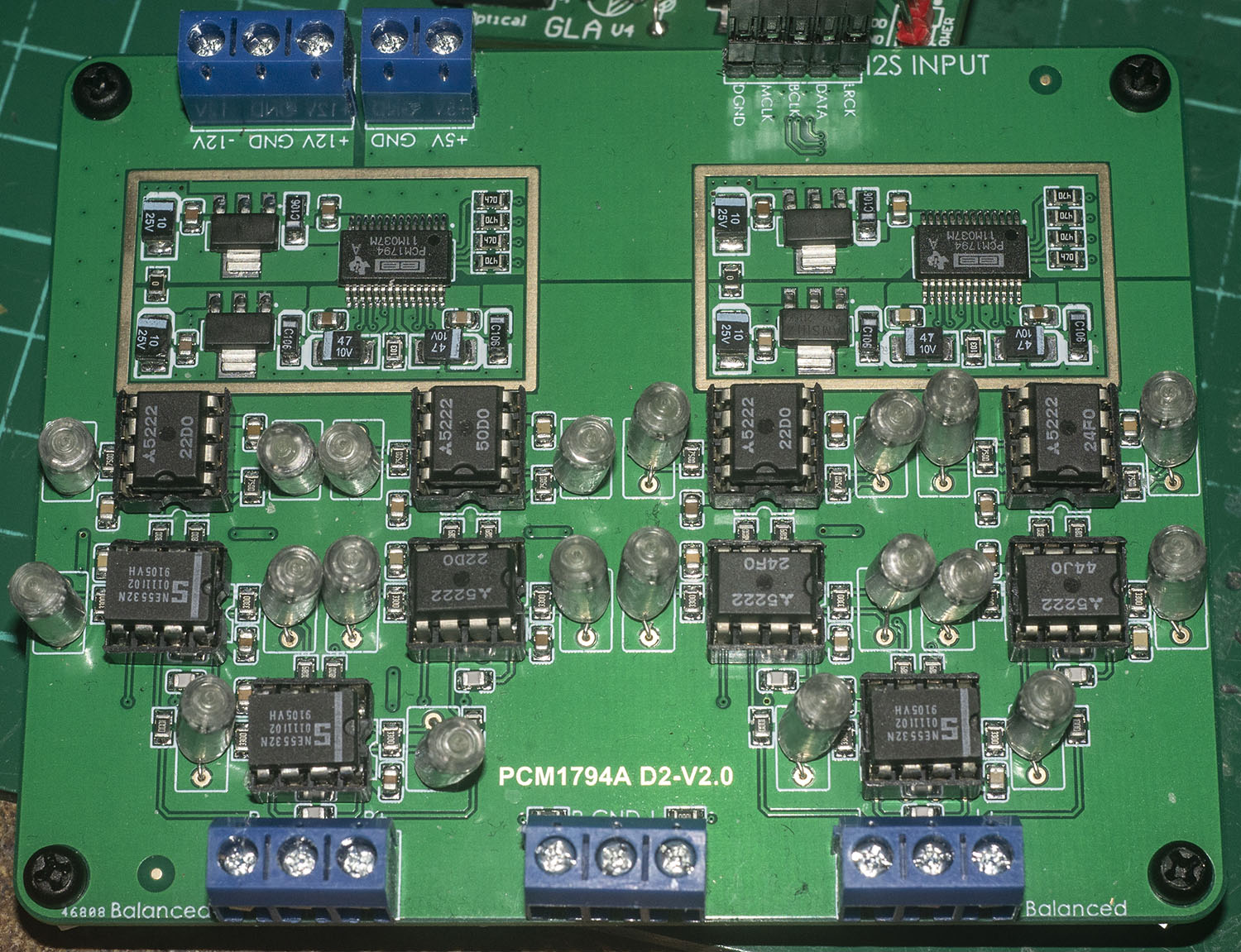

Just to get it up and running I fitted the opamps I had to hand - HA5222s, of which I had 7, plus three NE5332s to fill the remainder. The caps I used are Evox polystyrene.

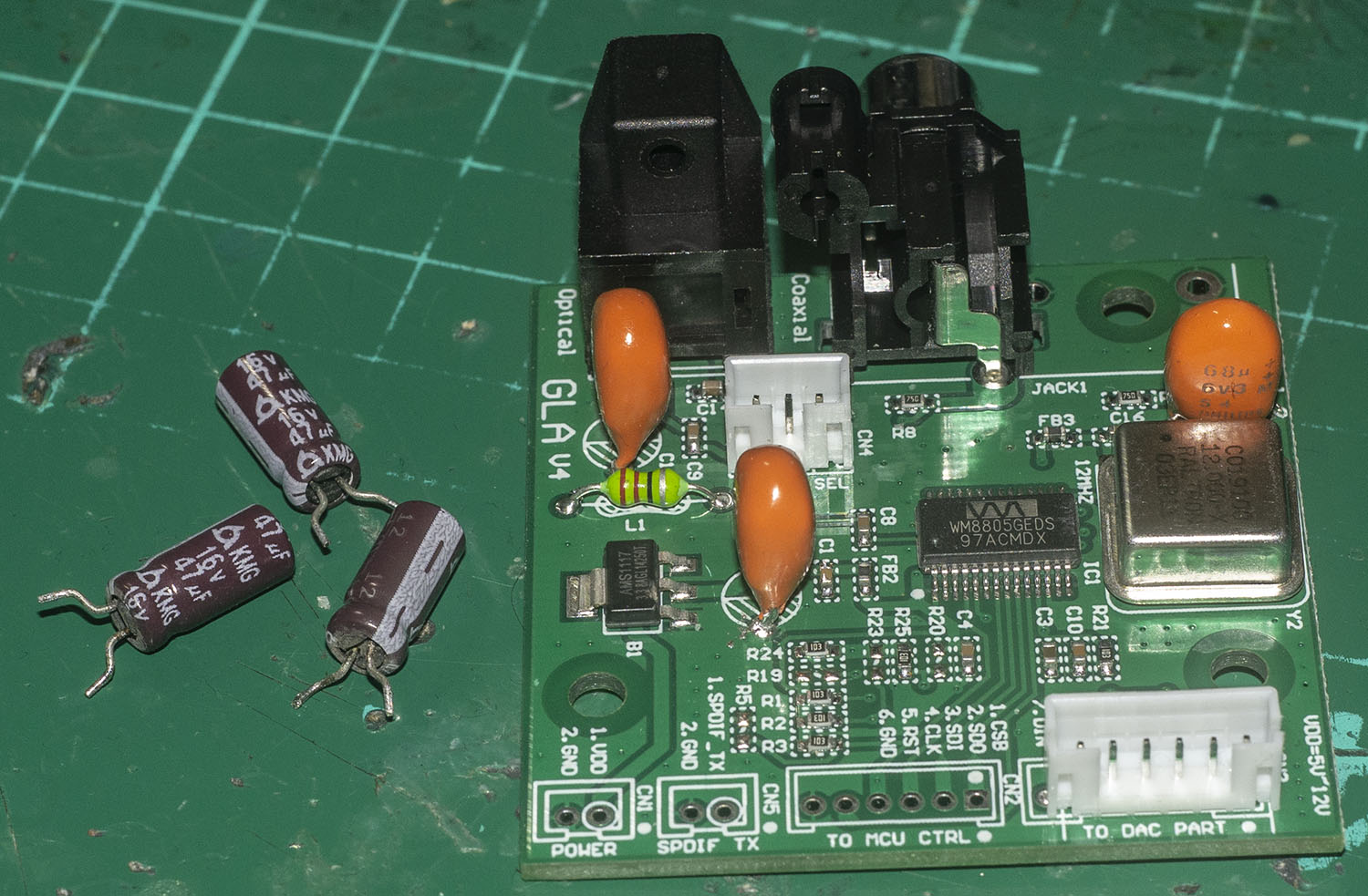

I'm using a WM8805 receiver board, I changed the three 47uF electrolytics for Phillips 47uF tantalums, just to make sure I have no fake caps.

Please be careful. Since I made my own board I don't have your layout or schematic. However it looks like you might have mixed up some dual and single op-amps. At least the picture I have shows singles (NE5534) in some spots where you have duals (NE5532).
Again I don't have your layout (since I made my own design) so hopefully my advice is not incorrect. Please double check before you power it up.
I think you should have four duals installed and six singles.
Aah, you are right, it should be four duals and six singles, cheers for spotting that.

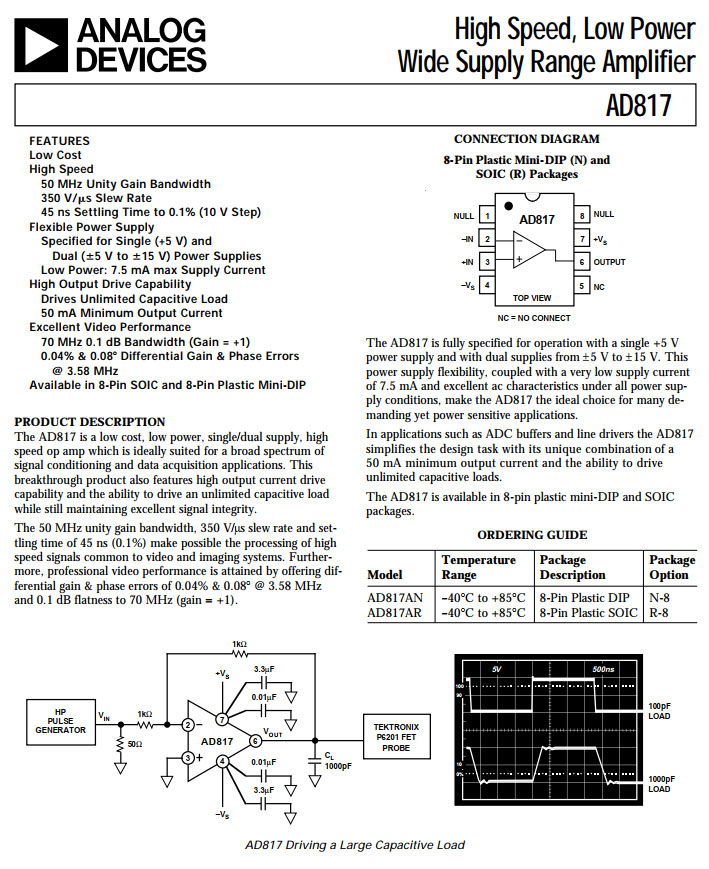

They also have AD817 single type which might be suited. Other singles they have in stock are the older OP07 and Toshiba TA75061P

I would caution about the AD817 being a video amplifier. Such amplifiers often have considerably lower gain than a modern low distortion audio op-amp and higher distortion.

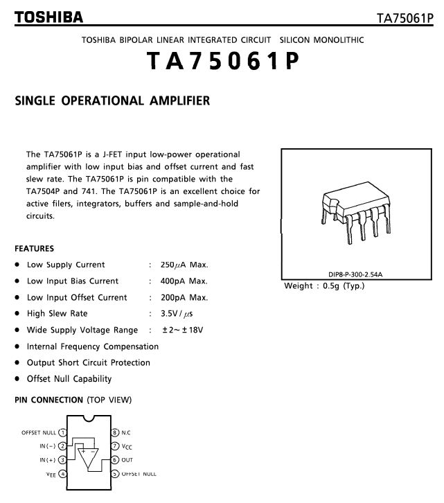

I would also caution about the TA75061 being low power, low gain and rather slow compared with any modern low distortion audio op-amp.
I think the classic NE5534 would be a better economy starting choice.

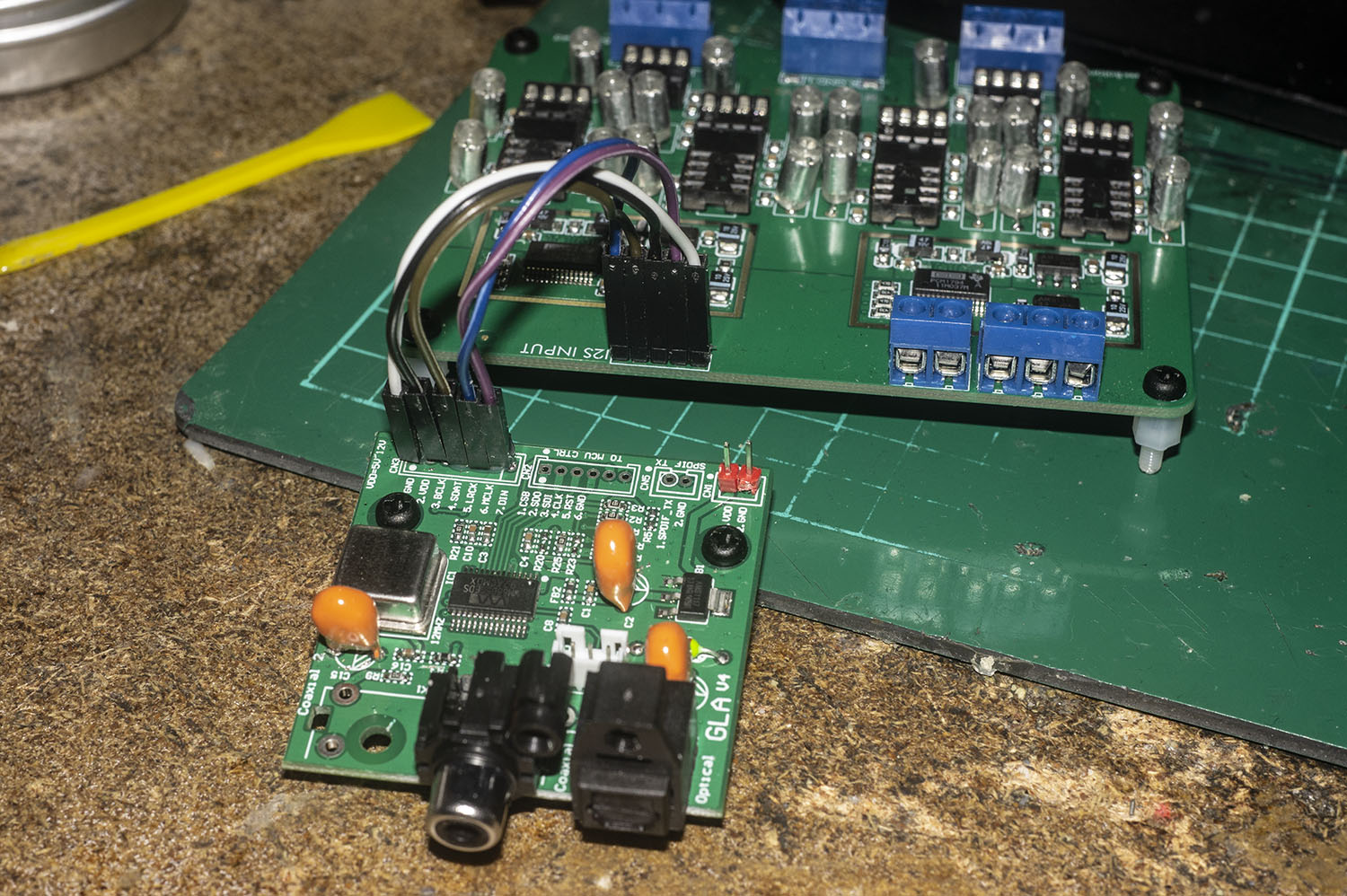

The Philips tantalum caps are not tantalum caps. You could call them fake tantalum caps but they’re the very good solid aluminium caps 🙂 SAL-RP122 I think, or the SAL-RPM128. These are 20.000 hours lifetime at 125 degrees Celsius and they were too expensive and thus they were discontinued.
Excellent in audio but they have brittle lead wires and one should not attempt to bend the pins close to the cap body as then the dipped epoxy "opens" just like has been done to the one near the terribly bad AMS1117 regulator (why the bad regulator is used in abundance is strange as it is worse than many other 3.3V regulator ICs). One other specific feature is that these tolerate a substantial reverse voltage. Both DC and AC that is!
Used after a regulator one has to take care that the regulator tolerates ultra low ESR caps at its output so in general this often means a low value should be used. On the board I would use 10 µF 16V and a better regulator to have the WM8805 perform optimally. In any case one should measure and check if the regulator doesn't oscillate. It would also be a good step to give the XO its own separate regulator. The unpopulated third input could be used for a nice 75 Ohm BNC connector.
