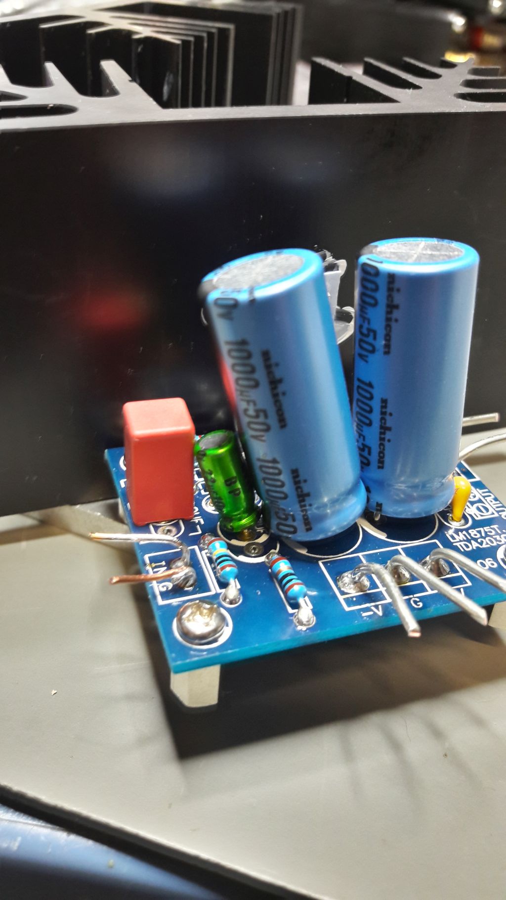

Hi
the red 10µ 16V electrolytic cap is definitively junk!

hi FF
Yes the ES are bipolar caps. if you look at neurochrome - he use it too ....😉
i use them for my recovery at my 28years old Accuphase C200v and at my TPA3255 amps. i tried other bipolar e.g. the small blue from panasonic no chance - they are hard in sounding, normal polar elna silmic 2 are a save cap. i am sorry but foil caps i have nearly nothing at home...

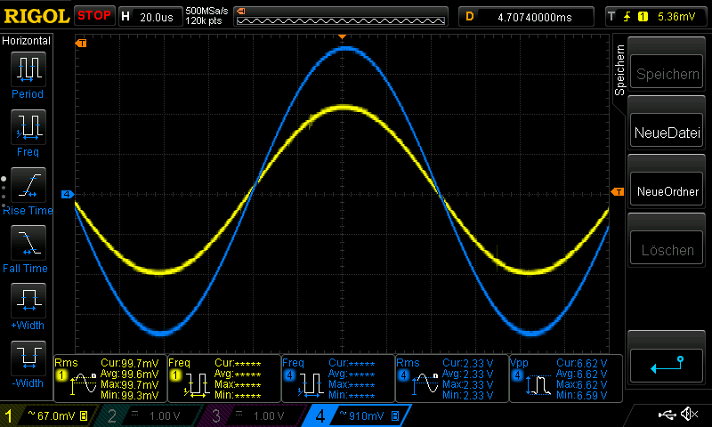

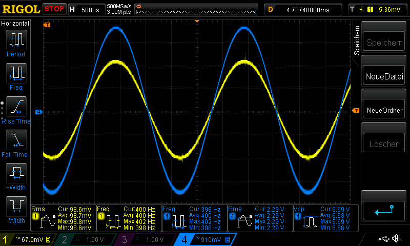

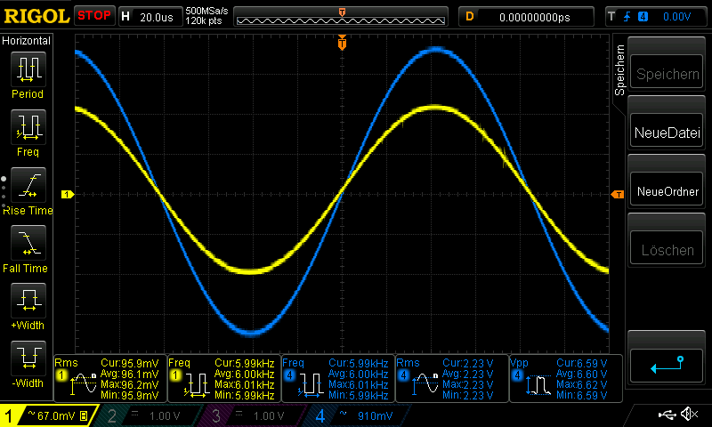

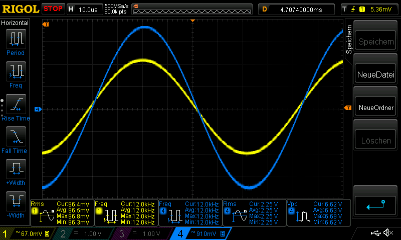

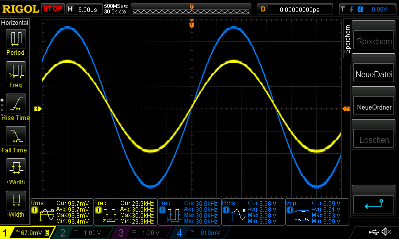

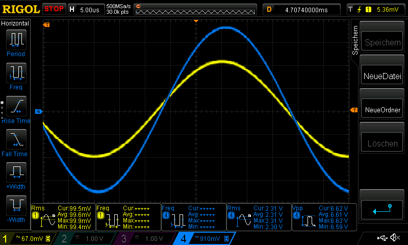

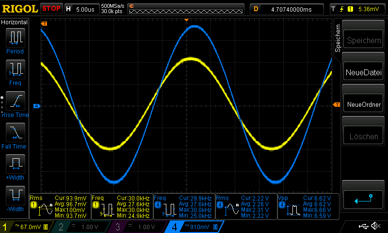

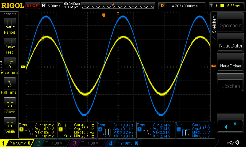

Hi
something without sound 😉 i made some frequency response test on 8R to look at my actual amp1_2 (green caps) at the low level and this phase shift.
the phase shift is still visible - any ideas to that??? 1k is ok. lower freq. are "earlier" and higher as 1k, 20k... its "later"
so different frequencies go with a different phase /time to the output?
yellow 100Vrms in and the blue is on the R channel output terminals
40hz, 100,400,1k,6k,12k, 20k,30k
chris
chris
Hi
chris
Hi Chris,
Such phase shift is normal. It relates to phase lead- and lag networks. I will not claim to be a specialist in this but until more clever people comment, I will give you a hint.
At low frequencies you seem to have a phase lead phenomenon with the output phase preceding the input phase. My impression is that it relates to the two Nichicon Muse capacitors that cause a lead effect at low frequency where the capacitors have an influence.
At high frequencies you seem to have a phase lag effect with the output phase succeeding the input phase. My guess is it relates to either the inherent phase-lag of the amplifier circuit itself or to the zobel network.
...phase shift with the other board - amp2

Am I right, there is little difference with the other board?
