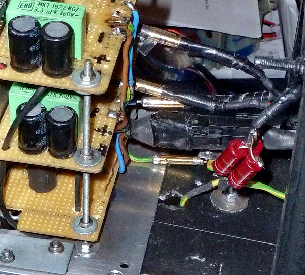

Hey people,
if anyone still has issues with a crackling sound just as the volume gets loud enough to rock, FauxFrench told me to put a 10W/fewR resistor in each + lead of the Speakerchassis. Icouldn't do this, because I don't have such resistors. But, to do at least anything which goes in the same direction I took three 82R/5W resistors in parallel and soldered this pack between the Starground and the - lead which splits up 2 inches later and goes up to the Speaker- Chassis.
I have no Idea if this was the tweak to let the crackling completely subside, or maybe the Witch-Doctor I oredered via Amazon directly from Togo as backup solution. This really impressive Guy came with a at least 30inches long JuJu-Bone and he knew his profession well! First, just as warm up and for only 25€ he did a phase correcting-dance. After that he took on the fight with the crackling-demon (400€).
To give at least no chance for the demon to get back in the Speaker cables the Doctor told me to solder the Resistor Thingy right where it is now, while he did a last safety-Dance to keep other Demons out of the cables as long as I was soldering.
What shall I say? Until today the Demon never showed up again and I can drive those really fine sounding speakers to volume levels which made all my neighbours react in an interesting way, sometimes it looks like they're dancing, but they scream, too. I just cannot hear ... .
