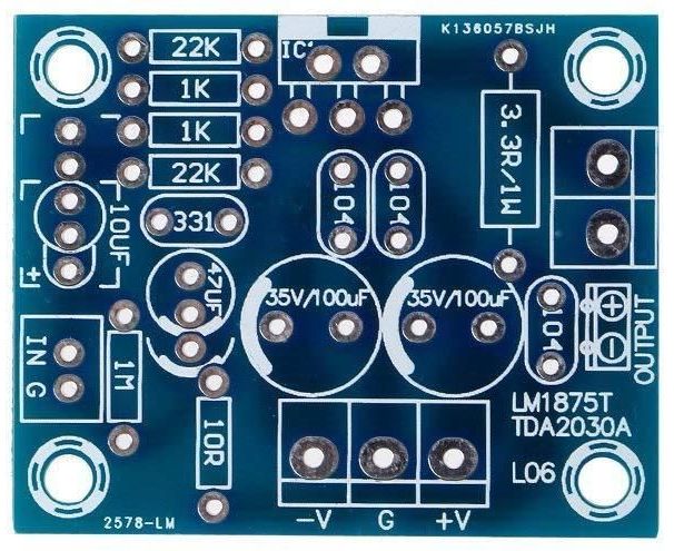

eBay mono LM1875 kit

I just found two of these kits in my parts drawer. I'd like to populate with genuine components.
Does anyone have a suitable BOM / shopping cart for mouser/digikey?l etc?
I was overwhelmed by the options then discovered not all components are available in Australia.

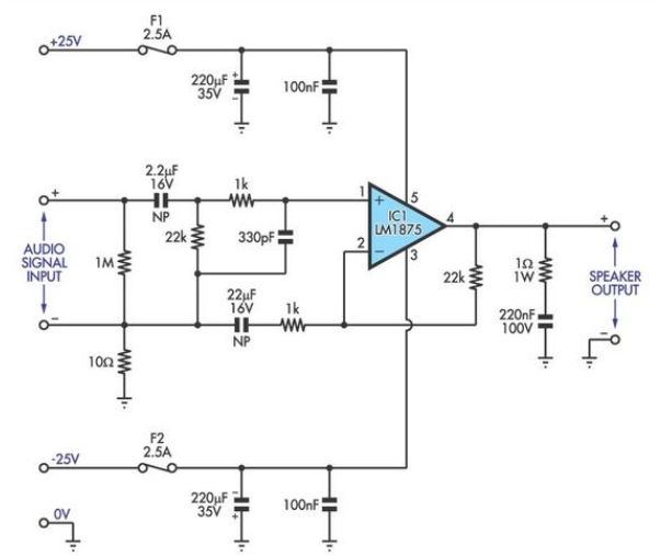

here is my best parts list. the luxury housing and the bigger PSU is according to other members not relay needed.
rabbitz version is that( refered to Brain BEll)
Reference: Brian Bell (Chipamp.com) LM1875 (schematic unknown)
Default configuration [components used in rabbitz build 2019]
R1 - not used (optional resistor to ground before C1) [not used]
R2 - 22k (input to ground resistor) [0.5W MF] 0,5 WATT R3 - 1k (gain resistor , gain = 1 + R4/R [0.5W MF] 0,5 WATT R4 - 22k (nfb resistor - on bottom of pcb) [0.5W MF] 0,5 WATT R5 - 2.7 2w (optional - zobel network) [2R7 2W MF] 2,7R - 3W R6 - jumper (optional resistor between input ground and output ground) [not used, linked]
C1 - 2.2µF (optional input capacitor) [1uF MMK] MMK version C2 - 22µF bipolar (optional) [Nichicon ES 22uF 25V] just 22µF C3 - 0.1µF (power supply decoupling) [ceramic X7R Vishay BC] XR7 Temp class C4 - 47µF (power supply decoupling) [Nichicon KZ 47uF 50V] 47µ Nichicon KZ C5 - 0.1µF (power supply decoupling) [ceramic X7R Vishay BC] XR7 Temp class C6 - 47µF (power supply decoupling) [Nichicon KZ 47uF 50V] 47µ Nichicon KZ C7 - 0.1µF (optional - zobel network) [MKT]
Note: 1K resistor after input cap not listed above but installed [0.5W MF]

It's easiest to stick with the values in the original SC article as that's what I mostly did on my final build. The only change I made was the zobel 2R7/100nF, 220pF in lieu of 330pF and a 1uF MMK (MKT also OK) input cap. Make sure you use monolithic X7R for the 100nF by-pass caps.
You should be able to get most parts from Altronics and better power supply caps from RS Components if desired. Digikey is also good if you are ordering other components as well to make up the A$60 free shipping.
If you are having difficulty in sourcing I can send you 2 Nichicon ES 22uF 25V and 4 Nichicon or Panasonic 220uF.

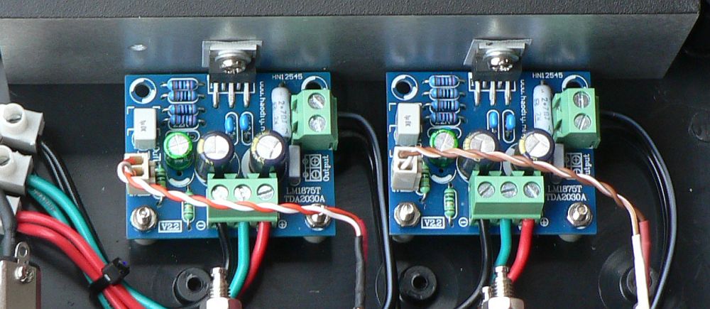

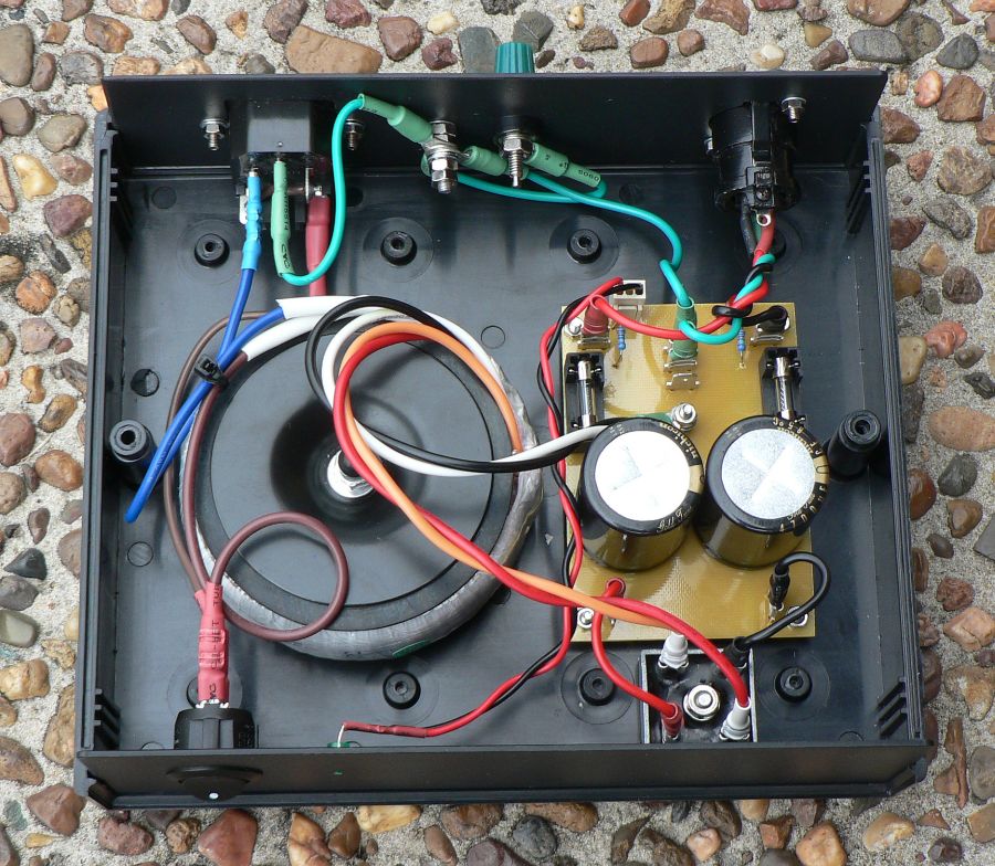

I've added a pic for reference showing a power supply with a single transformer in the build.
907645d1609679657-free-preamp-lm1875-amp-speakers-newcastle-aus-rz21_lm1875-jpg

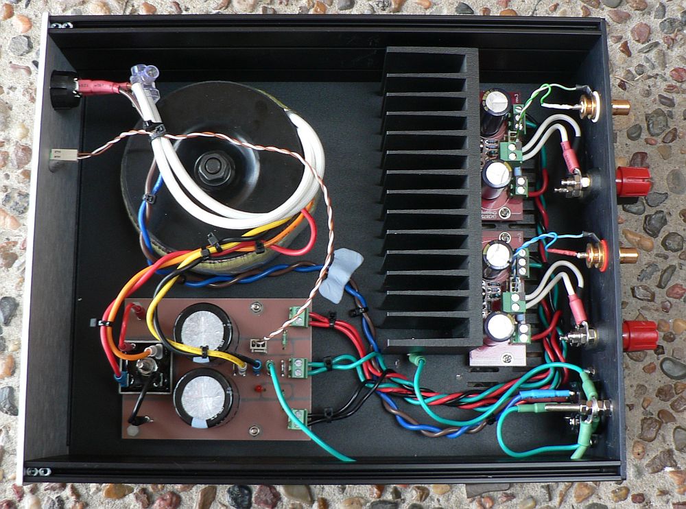

Thanks a lot, rabbitz! The photo explains tons for me! So, this is great news it is possible to run 2 chips with 1 trafo and 1 rectifier, where you split the DC output to each LM1875 with that black cable. How did you do that, btw? Do you use a 6 conductor cable or special connector?
Regarding trafos, I have found Antek which seems much cheaper than anything else. They offer 100VA and then 200VA; nothing in between. Excluding cost and size, is 100VA less desirable than 200VA at all?
You have 2 DC outputs from each rail and PS ground. So you end up with Transformer > Bridge Recifier > Capacitors > 2 wires from each +ve, -ve and power ground. If you look at the Pic in post #847 there's a Molex with 6 leads and I've added a pic of a LM3875 where you can see it easier with different coloured wires. Red +ve, black -ve, green ground.
!00VA is fine and 200VA would be overkill.

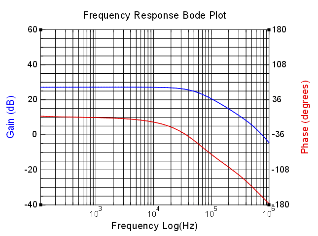

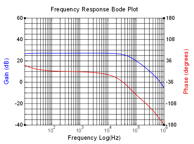

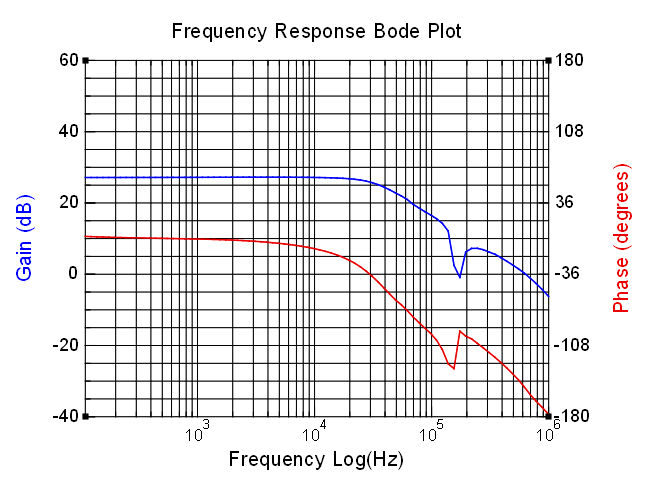

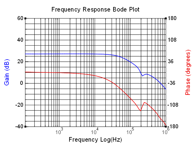

I've just made a quick set of frequency gain-phase response tests out to 1MHz on an ebay LM1875 kit with fake IC. I was interested in seeing the HF response to load change (no load, 8R, 16R, 32R) and to load capacitance (47nF, 100nF, 680nF). The hope was that the stock amp would be unconditionally stable, and it appears to be so. Testing was with just a +/-15V regulated rail supply, and only for 1W nominal output.
The mid-band gain is about +27dB, as anticipated. Out at 1MHz, the gain falls off to about -5dB (+/- about 1 to 2dB) for all load combinations, and phase has also similarly fallen to around 180deg.

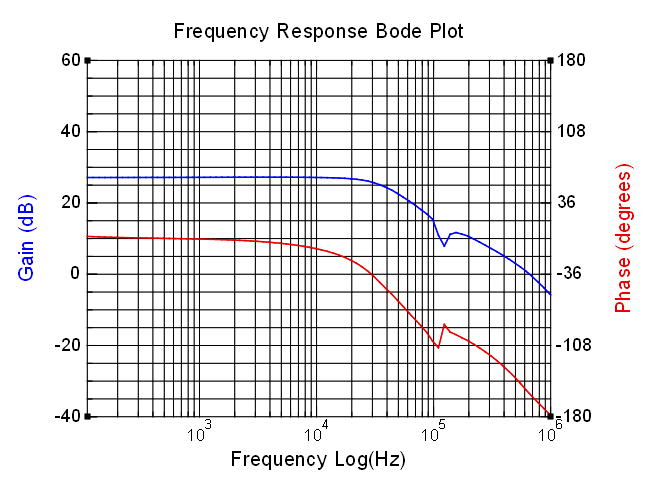

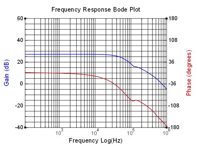

Of interest is a minor resonance related to capacitance loading, which occurs near 200kHz for 680nF, and increasing to 550kHz for 100nF, and similar for higher resistance loading.
I have previously used some small inductance to make certain valve amps unconditionally stable, so I included a simple emi axial leaded 6mm ferrite tube (circa 0.55uH, and mainly inductive from 20kHz to 600kHz) in series with any loading combination to see its effect. Adding the axial ferrite part had no noticeable affect except for when there was capacitance loading, where it suppressed the minor resonance and lowered its frequency a bit.
I had checked the frequency and distortion response using REW and an EMU0404, and that was consistent with datasheet and other testing I'd seen. The above testing to 1MHz was done with a Picoscope 4224A and FRA4 software.
I'll hopefully get some real LM1875's in sometime to compare, although my use for the amp is just for general instrumentation purposes. And I may get keen and test for clipping on-set response, but I'd likely use a burst of a small number of signal cycles to avoid any die heating effects.

Yes those plots are out to 1Mhz, which is luckily 'just' wide enough to show the closed loop response characteristic out to a region indicating 0-deg phase and 0dB gain margins for stability assessment. Squarewave testing with different loads could confirm no resonance/feedback issues beyond 1MHz that could be 'hidden' by frequency sweep testing only to 1MHz.
I could identify only one youtube video that did squarewave testing, with resistive and capacitor only testing, but not no-load. The capacitor only loading showed up damped resonance at about 220kHz, which aligns with the gain phase plots in post #851. That video didn't identify the scope model, although plots with 5us timebase indicate a bandwidth beyond 10MHz.
