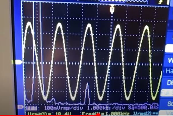

AFAIK this picture shows john audio tech´s method to measure:
1khz main tone and the 3khz or 4kHz pilot tone which is 1% of the 1khz tone.
so you can better look at the the pilot signal especially at pushing more power...

In fact, I see the 2nd harmonic dominant with 60mv rms for 18.4 fundemantal. This gives 0.32% at 40w.

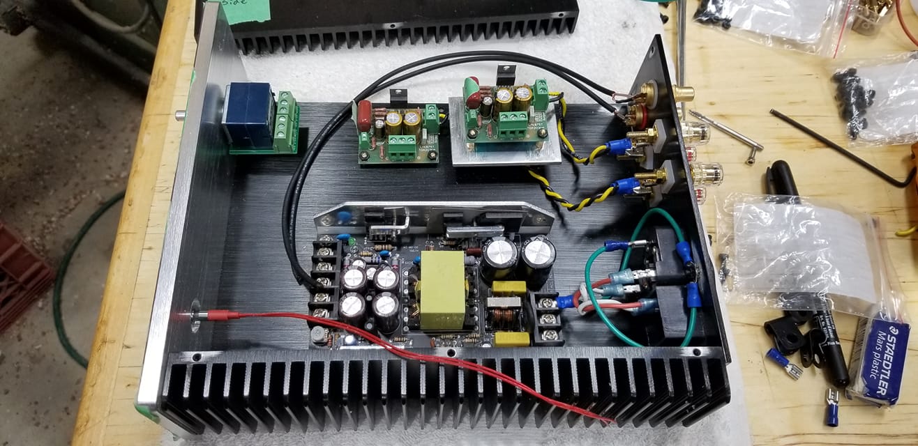

Slow but steady progress on my little Ebay LM1875, did some more wiring tonight...
Hi Davefred,
Do you have a link for the SMPS?
Denis
Hi Denis
i bought the same...important is that it is dual = +/- 24V etc.
.i what tot try a SMPS vs unregulated power supply...

I have only powered up the SMPS to see that the voltages measure correctly, I have not put it under load, but it makes a funny sound.
Does yours make a funny sound? A high pitched sound?
