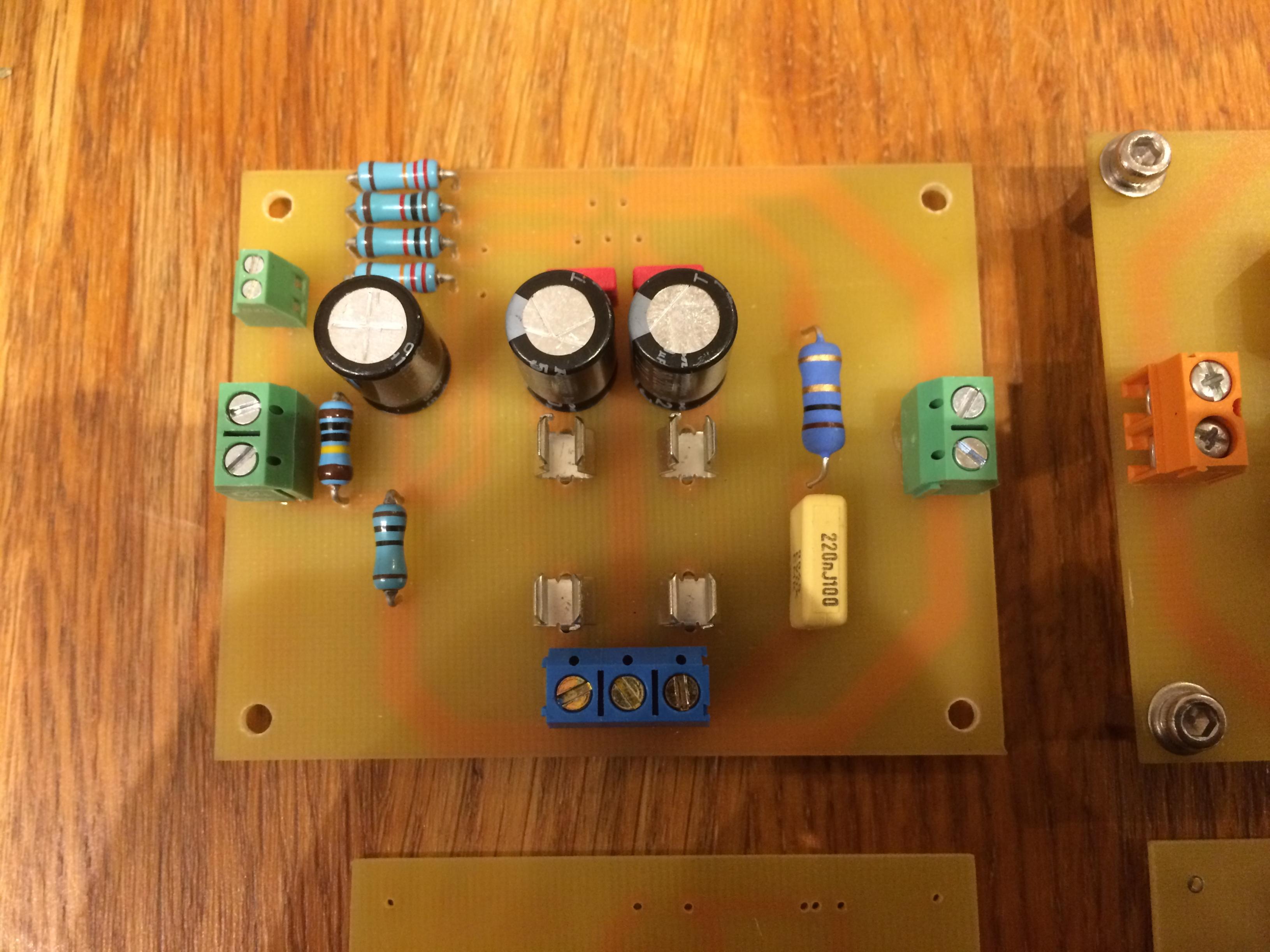

If anyone is looking for a link to the boards with plating in the through holes and on top of the board, I think these are them,
Aliexpress LM1875T boards
yes...fine David thanks
But be aware of the low quality of the pcb and therefore do not try to solder twice at one point. it is because the solder dot will be gone🙁
chris
chris
These are harder to rework as well and I found the boards without the though hole plating easier to work with.

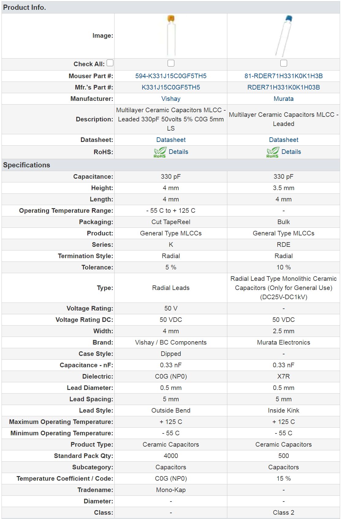

What would be the better component for C2, 330pF capacitor,
Vishay Multilayer Ceramic Capacitors MLCC - Leaded 330pF 50volts 5% C0G 5mm LS
or
Murata Multilayer Ceramic Capacitors MLCC - Leaded
or

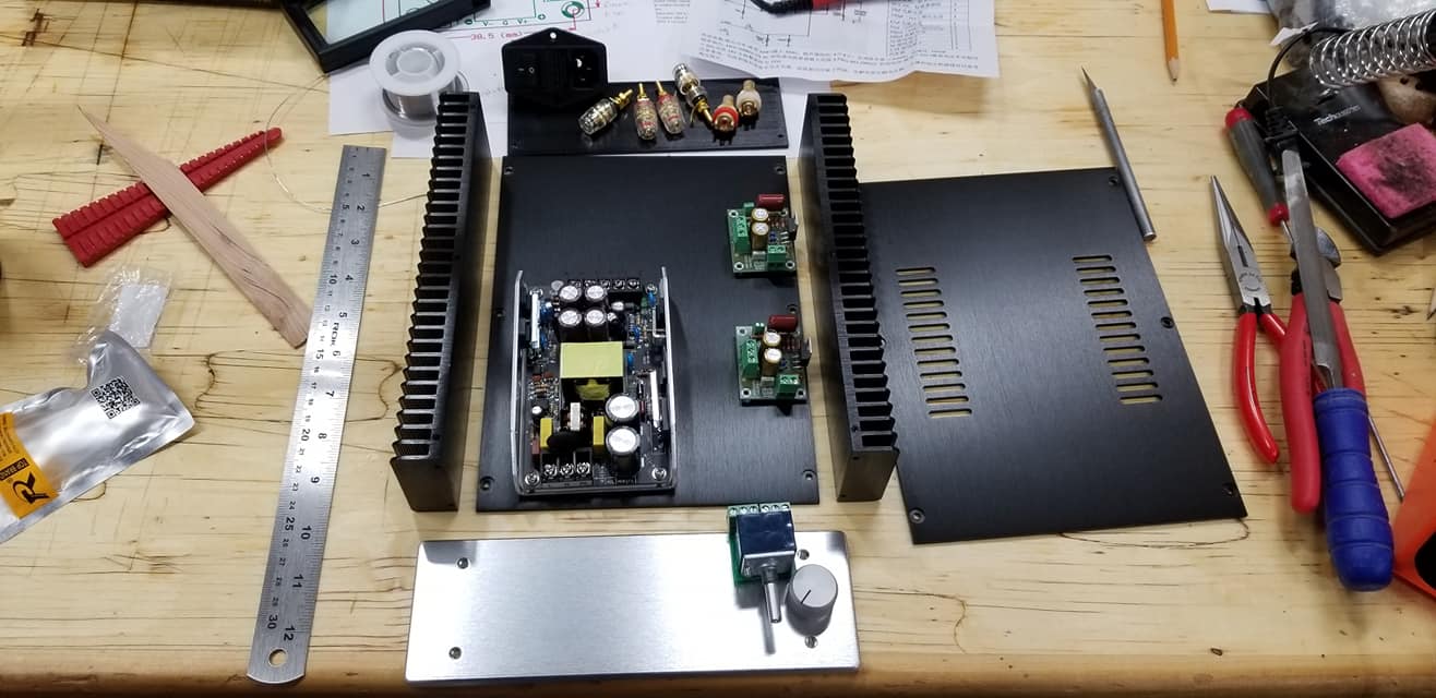

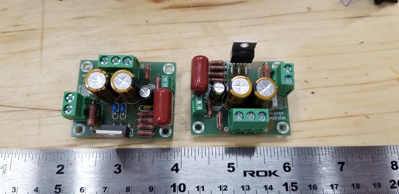

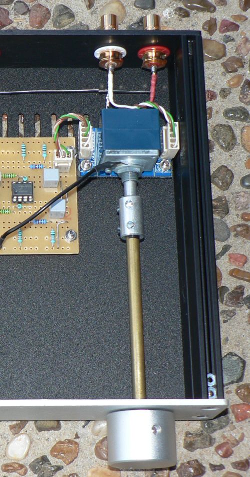

My tiny little Ebay LM1875 kits are coming together nicely, now to decide on a layout...
I'd go with the amps at the back on each side, the pot in the middle with an extension shaft to the front.
yes ...rabbitz is right.
then you get short cables to the speaker terminals and a short way at input cable.
input coax RG178...inner cable is partly silver 😉

to be honest with the smps you could have the space for 4 amps inside - so you could go for bi amping (bi wiring) if your speakers can handle that.

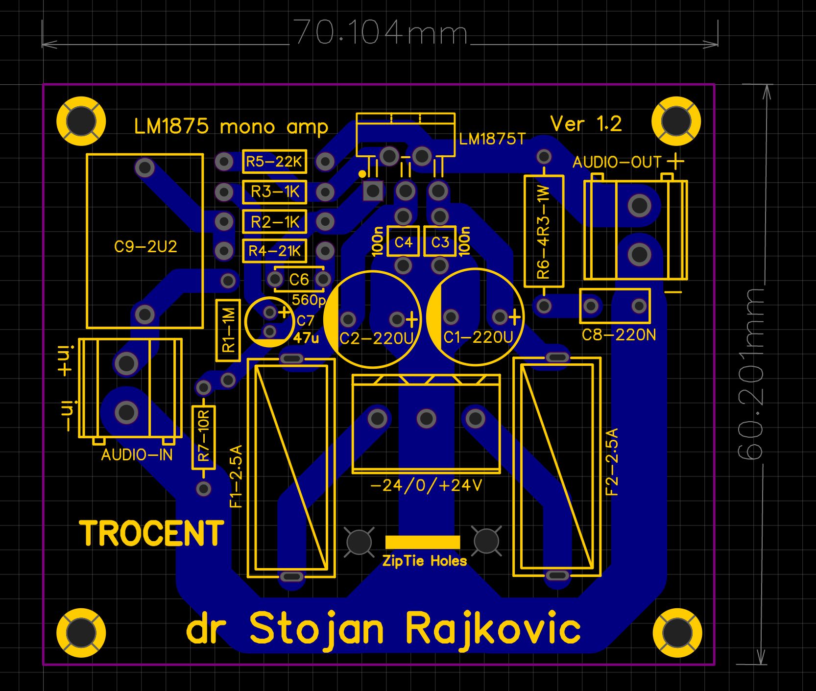

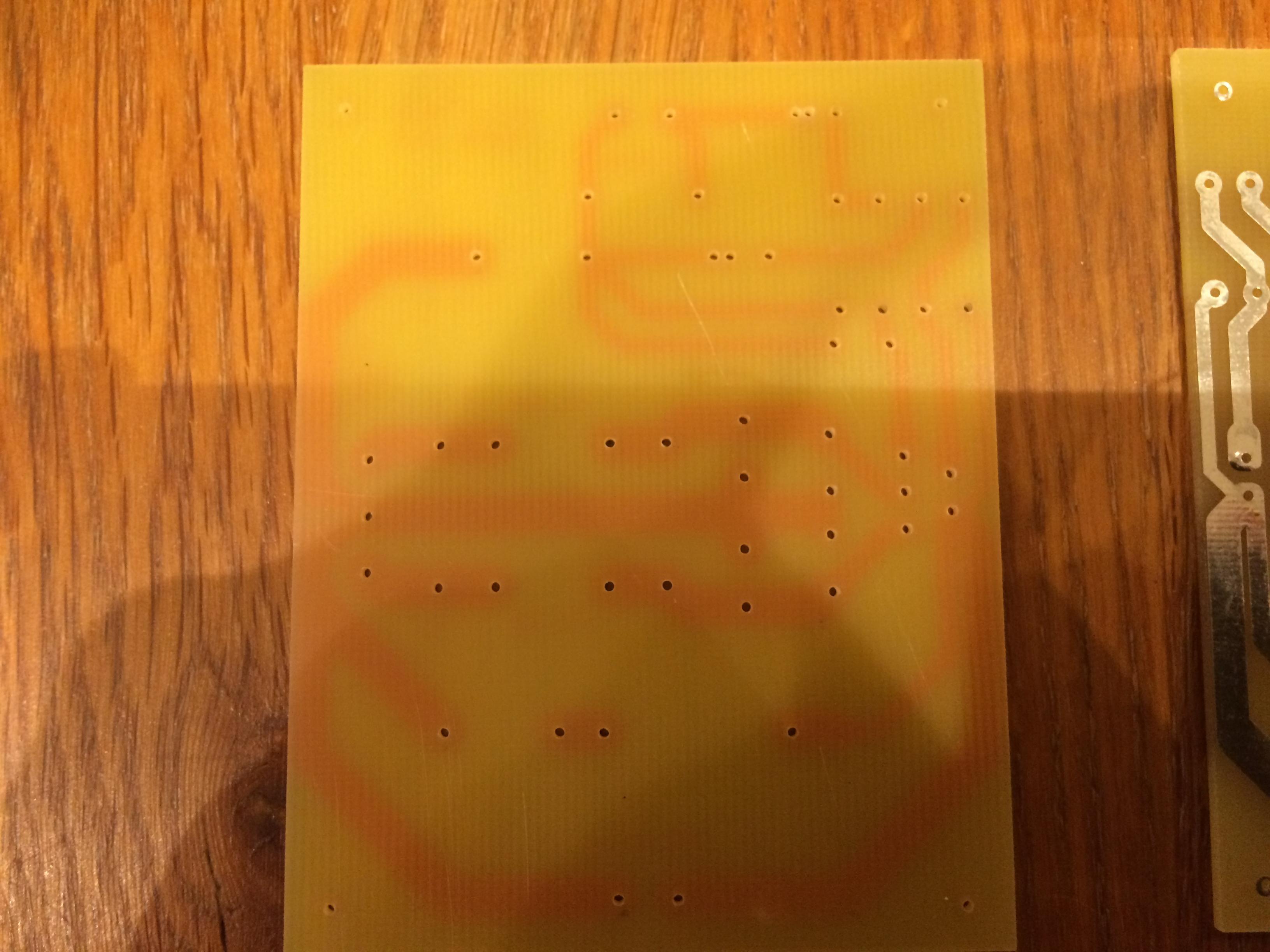

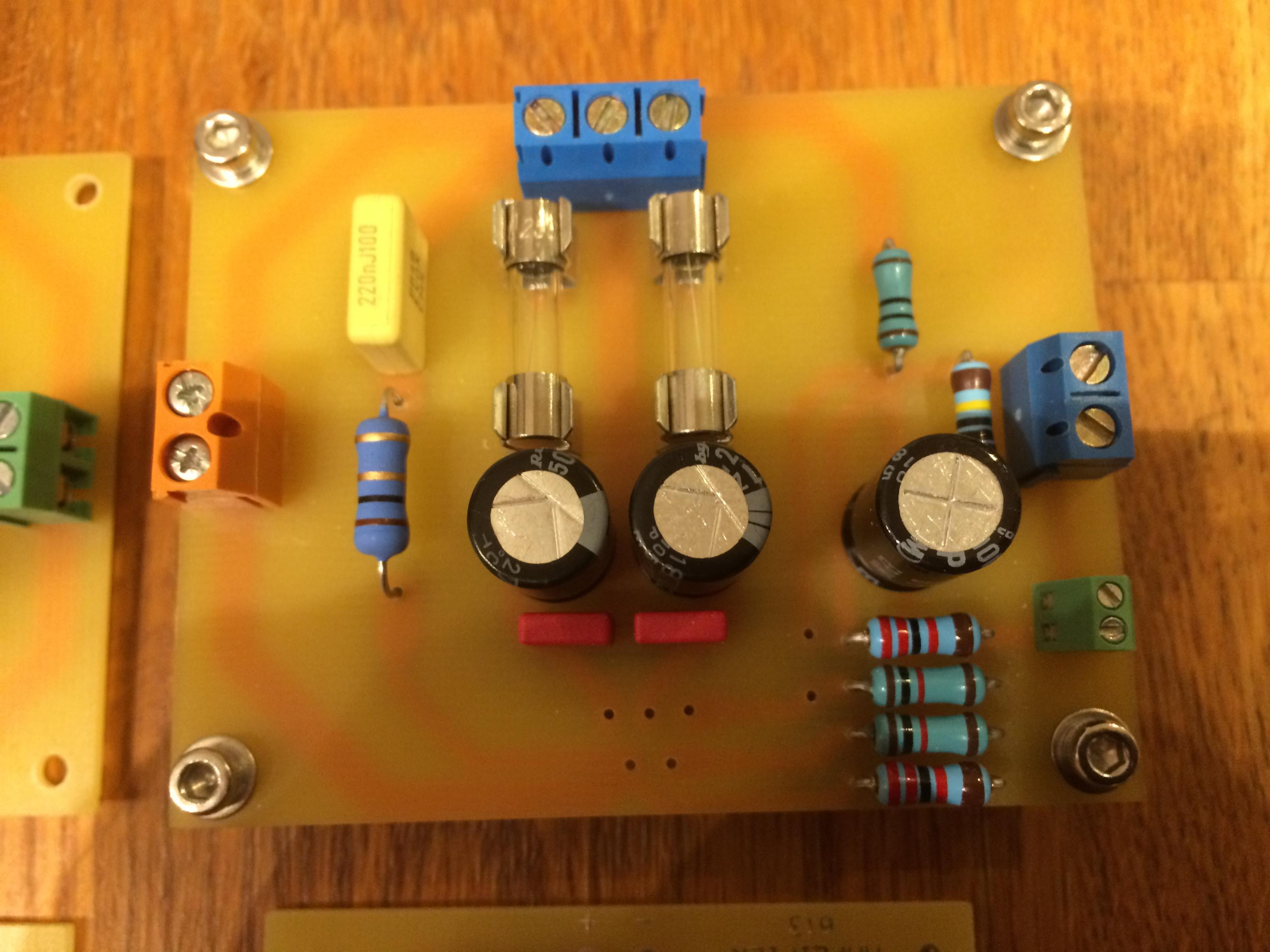

This is my work in progress ... just started this project
well done...its a DIY pcb!
Nice work on the PCB. Much better than my attempts with a Dremel. 😉
This is what I mean with the pot extension shaft. Even though this is for a pre amp, it still applies for a power amp and you can see close RCA and short signal wires.
For short runs I just use twisted Cat5 but for longer I use Mogami W2944 which I discovered in a CF My Ref thread.
