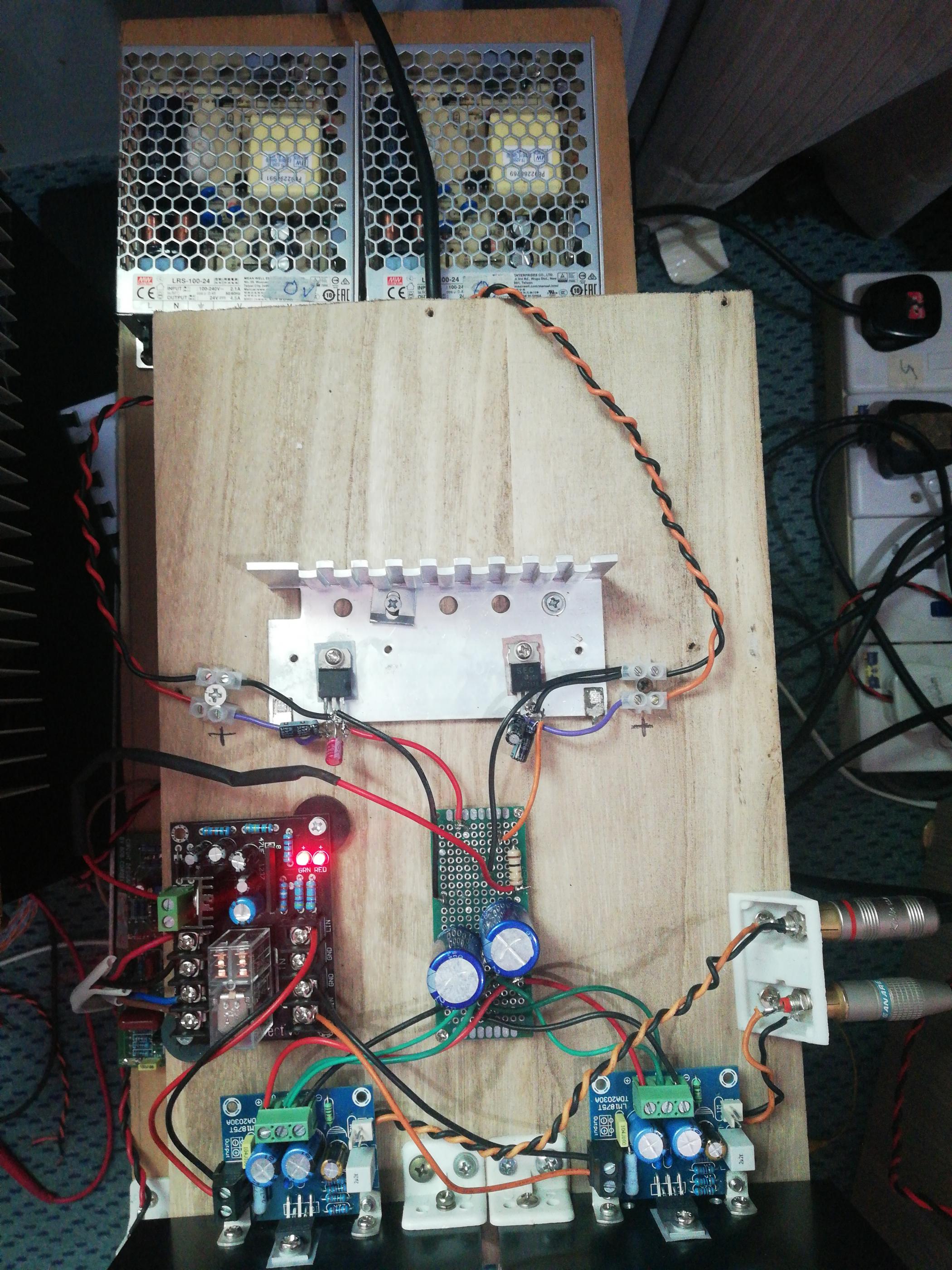

I was asking if that was the correct type of small transformer to power *JUST* the speaker protection board as it requires AC12V to AC24V.
The main amp boards would get a proper separate DC+-24v SMPS.

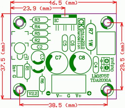

I've designed an LM1875 PCB. I call it the Bigcap.
It turned out halfway between the old schoolies amp and the datasheet implementation.
-I removed the 10R ground lift resistor. It doesn't feature on the datasheet and my understanding is that this is generally unnecessary.
-I added fuse rails back onto the board that were taken off the Ebay pcb when they ripped off the schoolies PCB design.
-I've changed the screw terminals for power connections and outputs to spade connections.
- Space has been allocated around the 22uF feedback cap to allow large sized film caps (up to 27mm pitch) instead of an electrolytic can.
- Space has been allocated between the power supply decoupling caps to allow a screw driver to access the IC.
My board beside the ebay board
Populated big cap pcb beside the ebay board.
Attached are the gerber files if anybody feels like a JLCpcb order.

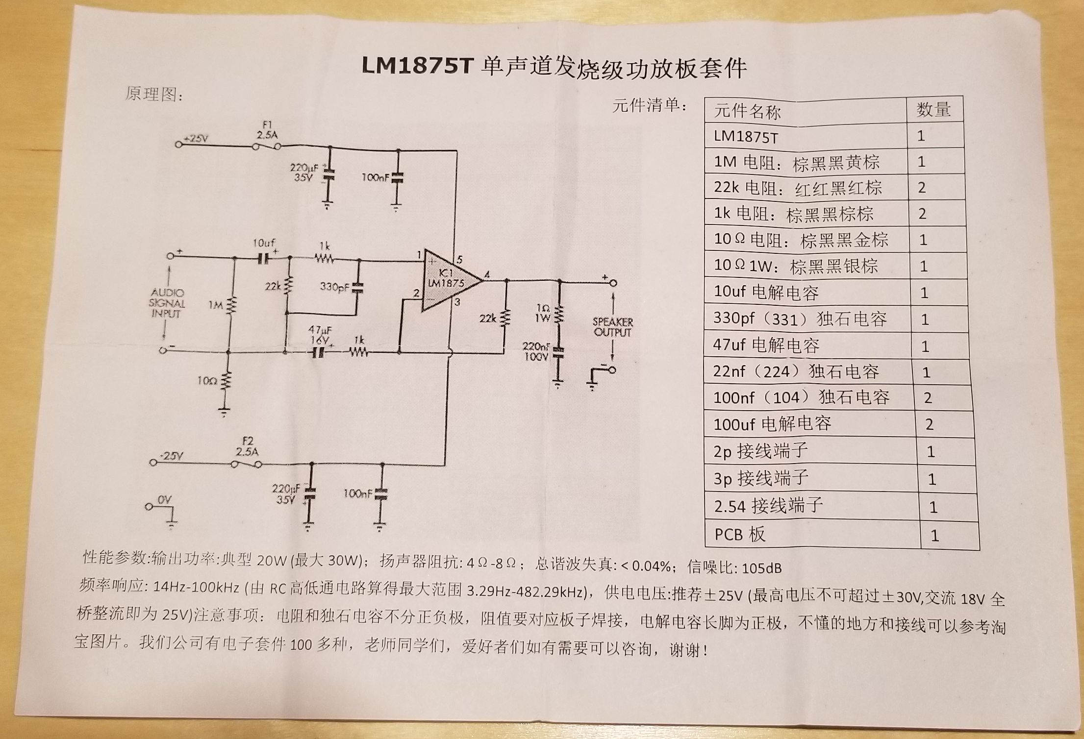

Just for Yucks, I decided to translate the Chinese supplied instructions that came with an Ebay LM1875ST kit.
Parts list right of schematic,
Component name Quantity
LM1875T
1M resistance: brown black black yellow brown 1
22k resistance: red red black red brown 2
1k resistance: brown black black brown brown 2
10Ω resistance: brown black black gold brown 1
10Ω1W: brown black black silver brown 1
10uf electrolytic capacitor
330pf (331) monolithic capacitor 1
47uf electrolytic capacitor 1
22nf(224) monolithic capacitor
100nf (104) monolithic capacitor 2
100uf electrolytic capacitor 2
2p terminal block 1
3p terminal block 1
2.54 terminal block 1
PCB board
Description from bottom,
Performance parameters: output power: typical 20W maximum 30w); speaker impedance: 4Ω-8Ω; total harmonic distortion: <0.04%: signal-to-noise ratio: 105dB
Frequency response: 14Hz100kHz (the maximum range calculated by the RC high and low pass circuit is 3.29Hz-482. 29kHz, the power supply voltage: recommended ± 25V (the maximum voltage cannot exceed ± 30, AC 18V full
The bridge rectifier is 25) Note: The resistance and the monolithic capacitor are not divided into positive and negative electrodes. The resistance value should correspond to the welding of the board. The long leg of the electrolytic capacitor is the positive electrode.
Treasure picture. Our company has more than 100 electronic kits, teachers, students, and fans can consult if necessary, thank you!
I found it interesting anyway... 🙂
