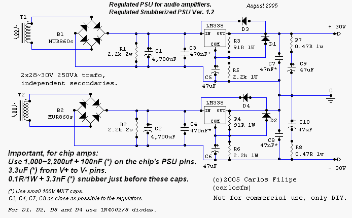

Another Question: Is it possible to use a Cap Multiplier to get rid of those 3-4 Volts? If so, how should it look?
You do not really have sufficient drop-voltage for a cap multiplier that has real filter effect. You can put "voltage dropper" circuits between the outputs from the rectifier bridge and the power rail decoupling capacitors. You could also just use drop-diodes connected in series but the "voltage dropper" circuit is more compact and easier to cool in a controlled manner.
Use Darlington power transistors rated for some 10A, in a TO-220 housing, and ordinary 2V7 zener diodes.

Hello,
I ordered a couple of the boards/kits with the through pads, and now I am trying to decide on a power supply. I think SMPS would be cheaper and certainly easier, but I would prefer to use the better of the two.
Is there any reason to go with a SMPS vs. Toroidal Linear Power Supply Unit?

As i remember right. fdenys used a SMPS with dual voltage(adjustable) and is happy.
my first boards i use the classical transformer 18-0-18 120V with cap with about 14000µF each rail.
my SMPS i ordered came very late and i haven´t compare it. if you read in other chip amp threads a lot of members are happy with the smps for chip amps and of course with class D amps.
the only thing what i remember (TPA3255...what is wrong-smps tests..) is the quality of feedback speed and power. if i read carefully then the smps during the dynamic "request" of an amp is not easy for low cost smps so the rule for me is to use a over dimesioned smps for amps.
i think the "noise" with actual smps are fine enough for these amps....I will compare it and report back...

NO! this is to less for 2 amp boards. its a 12V - 12VA transformer with 1amp current.
please us in minimum a 80VA transformer. so a rule of thumb.
one channel can deliver in 8R speakers about 30W so you have 60Watt total + factor 1,5"dynamic reserve".....--> so its about 90VA. so i found that a 100VA-120VA is the same price with more power reserves.😉😀
please look at transformer with 2 secondary windings- or use a dual rail SMPS- less work 🙂and same result as fred wrote.

Hi david
please take your time and read through this tread- you will learn a lot😉.
if you use a chip LM1875 from a vendor like mouse , farnell, digikey etc...then you can expect that this chip has a kind of self protection..---> thermal + short cut. read here the datasheet.
so then a speaker protection board is not really needed. if you have space and you want to have a speakers protection then use it.
