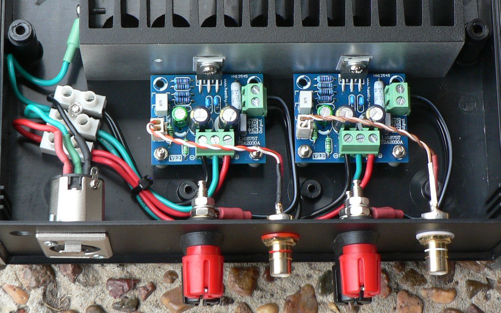

I finished up the Ebay LM1875 amp today, and it is NOT working correctly!
At full blast, there is a very low volume sound coming from the speakers, both channels have the same problem.
PSU is producing correct +-24v, 48v at amp from +-, ground continuity is there.
Any ideas on what I should be checking?

Hi David
sorry to read that.
Did the amps working in a other configuration?
power off and wait 10mins.
then disconnect every wire and check if you had contact to the chassis where should not have it !!! -
RCA connectors,
speaker terminals,
chip to heat sink (maybe you forgot the isolated screw)
knob volume
check potentiometer connection diagram, maybe you do a wrong solder and you do not have a variable resistor...

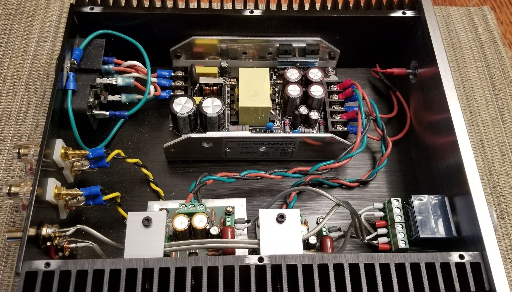

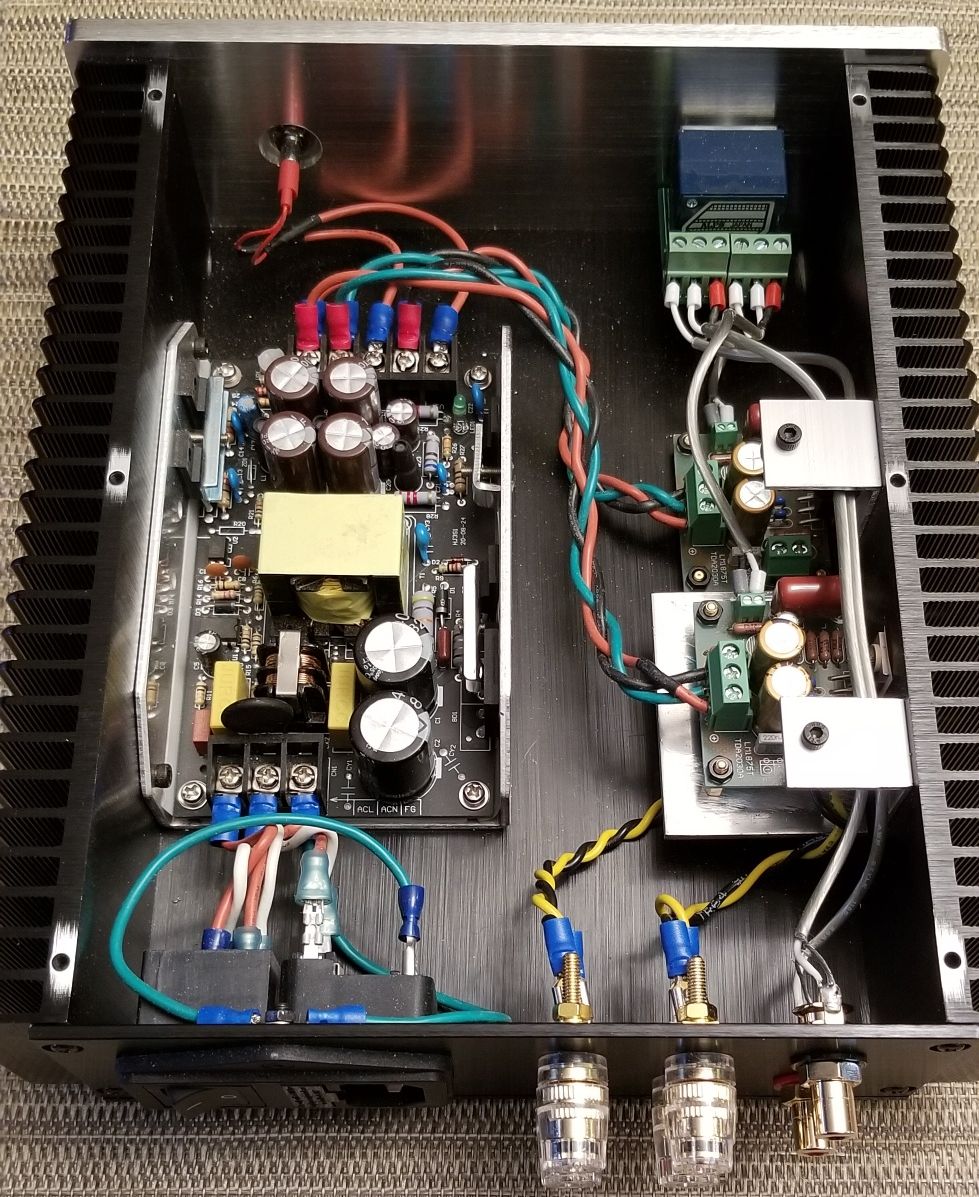

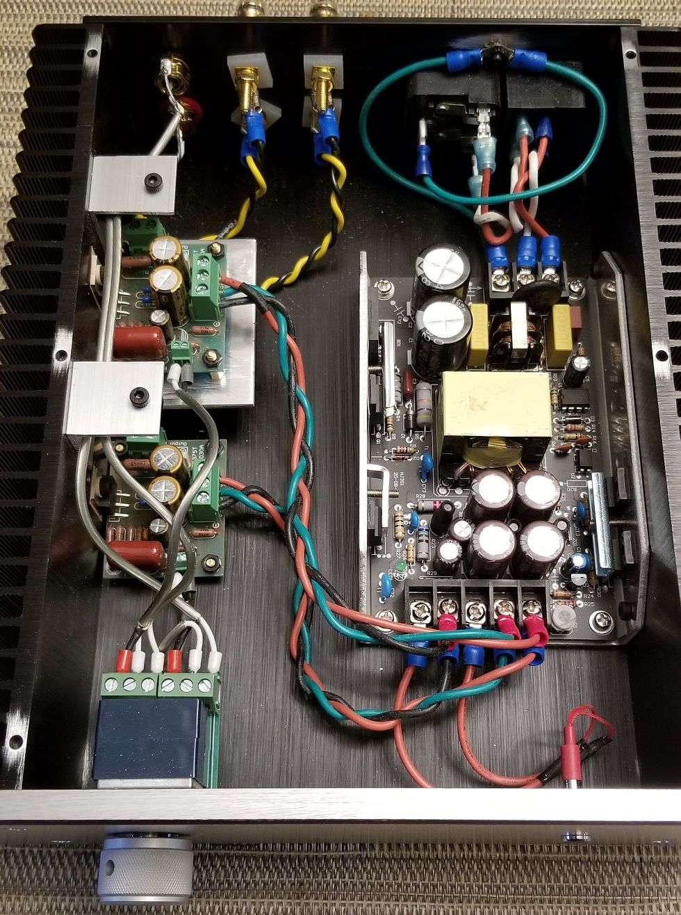

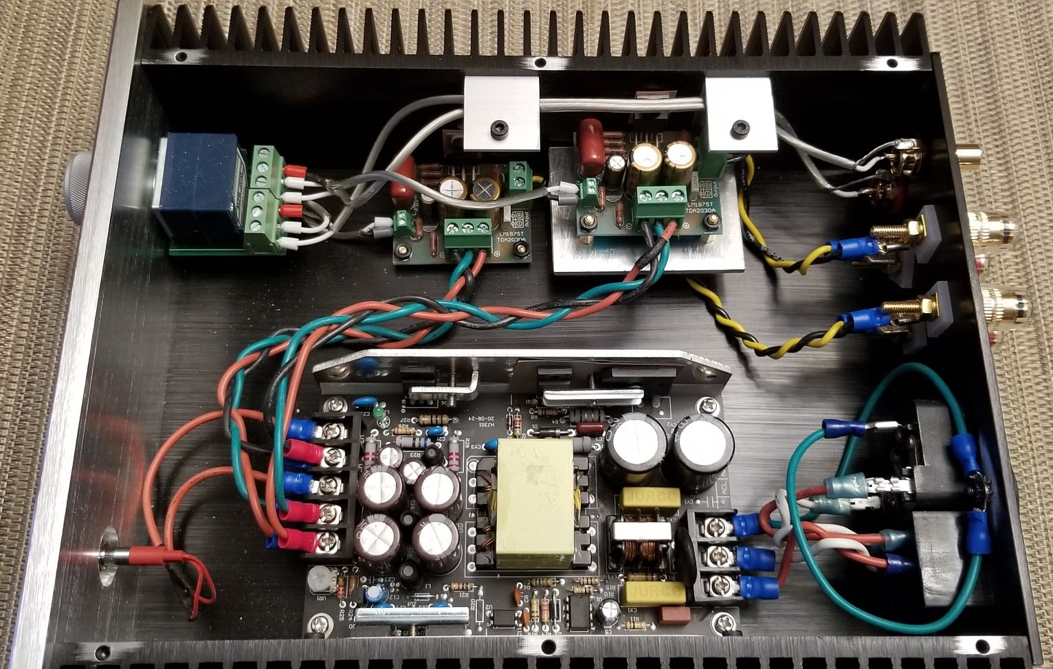

Could be incorrect wiring of the pot shunting the signal to ground. The other possibility is reversing 22K/1K feedback resistors on the amp PCB which would give almost no gain. Check all your resistors are in the correct locations.
With power amp building you should do 3 basic checks with a DMM.
1. Make sure the chip is isolated from the heatsink.
2. Check the supply voltage on the PCB, +ve to ground and -ve to ground to ensure correct rail voltages. Don't measure from +ve to -ve as it is not referenced to ground and gives no idea of the symmetry of the supply.
3. Check the DC offset on the speaker output and should be < 10mVDC and all mine have been < 2mVDC.
After doing those basic checks, I suggest you run a source with volume capabilities (such as an iPod) directly to the amp PCB inputs one amp at a time. This will tell you if the amp has gain and is working correctly.
I've added a pic for reference of one I threw together this month.
