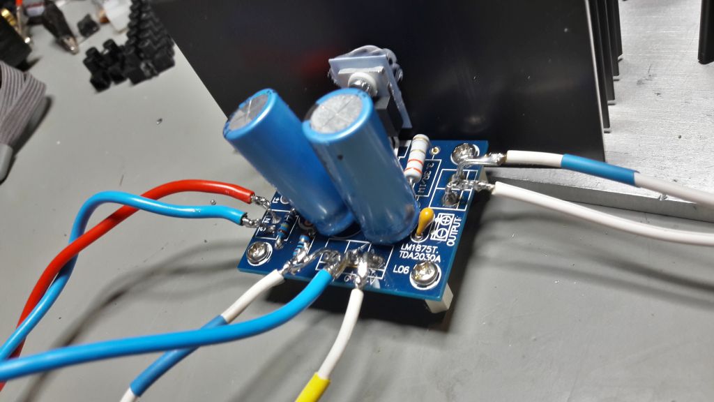

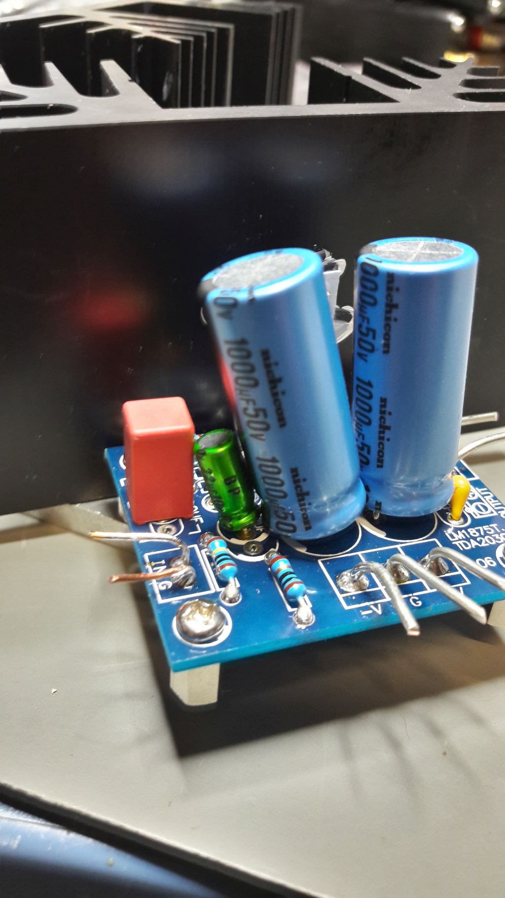

Hi
measured direct on the +V -GND -V terminals at the amp board.i add 3300µF on each rial.is not better 100Hz ripple with 188mV -before 220mv...so more caps = ripple gets down😉.....i will have a closer looka t my space in my mock up /housing😀
maybe rabbitz your are interesting to add some more caps ?...and report back about the changes = SQ
pic 1 +V
piv 2 -V

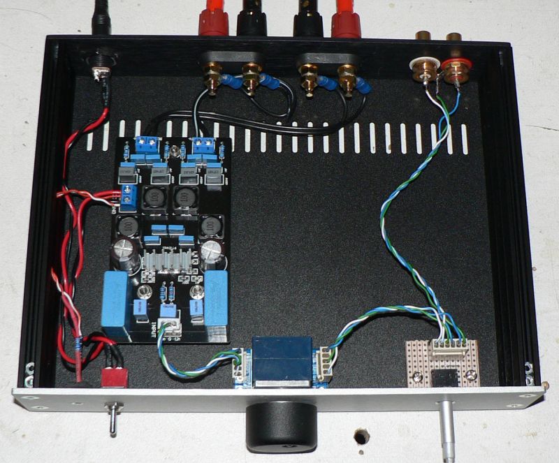

I tried several TPA3116 and the only one I liked was the blue/black designed by Danzz (see pic). All the rest had issues such as hiss, noise or failed.
P72 is ESP Project 72. There are several dual PCBs on ebay like the one in the pic but not ideal.

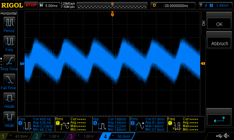

the red 10µ 16V electrolytic cap is definitively junk! - this is maybe the reason of bloated/strange bass.
from 10 Hz up to 100 Hz i have a lower gain (look at the scope Voltage)and at 10Hz the signal is really strange. at the pdf file you can see the ESR + ESL measurements --> this cap is junk!!
generally i see at 10-400hz a phase shift which changed from14khz to 19 khz to the other direction.
a sane cap looks fine
last pic at 10hz

Chris, I guess it is the capacitor in the string from the inverting input of the LM1875 and to signal ground? If so, would you have a bi-polar Nichicon or Elna capacitor to replace it with? This capacitor risks being reverse biased and that may disturb your low bass.
i find that the bass is still"strange" or bloated...i will measure the frequency response.
I found it worse with the passive pre with a 50K pot. Really bloated and lacked control. The active pre amps (Zout 100R) were much better and controlled.
I think the red input cap is a fake Elna. I used a film in this location but didn't try a Nichicon ES.

No i mean the input red cap. but maybe your are right too - the feedback cap is a 47µF fake nichicon gold....whatever
actually i made other 2 boards - amp 2, with a 4,7µ wima + ES 22µ in the FB + a hugh cap(1000µ) at the rail....see pics..i soldered because the terminals are junk. the 2 new chip by digikey are fine...shortcut test sucessfully done .
i want to check a complete different setup against the original parts.

with this amp1 (bad caps) i did a frequency response with 8 R both channels and 100mVrm input - with extra zobel or not. i expected the same effect as at class D but it isn't really- sound wise yes..little bit better....but with this kit parts i will not investigate more time.
in the low area- bass - i lost 7 db! i comment the phase shift - just in a small area 5k-8 kHz i have no phase shift between input and output signal...
next will be the new boards amp 2😉
