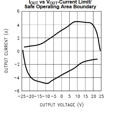

Hi
lets think about the figure 11 at the datasheet - attached
the current limit is 4amp up to 20V rail voltage - so with my 27(idle) or 25,3V i am for sure not in the "safe area". with the LM1875 or fake chip
if i calculate the 6R impedance at the TT with 30W i got 5 Amps...so for sure I am in the current limiter.
the temperature at the chip is about 48°C after this "Flamenco"....... is no problem
but now you = experts can explain/help me 😉😀

yep...the datasheet says :
Current limiter = at Vsupply -10V ...current limit is 4A...typical 3 A
that means 3App = 2,1 continuous current
i am little bit disappointed that i come so quick into this moment that the current limiter strikes in😀 it was not sooooo loud😀
...hmm... extra transistors?....😉

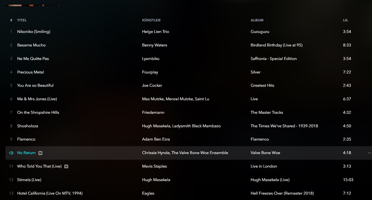

pic is my playlist

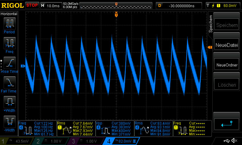

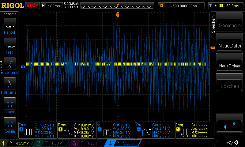

Hi
the kit is running some hours and i just checked the "performance" with the "flamenco title" i push 6 time the same track
2 times for the different voltage rails. 3 times for output and once for the input probe.
with the volume level 50 (instead 44). the speakers are 6R (venere1.5)
i cannot explain why i sea at the fake chip at the same title more voltage (38Vpp)at less volume level 44(not 50) now its "just" 35,4Vpp max.--> 26Watt at 6R
the voltage sag down to 25,1V at the heaviest rolls.
no clipping and sound level feels stressed but not at the end...
pic 1 output Rchannel
pic 2 input
chris

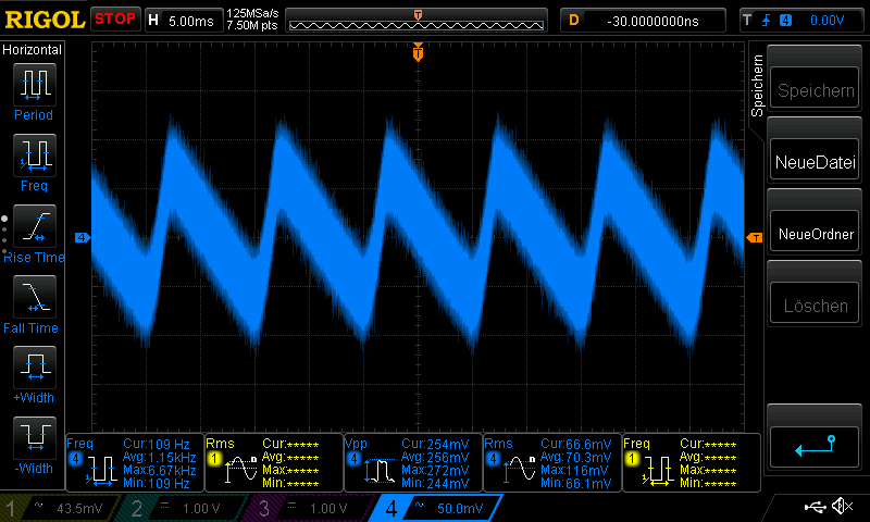

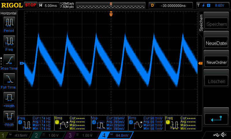

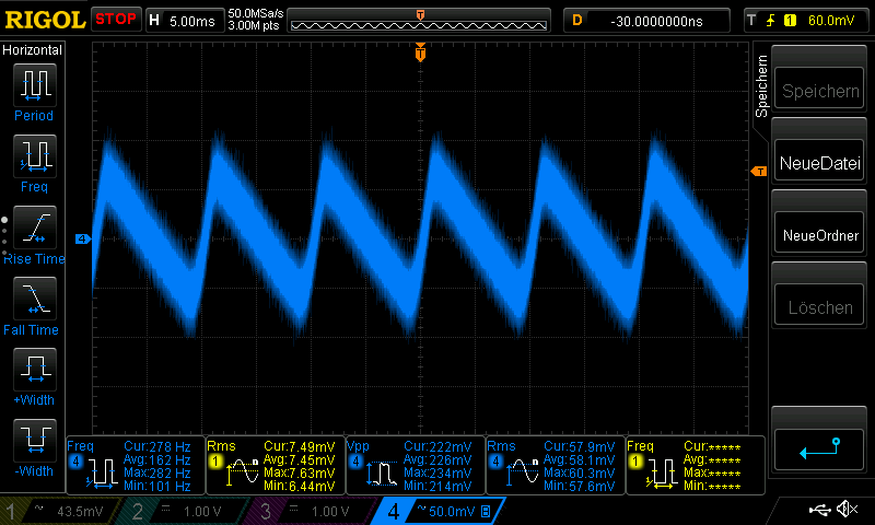

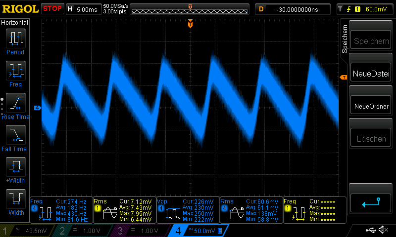

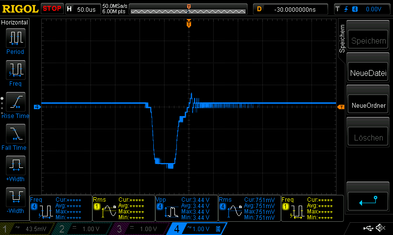

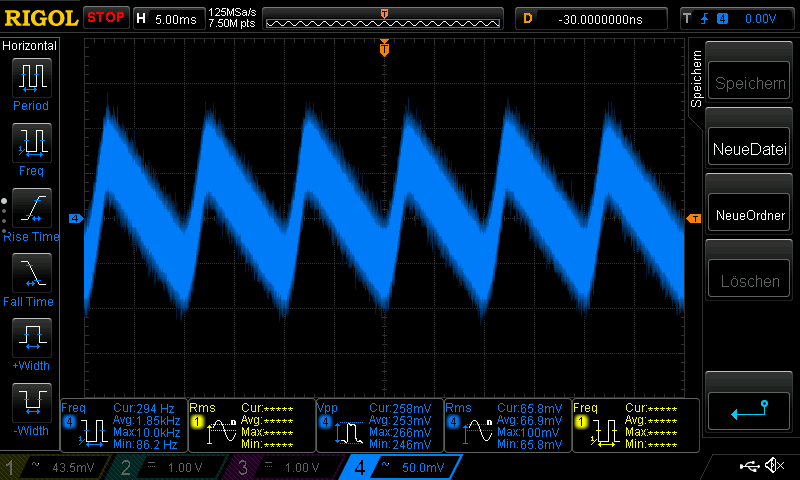

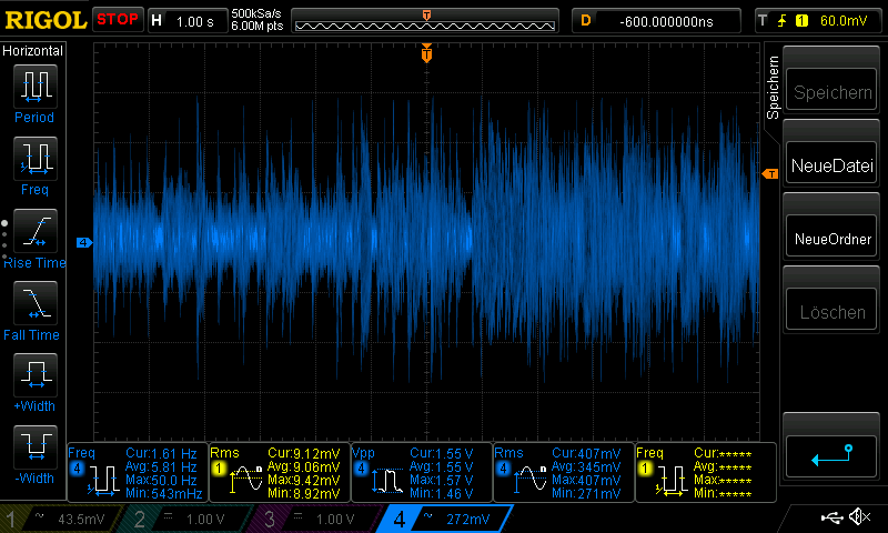

noise at the power supply
Hi
please can you give me ideas to get a better = lower ripple at my power supply. my idea is the get a better sound because of less ripple voltage at the rails
i read about some small caps at the bridge rectifier
and what about bleeder resistors at the cap bank or some foil caps?
amp on, complete connected but no signal
pic 1 ripple at the +V and -V after the rectifier
pic 2 ripple at the L channel +V and 0 at the cap bank
pic 3 ripple at the L channel -V and 0 at the cap bank
pic 4 L channel off pop 😱
thanks in advance
chris

Hi Chris,
A typical ripple-form for a non-regulated power supply. If you double the decoupling capacitance, you will have close to half the ripple but you can't just increase the capacitance without getting space problems and too much invested in capacitors.
It is a 100Hz ripple of a moderate amplitude. In-between recharge of the capacitors every 10ms, the capacitors provide the current and are discharged as you see. The curve is a bit blurred but with a sampling scope and high gain, my experience is that a blurred picture can be expected.
Rectifier capacitors and foil capacitors will only have a small effect on higher frequency ripple. Bleeder resistors serve to give a slight minimum-loading (which you already have from quiescent current) and more importantly quickly remove charge from the decoupling capacitors when you switch the amplifier off.
What to do then? Use regulators on the two rails. Then, you have considerably less ripple but only audiophiles like you can evaluate the improvement of the sound. Several volts of ripple can be an important issue, not your modest level.

Hi
i did a small modification in the morning on my bridged rectifier- a solder a 22nF ceramic caps at all pin (diodes) + i add a 220nF /250 X2 caps after the rectifier at +V and -V.
the results is not better...soundwise the same....should i pull that out?
chris
chris
Hi
chris
Hi Chris,
The small capacitors on the rectifier diodes may help the diodes switching off but they hardly change the sound. I never used such capacitors myself so I will let more competent people advise on "stay, or go".
10000uF is not a magical value. Theoretically - the more, the better. With the moderate prices for 10000uF, my advice is not to use too little or even some of more ordinary quality.
The off pop comes from when the amplifier gets starved for voltage during switch-off and looses regulation control. The bleeder resistors may not help on that. In the old days, a safety relay disconnected the speakers before the amplifier lost control.
NB: Always switch off the power amplifier before the pre-amplifier and source. Else, the pop comes via the input.
