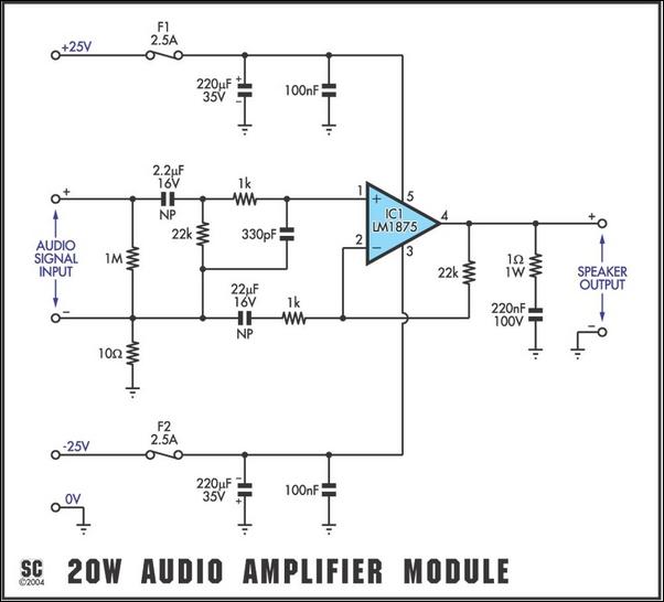

Hi Rabbitz
about the NFB cap i found something from a very good engineer an advise
LM1875 power supply
post #10
the 22uF NP in the feedback loop is far too small.
Try >=100uF. I would suggest 220uF.
post #16
with the low value feedback capacitor (DC blocker), that capacitor forms a high pass filter to roll off the bass response of the amplifier. This is a bad way to band limit an amplifier. Most reliable authors/designers warn against this practice. (it develops AC voltage across the electrolytic capacitor).
The DC blocker must be made large enough that any operating voltage across it is negligible.
post 18
The NFB DC blocker generally has a small DC voltage across it. A polar electrolytic must be oriented to match that small voltage offset.
If the amplifier fails catastrophically then a much larger offset can be applied to that electrolytic. This can be guarded against by adding inverse parallel connected diodes across the DC blocker cap.
If the electrolytic is sized appropriately then the AC voltage across it is very low. For the electrolytic to work as designed it does not hinder it's operation if the small DC + the small AC signal across it can have +ve or -ve values. But the instantaneous sum of voltage values must be kept small.
That is where the Passive Input Filter and the NFB DC blocker ratio of values comes into play.
On the other hand, where a Manufacturer fiddles with that cap value ratio to "adopt an in-house sound", then there is the possibility that the AC signal is no longer small. In this situation a non-polar electrolytic may be required to give reliable long term stability in performance.
post #23
The 22uF non-polar electrolytic can be replaced with a 150uF or 220uF polar electrolytic. A low voltage rating is OK here. Try 16Vdc or even 10Vdc. It should be quite small and cheap. But add those protective diodes across the cap pins.
chris

Chris
I refer to the 22uF 16V NP in the schematic.
Yes, I've seen up to 220uF in this location but it's hard to get a quality larger cap in there as 8mm diameter is the largest that will fit with sitting on the PCB.

I'm running this chip w/o the neg fdbk capacitor allowing response all the way to DC. So far, no problem meow. I would think C 2.2uf on the input would block any DC getting into it for further amplification.
That cap I can understand in the single supply version, but why its necessity with +/- supplies I fail. Personally, I dont want any electrolytic cap in my signal path... That's just purely from audiophile experience.
All caps have a "voice" and there can be practitioners who like the sound of ...polarized electrolytics conducting AC. If that's what someone likes, no point in challenging, but methinks the sound of a "wire" is better, for obvious reasons.

Hi Chris, are you about to construct a snubber to remove some of the higher frequency noise? I am not sure if you will succeed. It may be sampling noise from your scope or it may be too low impedance for you to remove it.
You say 200Hz. Isn't it 100Hz?
Ist 220hz After the crc bank
How does a CRC-bank change the ripple frequency from 100Hz to 220Hz? My guess is that your trigger level or scope time-base are set so that the scope shows 220Hz with a large spread.
Chris, look at the horizontal settings: first photo 10ms per division, second and third photos 5ms per division. First photo one division per signal period, second and third photos two divisions per signal period. The signal period is 10ms for all three photos, hence 100Hz.
