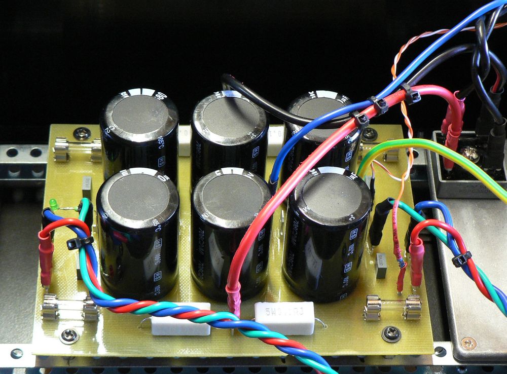

Hi Bare, Rabbitz, FF
i build caps bank with 10, 000µF per rail -i use that what i have at home
gold nichicon UFW 3300/50V
black panasonic FC 2x 2200µF/35V
blue panasonic FC 1x 3300µF/35V
i want to make a CRC filtering e.g.
3300 gold - 3x 1 R / 3W the 2x 2200 black +1x3300 blue
bleeder resistor between + and GND 2k2 1W ...and - and GND 2k2 1W
or is it better to use: CRC
3300 gold - 1x 2200 black - 3x 1 R / 3W the 1x 2200 black +1x3300 blue
or should i turn around. i mean the panasonic blue is faster an it should near the transformer??
pic 1 is my cap bank

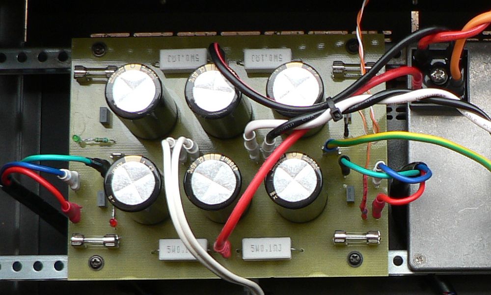

pic 2 is the actual planning in my housing - its getting tight 😀
thanks

Firstly ESP P72 recommends 2 x 4700uF for 2 channels and maximum of 2 x 10000uF.
The power supply that I have used successfully with AKSA 55N+, BAKSA, P101 and NXV200 uses 6 caps, 1 transformer and 1 bridge rectifier. For 50W amps I used 6 x 4700uF and for 100W amps I used 6 x 10000uF.
The +/- from the bridge rectifier goes to the centre 2 caps > 2 0R1 5W resistors each side of the centre caps > 2 caps each each end. Each end supplies 1 channel only so it acts like a pseudo dual mono supply. The transformer CT goes to the centre of the board as well as chassis ground and if required, speaker ground also connects to this point.
Disregard the by-pass caps as it was a trial and no bleed resistors were used but I did have LEDs on each rail.
Not my design but from a reputable source.
So what I am suggesting is use only 1 of those power supply boards, spin 90° and place in between the amp PCBs and midway between the transformer and amp PCBs. This way each side of the power supply goes to 1 channel directly. Using your existing caps, use FW on the outsides (4 caps) and FC on the inside (2 caps).

I wonder what the 5w resistors are for? I haven’t got these in my setup.

Hi Rabbitz
i just joking 😀... i rectifier and 1 cap bank is enough 😉😀
sorry for that....
your pcb is interesting...so i understand that its in the middle there is the "source" /center = first caps in the middle (cap No.2) and to every side the R 0R1 5W and the the next cap...
but
this comment ....i do not understand...FW on the outsides (4 caps) and FC on the inside ....sorry
chris
Looking nice Rabbitz!
/Kurt
with the caps -resistor - caps you build a CRC "Filter" - to get the ripple voltage of the supply down ...
