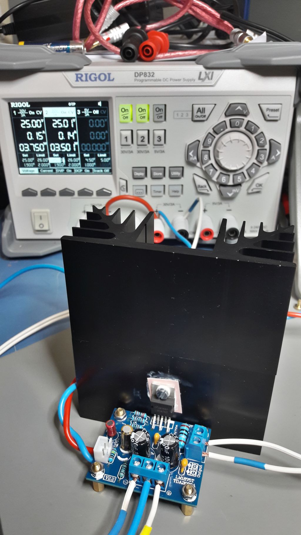

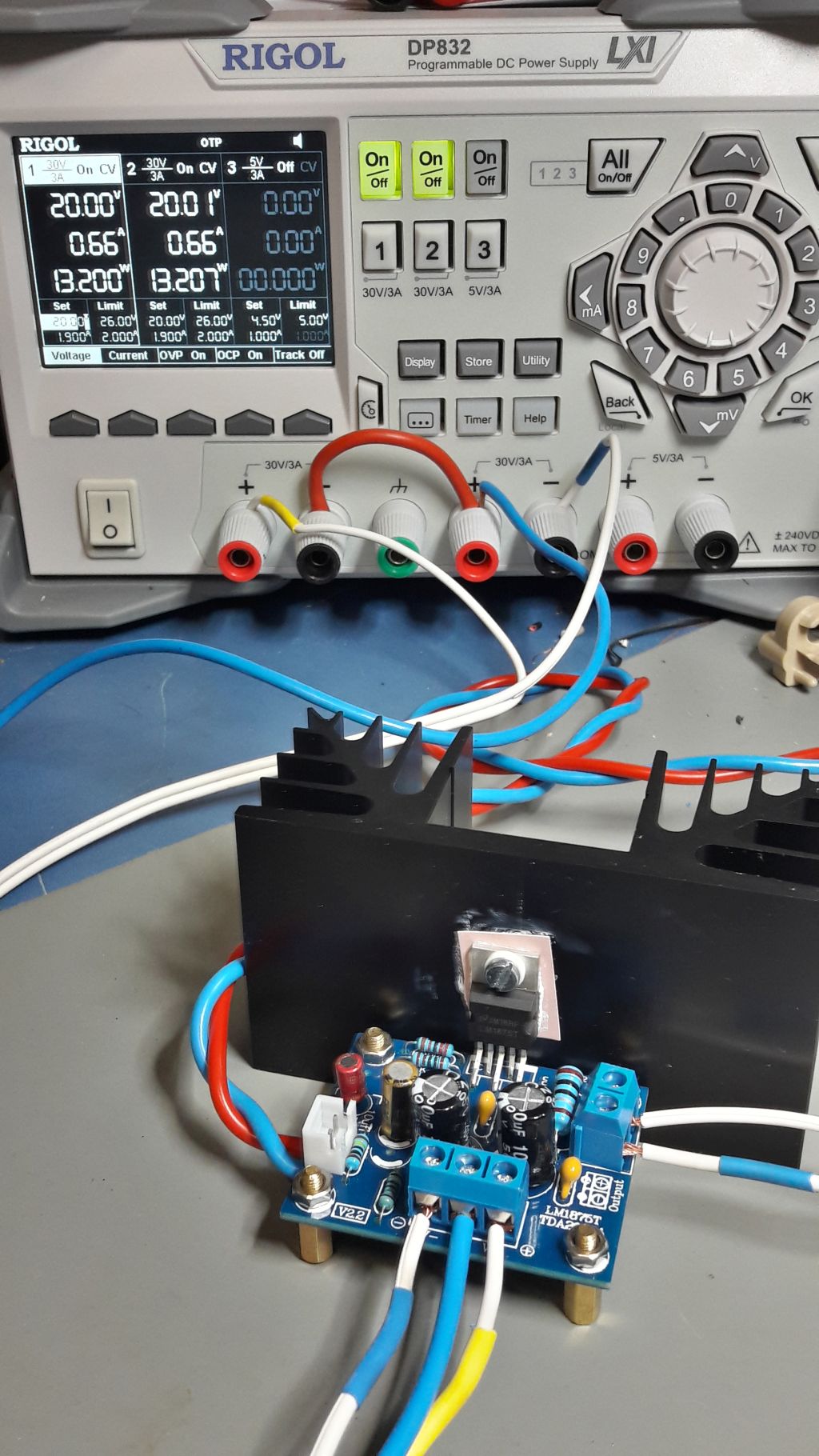

hi
i am impatient...i did it!😀
i set the chip on 20V rail and it worked fine. so now its a TDA2040.
correct?
i let the amp run on its clipping border = 500mVrms with my sweep 5 minutes at 8R and its survived. the chip has 59°C then i stopped and cooled with fan.
pic 1 is the consumption during 500mVrms 1khz on 8R
pic 2 is the scope probe ...its about 11,1V rms = 15,5 Watt

Without magic smoke there is no glory 😀😀😀
I have used mine with +/- 20V and without problems 😉

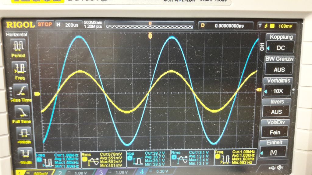

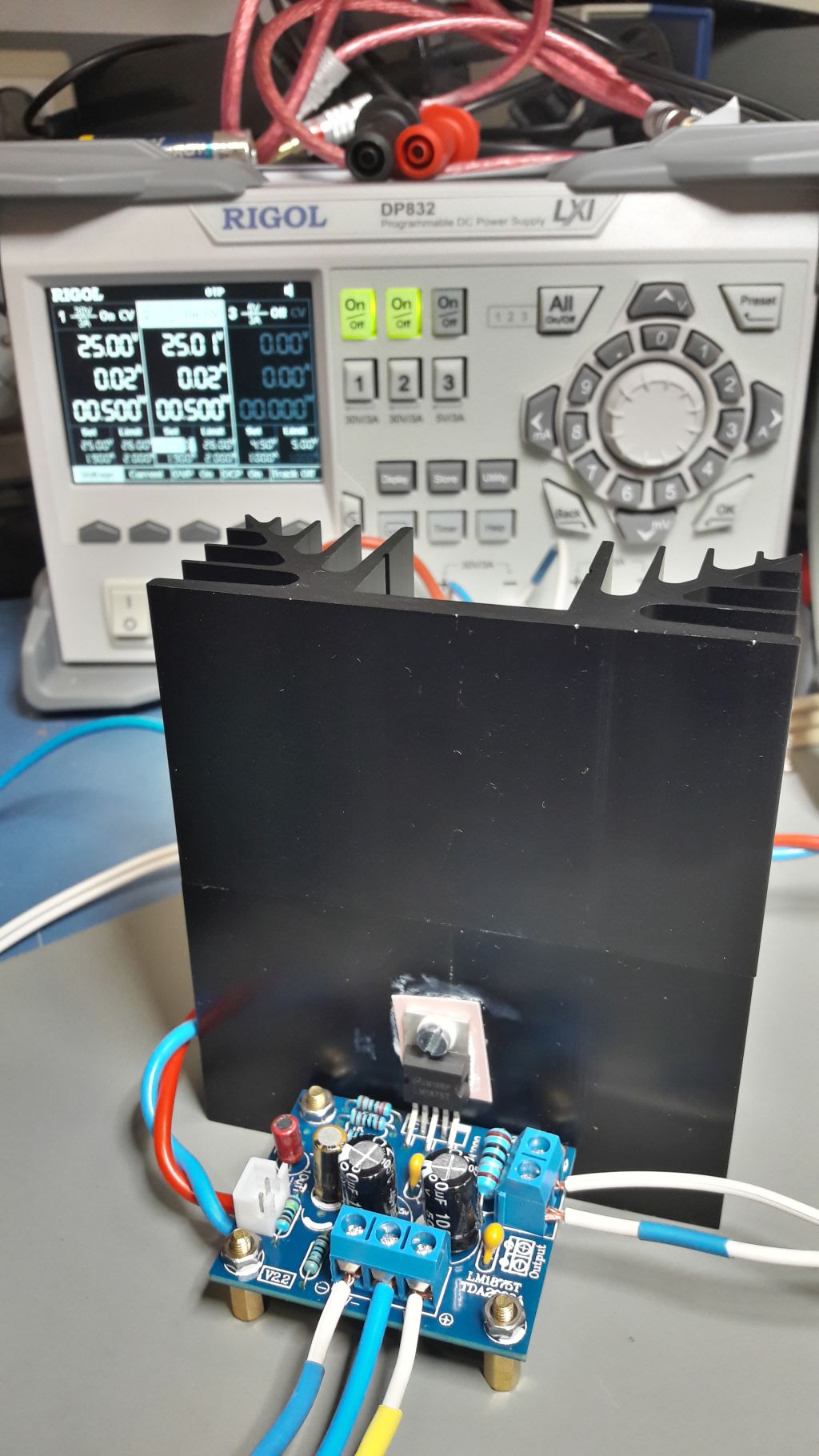

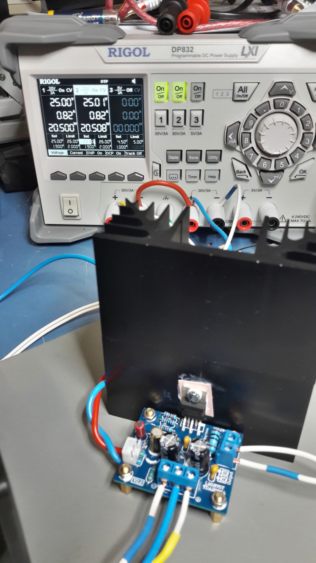

25V rail ... no smoke
Hi
i did it !....25V per rail and no smoke
pic 1 idle
pic 2 +3 1khz with 100mVrms at 8R
pic 4+5 1khz with 600mVrms at 8R near clipping
13,1 Vrms on the scope give me 21,4Watt at 8R calculated...
so my chip is fine 😎

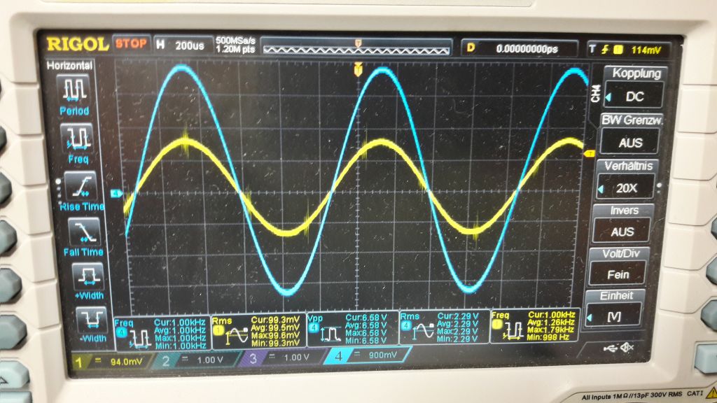

Hi again
so 4 hours test of the fake...i will say tda2050is done. 70mVrms input with my sweep let the chip run at 40°C with this heat sink configuration.
additionally to this i let this chip run at 5 minutes full power= 600mVrms sweep , 25V rail and 8R load. its about 13,5Vrms = 22,7Watt calculated.
the chip gets after 2 min about 73 °C then its stable up to 5 min...then i cooled it with fan.

error in post 120
pic 4+5 are with 1450mVrms 1khz into 8R - before clipping = its about 12Watt rms
typo !!!
pic 4+5 are with 450mVrms 1khz into 8R - before clipping = its about 12Watt rms

i did a 6 hours test with my aliexpress kit with 100mVrms sweep , 25Vrail 8R load ....its about 2,3Vrms output....0,7Watt......the chip gets stable with 46°C all the time....so for me this fake is a TDA2050.
now i test the second ali kit (from my son) and it worked with 25V per rail too.🙂
test is ongoing.....running at 46°C stable...
DC offset is 0,1mV !!!
