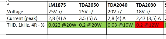

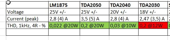

for me the main porblem is the recommended max. voltage what the chip can handle.
LM1875 +/- 25V (max +/-30V)
TDA2030 +/- 18V
so if we plan to use 18 -0 -18V AV transformer we will get about 18*1,41 = 25V without load und under load less - but too much for the LM1875 fake = TDA2030...so first test the chip
so i hope we get a TDA2050 😀

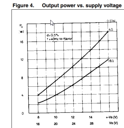

For other hand, in the TDA2030 data sheet you can see a maximum power of around 15W with a +/- 16Vdc power supply... if I´m understanding the graph correctly. 😱
º
Hi
You have to look at the figure 4 graph its about 0,5% distortion. figure 5 is about 10% distortion...nobody want to hear this 😀
16V at 8R impedance gives 12WATT
16V 4R impedance gives 18W
so yes this is the max voltage for that chip.

i am thinking about the Id graph TDA2030 Figure 12, TDA2050 figure 14. the current graph at 16V has not a big difference....but i am not really sure.

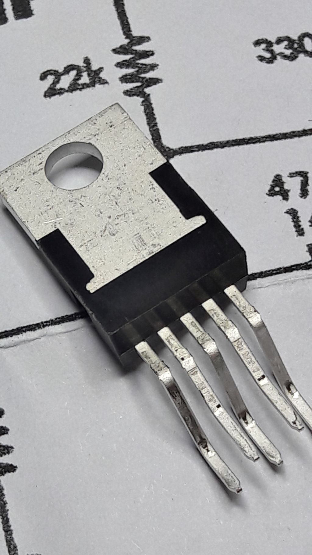

the LM1875 is without slites on the side. another pic shows a 1875 with broken leg. this is without slite on the side.

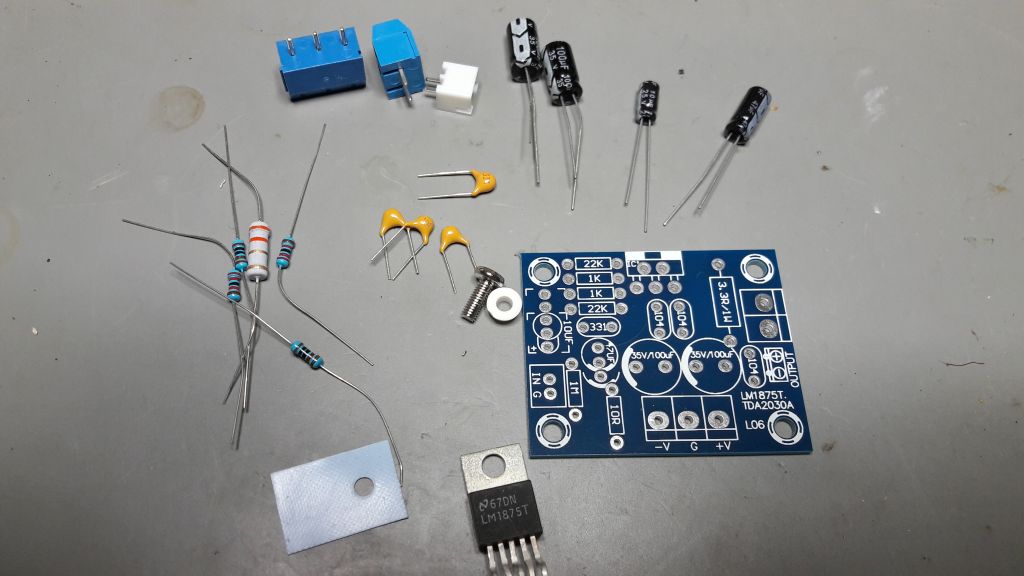

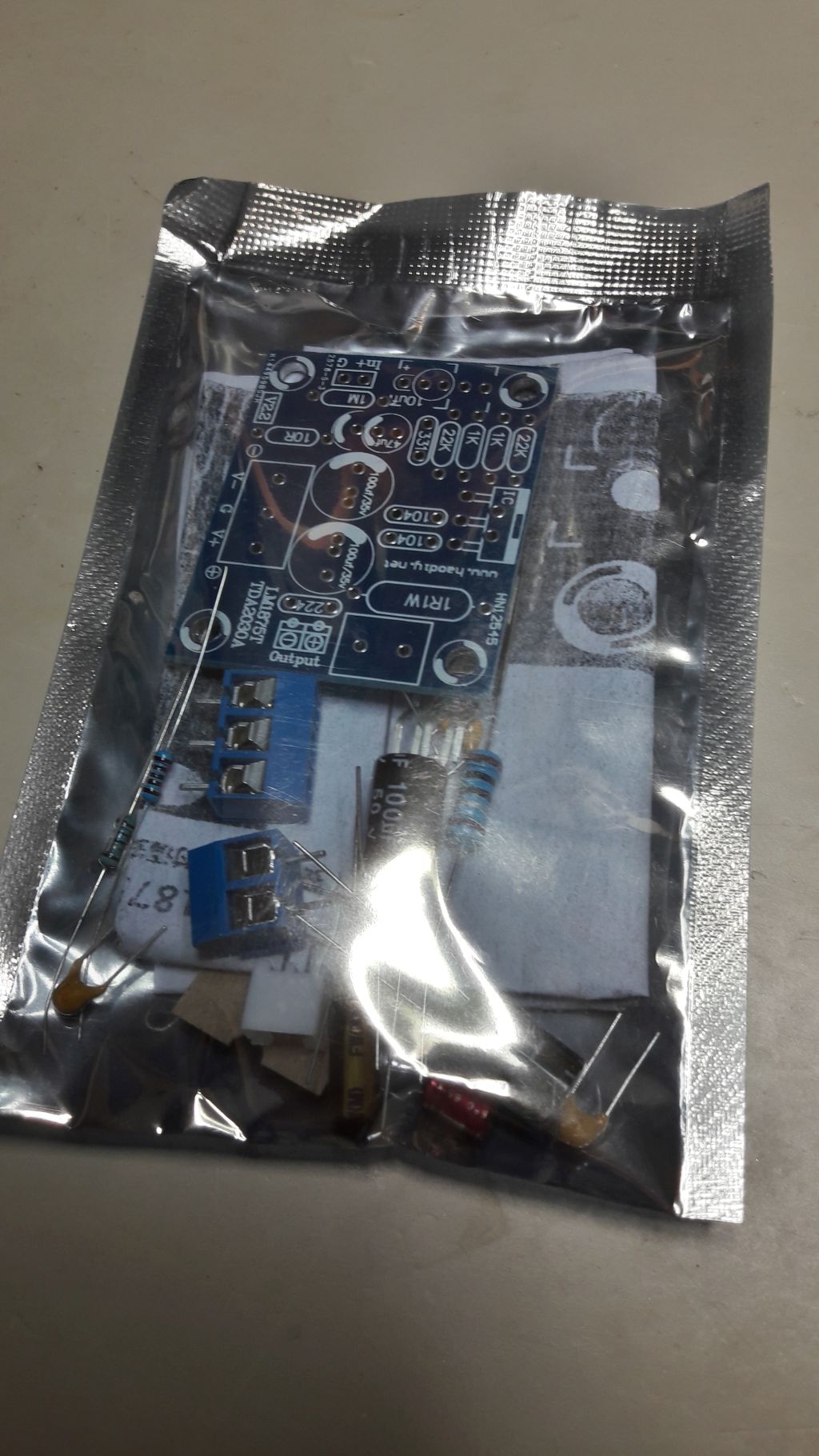

kit from aliexpress...TDA20xx
Hi

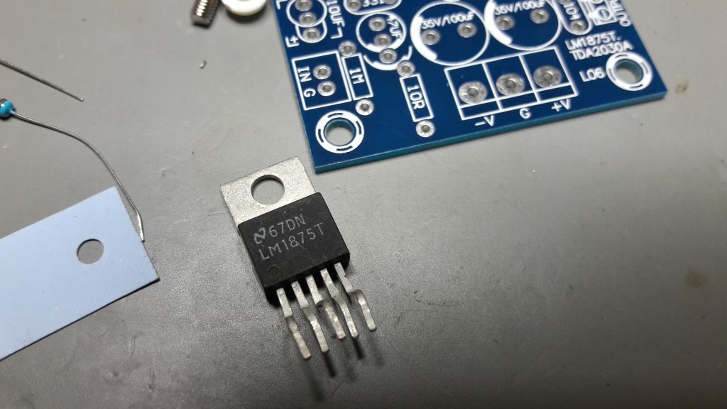

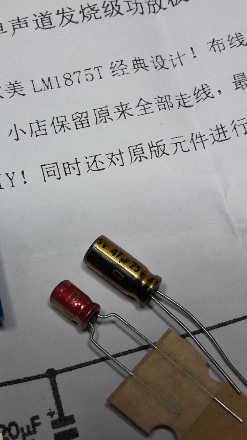

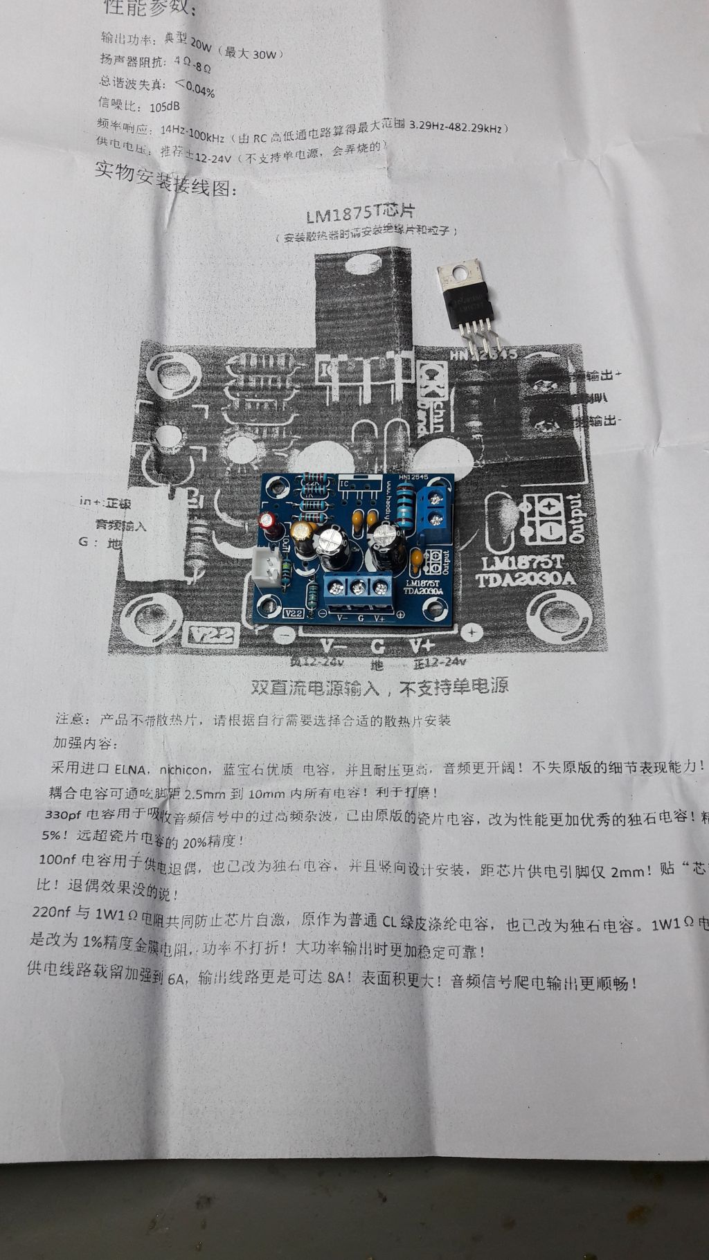

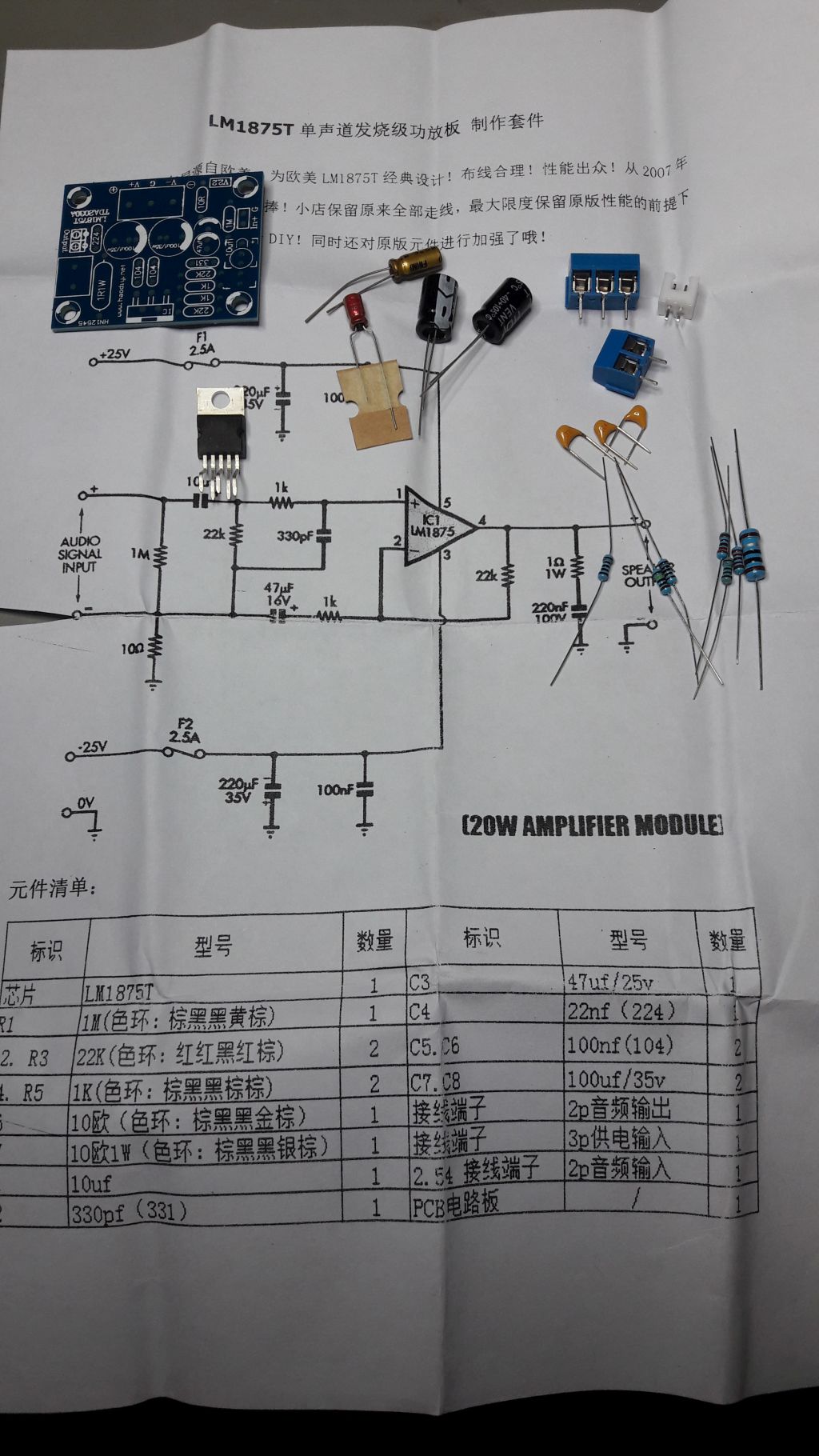

additionally i ordered some kit from aliexpress.
the LM1875 is a fake = it has the slites on the side, this kit is complete and use elna 10µ cap (the small red) and the nichicon gold 47µF😉😀. no screw or isolator for the chip is included. the paper shows 2 pages. 1 is the schematic the other side is chinese with some hints i guess.
i soldered all components except the chip TD20xx. this week i plan to test the ali kit to be sure which chip i got 😀

Exactly Chris, I bought 4 of those kits on eBay. They come with the same components, instructions, package ... that you describe.
It will be interesting to read your impressions.
In my case, the only thing I have replaced in two amps with components purchased from an official distributor have been the 220uF capacitors (Nichicon KW).

Hi Jose
yes you are right the caps are 100µF/50V at this kit. should be 220µF.
i will try this configuration.

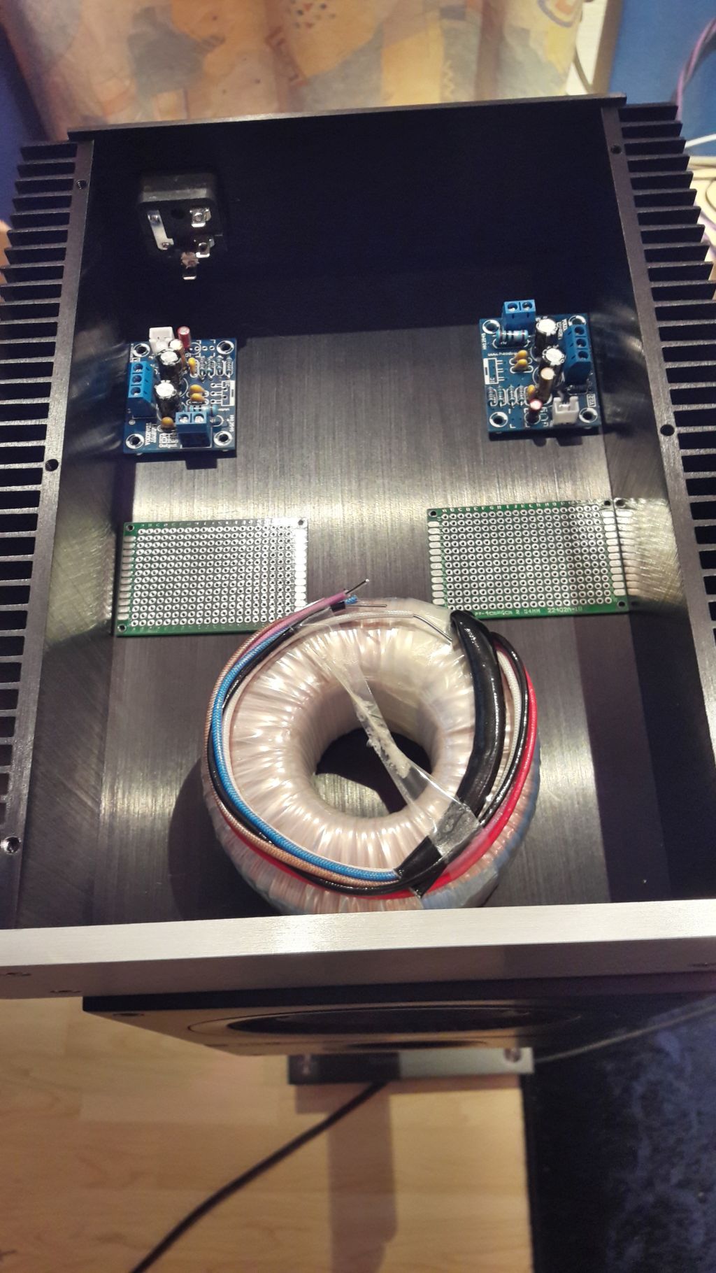

cost of houding increase...
Hi
as i posted in #96 my plan was to use a "better, bigger" little bit more expensive housing. i decided to ordered 2 cases.....other projects are waiting for some housing too..😀
now i get a letter and i have to pay extra taxes. 27,01Euro. 2 cases with delivery 86,46.....so one housing cost about 58 Euro 🙄...i love to live in Europe 🙁
chris
Thanks rabbitz for sharing your experience..
i re checked the housing and other parts:
at Aliexpress - -"my" preferred housing cost about 47 € with shipping.
Douk Audio Amplifier Chassis General Aluminum Shell Pre Amp Enclosure DIY Box-in Amplifier from Consumer Electronics on Aliexpress.com | Alibaba Group
the other housing - Galaxy Maggiorato GX288 230 x 280 mm + delivery cost me 34 euro +
i have to buy a power socket with fuse with 4,4 euro +
%product-title% kaufen
i have to buy 2 x 2,5 C/W heatsink with about 2x5,5 euros..... - max high 50mm.
.so the price is nearly the same for me.
the 50VA is about 26 euro- 80VAis 33 €
the 120VA transformer. cost 35 €
-->......the housing and the 120VA/2x18V is ordered😉

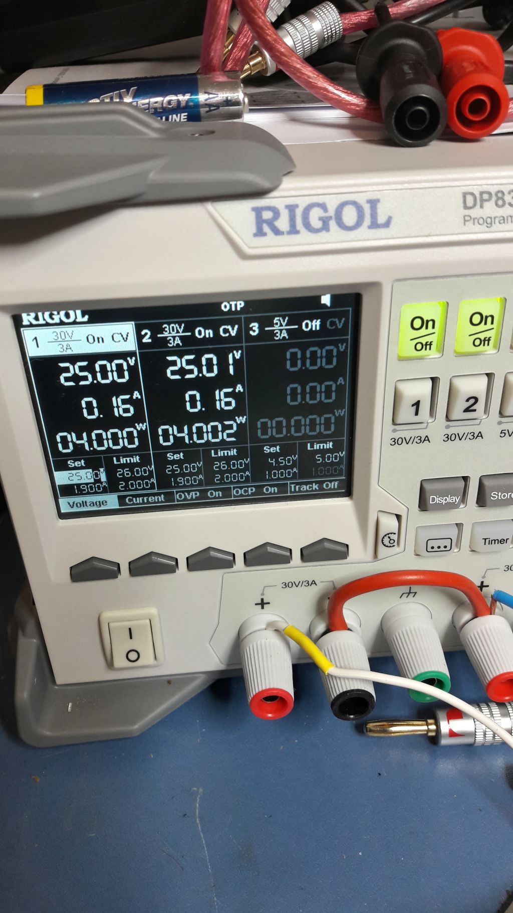

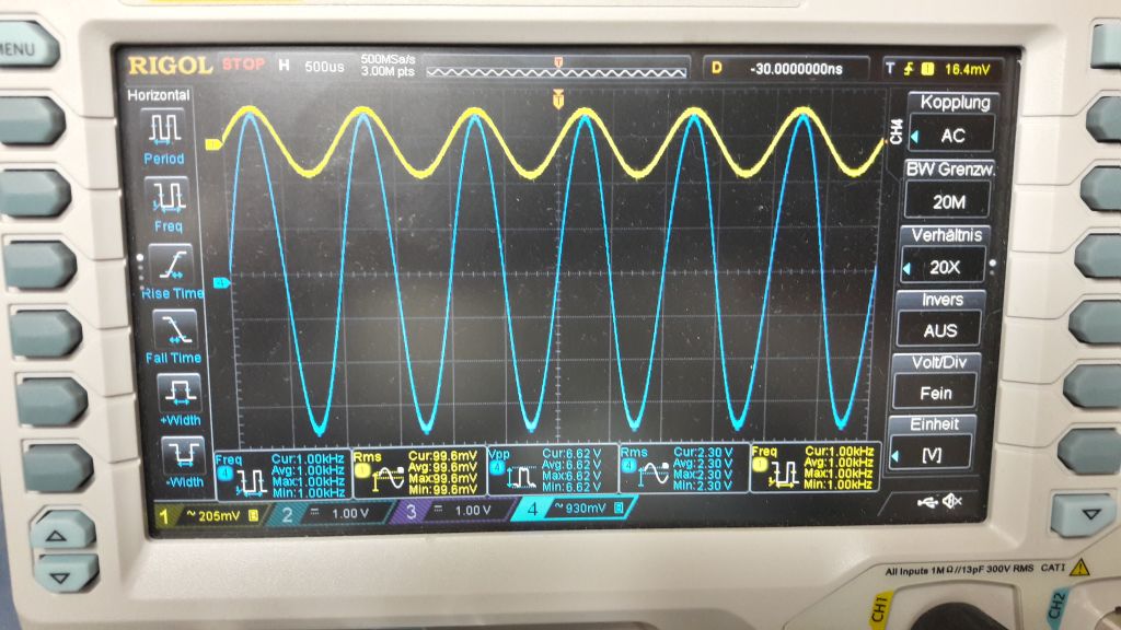

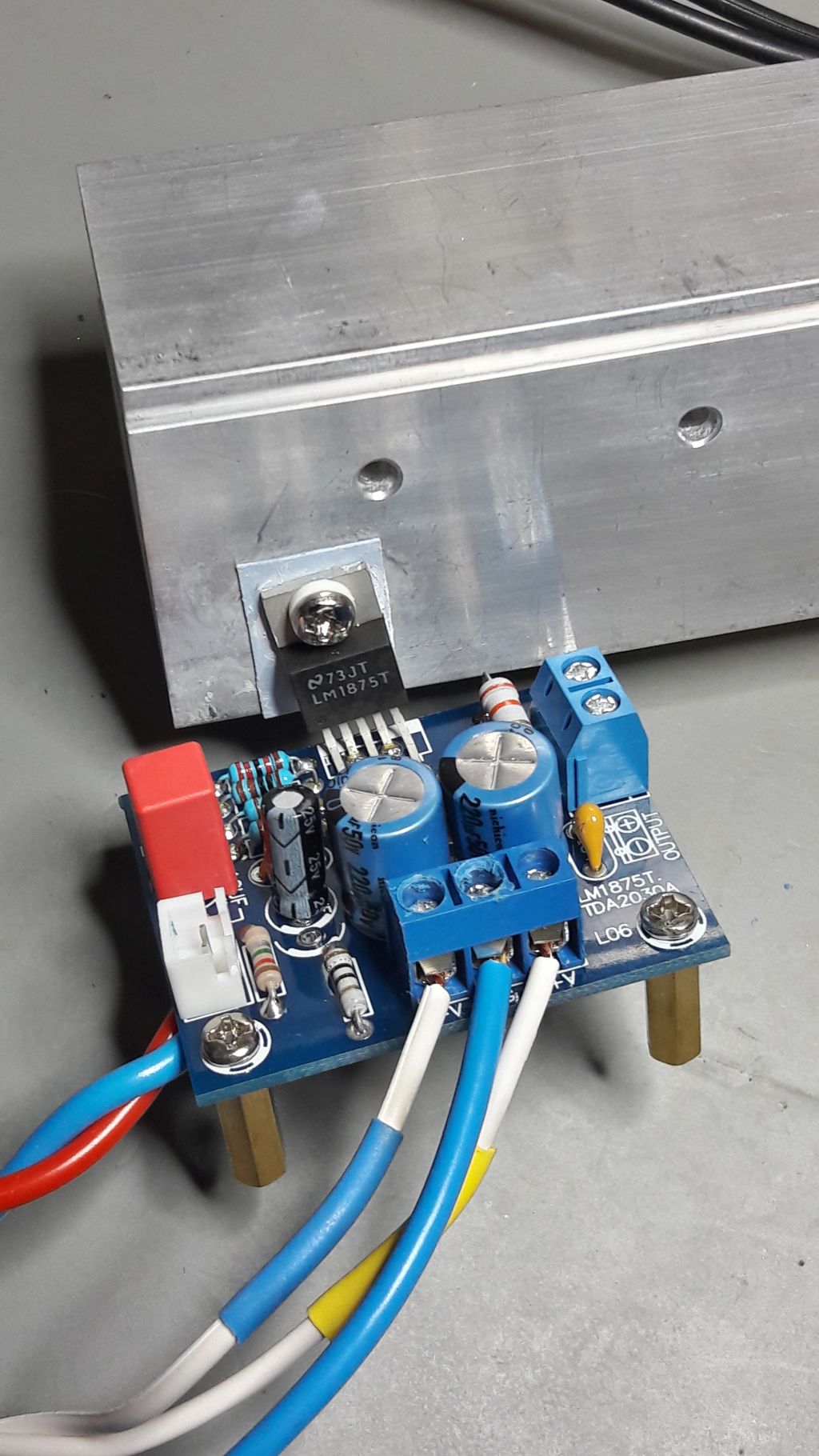

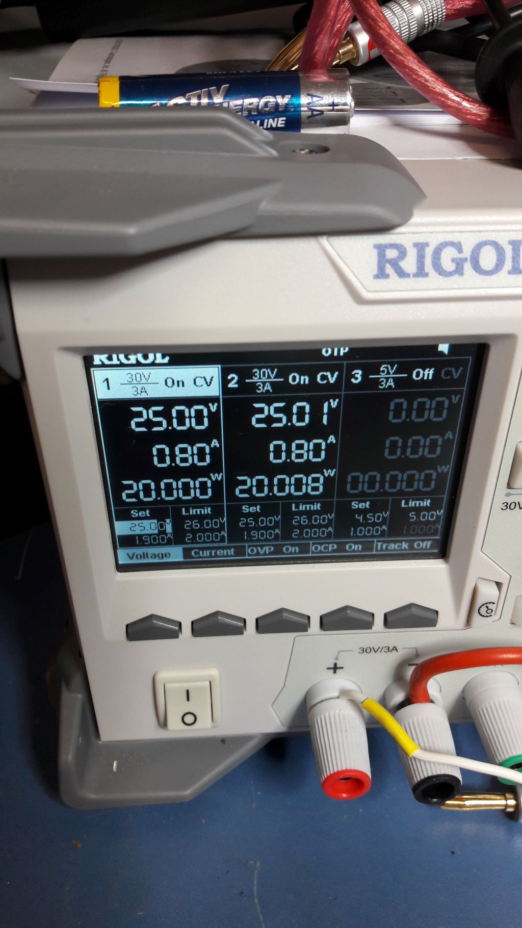

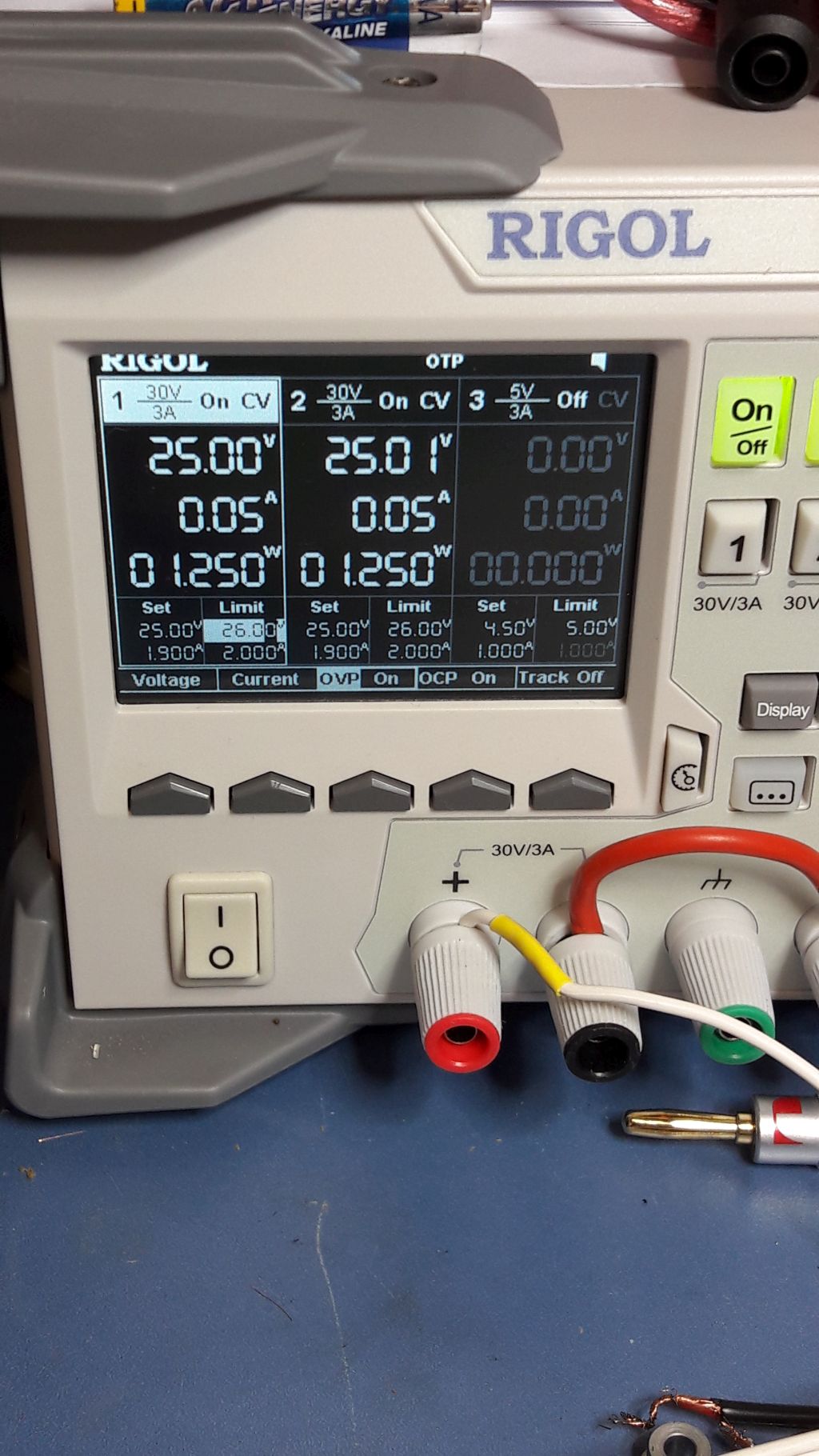

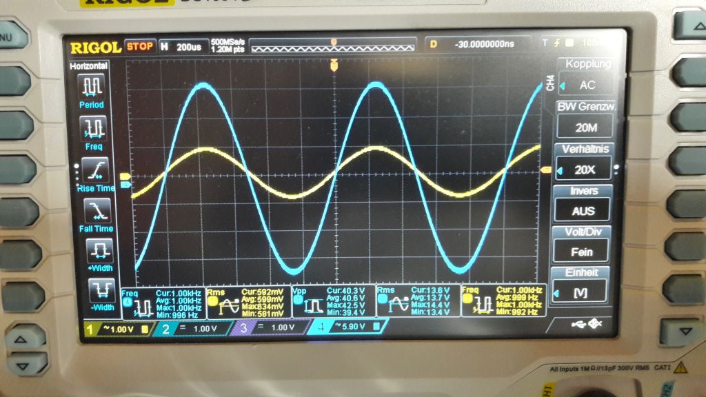

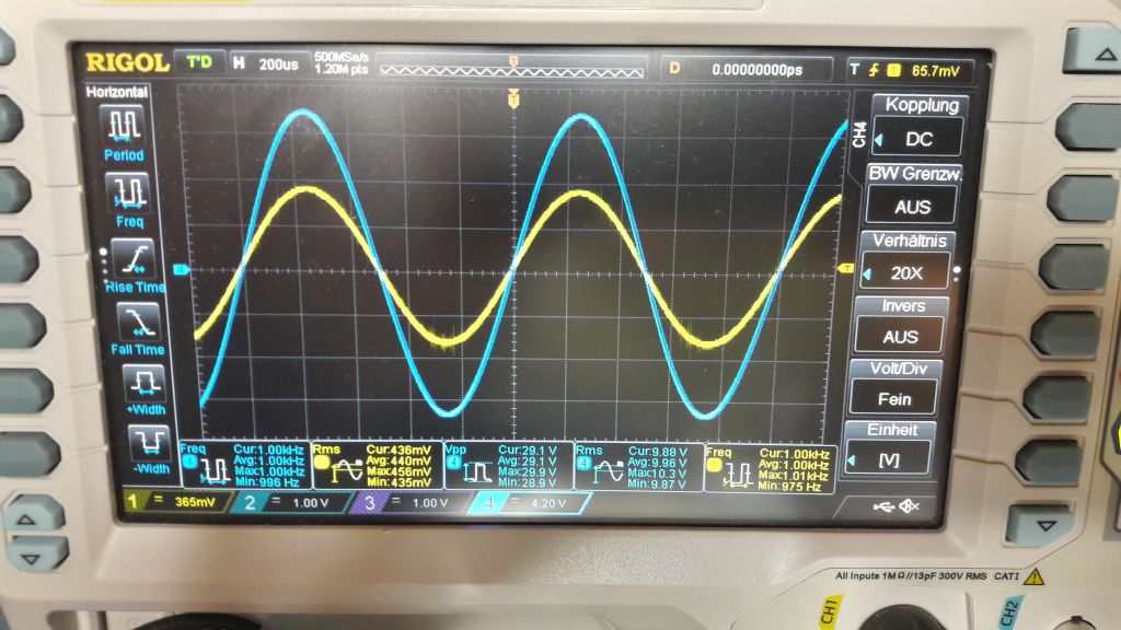

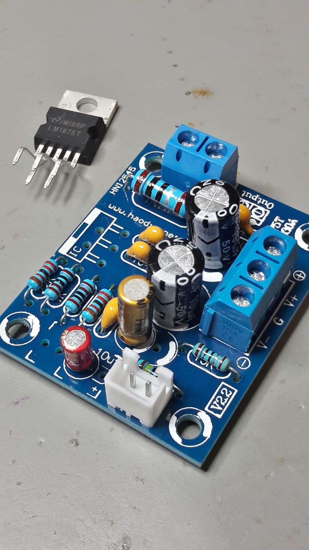

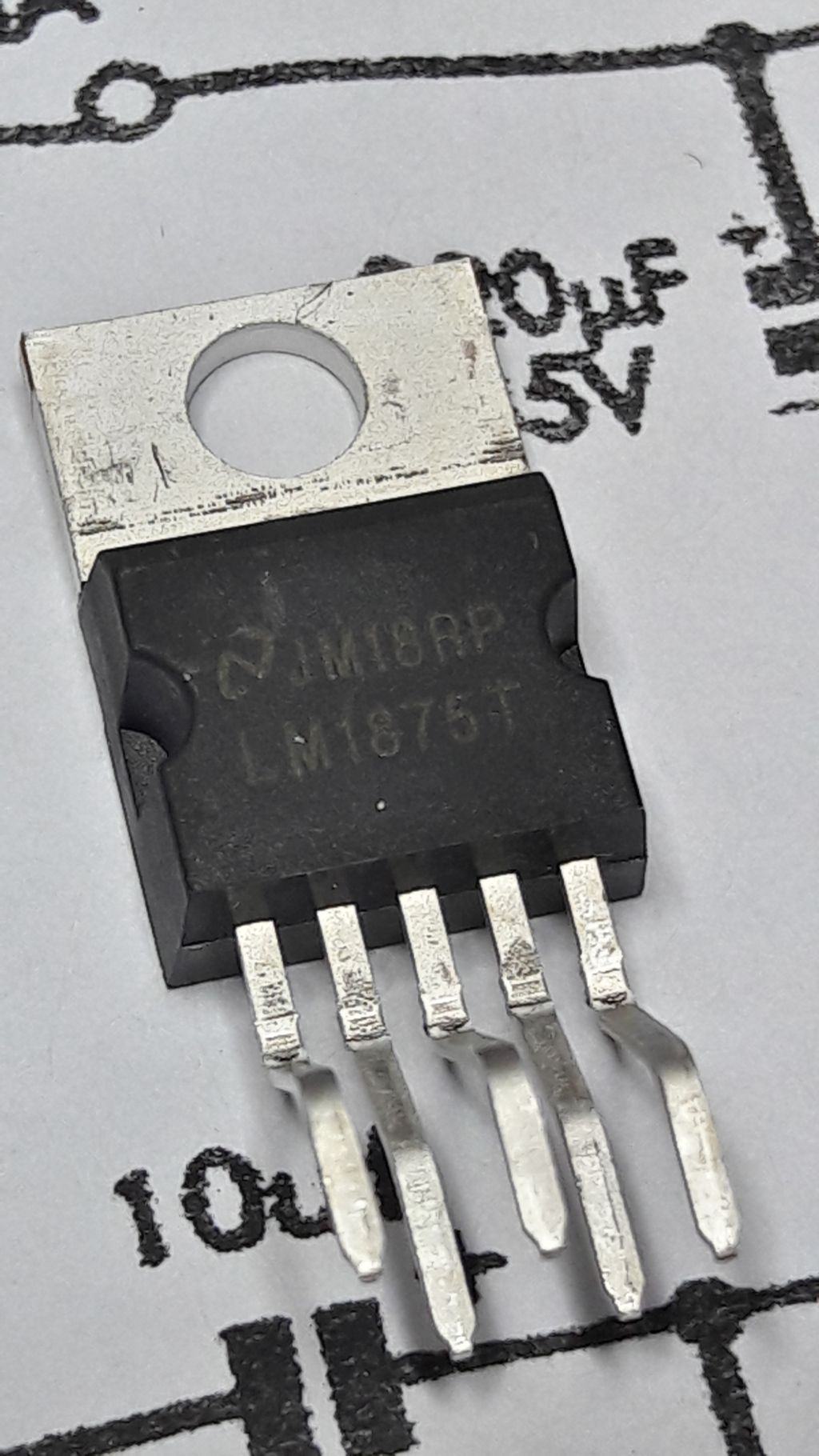

First measurment from amazon kit
Hi
as i wrote a bought the kits at 2 different sellers. first is amazon (they forgot some resistors)the caps are as john audio tech show us. and but the lm1875 look optical good = no slits on the side...5 euro
https://www.amazon.de/gp/product/B0796QV12M/ref=ppx_yo_dt_b_asin_title_o00_s00?ie=UTF8&psc=1
i mounted the kit on a small and long heatsink and start my first test at my lab supply. 12-0-12V without fire and burning so i use +/-25V per rail.
pic 1 idle consumption at +/-25V per rail - no signal, no load
25V / 0,05mA = 1,25Watt per rail
temp after playing around was 28°C and DC offset 3,6mV
after 20min amp on (no signal , no load) i get 32°C on the chip and 3,8mV DC offset
pic 2 my board...the heat sink should be stabilized😛
pic 3 sine wave at the scope-yellow in, blue with diff probe output
pic 4 100mVrms 1khz - consumption 4 Watts per rail - output is about 0,67Watt at 8R load
pic 5 is consumption per rail = 20Watt/25V
pic 6 is the scope with 600mVrms 1kHz and 8R load before clipping
so this chip looks real - maybe used but real 1875?

In the "fake" chips the offset is usually about 3mVdc but they do not get so hot.
By appearance, they seem original.

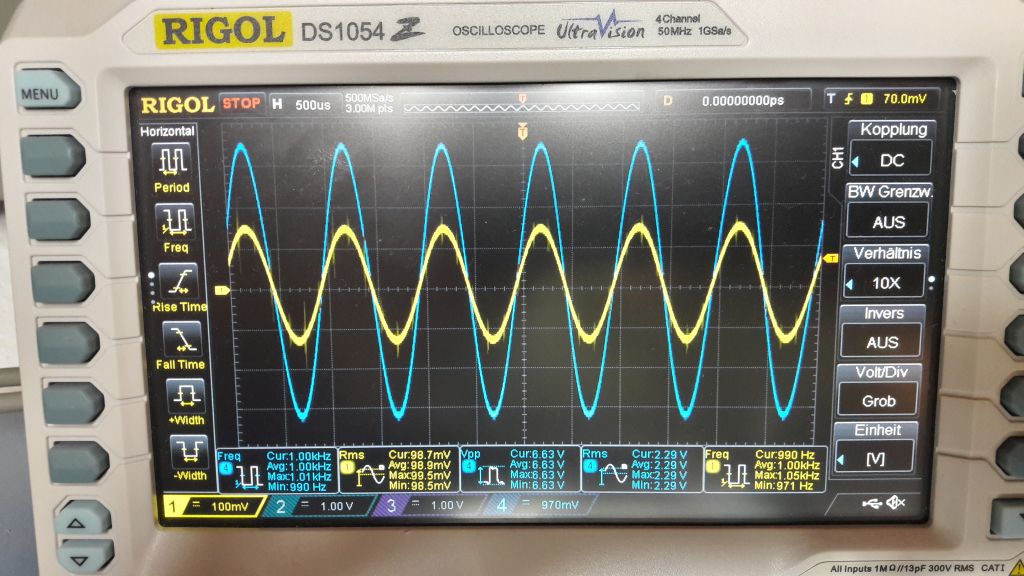

aliexpress test

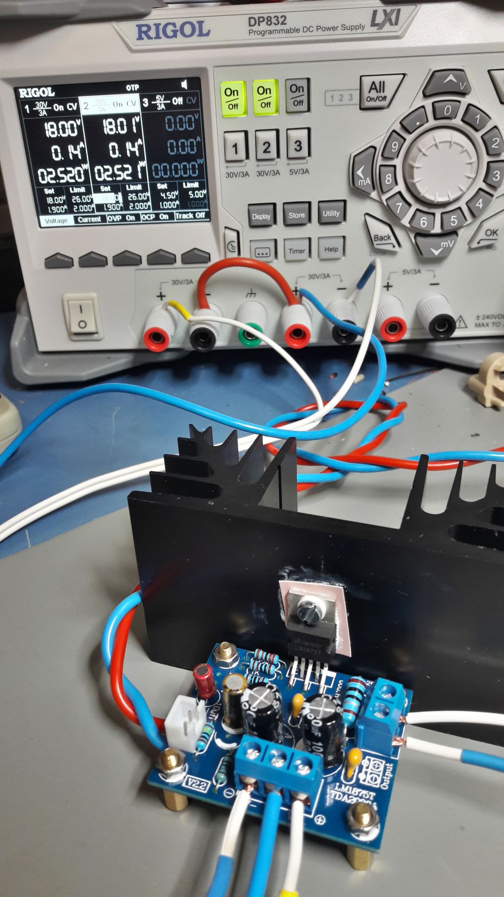

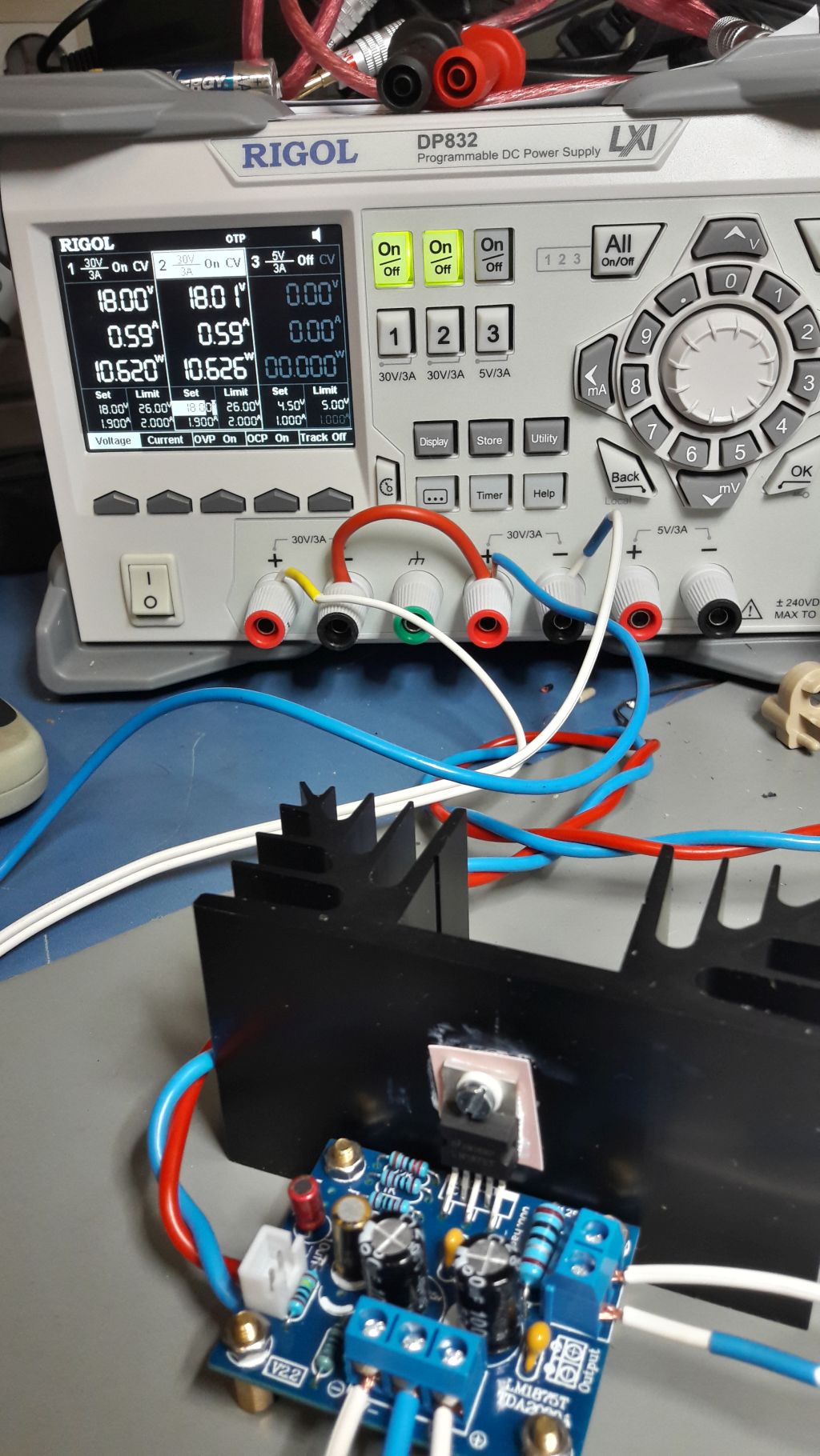

Hi

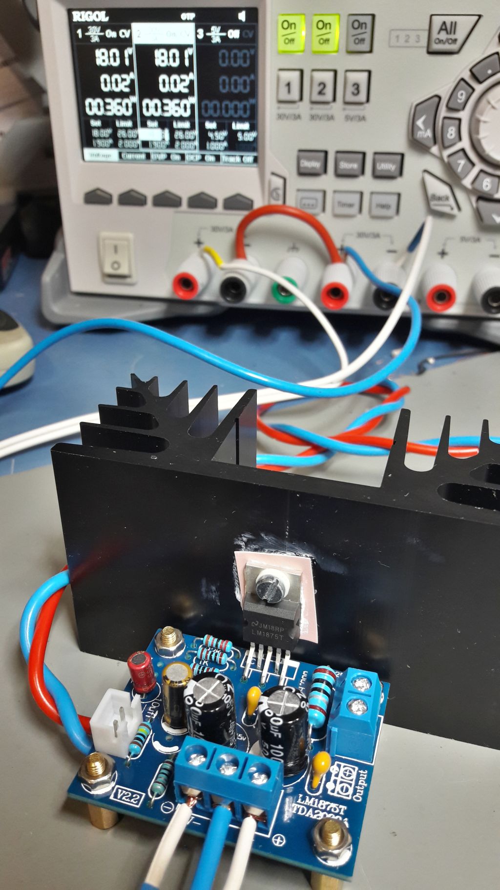

i mount the kit with the fake LM1875 (slits in the side) on a heat sink in my lab - its about 1,5K/W 5,5 euro
i guess its a TDA2030 so i used max 18V per rail.
DC offset is at -1,3mV
pic 1 is idle consumption
pic 2+3 are with 100mVrms 1khz into 8R
pic 4+5 are with 1450mVrms 1khz into 8R - before clipping = its about 12Watt rms
actually the chip is running at max power with my sweep 10hz-35khz...15 minutes and its about 46°C with this heat sink ......so there could be some room for more.
how can i check if this chip is e.g. tda2050 without damaging??? just go up with the rail voltage and pray 😀
chris
