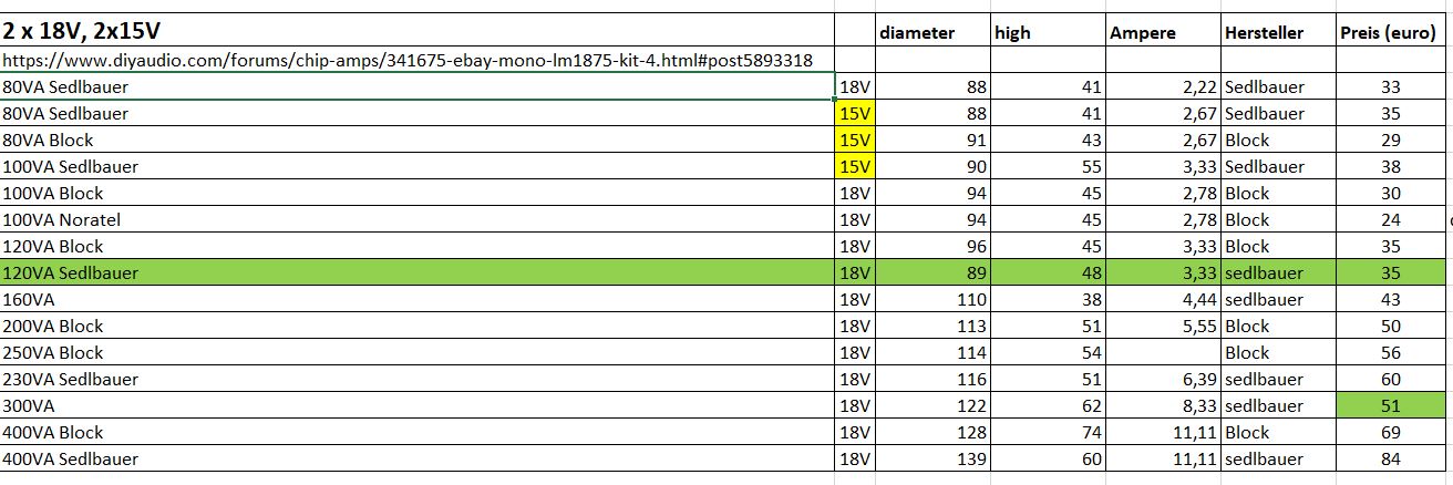

Thanks to bare´s input about the transformer i recheck the 80VA or 100VA .
yes they are smaller:
sedlbauer toriodal transformers check at conrad-eelctronic and aliexpress...ali is not cheaper
80VA diam. 88mm high 41mm cost about 33 euro
120VA diam. 89mm high 48 mm cost about 35 euro
160VA diam. 110mm high 38mm cost about 43 euro
in my housing the high is not an issue but every mm i can save its good to have more space - so a good trani is 120VA version.
the producer BLOCK/noratel make the tranis compared to the sedlbauer always bigger in diameter
chris

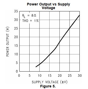

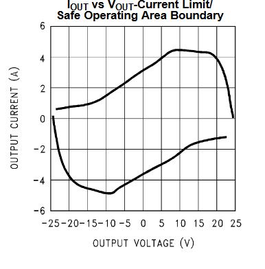

now 🙄 i looked at a very important figure in the datasheet. the max Vout and the relation with the current limit - Figure 11 page 5.
now for me its more clear what you mean 😉😀

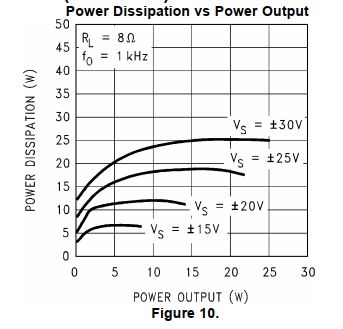

the idea why some guys use a "just" 15VAC output voltage. 15 *1,4 = 21Vdc. so i interpret the diagram that the current limit is kick in about 18-19V.
to avoid the max power on the chip at 4R impedance the trani could be 15*3amp => 45 - 60VA
correct?

Yesss 21v is safer but the chip will happily accept 24v.
I wouldn't lose sleep over it... a 'real' chip is well made /capable and even in the v unlikely event of it's death.. only 4$.
Less than a decent Beer.
