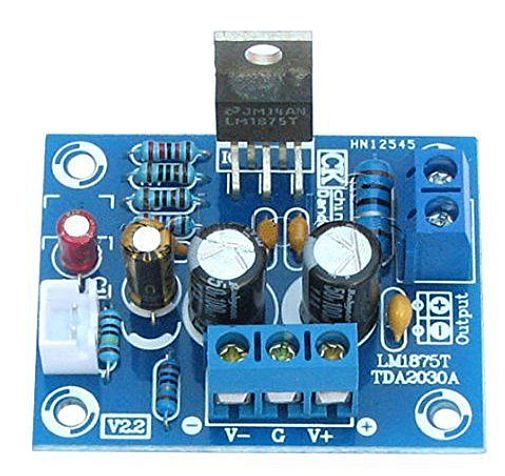

eBay mono LM1875 kit
Hi Chris
I generally agree with your advice about the 25V POWERAMP LM1875 PSU, but my question was about the quality of the 15V PREAMP PSU-addition shown at LM1875_20W_diy_haoDIY.
Is that PSU-addition (used for powering a preamp) ok for hifi?
Ahh...sorry....i overread this.
generally a voltage stabilizer with zener diode is the simplest way to reduce 25V-15V. resistor and zender diode are"noisy" . so for a pre amp its important to use a very low noise psu. usage of a linear regulator + 7815 / -7915 minimum setup.
its needed to know how much current/power your preamp needs and with some margin you can search for a low noise/ultra low noise regulator (TPS7A4700)which can handle your current and the peaks.
chris
Yes, forget about that pre amp supply in the link and as mentioned above use a 781x / 791x depending on what output voltage you are after. Better still is the 317 / 337.
Have a look at ESP P05 (all versions). You can take off DC from the 25V rails from the amplifier supply so you don't need the rectifier diodes.

I had the feeling, there were more to it than just 2 zener-diodes.
Think I'll go for Rabbitz's advice with the ESP P05.
For reference the 15V linear PSU is not for a preamp but for powering an active crossover for the chipamps.

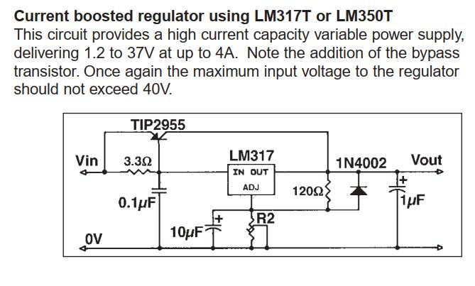

I'm surprised you are using a regulated power supply as I just use a standard linear supply. They will get hot as I think the 337/317 are good for up to 1.5A unless used with a bypass transistor (never built one).

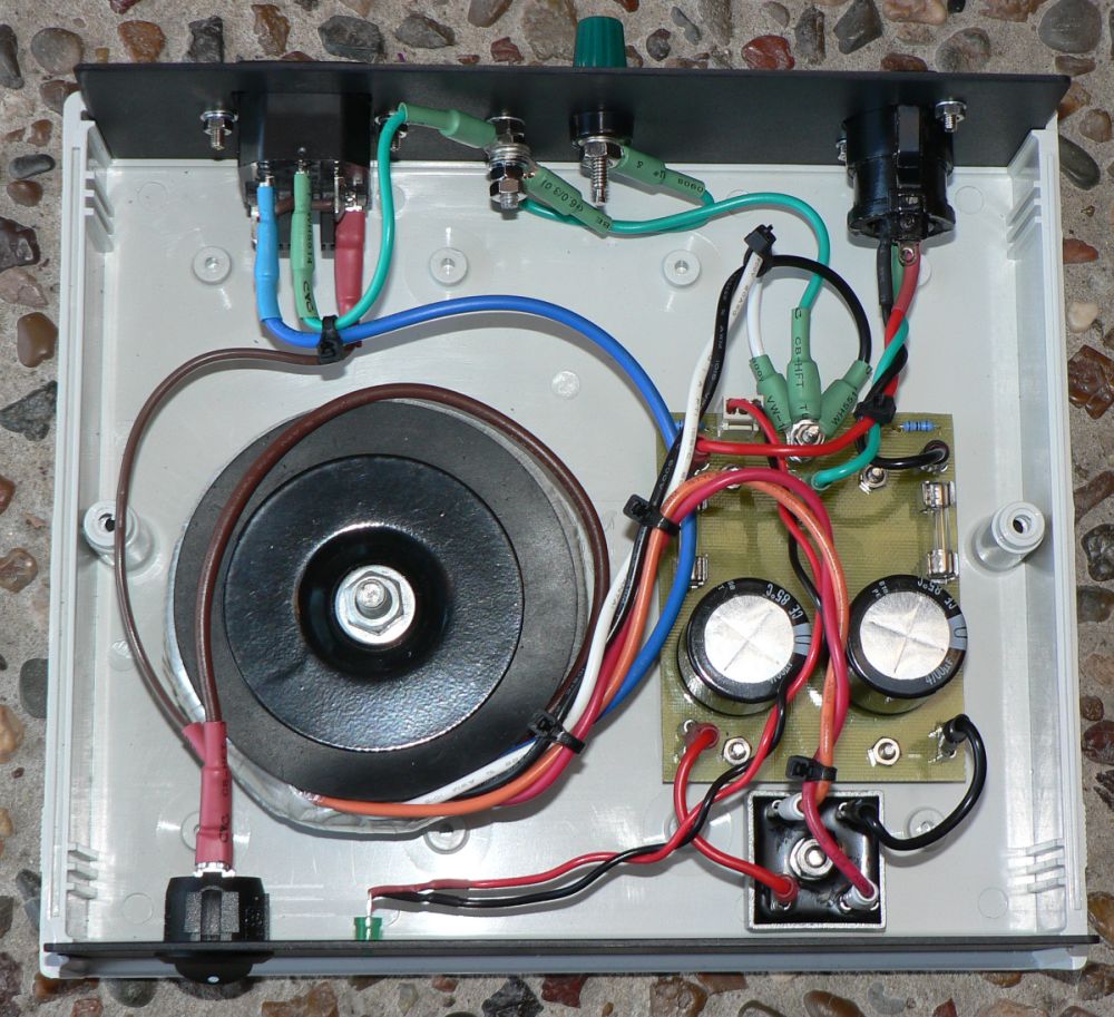

The pic shows the power supply I will be using on my build for when I finally receive the amp kit.
240V in through a IEC socket with fuse holder (1A slow blow.... 2A for 115V) > 6A switch for active wire only > 50VA 18-0-18 transformer > 35A bridge rectifier (10A would do) > power supply board with ground connected to mains earth > 3 pin XLR connector > umbilical cord to power amp with all wiring 7.5A.
The power supply board has the 2 inputs (+/-) from the bridge rectifier followed by two 4700uF 50V capacitors. Fuses (1.6A fast blow) are on each rail which then go to the output supply wiring to the XLR. The transformer centre tap is connected to the PCB at the output end with a machine screw and is wired to the earth connection. The ground is then connected to the output wiring XLR. There are 2 resistors on the output side of the board and these are for 2 LEDs with one for each rail. One is for the power board so I know power is on and the other for the front panel LED. All connections are via 6.4mm spades.
Tested today with a LM4780 module and no load gave me 28VDC rails and fluctuated between 25VDC to 27VDC under load. Nominal was around 26VDC and fell below 25VDC a few times during heavy passages.
Installed in a small plastic Hammond instrument case and nice not having to machine metal for a change.
