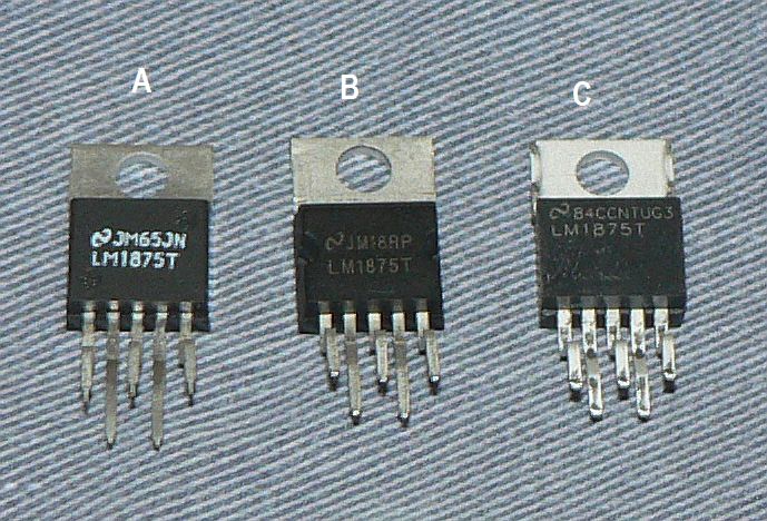

lLM1875T chips
When I received the kits I had a look at the chips and compared to the others I had.
A. An Australian supplier who does substitute when original is not in stock. This one has 2 indents on the face, one above pin 1 and the other higher above pin 5. Looks like they have a manufacturing code in them B8/14 and B9/1. Not genuine from TI for sure.
B. As supplied with the kit and the cutouts in the sides looks like that of a TDA2050 from the pic at ESP P72 so unlikely to be a LM1875T.
C. LM1875T/NOPB supplied by Digikey which would be from TI.

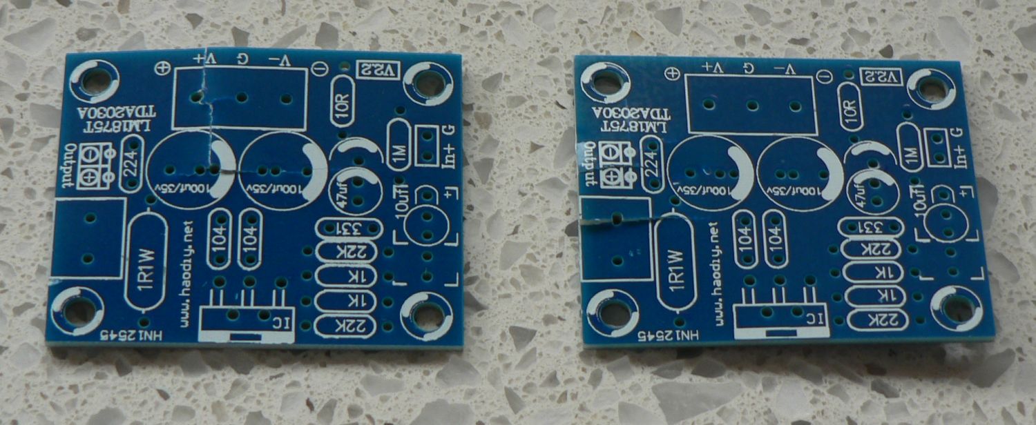

It seems that someone has put something very heavy on your PCB´s.

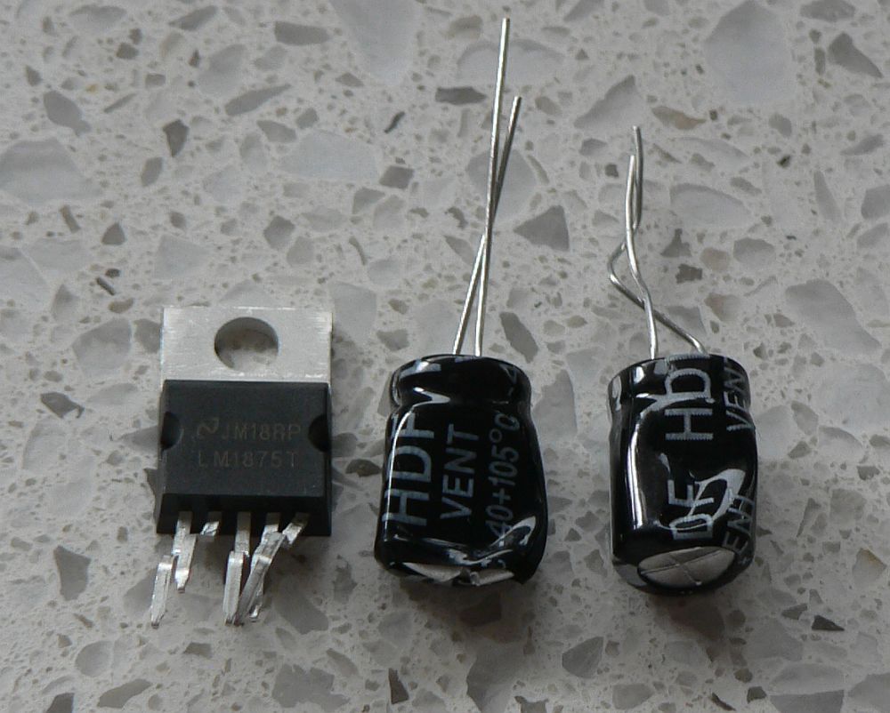

It is interesting: You have received the same "LM1875" with the side notches.
We post at the same time. 🙂
Yes, I am sure that the one with the notches on the sides is a TDA2050.
It doesn't sound bad, maybe the bass is a bit more present than I would like.

I tested a channel with an original LM1875 and indeed, the chip supplied in the kit is a TDA.
The LM1875 is brighter, less warm. I would not rate it as better only different but I need some more time to form an opinion.

Hmm... the 1875 'chips' included in MY 2$ amp kits are Definitely Fakes.. Not even passable copies..
Simple visual comparison alone..between these and Genuine (from Mouser) 1875's Left me with zero doubts.
No subtleties involved there.

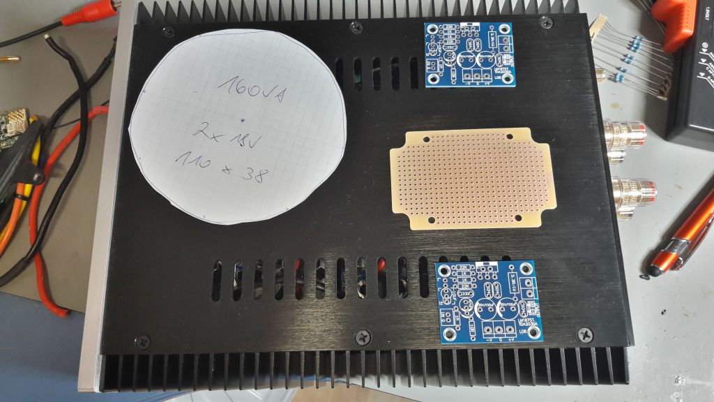

planning.....the housing
Hi
i just play around with the possibilities of a housing (i used this for my TPA3255 "fake amp") and the internal boards.
https://www.amazon.de/dp/B017VIIDN4...ascsubtag=94c08f68c2a4b11d022dd960c5c1d695_CT

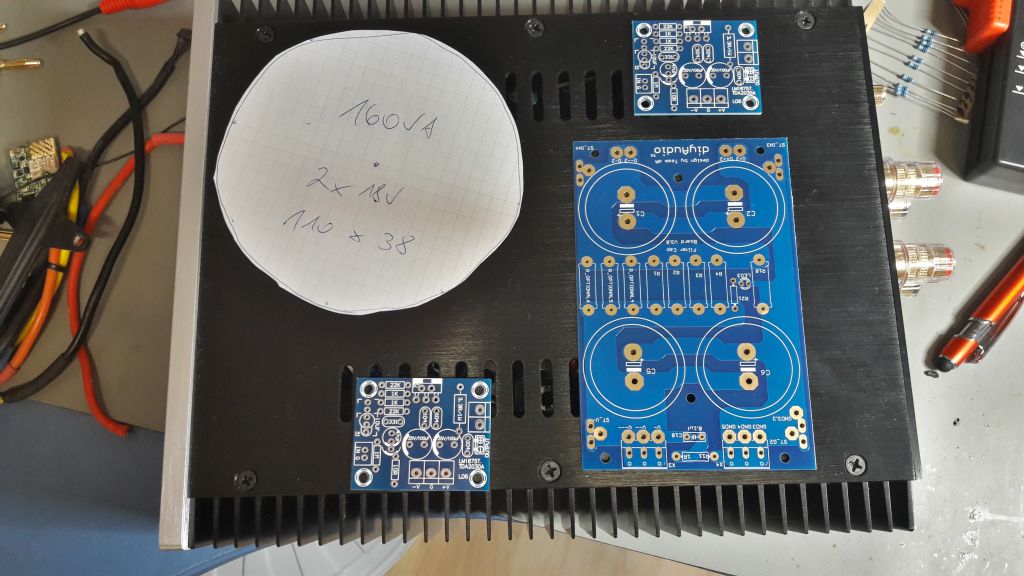

pic1 160VA with its dimensions (i bought a 300V for a other project) + big rectifier board + both channels - here is the room for the amp boards limited and t1 board is near to the transformer - not good
pic2 the same but with small psu board (rectifier and caps - no crc..) - here its better for short input signal ways.
oh...yes the transformer should be placed in the middle 😉
pic 3 is just the size of the heat sink = 6cm and the height of the board with possible stands and the lm1875.

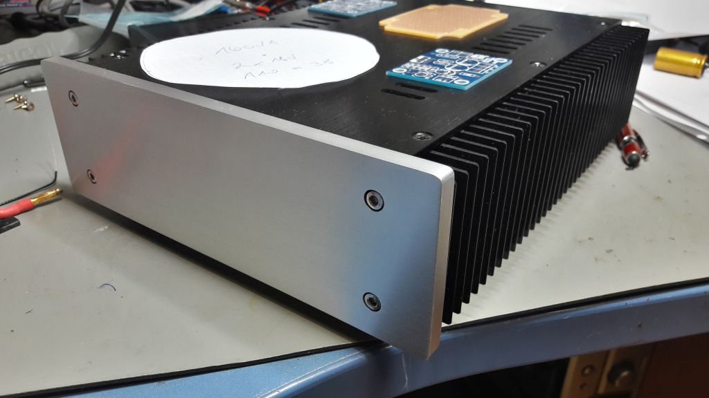

pic 4 is the front panel -i like this kind of housing🙂
