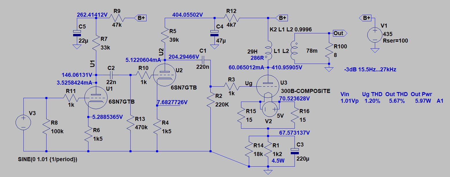

The 0.22nf Cap is only in the simulation.
22nF K40Y between the first and second stage.

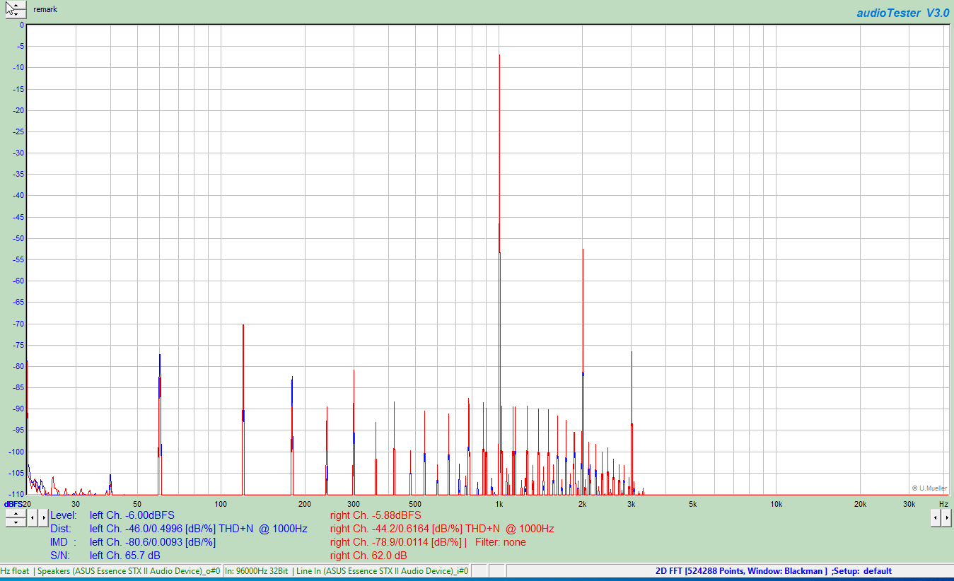

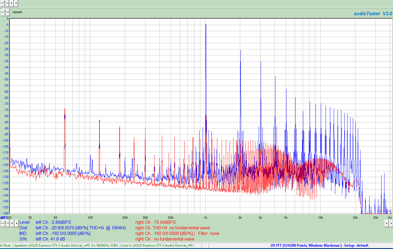

32mW - 0.39% thd
64mW - 0.44% thd
128mw - 0.59%thd
0.25W - 0.78%thd
0.5W - 1.12%thd
1W - 1.65%thd
2W - 2.65%thd
3W - 3.45%thd
4W - 4.5%thd
5W - 6.1%thd
5.12W - 6.6%thd
7W - 10%thd
the inflection point is about 5.12W out, about 6.4Vrms into 8 ohms. the first plot is 6.4Vrms with nice monotonically decreasing harmonics, the second is 6.6Vrms with the high order harmonics produced by the onset of clipping.
This is also accompanied by a rapid increase in IM distortion.

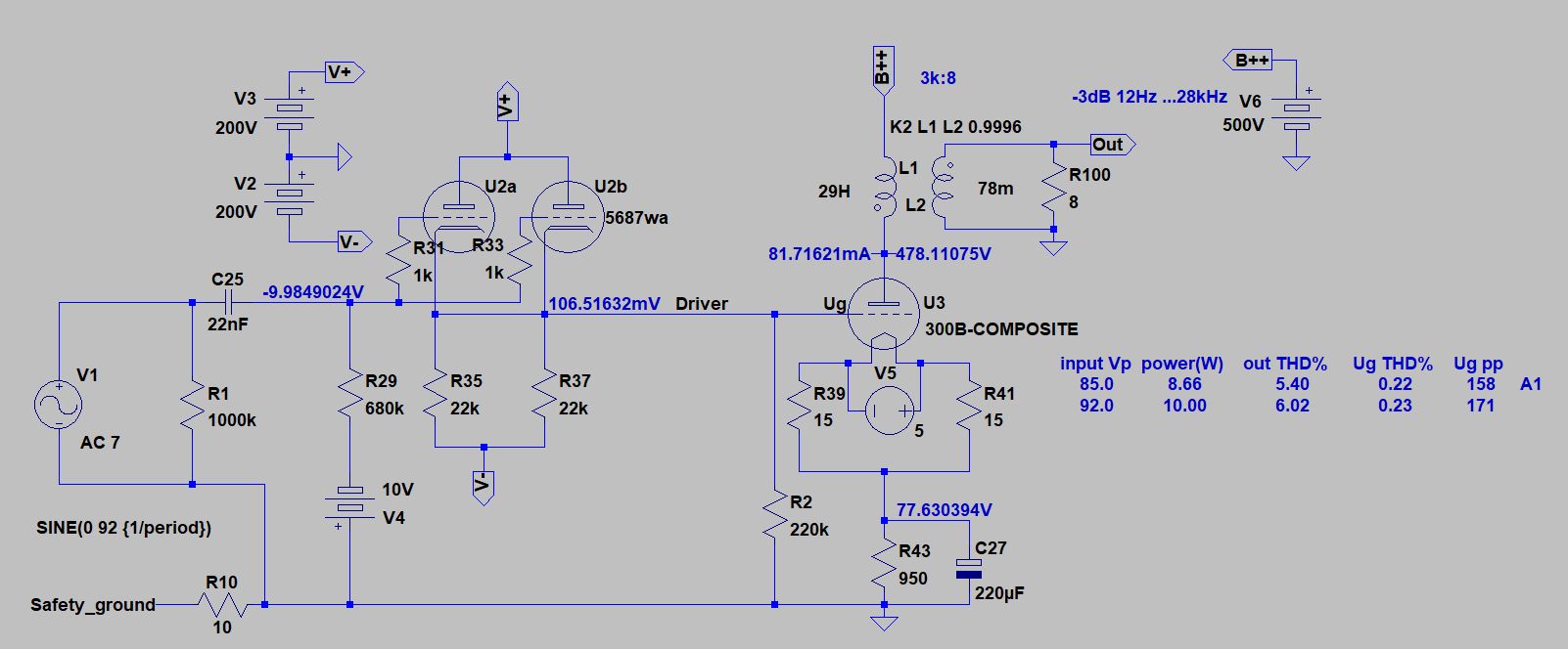

The K40Y 0.022uf in combination with the 470K grid resistor for the next stage has approximately a 15Hz -3dB point. No need to increase it as in promotes LF from a record player to be passed.
Stephe, I put a 100pF cap from grid to ground with the tube missing so the drive is sufficient. Any loss of ability to drive the 300B should show up as HF roll off where the the miller capacitance would be loading down the drive signal if there were an issue. From the frequency plots it is evident this is not an issue.

Due to the OPT high DCR (286R) the 60mA operating point current is one of the worst scenario.
Try to higher current (70mA or grater if the OPT is tolerate it) and distortion will be decreasing significantly.
The A1 border will not changing considerably, below 6W.
Over it the distortion growing rapidly (too high output impedance of driver + blocking distortion due to coupling capacitor).
Transformer is rated at 110ma. I will try again. However I tried an additional 2.4K parallel resistor and Ia went to 73mA reducing the Vgk 64.3before clipping. I think increasing Vak is more promising.

IMHO One Electron UBT-3 is not perfectly optimal for 300B, despite of aproximately suggest it in the datasheet.
http://www.one-electron.com/Products/Trans/UBT3_10.pdf
Tube Plate voltage current Grid bias Power
300B 325 V 75 mA -65V 7.5 W
If you use it with lower power, the higher impedance OPT (for example 5k) produces much lower distortion.

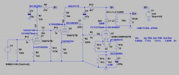

Possibly hooking the speakers to the 4 ohm tap would help reduce the distortion, especially if the speakers are more like 6 ohms in reality.

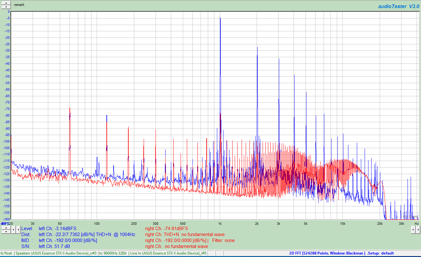

Here is distortion at moderate listening level. I cranked it up to a level I use when I am in the kitchen cooking.
Since I am not sure what you consider "High" distortion I propose you provide me with examples of what your amps produce.
Adjust the volume of your system to produce a moderately high level of sound (69dB at 12' from the speaker) such that it can be heard in another room over the sound of cooking a meal with the vent fan running on the stove vent. Measure the p-p or RMS level and then use that as a reference level to measure the harmonic distribution spectrum of your amp at that level. Then post the screen shot so I can get a feel for the relative distortion of my amp.
This way I can have a relative measure of what I am working towards.
I was going to change the capacitor to a 0.15uF, until I realized that LF Fr is dominated by OPT and driver stage. Improving the LF coupling of the first to second stage will do little for real wold response.
How much audio content is there below the 15Hz -3dB point? Other than edge warp from vinyl records.
