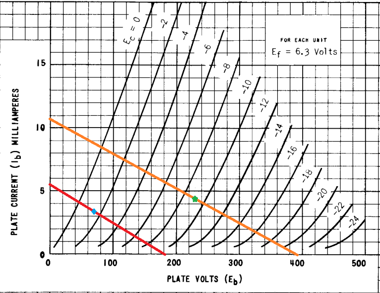

With the schematic in post 65 leaving off the cathode cap on the second stage we have:
Transformer turns ratio is SQRT (3000/8) 19.36
amplifier gain is 11.9 * 1.28 * 3.19 / 19.36 = 2.51
For 8 W out 8Vrms is required to an 8 ohm load, so input drive is 8/2.51 = 3.18Vrms.
First stage amplification:
3.18Vrms * 11.9 = 37Vrms = 107Vp-p or 53.5Vp
Looking at the red loadline we see from the bias point (blue star) to the Ec=0 curve is only about 30V, and this is probably what Stephe was talking about in post 94, since it will result in clipping well before full output.
Since the amplifier actually has a bypass cap on the second stage cathode, it behaves differently.
Actual Gain Structure:
First gain stage the same as previous:
AV1 = 11.9
Second stage V2b 6SN7 Bypassed
AV =(Mu * RP) / (Rp-+ Ra)
= (20 * 33K) / (33K + 6700)
= 660K / 39700
= 16.6
300B is the same as previously calculated:
= 3.10
amplifier gain is 11.9 * 16.6 * 3.19 / 19.36 = 32.55 vs 2.51 previously calculated.
For 8W we only need:
8Vrms / 32.55 so drive is 0.245Vrms
with a stage gain of 11.9 for the first stage, it’s output will be 2.92Vrms or 8.27Vp-p which the gain stage can accommodate without clipping.
This explains why I did not hear the problem Stephe was talking about.
This amp starts clipping when the driver voltage approaches the Vg=0 condition to the 300B.

Yes, I confirmed the driver stage was hitting 0V grid voltage when clipping started and distortion went up. The input stage was no where near clipping. I continued increasing the input drive until the input tube started clipping, It took a much larger input signal to push the input tube to clipping.
