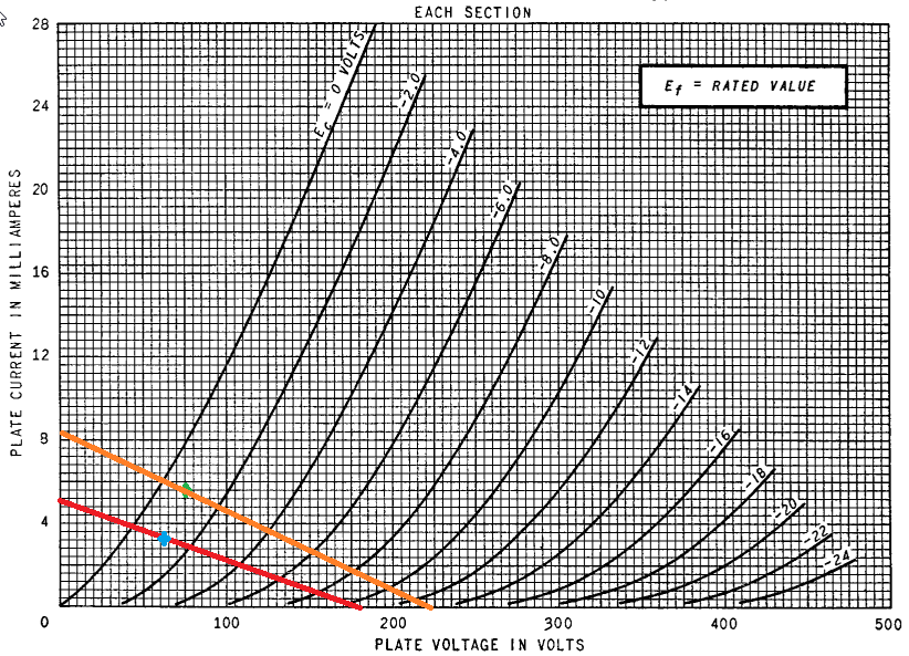

I then tried measuring the max output and could not get much over a watt an a half! One watt is a lot for my speakers (96dB/W-M), so I can see I would not hear this without really turning up the volume.
Unfortunately, I did not get screenshots of my previous measurements of the drive to the 300B, but went back and repeated the measurement and was surprised that the grid drive clipped well before it reached the 300B Grid bias (70V negative wrt the cathode).
So, Stephe’s predictions hold true.

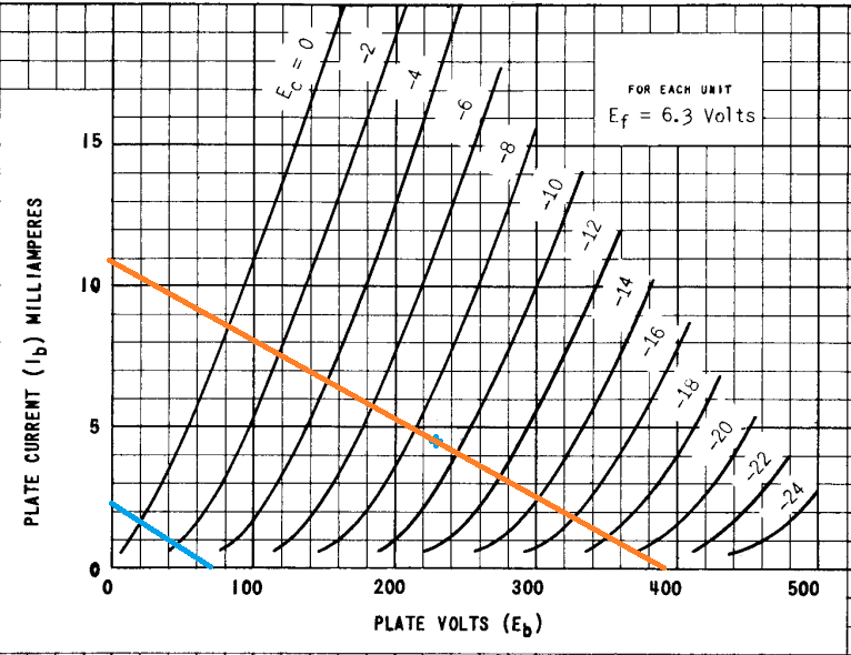

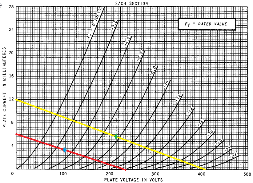

So what did I do wrong in my calculations? The gain structure is valid, I made no error there.
The problem lies in the my load lines in post 103 (First attached here). The upper curve for the driver stage is based on the Va, NOT Vak as it should be.
The corrected load line shows the issue. There is less than a volt of bias on the tube. It will clip due to grid drive clipping well before it can generate enough drive for the 300B.

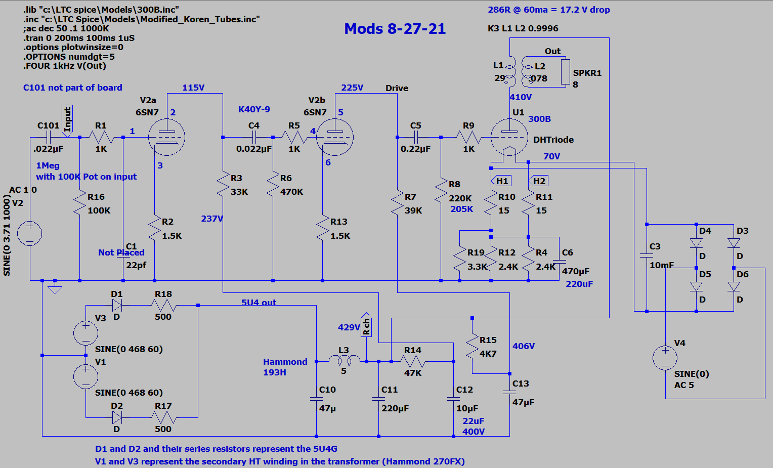

All is not lost however, the solution is along the lines of the schematic in post 8.
Convert the second stage to a capacitively coupled common cathode stage with an un-bypassed 1.5K cathode resistor, 39K anode resistor.
The attached schematic shows the current design.
A coupling cap is added between the anode of stage 1 and the 1K grid resistor of the second stage. A 470K grid resistor is added from the cap to 1K grid resistor junction to ground. The cathode resistor is changed from 15K to 1.5K. The Anode Resistor is changed from 22K to 39K.
The first gain stage cathode resistor is changed from 750R to 1.5K as well.
R14 on my schematic is changed from 68K to 47K to give more headroom.

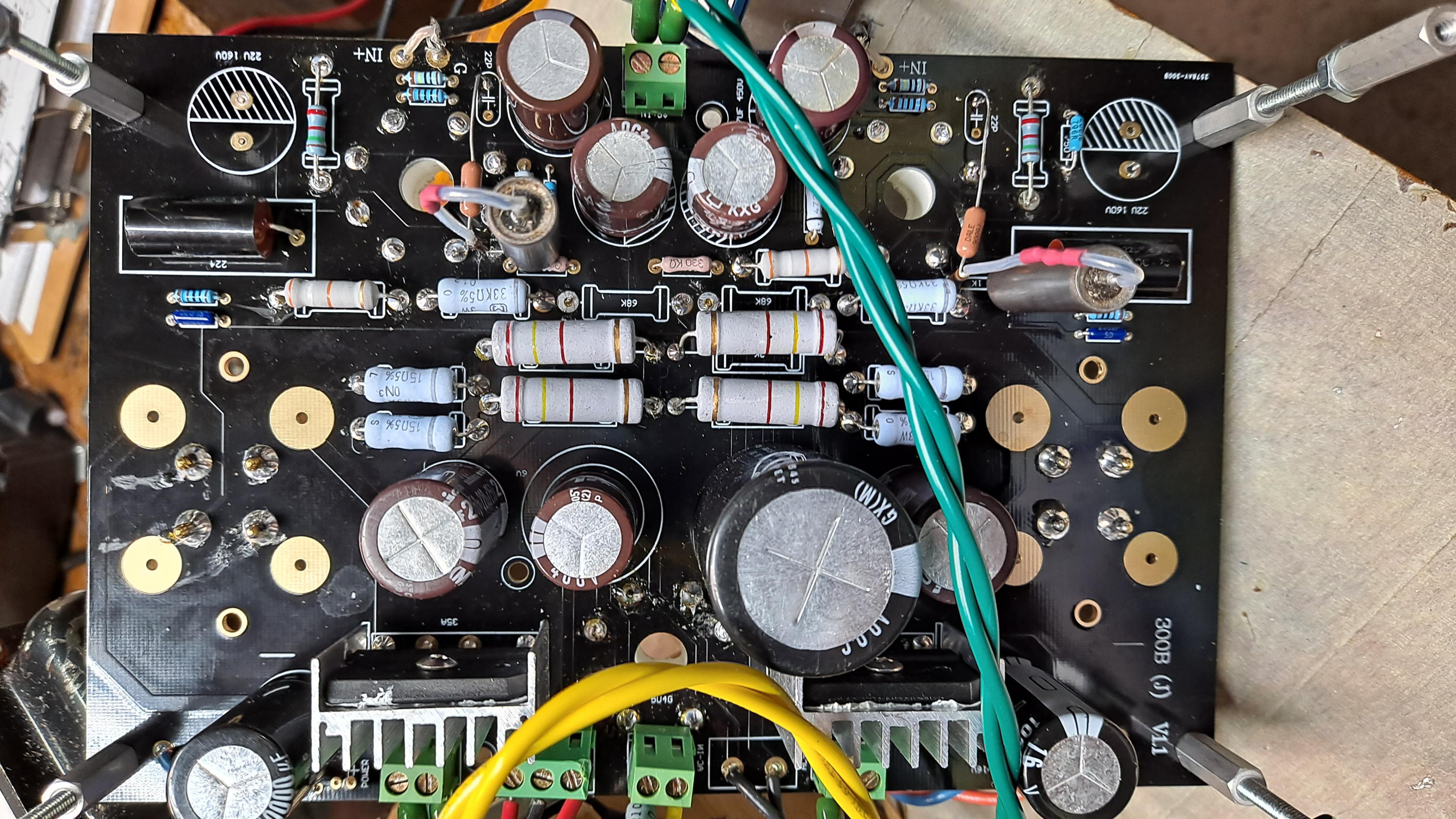

Here is a shot of the board with mods.
I used 0.022 uF K40Y-9 1KV capacitors between the stages.

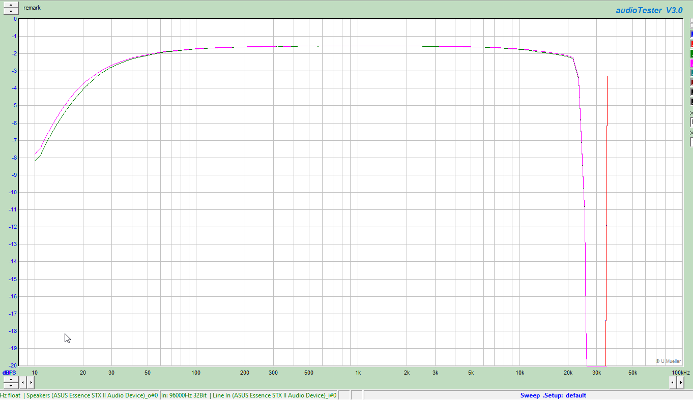

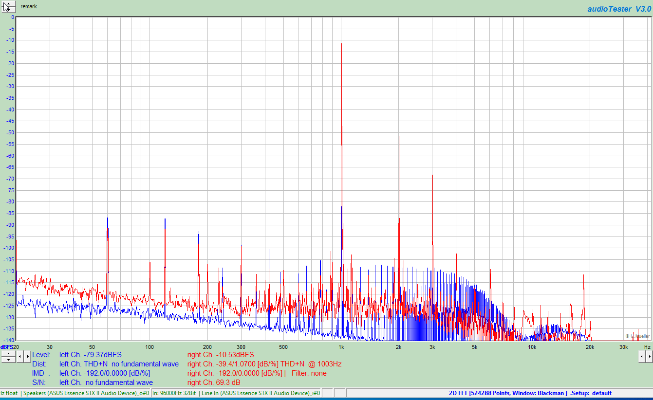

Here is the FR at 8W out. Probably better than 20Hz to 30KHz -3dB.

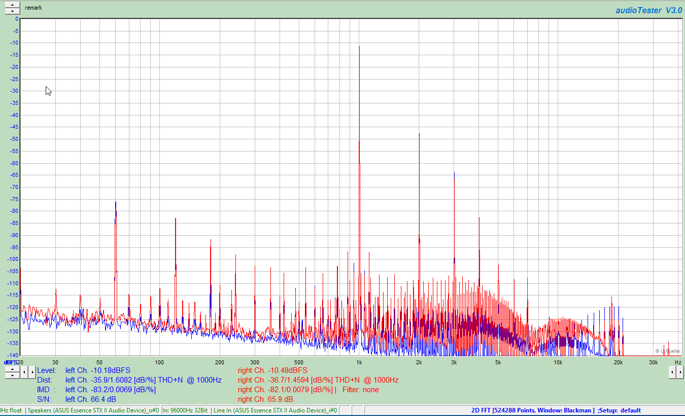

And the distortion at 1W.
One thing to keep in mind is that I am using a resistive divider to prevent overloading my sound card.

There are two errors in the schematic in post 124 (1) R19, 3.3K is changed to 5.1K, to set Ik = 60mA, and (2) I am now using the XPWR002 Edcor transformer which gives 100V higher B+.
If you change the first coupling capacitor from 22n to 220n, the lower 3dB goes down.
The 0.22nf Cap is only in the simulation. The note on the schematic explains "C101 is not part of board".
My Vak is 358 vs your 385, so all things else being equal, my distortion will be much higher than yours at 8W out. At 8W out and my bias point, I am in hard clipping.

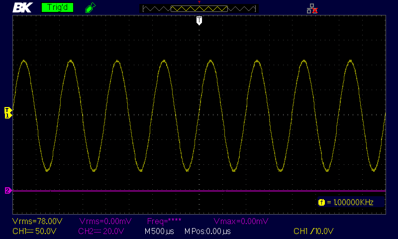

the first screenshot is the grid drive and cathode voltage at 7Vrms out (6.125W) into an 8 ohm load resistor. As you can see, It is about to go into grid current draw. So at 8W out my distortion is high.
The second shot is grid drive at max with the output tube removed (220V p-p) with Vin = 0.960Vrms showing there is no issue with the input and driver stages.
So where does the distortion level climb past 1% or whatever the point is where it turns upward?
And the fact the driver can swing the voltage with no load doesn't mean anything. It's like measuring the no load voltage of a transformer, what matters is what is it when driving into the intended load.
