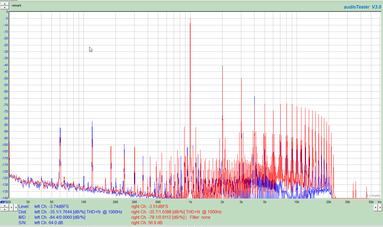

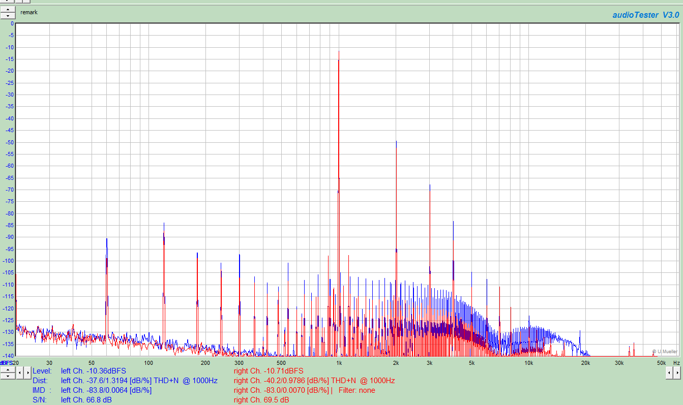

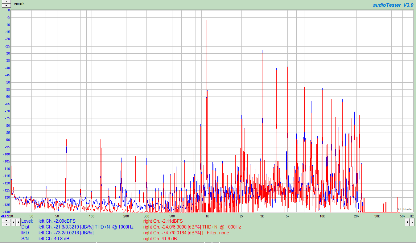

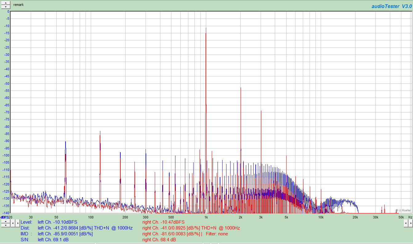

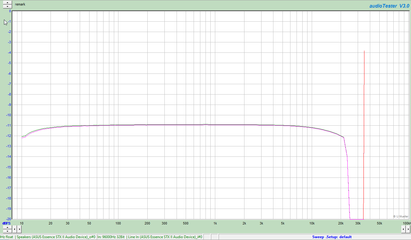

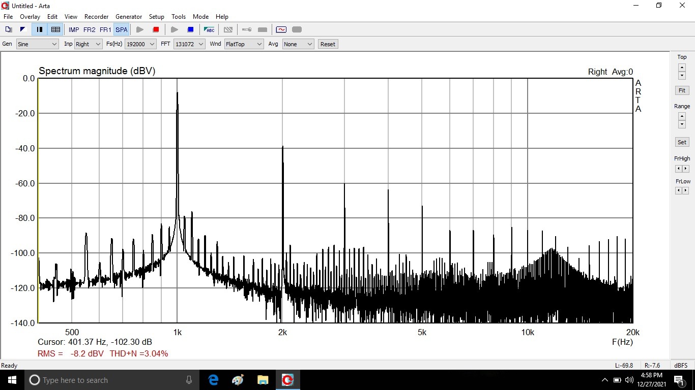

I finally got the Cascode driver built and tested for comparison to the two cascaded common cathode stages.
Cascaded Common Cathode stages:
Common Cathode dual stage was previously analyzed for un-bypassed gain (11.9) but not for Zout.
Mu = 20, Ra = 6700, Gm = 3000
Zo =(rp +[mu +1]Rk)||Ra
= (39K+[20+1]1.2K)||6700
=5292
AC line voltage is adjusted to 125V for all tests.
All measurements are through a 220R/60R divider to prevent overloading the input of the sound card.
The first attachment is THD at 0.25W
The second attachment is THD at 5.5W where it approaches 8%, but remains mainly monotonic in nature.
The third attachment is THD at 6.5W where it is roughly 10% and is no longer monotonic in nature.
The fourth attachment is frequency response at 1W. There are two plots in the graphs, one with the coupling cap at 0.022uF, and one with an additional 0.15uF cap in parallel demonstrating that the LF response is determined by the inter-stage coupling cap and next stage grid resistor.
I prefer the sharper roll off since I have a Reel to Reel tape deck, a cassette tape deck and turntable. These can produce objectionable LF energy below 20Hz which I prefer to filtered out. If you have ever seen a bass speaker servo in and out due to record edge warp (1.8Hz) you will understand.

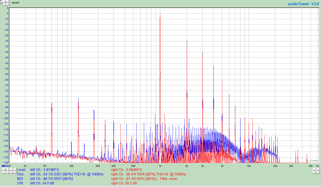

Distortion Comparison:
0.25W:
Cascode shows overall less THD, however it is achieved by reducing 2nd Harmonic at the expense of 3rd and higher. Still mostly monotonic and probably undetectable by hearing.
8%Distortion (5.5W):
Cascode has slightly higher odd harmonics from 3 to7. 2nd harmonic is lower for Cascode, resulting in ovarall lower THD.
10% Didtortion (6.5W):
Distortion at this point is bringing up lots of highorder harmonics due to clipping on both peaks.

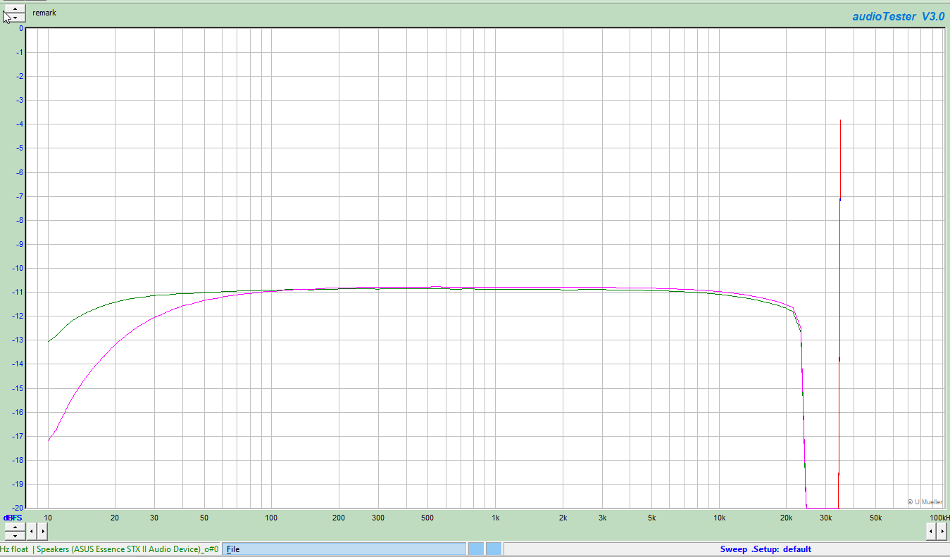

Frequency Response:
The plot for the common cathode stages posted previously showed more roll off below 50 Hz compared to the Cascode. This was due to the coupling cap between Common Cathode stages as shown in the last plot which compares 0.022uF vs 0.17uF capacitors.
Overall the typologies are similar in response. Most differences can be accounted for by comparing the RC time constants of coupling circuits, and output impedance vs input capacitance of the driver stage.
The biggest difference is drive sensitivity.
The Cascode stage requires 1.2Vrms to achieve 1W out (2.828Vrms) versis 248mVrms for the cascaded common cathode stages.
The Cascode implementation is 4.8 times less sensitive than the cascaded CC stages.

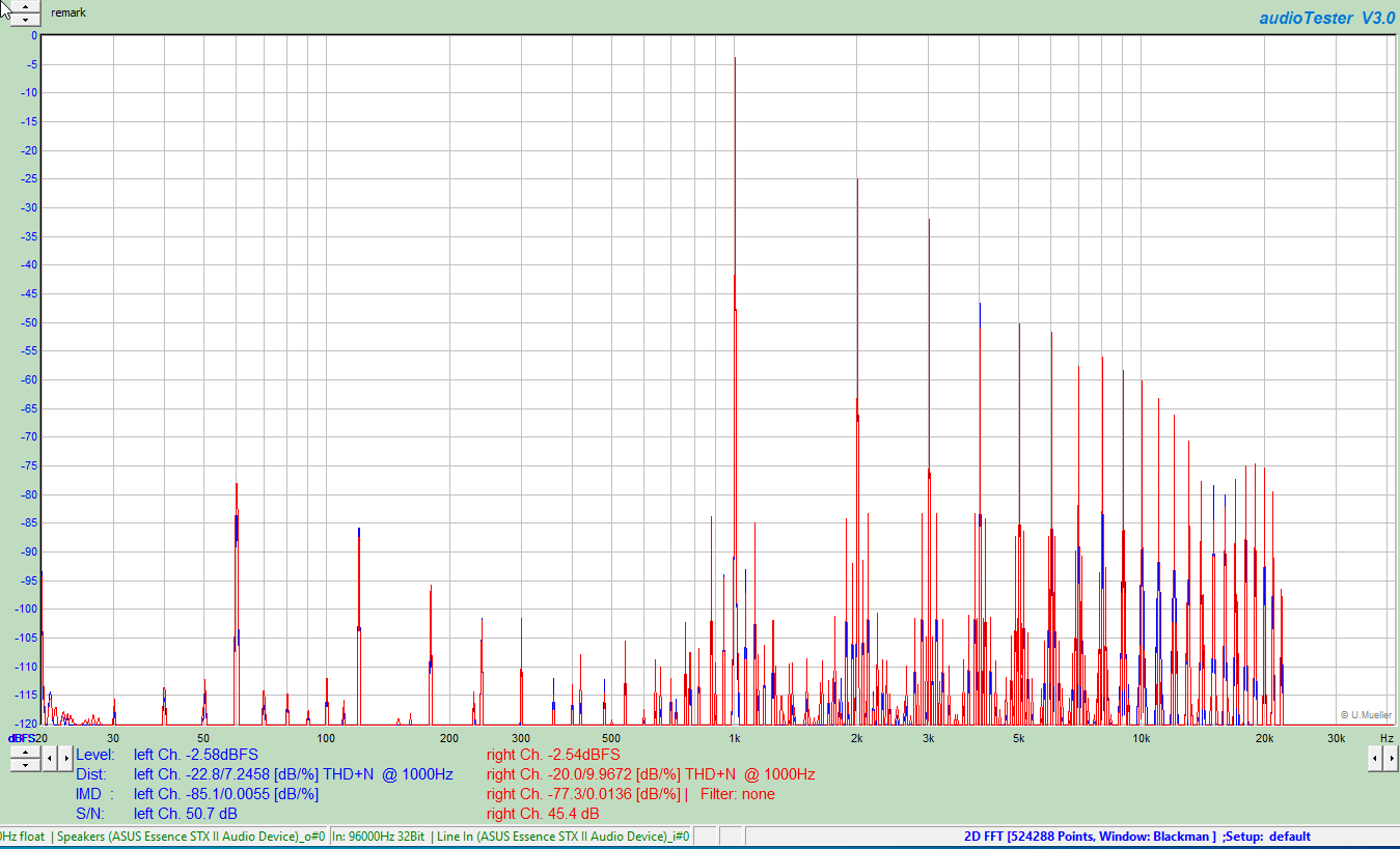

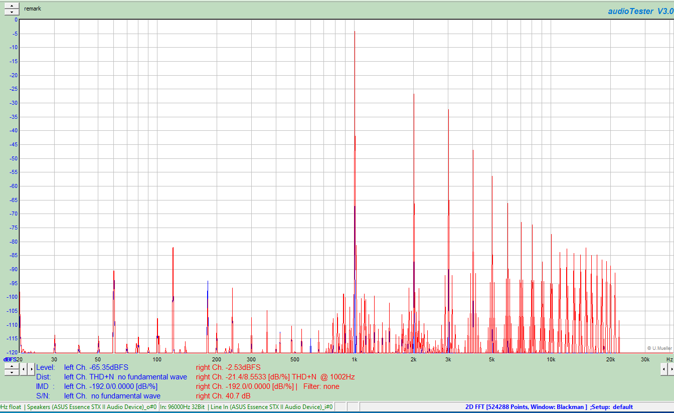

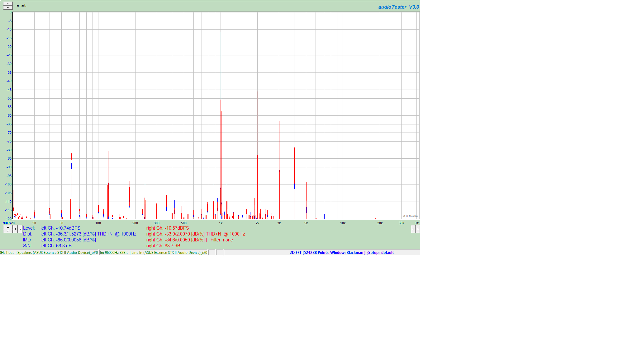

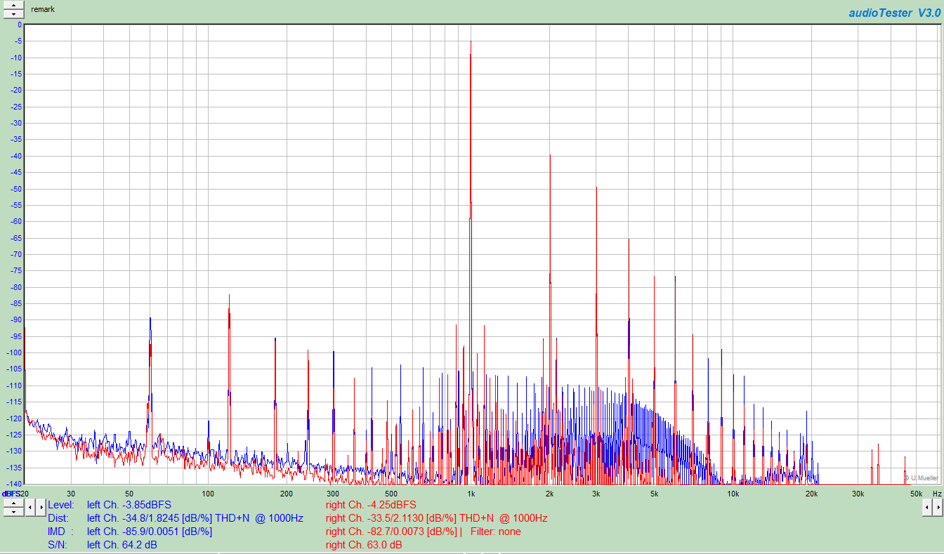

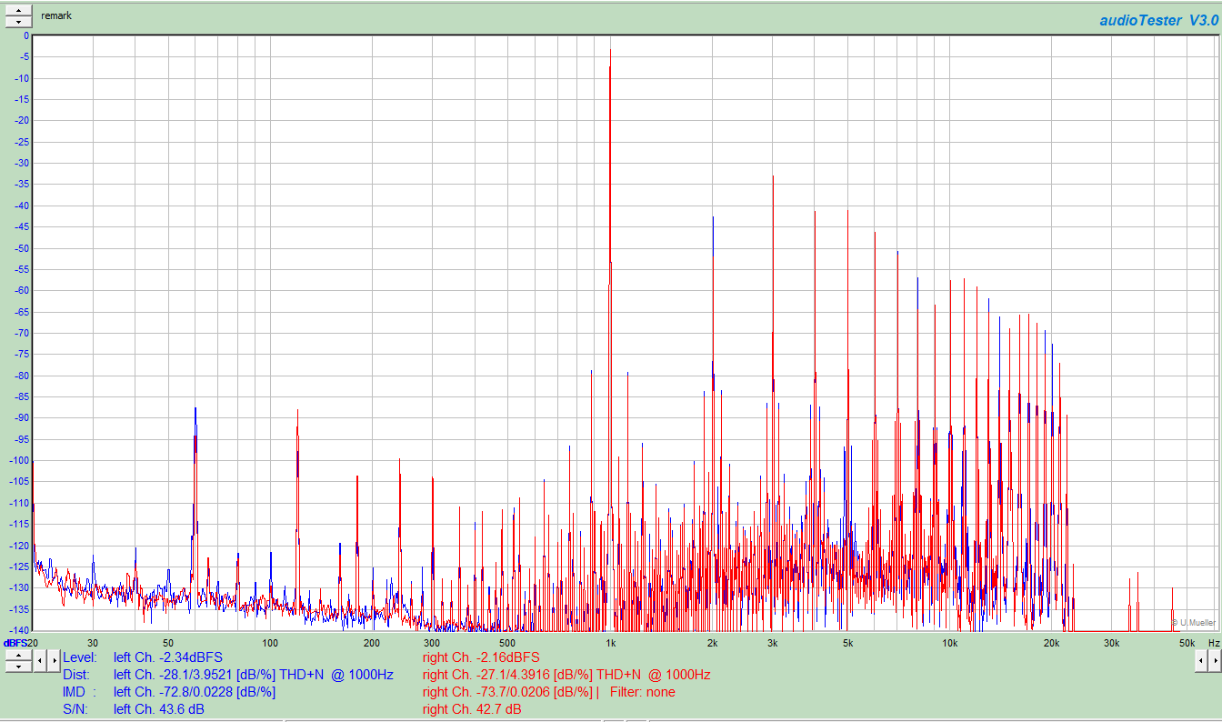

I finally got around to trying various transformers to see how they effected distortion.
In addition to the original UBT-3 (3K) from One Electron, I tried:
UBT-2 (5K)
CXSE25-8-5K
GXSE15-8-5K
I also tried both the Psvane and Gold Lion 300B tubes.
For later tests I abandoned the Psvane 300B as they had measurable higher distortion, most notably above the third harmonic. I willnot present their data.
First is te UBT3 3K OPT.
UBT-2 (5K)
CXSE25-8-5K
GXSE15-8-5K

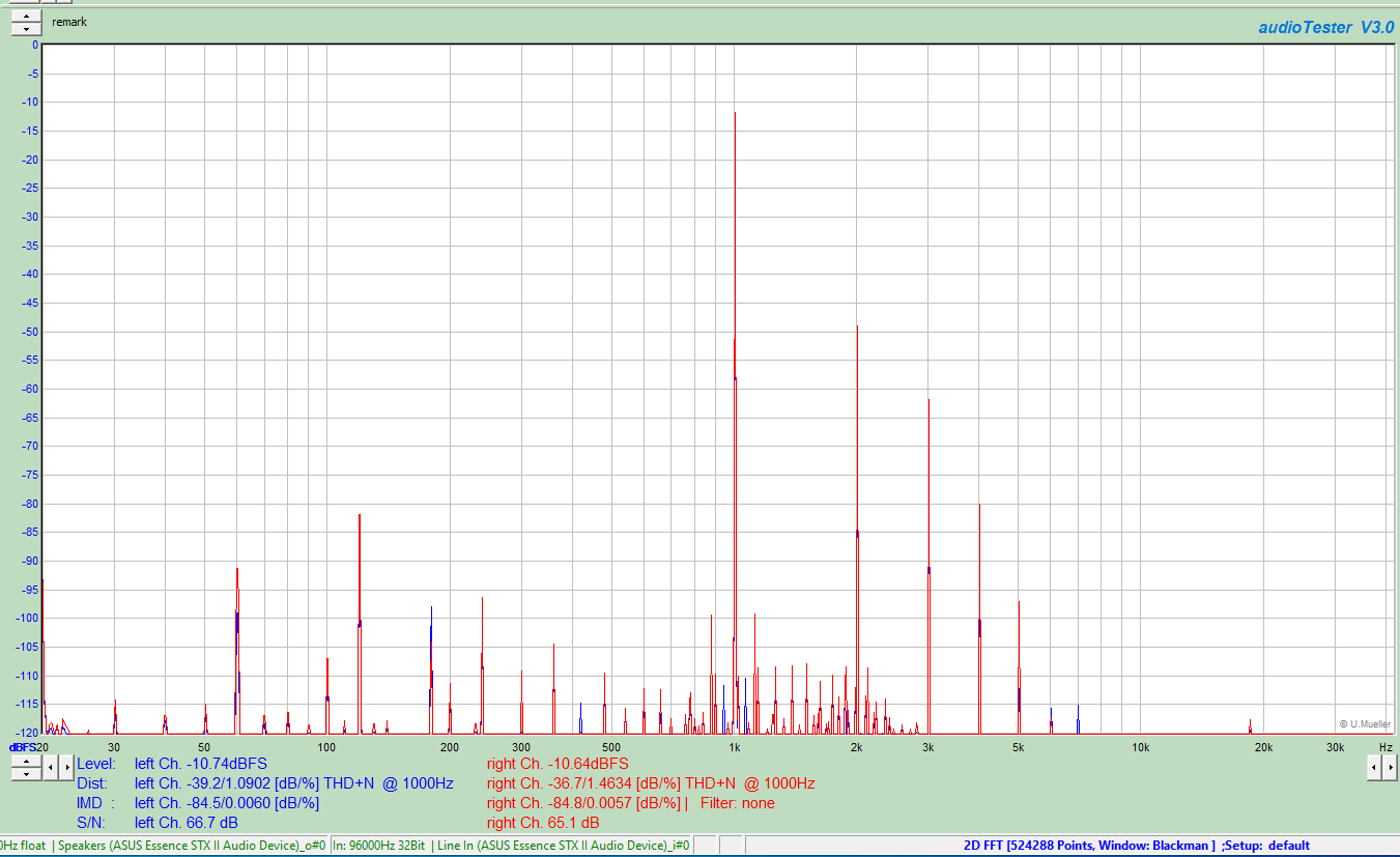

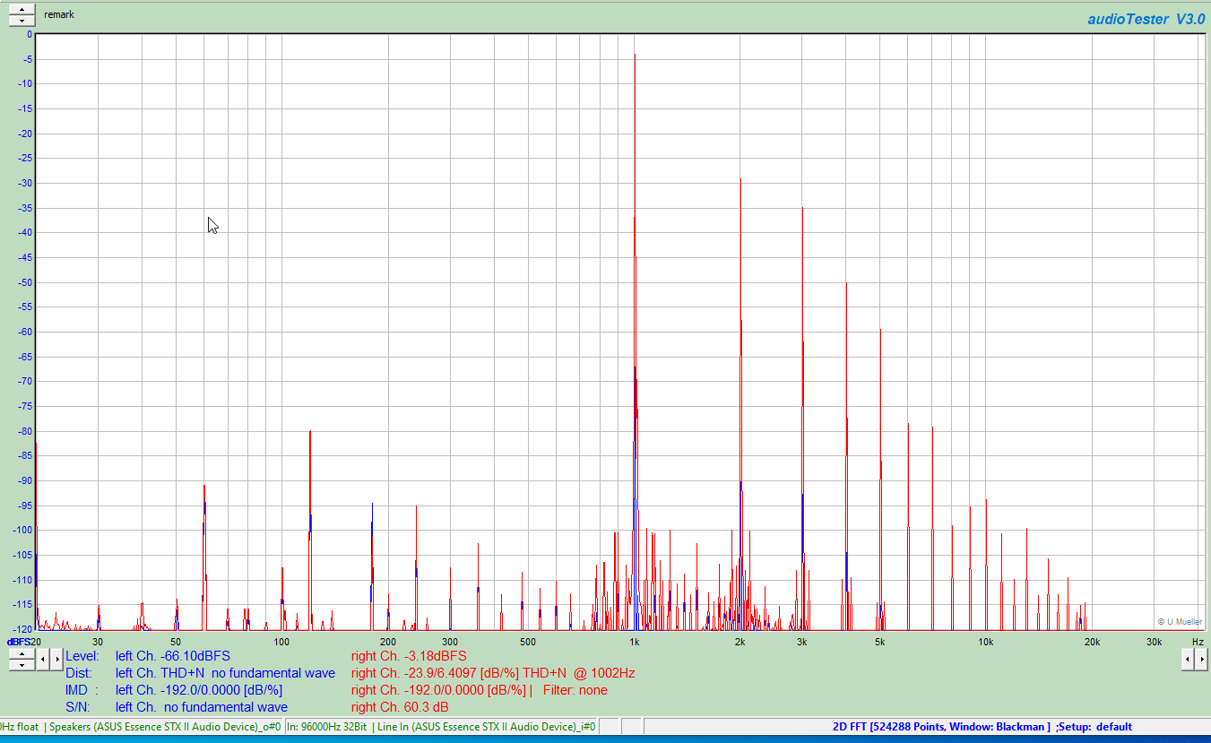

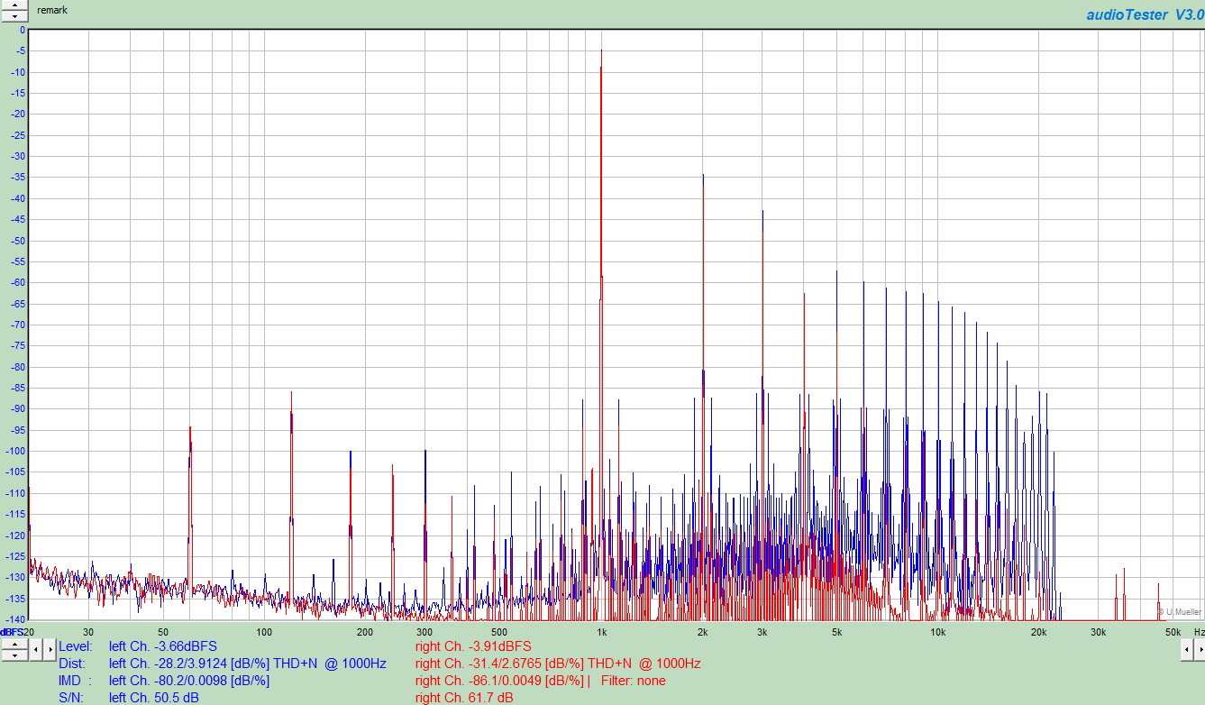

Next is the UBT-2 (5K) OPT.
As expected, the 5K transformer has lower distortion at one watt. At 4.5W it is starting to produce significant distortion, however this is expected at this operating point which is expected to be similar to 6.5W out with the 3K OPT. The higher our impedance, the lower the distortion at 1W, but also the lower the power out before clipping.

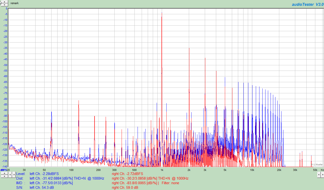

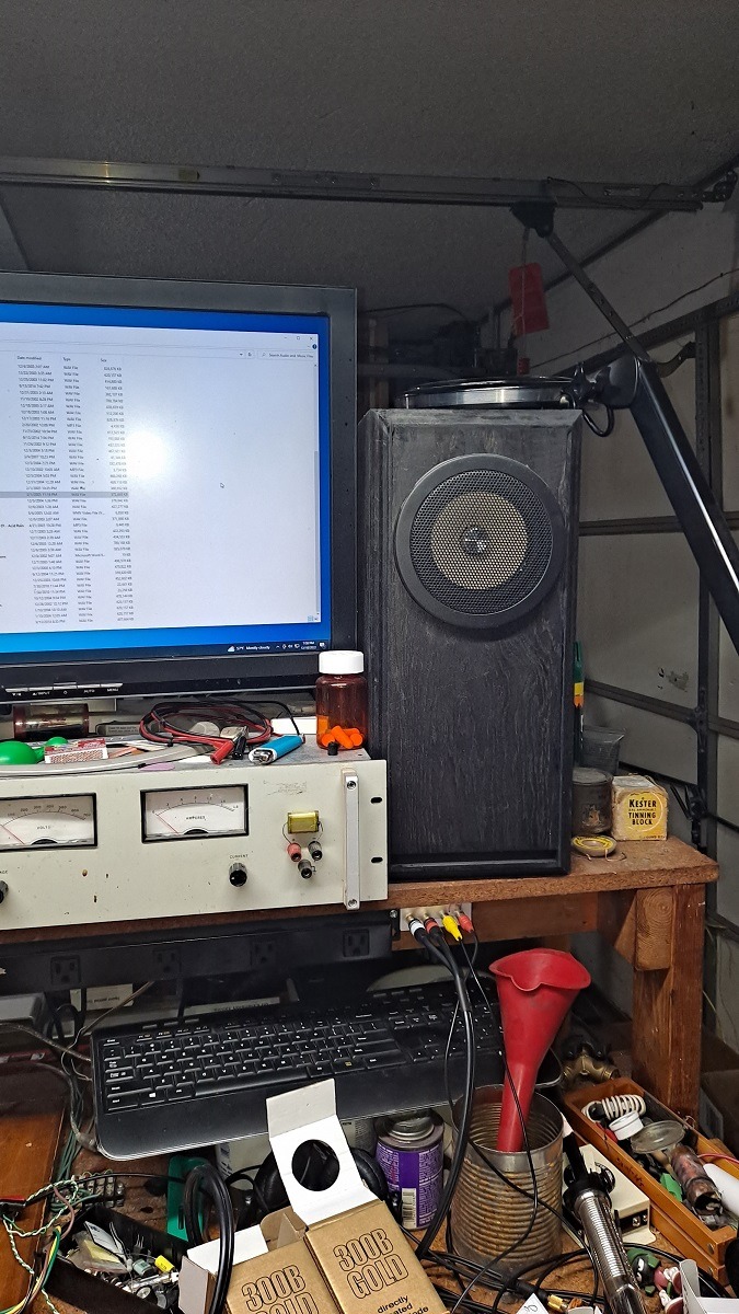

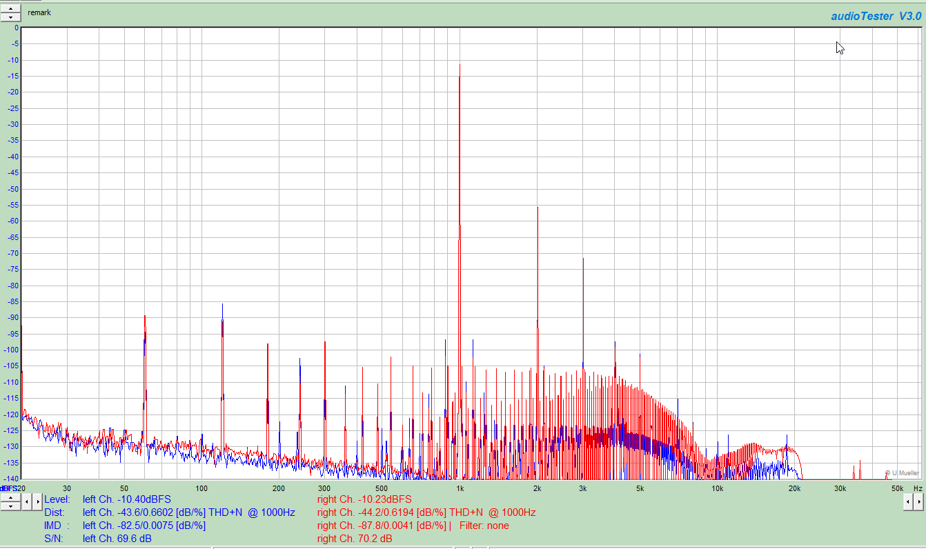

Listening tests were performed with a set of TangBand W5-2143s in Slot port enclosures.
Music was various albums I had digitized including Bob Dylan and Johny Cash, Billy Joel, Christopher Cross, Deep Purple, Genesis, James Taylor, Leon Redbone, Emerson Lake and Palmer, Joni Mitchell and Liquid Tension Experiment.
The best sounding transformers were the big Edcore CXSE25-8-5K. The UBT-2 placed second and didn't seem as authoritative. The UBT-3 and GXSE15-8-5K were a toss-up. The UBT seemed muddy while the GXSE seemed thin on the bottom although mid range up seemed very clear and detailed.
I will have to try this again when I get the 2A3 amp built, and possibly a 45 amp.
5K transformers are definitely an improvement over the 3K in terms of lower measureable distortion, better distortion component distribution, and listen-ability.
I am very sceptical that those distortions are caused by the xformers. They are simply too high for even a bad xformer.
I believe you are looking at the amplifier distortion primarily.

I see very small 120Hz upper and lower sidebands on each tone, 1kHz, 2kHz, 3kHz, etc.
(sideband at 880Hz, 1120Hz, on the 1k tone; and on each harmonic of the 1kHz tone).
Filtered DC on the filaments, no regulation.
Yes, the distortion is primairly from the amp, however the transformers do have an impact. The largest impact is the change from 3K to 5K impedance and it's loading effect on the output tube.
I do not think that the transformer introduces these distortions but the choice of its impendance and the wrong choice of the driver. I built an amplifier with 300b and the transformer has 5K/8 ohm designed and coiled by meFiltered DC on the filaments, no regulation.
