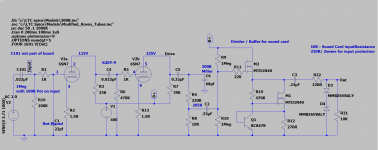

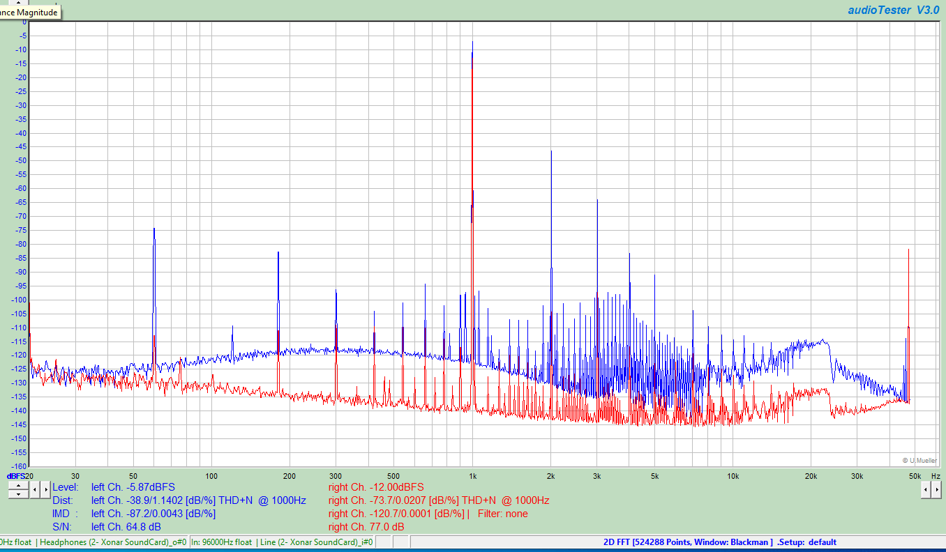

It says 0.2% distortion on the drawing but in the graphs I see about 3%.
Is that a typo on the paper?

The distortion of 0.2% refers to those produced only by the driver, obviously they are much smaller than those inserted by the final tubeIt says 0.2% distortion on the drawing but in the graphs I see about 3%.

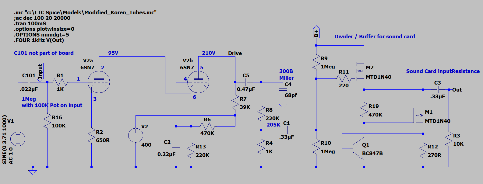

I may go back and try the Cascode circuit again as a driver.
I found an interesting thesis from 1956 which mentions using the Cascode in audio. see page 24, Conclusion.
Cascode Thesis
My biggest concerns of the Cascode are low PSRR, high output impedance for driving the 300B input, and the fact that the 6SN7 has low Gm for the circuit.
I will breadboard the Cascode before deciding whether to mod the board. In themeantime I will move the amp back to the living room and try it with the Heresy speakers again.

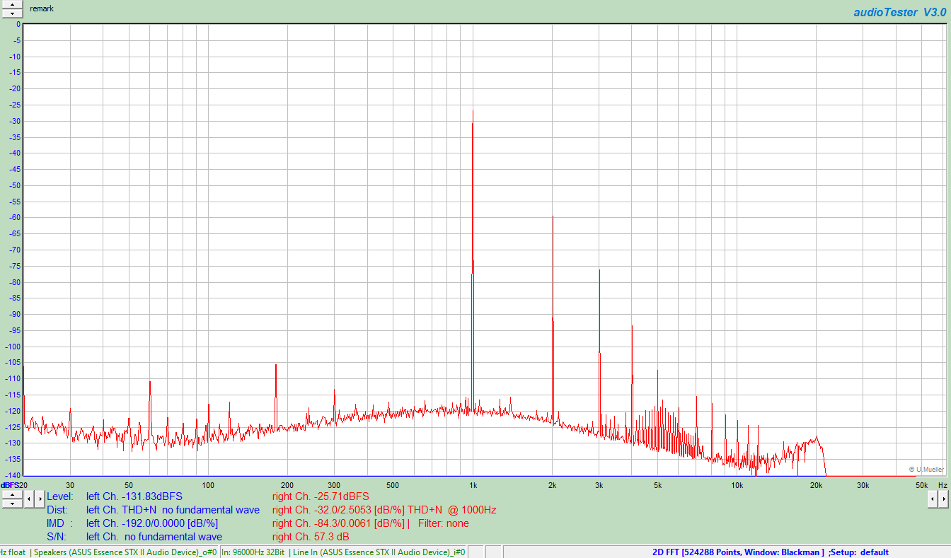

Jan, What I was trying to show was the DIFFERNECE in distortion between transformers. Look at the 4.5W scans in particular for the UBT2 fifth harmonic an up compared to the CXSE transformer. The only thing that changed was the transformers. How could the amp then be responsible?

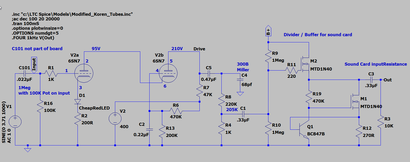

Before proceeding to try to improve the circuit I decided to add a voltage regulator. I used a simple cap multiplier with a FET as a pass element and Zener diodes for reference.
This improved the PS noise slightly, however I am using a bench power supply to drive the circuit so there may be more or less noise in the board itself.I will try to measure it later on.

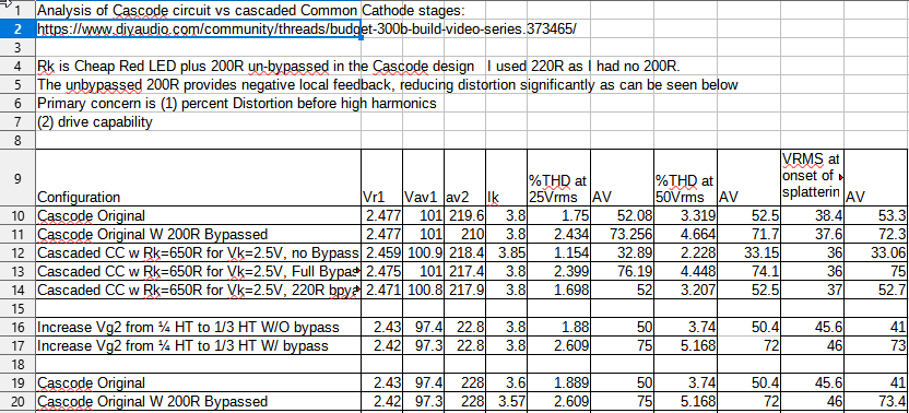

My final effort was to switch to an unbypassed cathode resistor on the lower tube to give some degenerative feedback (the 200R in series inthe original circuit did this to some degree). This gave the lowest distortion at 2.50%.
I used a 650R resistor in the Cathode of the lower tube, increased the lower resistor from 200K to 220K to increase the anode voltage, and changed the anode load of the top tube from 47K to 39K. Overall I increased the Vak of both tubes and lowered the plate load to decrease overall output resistance slightly. This gives a little better drive capability.
The 68pf cap (representing Cmiller for the 300B) had measurable effect at 20KHz where it resulted in approximately 1dB drop in the frequency response.
I will start working on the cascaded common cathode design next.

Blew my sound card (forgot to clamp the output of the buffer for the tube output), so I am waiting for another to arrive.
In the meantime I have wired up two sets of speakers (UBT-2 and GXSE15-8-5K) through a DPDT relay with a remote control. initially everyone could tell the difference so I looked at the outputs and found the GXSE was 1dB lower than the UBT-2.
After level balancing, it was more difficult to tell the difference, which came down to slightly less bass with the GXSE compared to the UBTs.

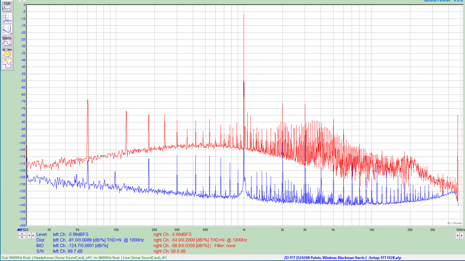

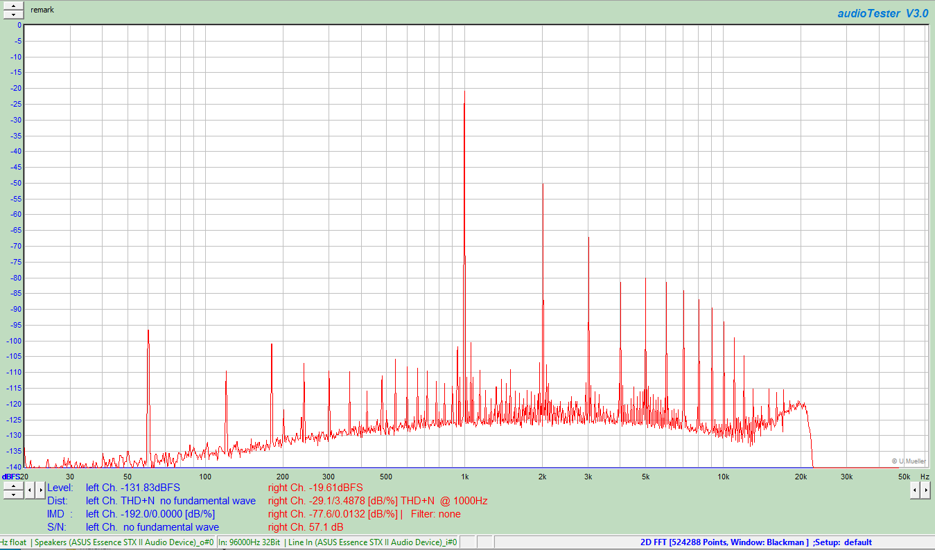

unfortunately life has a way of getting in the way of playing around some times. So I finally got back to the common cathode stages.
The new sound card is 116dB s/n vs the original 124dB s/n, so the noise floor is higher. That said, the distortion components are so much greater that it does not matter.
The two cascaded common cathode stages presented the lowest distortion of the tests performed so far with a THD of 1.14% per the attached plots, the red plot is the sound card in loopback for comparison.
Again the plots were with the output of the driver set to 50Vrms which should be sufficient to drive the 300B to clipping.

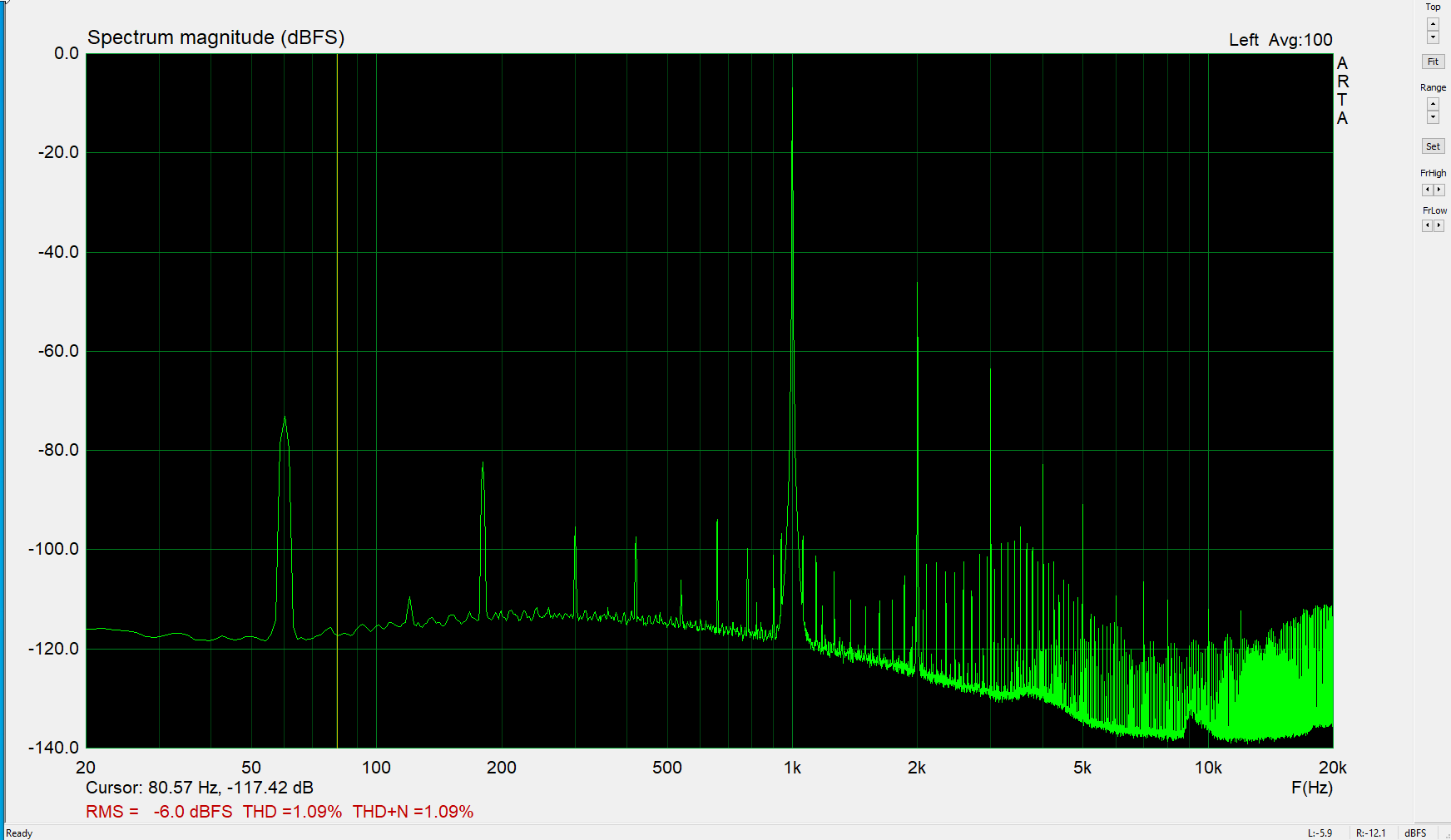

I trust arta software because I compared it to THD measured with a RADFORD distortionometer the differences being insignificantI noticed popa marius was using ARTA for analysis and I am using AudioTester 3D.
Out of curiosity, I loaded ARTA and ran it. It produces somewhat lower THD, 1.09% vs 1.14%.

Comparing various proposed driver schemes to see how their THD spectrum and drive ability compared.
I finally have the time and money to investigate 300B, 2A3, 45 for myself to see what the hype is all about.

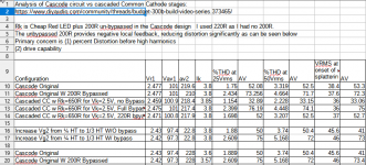

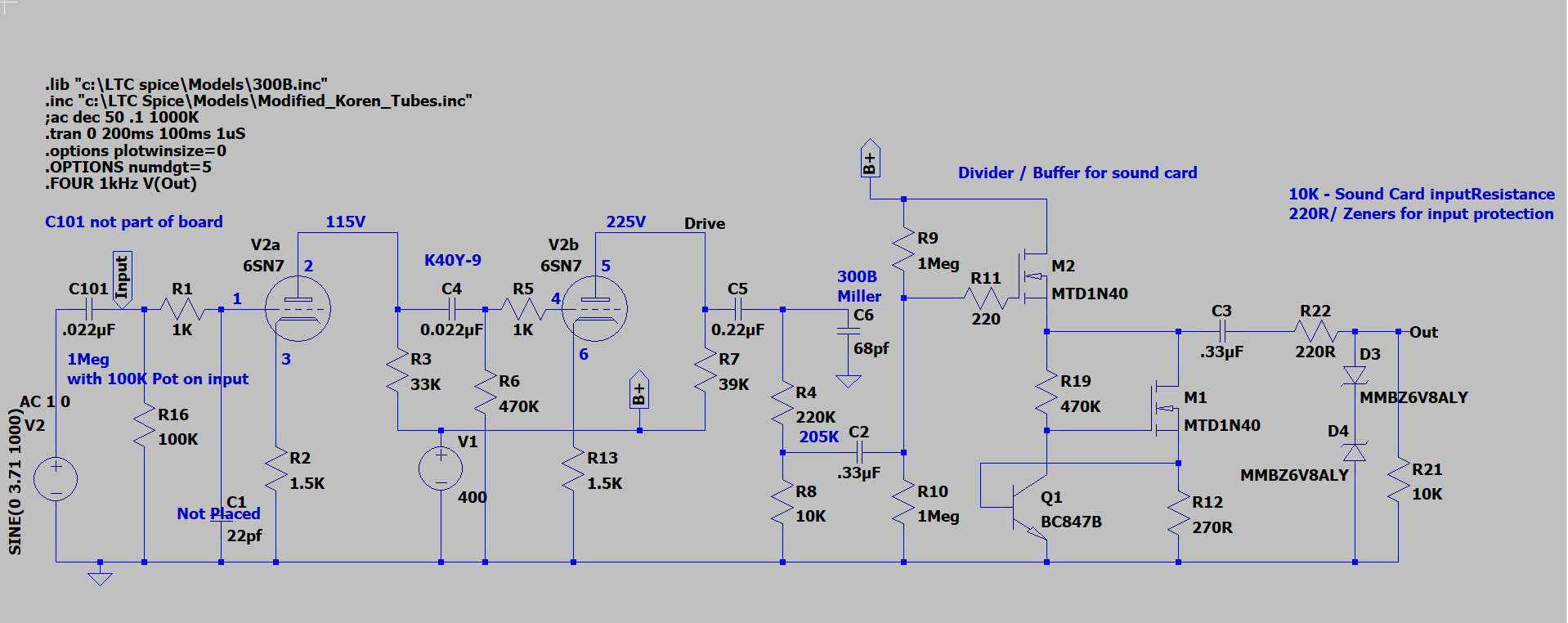

Here is the table for the tests reported in post 213. The cascaded Common Cathode with un-bypassed cathode resistors achieved the lowest distortion, and the lowest gain at 33.16 at 50Vrms out. This is not surprising since both stages have local negative feedback.
I also tested popa marius's circuit.
The distortion is indeed quite low for the driver with measurements of a mix of 10 6P1P and 10 6E6P (different pin-out version of the 6E5P) tubes. I got measurements between 0.118 and 0.36%thd.
The interesting thing is that the low distortion numbers are in large part due to very low 2nd harmonic content. Equal to or below 3rd harmonic level.
I expect this allows the major harmonics of the output to be from the output tube itself since there will be little 2nd harmonic cancellation.
The test included the 5687WB driver tube since without it, my sound card could not drive the output to 50Vrms.
