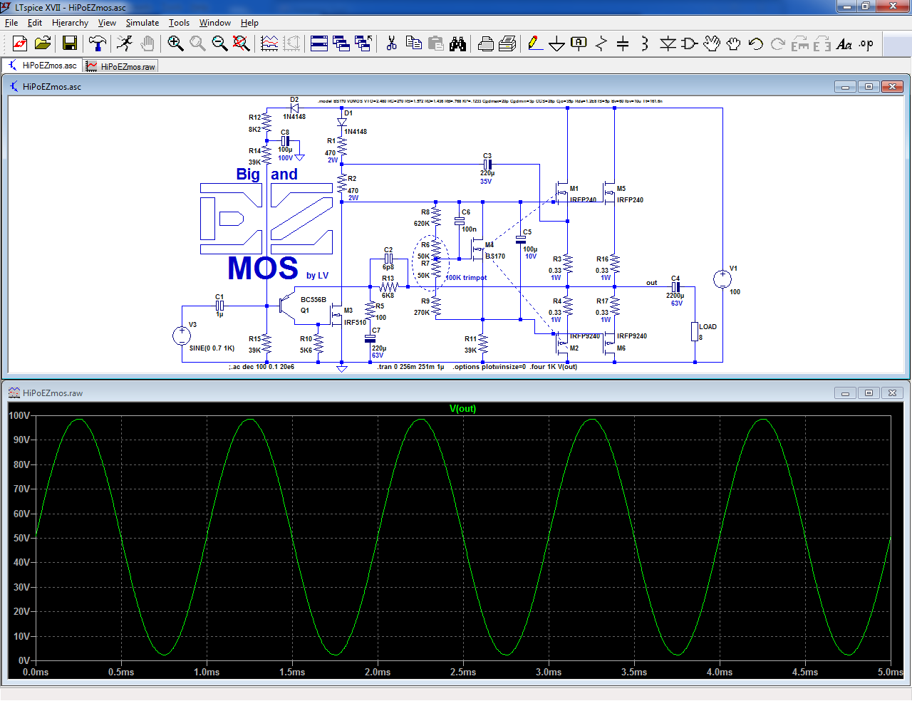

Easy-MOS is a simplistic, efficient and evolutive all-MOS amplifier for beginners
By popular demand, here is a beefed-up version of EZmos: in this example, it can deliver ~150W/8Ω, but other sizes are possible.
The changes required are relatively minor, and they can be applied to any of the versions: cascoded, auto-bias, etc.
Note that like most of the single-supply amplifiers, EZmos will generate a significant power-on thump.
For smaller versions, that is something one can live with, but with 150W output (or more on 4Ω), it is prudent to take preventive measures, like a speaker delay-relay.
I will try to think of smarter solutions, built in the amplifier circuit itself.

One or two more points:
The high power version has not been physically tested: it works in sim, and it is not hugely different from the lower power one, thus the chances it works are good, but you can never be 100% sure until it is built and tested.
All the other versions have been tested, but at 35V supply max.
In the HiPo version, the VAS dissipates almost 3W, and needs a heatsink.
It is probably not necessary to keep such a high quiescent current in the VAS (~50mA), but I prefer to leave everything in the condition for the moment, as a lower current might impact the SR and loop-stability.
Feel free to experiment if you build that version, and report the results: both positive and negative ones are welcome (negatives tend to be more useful for improvements)

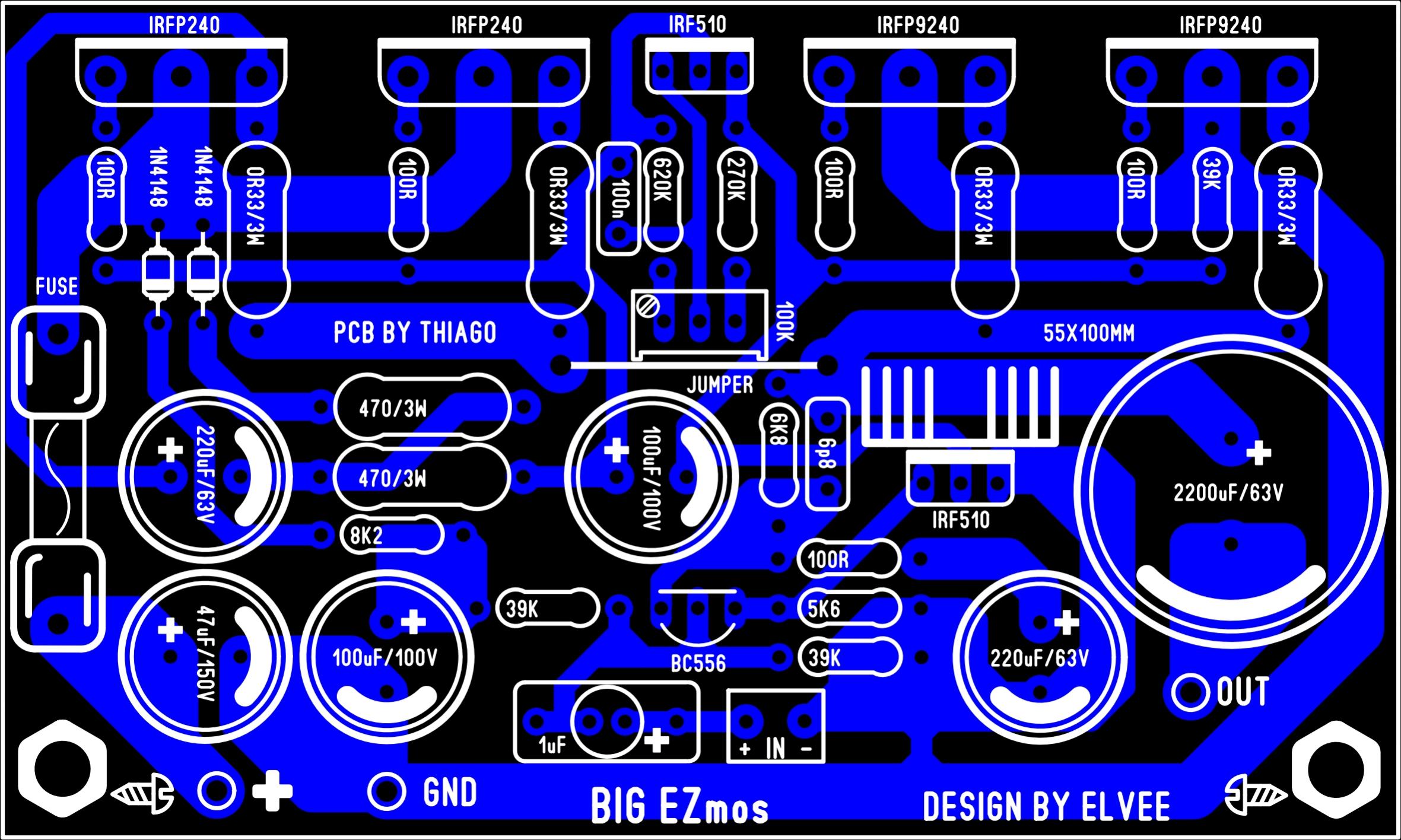

An observation on that PCB layout - the feedback path is taken from the wrong place on the output node - it should come from the output capacitor, where the two non-linear currents of the output devices have already been summed. If PCB traces were really zero resistance this wouldn't be an issue, but they have resistance. See slide #69 on this presentation: 1 AES AMSTERDAM 2008 Power Amplifier Workshop. 2 Power amplifier configurations The standard configuration Single differential input stage + push-pull. - ppt download
Neat design, but I was going to give the same advice as Mark:
One or two additional suggestions:
-Include an on-board fuse: single supply amps are easy to protect that way, and it is worth including, even if builders chose to strap it instead.
-Include a local bypass cap (not critical, 47µ/160V for example): the design is relatively insensitive to the supply impedance, but if there is a significant wiring length between the main reservoir cap and the amplifier, it will be necessary.
I would also suggest to include all the possible options (cascode and auto-bias) on the board: it will give a maximum of flexibility, and if a builder chooses not to implement one of them, the components can simply be omitted or strapped.
I am currently refining the thump-minimizing network, and implementing it would definitely be worthwhile too.
I am going to prepare a new schematic showing explicitly all of the above.

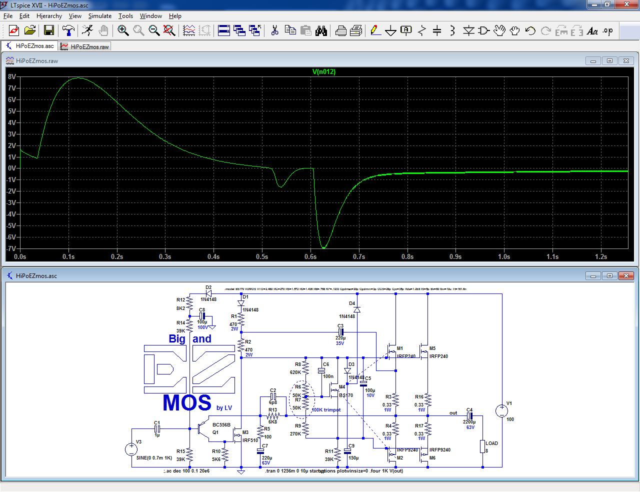

The thump-killer circuit is trickier to implement than what I expected: one of the main difficulties resides in the bootstrapping/over-the-rails drive of the MOSFets.
It conflicts with two of the main requirements of such a network:
a) Be totally transparent and inobstrusive after startup
b) Reset to initial conditions when the power is removed
Here is the conventional approach (D3, D4, C9):
attachment.php
It has a number of issues: a thump and an after-bounce remain (7 to 8V), and D3 and D4 will clip positive excursions.
A zener could be placed in series with D4, but C9 will be left more or less floating, because a leakage resistor to V+ will also cause marginal clipping/distortion.

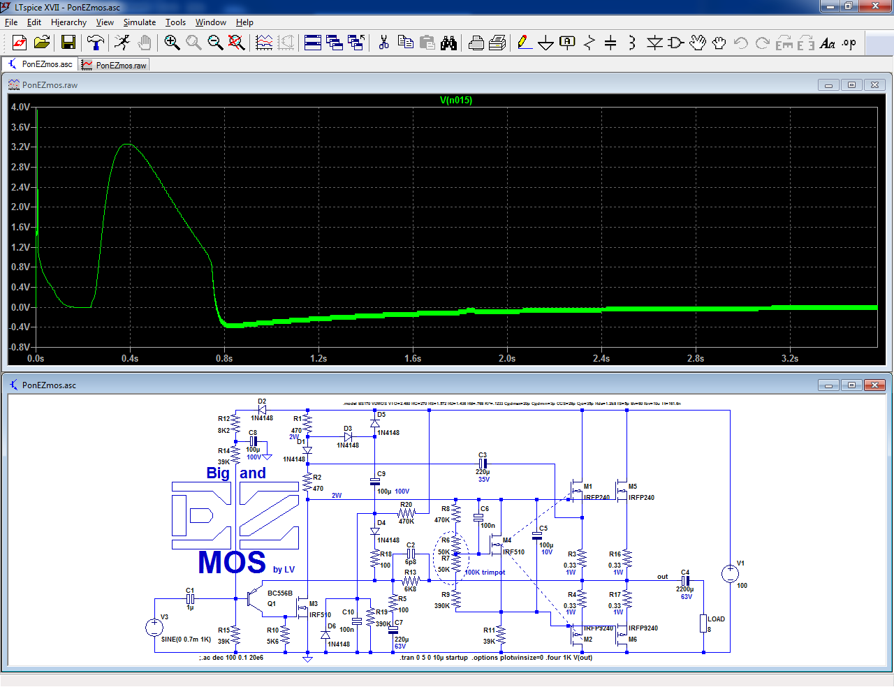

A more elaborate solution is this circuit: it reduces the amplitude of the thump, and it takes care of all the other issues: bounce, injection of unwanted distorted signal, capacitor reset, etc.
(D3 to 6, C9, 10, R18 to R20)
attachment.php
It is rather complicated though (but not expensive).
If someone can spot a weakness or has a better idea, I welcome any comment or criticism.

You could insert a series cap-multiplier with sufficient t-const before the D1 (or also the input bias via D2). Crude and rude. Say, 2sec of slow rise. (Slow ramping instead of clamping; it even rhymes).
Yes, if the rise is slow enough, there will be no thump or bounce, but I try to use crude and rude solutions only as a last resort.
We will see what consensus will emerge: we are not in a hurry

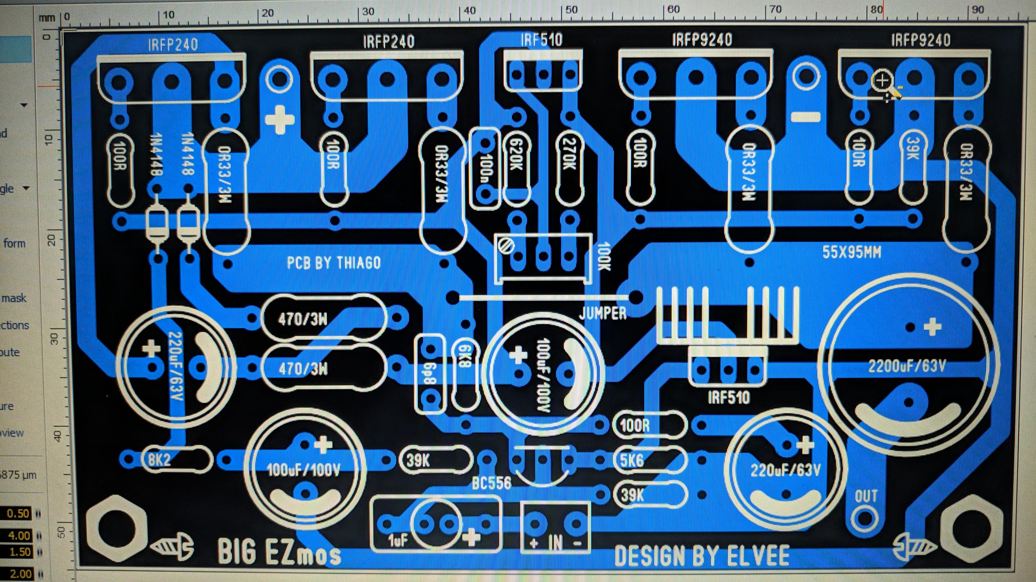

New layout, hope this is better. thanks
That is a significant improvement over the previous version.
Some nitpickers might still argue, but that would apply to a ppm-THD capable amplifier, which is not the case here: currently, the THD is around 0.025%, and there is no point in further improvement (for this particular aspect).
I am going to produce a schematic including all the options and improvements, so do not hurry to spend efforts and time on other versions for now, unless members prefer single-purpose PCB's: plain vanilla for this one, cascoded for another one, auto-bias, anti-thump, etc.
I think that a common PCB is the best solution, because some people might already have a speaker relay installed in their frame, others will hate the auto-bias idea, etc: a single PCB design can cover cover any mix of options, with little penalty regarding size or complexity: the amplifier equivalent of a swiss knife.
