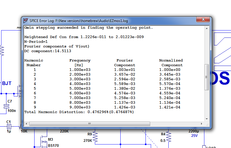

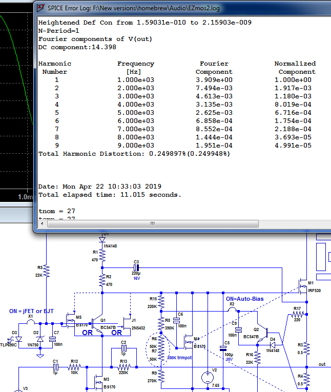

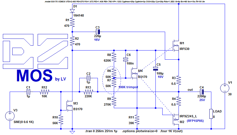

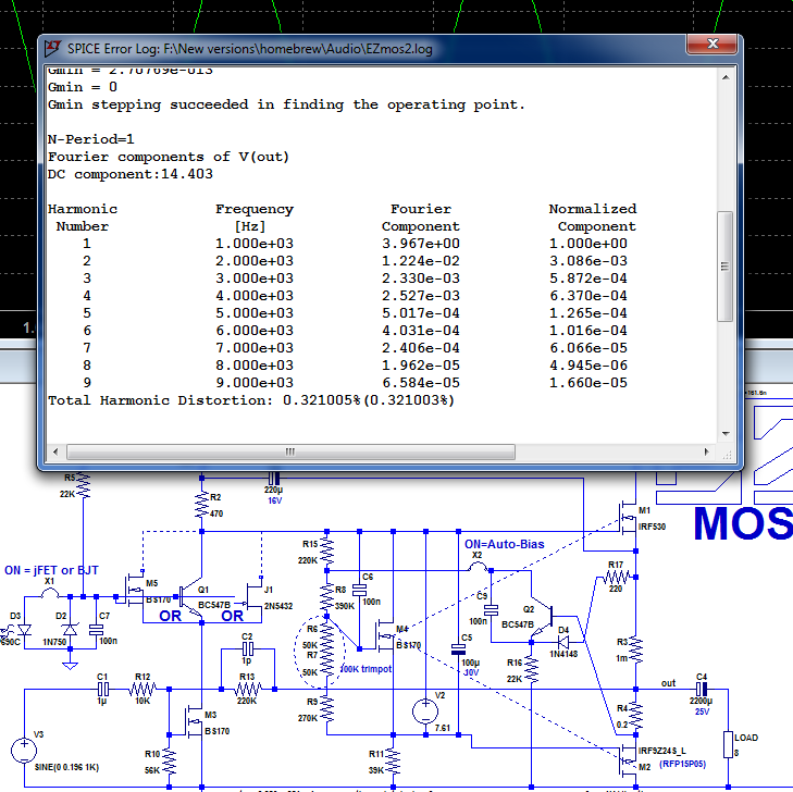

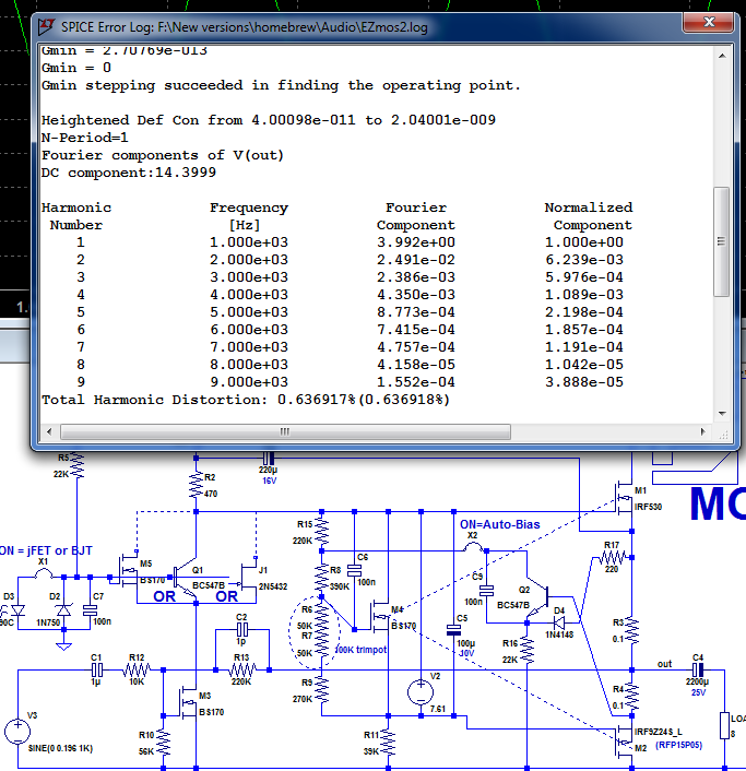

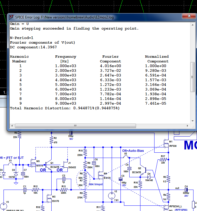

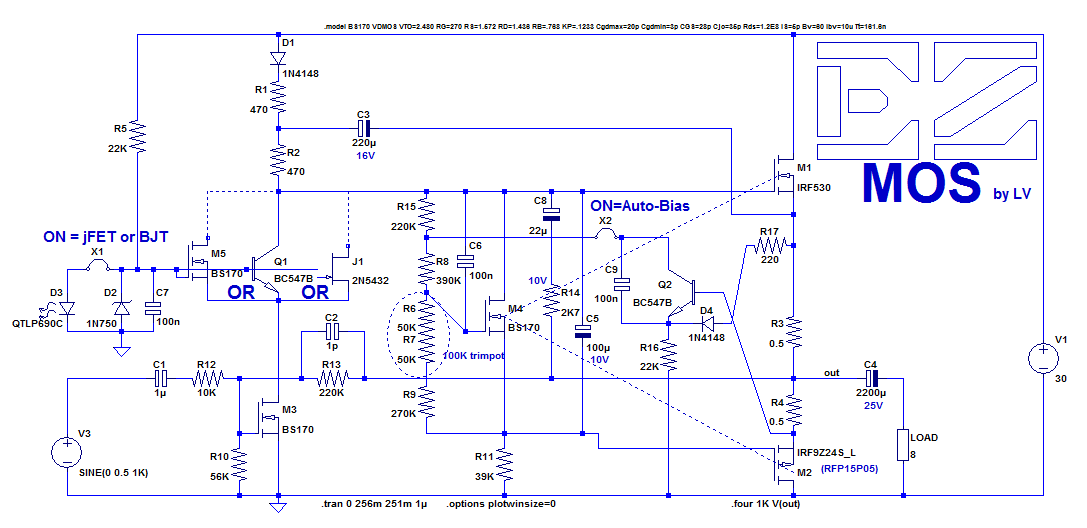

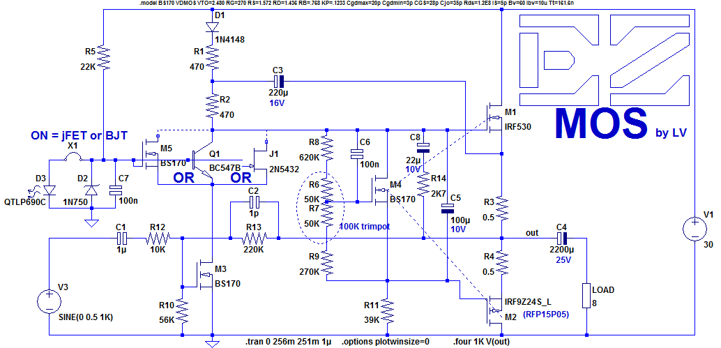

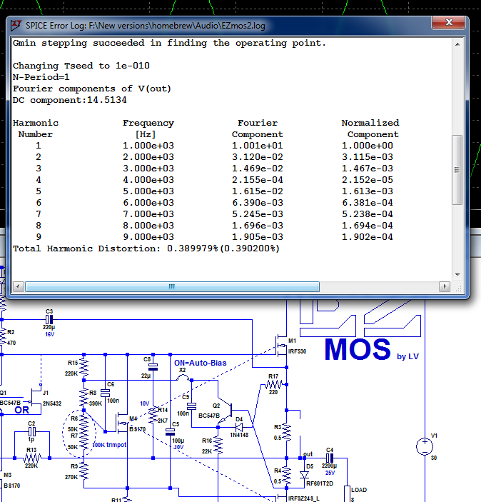

Clipping behavior
I was playing with some old downloads and I dug up this one and found that the clipping behavior was not great. When the gate is driven outside the linear range, there is a delay to return the gate back to a useful voltage. This creates rail sticking, and, shoot through currents when coming out of clipping.
I had assumed that people put Zeners on MOS gates to protect them from over voltage, but it seems it also reduces rail sticking and shoot through. If the power MOS vto are small wrt the on voltage, you might also want a series diode to block forward Zener current.
And there is also a similar issue with a MOS VAS, but you need a stack of diodes instead of a Schottky because the gate has to stay up at vto, which is about 2V.
  • EZmos-0id.asc
I think you _always_ want to block forward zener current, so either a series diode, back-to-back zeners (available in a single package in SMT!), or a bidirectional TVS diode.
Whatever the forward drive voltage one MOSFET sees will be the negative drive on the other one, and any diode conduction due to this will modulate the VAS current and cause distortion. So make the protection components electrically invisible during normal operation.
It depends on the value of the MOS vto. If vto is 4V and clipping happens before each MOS gets to 8V then the zeners will never be forward biased. It's possible that plain 1n4148 on each gate could be used to limit the gate voltage to 2x the bias (vto) voltage, ie each diode protecting the opposite gate, but my simulations say that it should be about 6V and 8V would be too high, depends on the MOS. This is an old simple current limit circuit used on BJTs, not used much because the limit is not very well defined. That's another thing that limiting the gate voltage does, current limit.
You won't see shoot through current in the clipping voltage, and rail sticking is not usually visible at 1KHz.
