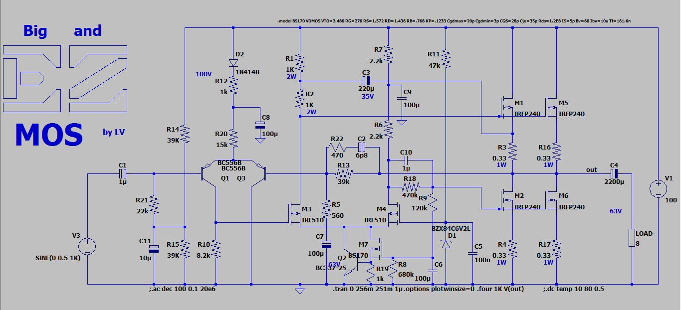

Another issue that needs to be tackled with the N version, if it is to become actually buildable, is the quiescent current stability vs. temperature and vs. supply voltage.
Currently, none of the variants (Steveu's and mine) is acceptable in those respects: ideally, Iq should be reasonably stable for supply variations of, say +/-25% at least, and the overall tempco in sim should be negative, but reasonably so (the tempco needs to be negative, because in the real world, the thermal contact between the sensor and OP transistors is largely imperfect)
and next issue
So this addresses those issues somewhat.
1. a diff-amp input does not drop a lot of bias on the feedback so the output remains centered over a wide range of supply voltage. An LTP current source would be better but I'm trying to keep this as simple as possible, so I picked R20 to provide enough current from 50VDC.
2. Adding a ~Darlington transistor to M7 makes it more stable over a range of currents that come from different supply voltages. It also adds the BJT thermal behavior to the vto multiplier. Enough?
And the THD is down again. And I'm ~happy with the clipping behavior when you reduce the supply to 50V. Complicated circuits tend to do strange things when over-driven.
Adding current sources would solve the variable supply issues but then you have a ~complicated circuit. I really like current mirrors between the diff-amp and the VAS, but again, that's more transistors.
An issue I would like to hear from LV about is the trade-off between VAS current and FET slew. I don't like large resistors. Just how fast do we need to slew? Class-B drivers would reduce the resistor heat but boot strapping drivers gets messy.

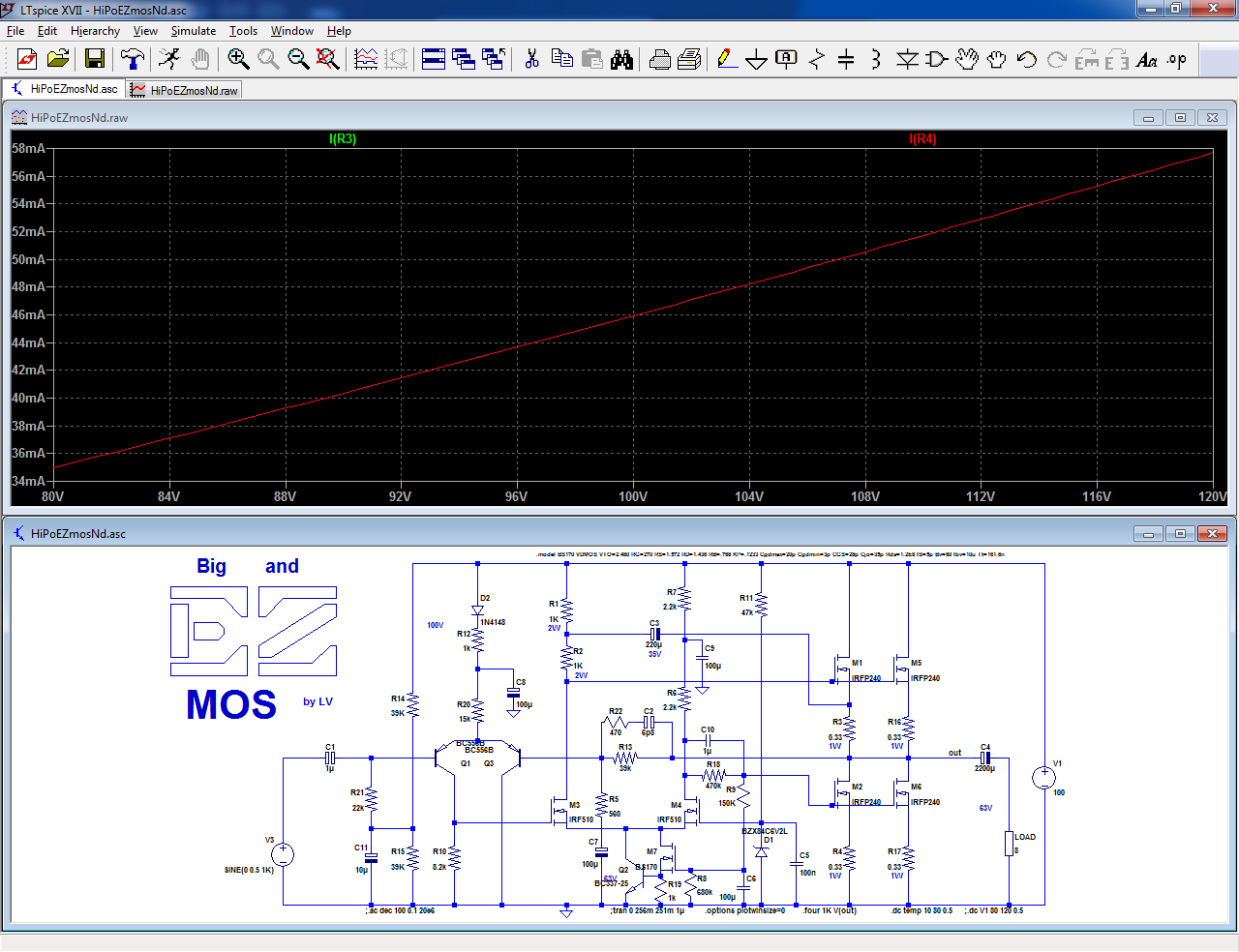

The DC centering is not a problem, even without diff: the drop on the FB resistor is highly predictable because the current is defined by R10 and the reference input of the VAS.
This means that a zener or a LED(s) in series with the input bias resistor is sufficient for a good compensation.

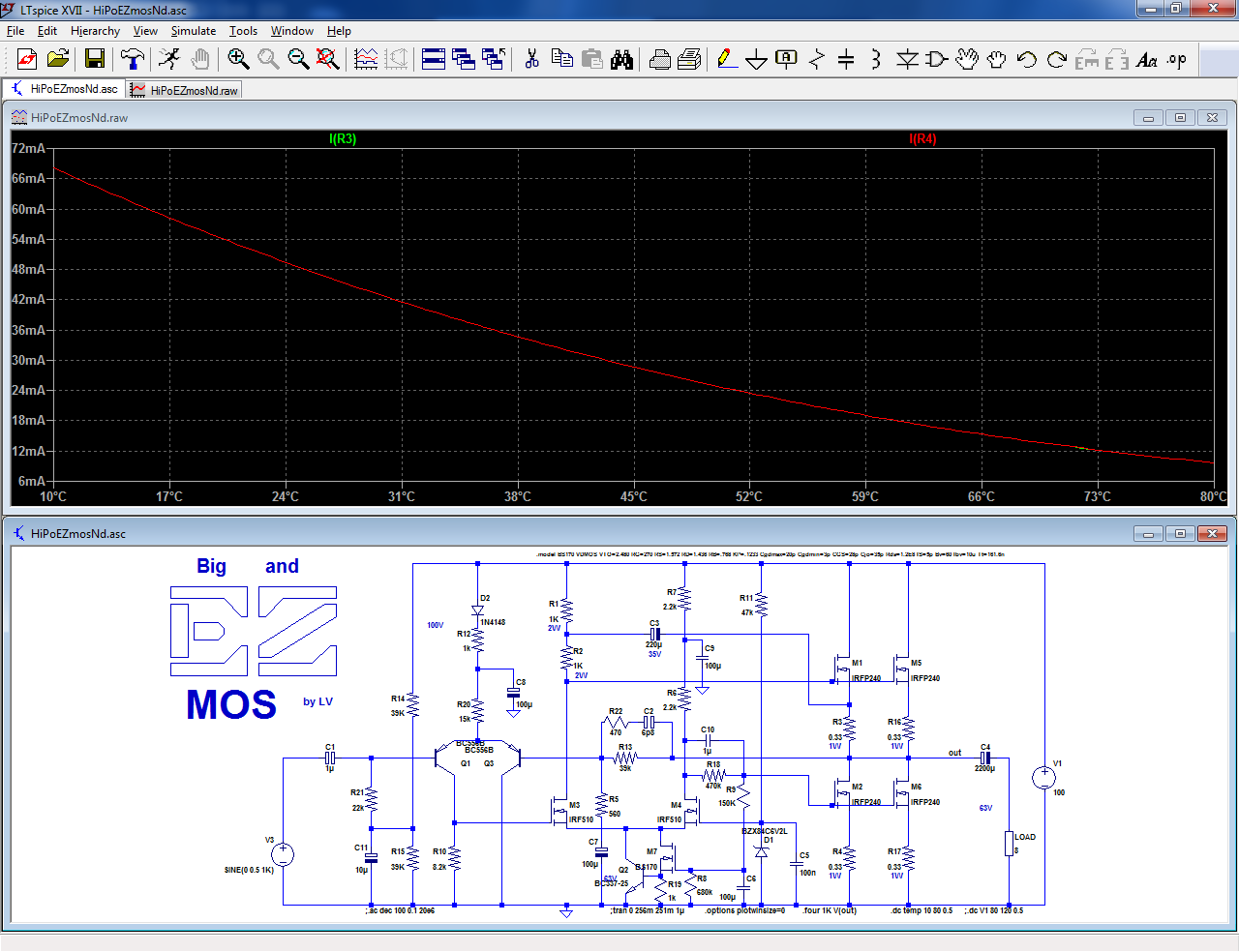

Regarding supply variation, it is not perfect, but it is good enough (I increased R9 to get a more realistic Iq):
attachment.php
The tempco is now negative, but it is much too strong: for a 10 to 80° range, it varies in a 10 to 1 ratio, which is excessive (1 to 1.5 or 2 would be more reasonable)
attachment.php

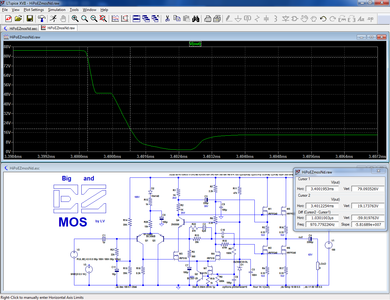

The main problem currently is caused by the VAS Miller: the positive SR is 8.6V/µs and the negative one 25V/µs, clearly insufficient.
A cascode improves matters for the positive, 80V/µs, but the negative slew has a nasty artifact, probably caused by M2 M6's Miller:

tempco and slew

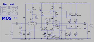

I ran into some strange behavior, including trying the cascode transistor, but I wanted to share a better tempco alternative, ie use a PNP at Q2. The tempco is still negative but not as much because the BJT is not part of the multiplier.
How much slew is enough is an old argument, and you could argue that 2 pi 20k Vp or 0.126/uS * VPk (6.3V/uS for 50VPk) is enough. But I think at least 2 to one margin is wise, ie 12V/uS. Of course if you want a 100KHz power bandwidth then you want more.
I am more concerned with the high power resistors and VAS transistor, so I have reduced the heat in this version.
Hopefully I will figure out what is causing some odds things and make the cascode etc work better. I did get some very low distortion at 1KHz but then I had bad things at 20KHz. I am ignoring my own advise to not waste time on this but hey, I'm retired and I enjoy it.
