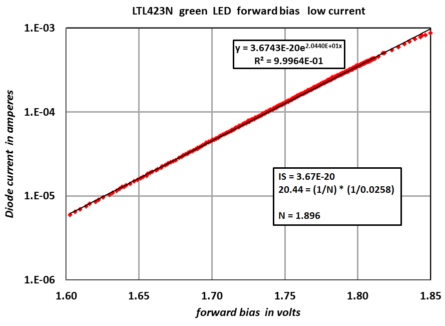

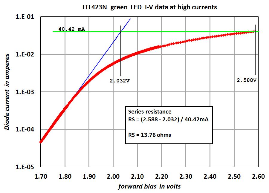

No, the forward drop depends on the bandgap of the particular semiconductor, which correlates strongly with the colour.~2V is standard forward drop for colored LEDs.
GaN LEDs are about 3--3.2V, this includes white, violet, blue and some green LEDs.
Common green LEDs are more like 2.5V,
yellow around 2.2V,
orange 2.0V
red 1.6V
infra-red 1.2V
But it does vary from these typical values depending on the structure of the LED and how hard its driven. These days LEDs use complex sets of layers to achieve quantum wells for efficiency (heterojunctions), so the effective bandgap is not necessarily natural for the colour produced, but needs to be enough to actually generate photons of that colour.

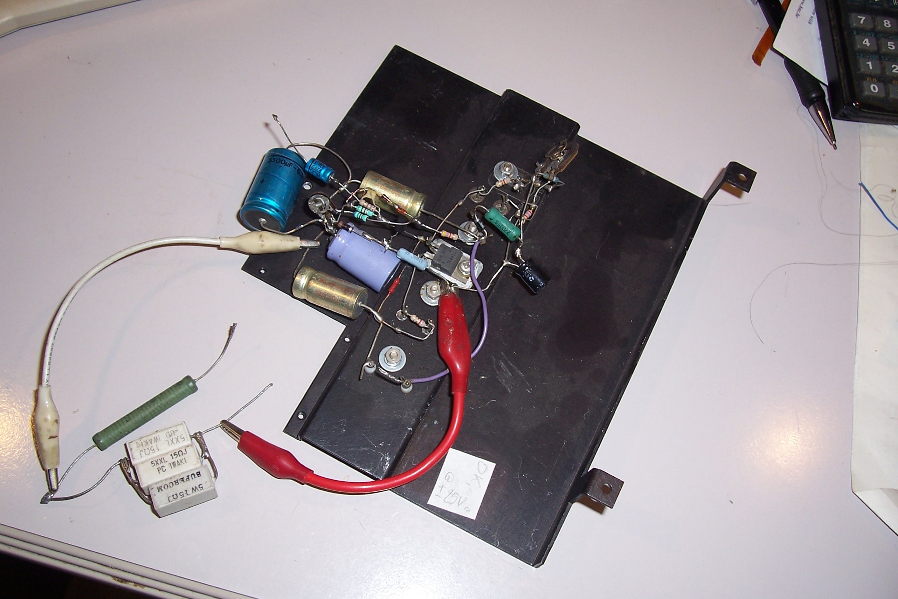

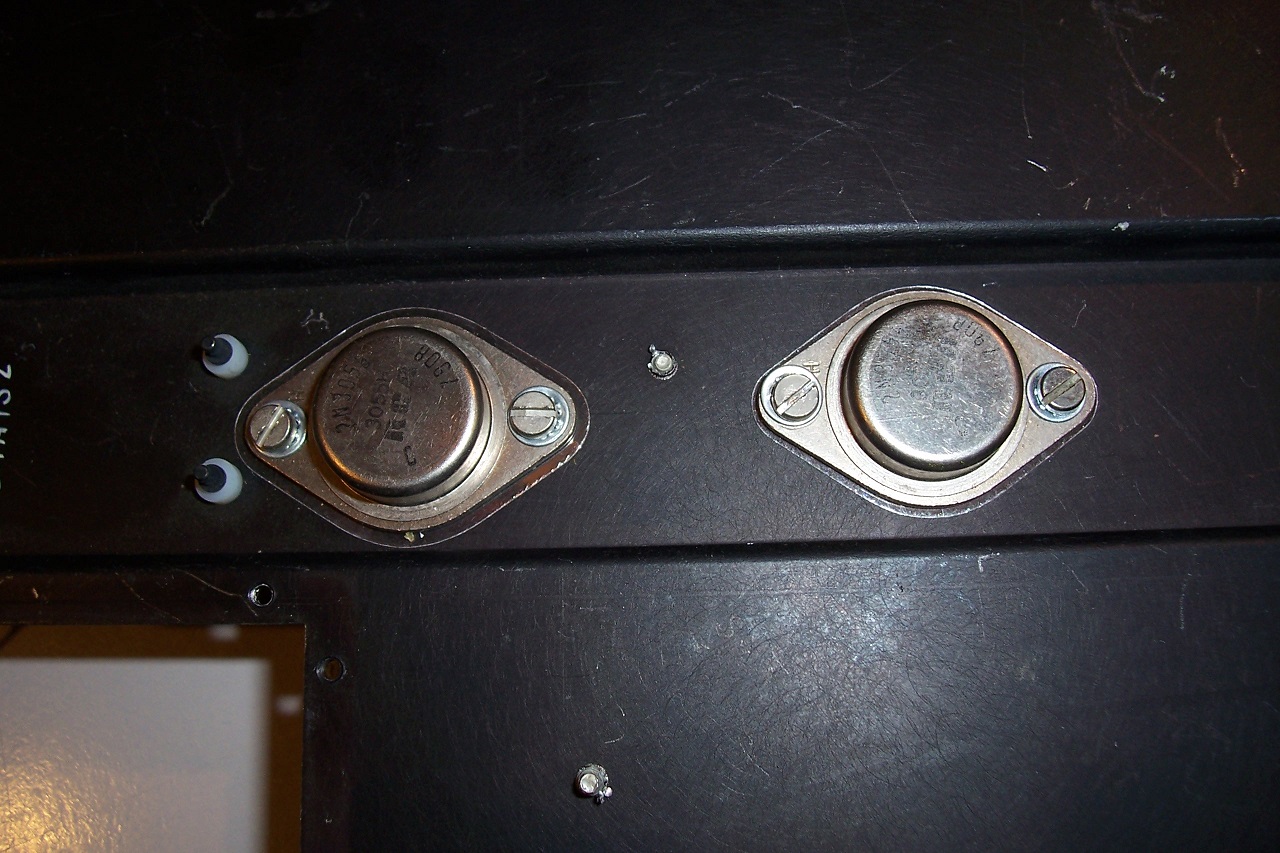

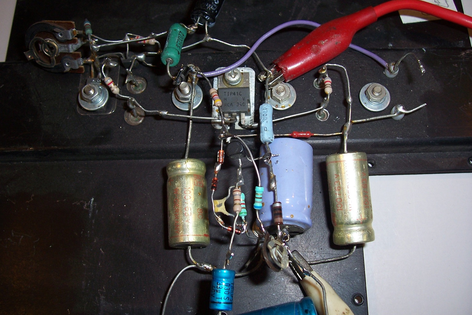

However, I have unearthed an interesting prototype in my huge "hardware archives", probably built 20 or 25 years ago, and apparently belonging to the "totem pole family", with a single phase-splitter.
I fired it up, and it woke up gracefully, delivering >50W on a 5 ohm load.
The THD is comprised between 0.05% and 0.5%, depending on the output power and the load.
Interestingly, it does not use emitter resistors, yet has stable quiescent current, and although it has no diff-amp input, it is DC-coupled and uses a symetrical supply (but it is apparently a natively single-supply amp modded to work in symetrical mode).
I haven't found the schematic yet: my paper archives, notebooks, folders etc form heap 2~3feet high, so it may take some time.
In fact, it might be simpler to reverse-engineer it, since it only count 6 transistors.
It fits your bill anyway, and it would probably be fun to see how it simulates (it was built and tested well before the sim era)

But that will give much poorer regulation. LEDs are stiffer voltage sources than a string of many pn-junctions - basically you want one junction only if possible. Above 5V or so zeners start to become usable voltage sources, but the low voltage ones are the soggiest sources. Zeners need decoupling to reduce the noise.
LEDs are great little non-critical voltage sources because they come in a range of voltages, can double-up as status indicators, and are low noise (compared to zeners).

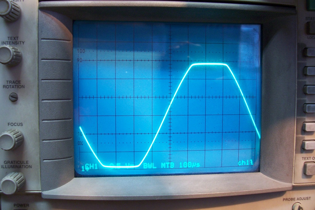

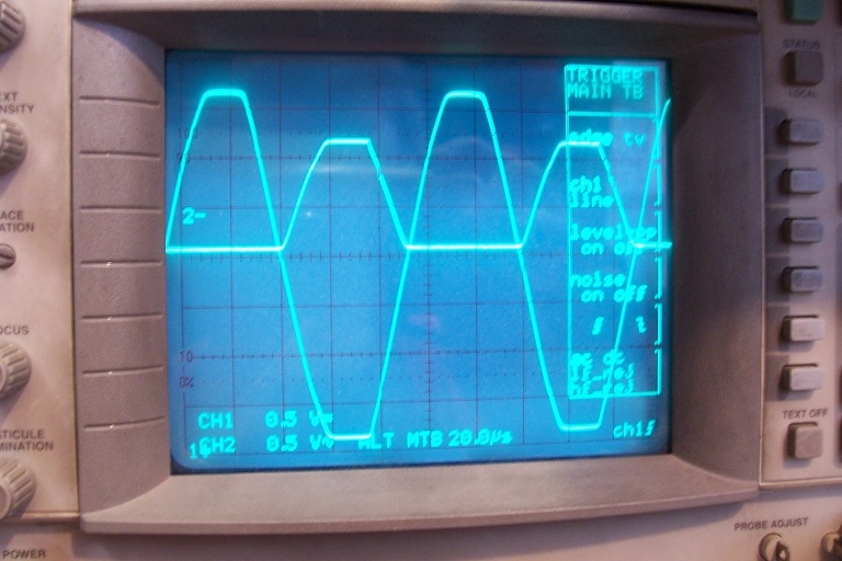

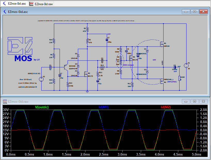

Clipping behavior
I was playing with some old downloads and I dug up this one and found that the clipping behavior was not great. When the gate is driven outside the linear range, there is a delay to return the gate back to a useful voltage. This creates rail sticking, and, shoot through currents when coming out of clipping.
I had assumed that people put Zeners on MOS gates to protect them from over voltage, but it seems it also reduces rail sticking and shoot through. If the power MOS vto are small wrt the on voltage, you might also want a series diode to block forward Zener current.
And there is also a similar issue with a MOS VAS, but you need a stack of diodes instead of a Schottky because the gate has to stay up at vto, which is about 2V.

I think you _always_ want to block forward zener current, so either a series diode, back-to-back zeners (available in a single package in SMT!), or a bidirectional TVS diode.I was playing with some old downloads and I dug up this one and found that the clipping behavior was not great. When the gate is driven outside the linear range, there is a delay to return the gate back to a useful voltage. This creates rail sticking, and, shoot through currents when coming out of clipping.
Whatever the forward drive voltage one MOSFET sees will be the negative drive on the other one, and any diode conduction due to this will modulate the VAS current and cause distortion. So make the protection components electrically invisible during normal operation.
It depends on the value of the MOS vto. If vto is 4V and clipping happens before each MOS gets to 8V then the zeners will never be forward biased. It's possible that plain 1n4148 on each gate could be used to limit the gate voltage to 2x the bias (vto) voltage, ie each diode protecting the opposite gate, but my simulations say that it should be about 6V and 8V would be too high, depends on the MOS. This is an old simple current limit circuit used on BJTs, not used much because the limit is not very well defined. That's another thing that limiting the gate voltage does, current limit.
You won't see shoot through current in the clipping voltage, and rail sticking is not usually visible at 1KHz.
