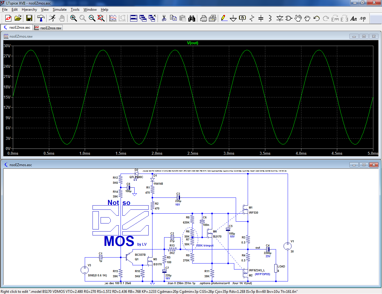

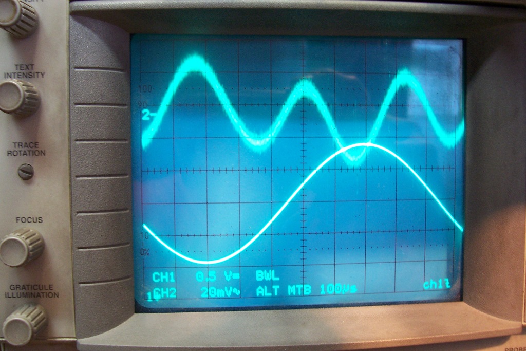

Well that's predominantly 3rd harmonic on screen, so I'm unconvinced by the spice values...Because of the non-symetrical topology and the low feedback, low-order, even harmonics tend to be dominant.
Here is the THD residue (0.15%) together with the output signal:
Well, neither am I, but that's the untampered reality, and to be honest the PMOS I used is different from the sim.
I tried to use a P-type that minimized the overall dist, because that's in fact what I prefer (except if the residue is something like Xover dist, which I hate).
This also explains why the measured THD is lower than the simmed one, a moderately rare instance.
Because complementarity does not actually exist for P or N MOS transistors, you are ~free to chose the ones that give you your preferred profile.
Another way of altering easily the profile is to make the source resistors different: it works in sim, and it will also work in reality (I didn't try it, but I am confident it will)

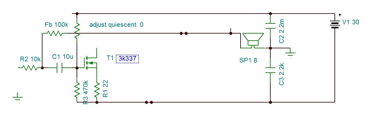

Here is an implementation example, based on the most basic version of EZmos (it can be applied to the more evolved variants too):
It becomes self-centering for a wide supply range and C7 acts as an inverting input and can be tied to a current-sensing resistor to alter the output impedance.
Side benefits also include a lower THD level (0.025%) and a higher input impedance.
I had to read the THD figure six times before it finally sank in how very low/good that is for a fet amp. Awesome. EasierMOS?...self-centering for a wide supply range and C7 acts as an inverting input and can be tied to a current-sensing resistor to alter the output impedance.

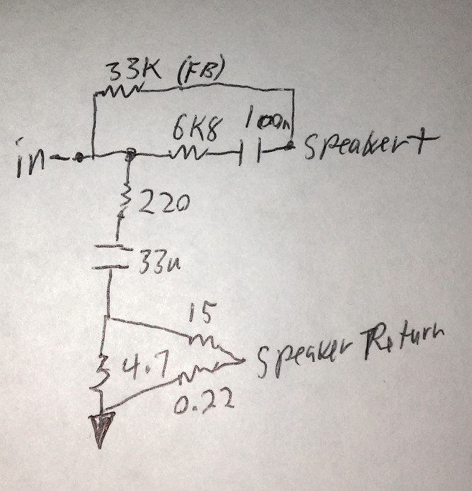

Attached: If I drew it right (not sure), the attachment has partial current drive.
I don't know how to hook that up correctly, together with auto center power (post32). They're both transparently mild; however, that combination of output functionality typically involves tubes/valves and a really flat wallet. So, it would be wonderful to do the job affordably solid state.
