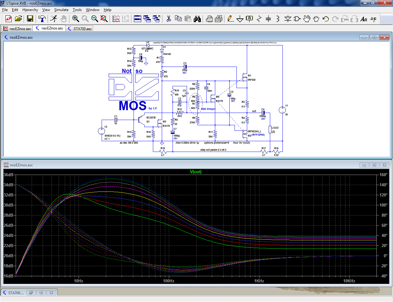

It looks very much like the example you sent me a few weeks ago.
It won't work very well in this condition, because the 33K FB resistor of your schematic is in fact the 2K2 FB of the latest EZmos version, and most other components should be scaled according to that resistor (not the 0.22ohm though).
The closed loop gain of the two amplifiers is different too, and that should also be taken into account.
However, the compensation needs to be tailored to the actual speaker, which means that you will need a lot of experimenting to find the right value(s) anyway.
As a starting point, you could use the same 0.22/4.7/15 triangle, to which you connect the 100ohm/220µ network of the EZmos, and the 2K2 FB.
You can then play with the 4.7 and 15 ohm to change the overall output impedance, and add a RC similar to the 6K8/100n to adjust the frequency response.
The end result will depend very much on your tastes and the speaker used.
Satisfactory values for one type of speaker will not be applicable to another one

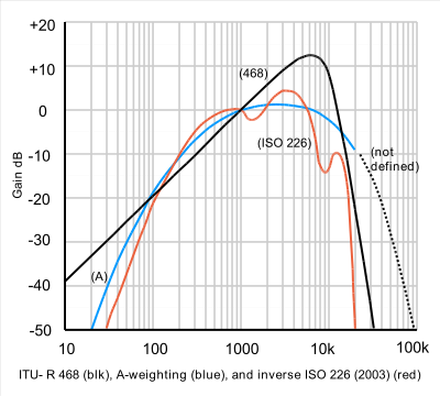

Oh, I see the problem.
I have made an error!
The target for 'matching' apparently wasn't a speaker. That got me confused.

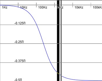

In the first attachment (that rc by itself), I've added the big black stripes at ear sensitivity peak frequencies.
In the second attachment, ISO226 is a good match for that shelf filter.
The production unit sounds like it matches any speaker because they had matched an ear instead.

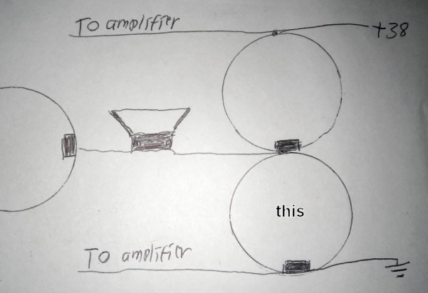

auto center power:
In the attachment is the simple method. The big cap marked "this" is the only part added to quick fit auto center power to a single rail amplifier. Practically, this one added part would do one of two possibilities: Either nothing noteworthy, Or a natural way to work more like a tube amplifier.

I finally understood what "auto-center" was.
In fact, the output cap could be eliminated completely, because it is in series with the ones straddling the supplies.
The configuration will not naturally work with a normal, single supply amplifier, unless the supply is perfectly clean, because the output will see ~half the ripple present on the supply.
It is probably possible to arrange the FB network in a way that cancels this ripple (clean, regulated supplies are inconvenient).
I will think about it

"auto-center" (sic) PSUs used to be the cheapest-of-the cheap way to work with a "dual-rail" (biplar supply) amp and a single-winding trafo. Usually a bridge, a resistor divider (faux-ground) and two reservoir caps. Often seen with the likes of TDA2030 or other cheap amplification etc.
I am afraid the inclusion of the "auto-center" feature is not going to be realistically possible: it requires the input and output GND's to sit at different AC potentials, which is not very healthy anyway, and to avoid injecting ripple into the speaker, some of that ripple needs to be injected into the (+) input of the amplifier.
This is problematic, because the source impedance will affect the compensating signal, meaning it will not be very accurate, and if the input is left open, the result will be disastrous.
This amplifier and the Old-Fashioned have been designed for a single-supply, and whilst conversion to a bipolar one would be possible, it needs to be complete, ie. both input and output referenced to the 0V, or the middle of the capacitive bridge if the GND is virtual.
A hybrid solution is not going to work very well, and will require extra complication, or a super-clean supply, none of which is desirable.
...avoid injecting ripple into the speaker...A hybrid solution is not going to work very well, and will require extra complication, or a super-clean supply, none of which is desirable.
