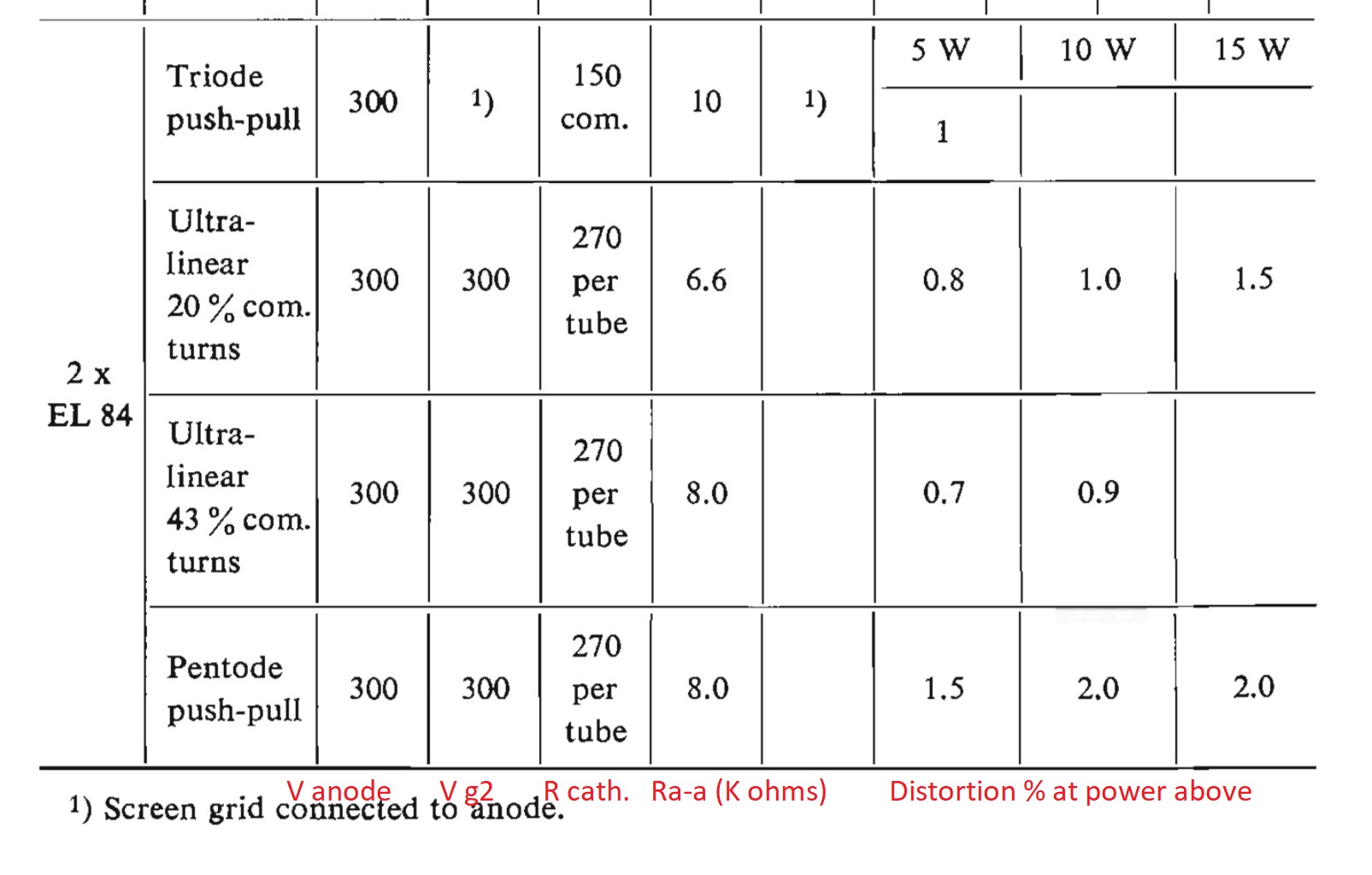

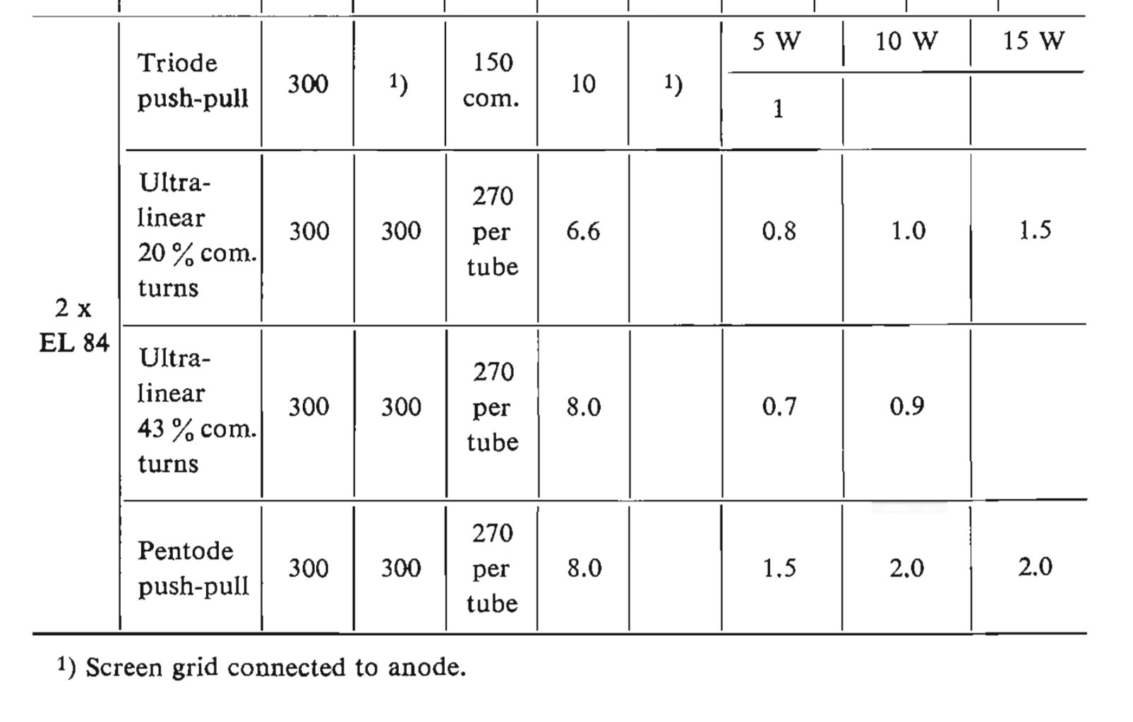

Interesting that Rodenhuis found that PP EL84 pair with 270 volts produces 10 watts into 6.6k UL 20% at 1% distortion, while it makes 10 watts into 8k UL 43% at 0.9%. Wonder what the figures are for these transformers with plate voltage at the more typical 300 volts.

Francois,
Please see my additions to the chart in post 84. The first two columns are volts. The third column is cathode resistor per tube. Yes, for a 20% UL tap you get less more power but also more distortion. It's interesting that almost all guitar amps run pentode mode. Pentode, from graphs I've seen, have a more straight-line distortion curve, distortion vs power. Maybe that's what guitar players like.

Steve, you are correct regarding voltages! Sorry, my mind wandered on the anode voltage. What got me off track was actually puzzling why Rodenhuis did not have an entry for UL43% distortion at a power output of 15 watts. Perhaps you can’t get 15 watts under those conditions.
43% Ultra Linear negative feedback is only 7 dB away from Triode Wired. And Triode Wired is by far the lowest power mode.
Getting 15 Watts from push pull EL84s and 43% UL, if at all possible, will have very high distortion at that power level.

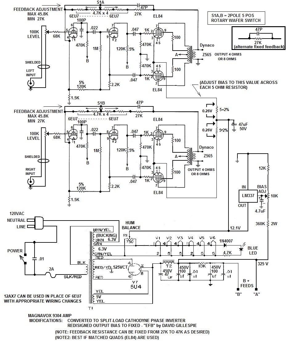

I've seen the Gillespie article and what bothers me is that like the Dynaco it's based on all of the EL84 cathodes are connected together. Unless the tubes match and age perfectly unbalanced DC conditions could result in the output transformer(s). I prefer to individually bias the tubes using the DIYtube.com method I showed in post 20. It has worked well for me on a couple of builds, Just my 2 cents.
So far, since 2006, the EL84 amp that I built, and later modded with Gillespie's bias method has never given me problems, and I get around 17 watts/ch before clipping.
I used an old Magnavox 93 series chassis and it's PT and choke, but everything else is my design.
Seductive and accurate amp it is!
Steve,
Good point! However, even if you bias individual power tubes AT the quiescent point of operation, can you be sure in a PP pair their curves match all the way up to maximum power? I think not. So, I think it is a bit academic to fret too much over individual bias, vs matched pairs and quads.
I rebuilt my Dyna SCA35 as per mr. Gillespie design, and with a matched quad it performed flawlessly, as attested to by wiseoldtech above. Recently the new amps I built, I must admit, featured individual bias 😁
