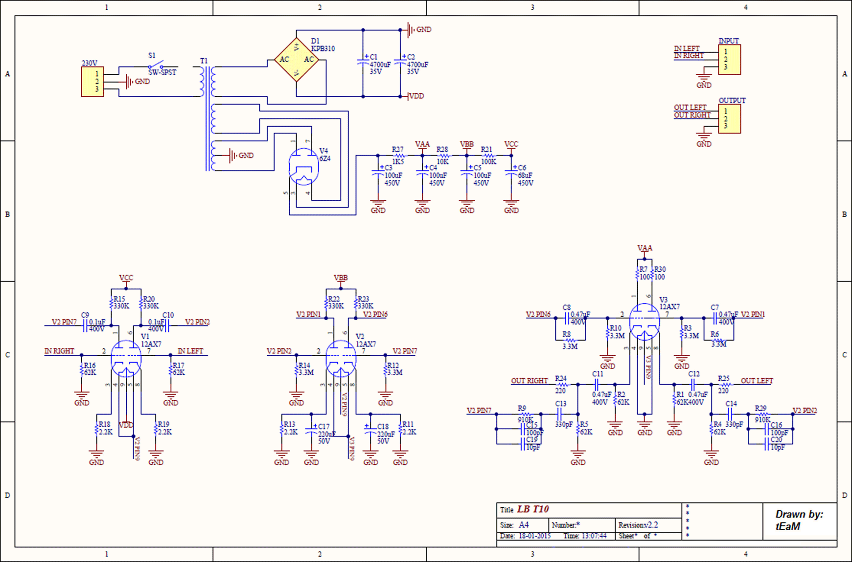

I'll attach the schematic for the t10 which is still the same. It's a phono preamp. It uses a 200-0-200v, 15v, and a 6.3v.
I should include that one of the reasons for me getting a custom PT for it is that it was built for 110v and after reading a very long post about the Little Bear people are reporting heater voltages at +12-13%. My line voltage here is 123v so I would like to get it right before I install my genalex's just in case it reduces tube life. I would like to make a bucking transformer in the meantime, has anyone here ever made one from a computer power supply transformer? (Just an idea i got while watching blueglow's youtube video on bucking transformers. I happen to have 2 old atx psu's lying around that will never get used.) Let me know if I'm getting too off topic and I'll start a new thread.

All you need to do with your little bear is put a resistor between capacitors C1 and C2, negative side. Use ohms law to figure it out. The tubes will draw about 0.9 amps.
Thanks Steve, will do. I asked why not do this on the huge Little Bear thread a while back and haven't got an answer yet, so now I can move on.

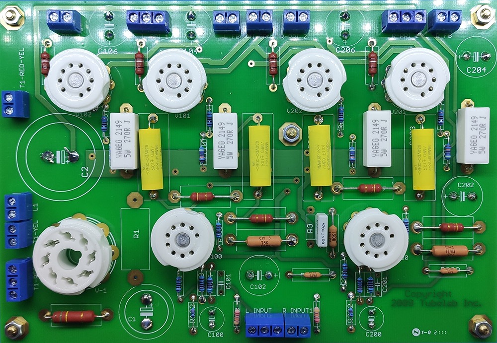

After building many solid state amps, I'd like to try building a ~10W tube amp (mains 230V).
Possibly with easy to find transformers and tubes.
Any recommended schematics, links or maybe kits available?

Jacques,
Depending on your B+ voltage the dissipation on the EL84s might run a bit hot with 270 ohm cathode resistors. Tubes being more difficult to procure these days......

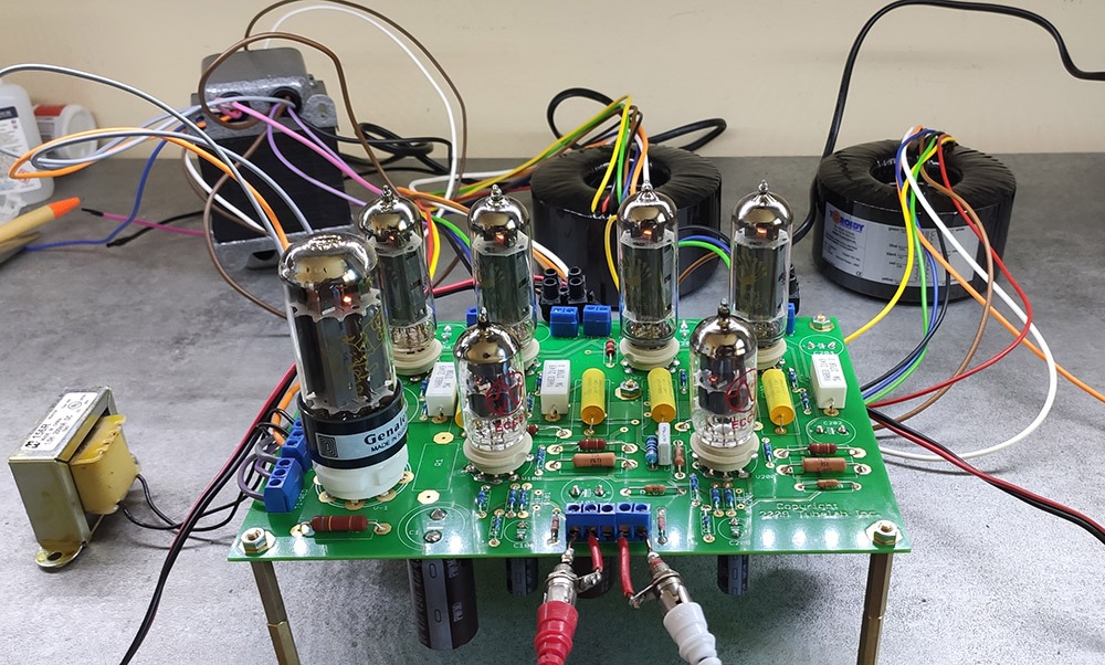

Jacques,
Good for you! The good thing about getting it running before it's in a chassis is you can experiment VERY, VERY, VERY carefully with transformer and choke positions to determine their best orientation for minimum hum induction. No test instruments required!
This seems like a very long procedure but trust me, it takes longer to read about than it actually does to perform.

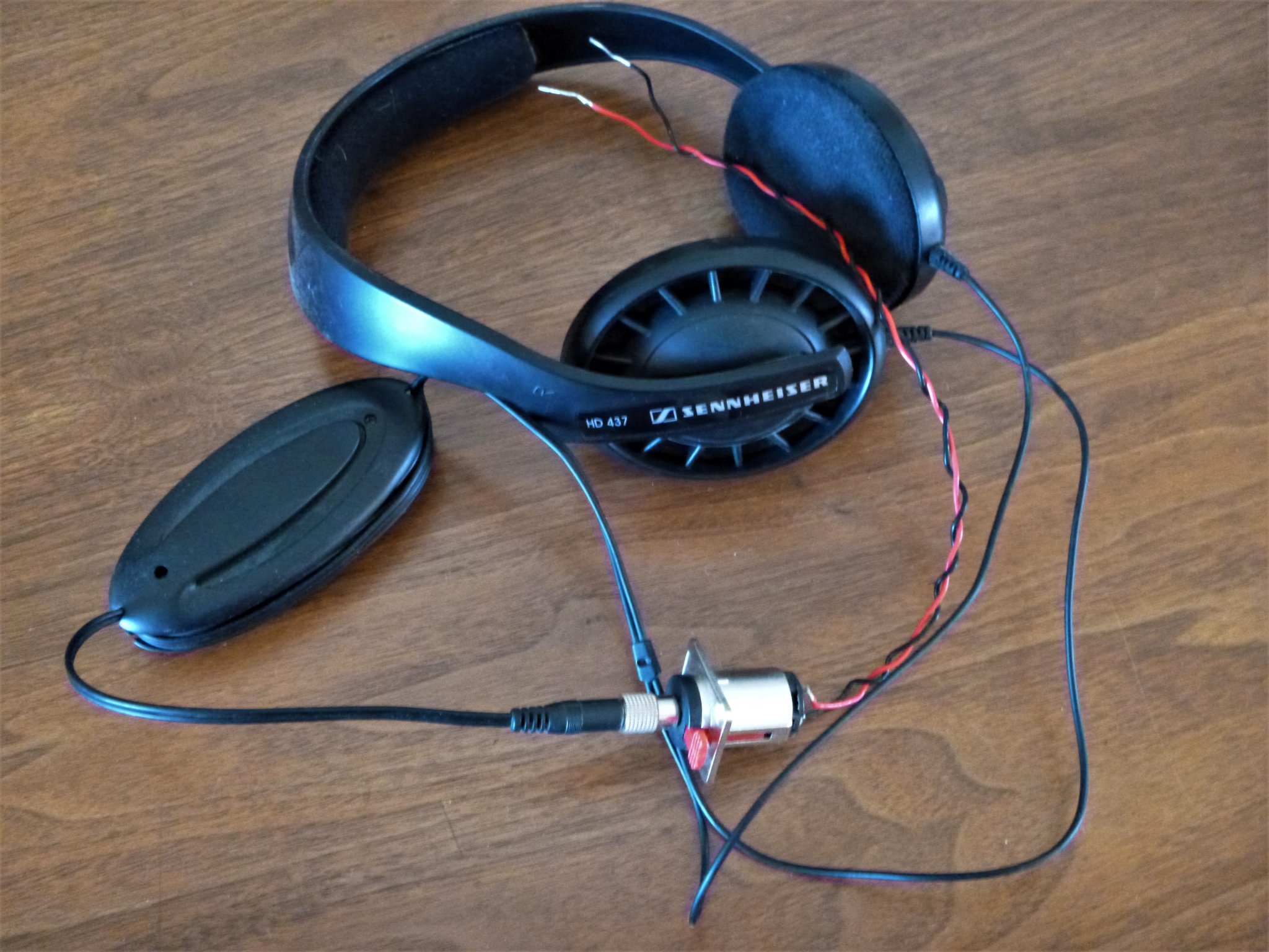

I use a cheap pair of headphones (see picture) meant for use with mobile devices and an adapter. They don't sound very good but have low impedance and are very sensitive as required by mobile devices.
Unplug your amp, let the capacitors discharge and replace the input jack connections with shorting links.
Before you start it's best if you twist all of the leads between the transformers and the board. This will help minimize radiated AC fields. Do these in pairs, 6.3 volt filament pair, 5 volt filament pair, high voltage pair. Also twist the choke pair.
Connect the amp signal ground. I used the connection in the middle of the input jack connector, to the ground on the AC inlet. This is necessary because leaving this connection off might give hum or noise that will mask what you are trying minimize with transformer position.
Use electrical tape to anchor the posts supporting the board to your work surface. This will prevent the board moving while you are experimenting.
It's best to load the output transformers with a resistor, anything between say, 5 and 25 ohms. 1/2 or 1 watt resistors are fine or you could just connect a speaker.
Arrange your transformers and choke in the position you plan in the chassis.
BE REALLY CAREFUL BECAUSE YOU WILL BE POWERING UP THE AMP AND YOU DON'T WANT TO ZAP YOURSELF.
Power the amp and let it warm up for a minute or two.
One possible source of hum is a large DC imbalance in the OP transformers. You can check this by measuring the voltage across the EL84 cathode resistors R112 and R116 of one channel and R212 and R216 of the other. Ideally, the voltage of each channel pair should be nearly identical. Swap around tubes to get the best matching pair in each channel if necessary.
Carefully touch the wires connected to the headphones to the speaker terminals of the channel closest to the power transformer. Ideally you should not hear any hum but there is almost always a little. A very faint hum in sensitive headphones will be totally inaudible when connected to speakers. A faint hiss might be heard but is nothing to worry about.
The power supply choke can often, in my experience, be the cause/source of hum.
If you work very, very carefully you can change the choke's position and orientation while the amp is running. (Wearing a heavy pair of rubber gloves should give you a bit of a safety factor.)
You may also experiment with the power transformer position and orientation as this might affect the output transformers. Since the OPTs are toroids their orientation shouldn't matter. Just keeping them as far as possible from the power trans should help.
Good luck and don't electrocute yourself!

Thanks Steve for the advice. The chassis is on its way and will try that.
I have ne audible hum at the moment: without signal, I cannot tell whether the amp is on or not.
While playing, I do have a slight imbalance though, in favor of the left channel. Swapping the ECC81's did not help. The EL84's are matched quadruples.
I wonder If I could tweak some resistor value on the board (maybe replace R105/205 with a trimpot ?) to correct that (I prefer not to use input pots).
Changing the value of R105/205 will not affect gain. What I suggest you do is measure and record the DC voltages at all pins on every tube (don't bother with the filaments). Compare the measured voltages for each channel, they should be with 10%. A difference could be down to a tube or perhaps a wrong resistor value.
