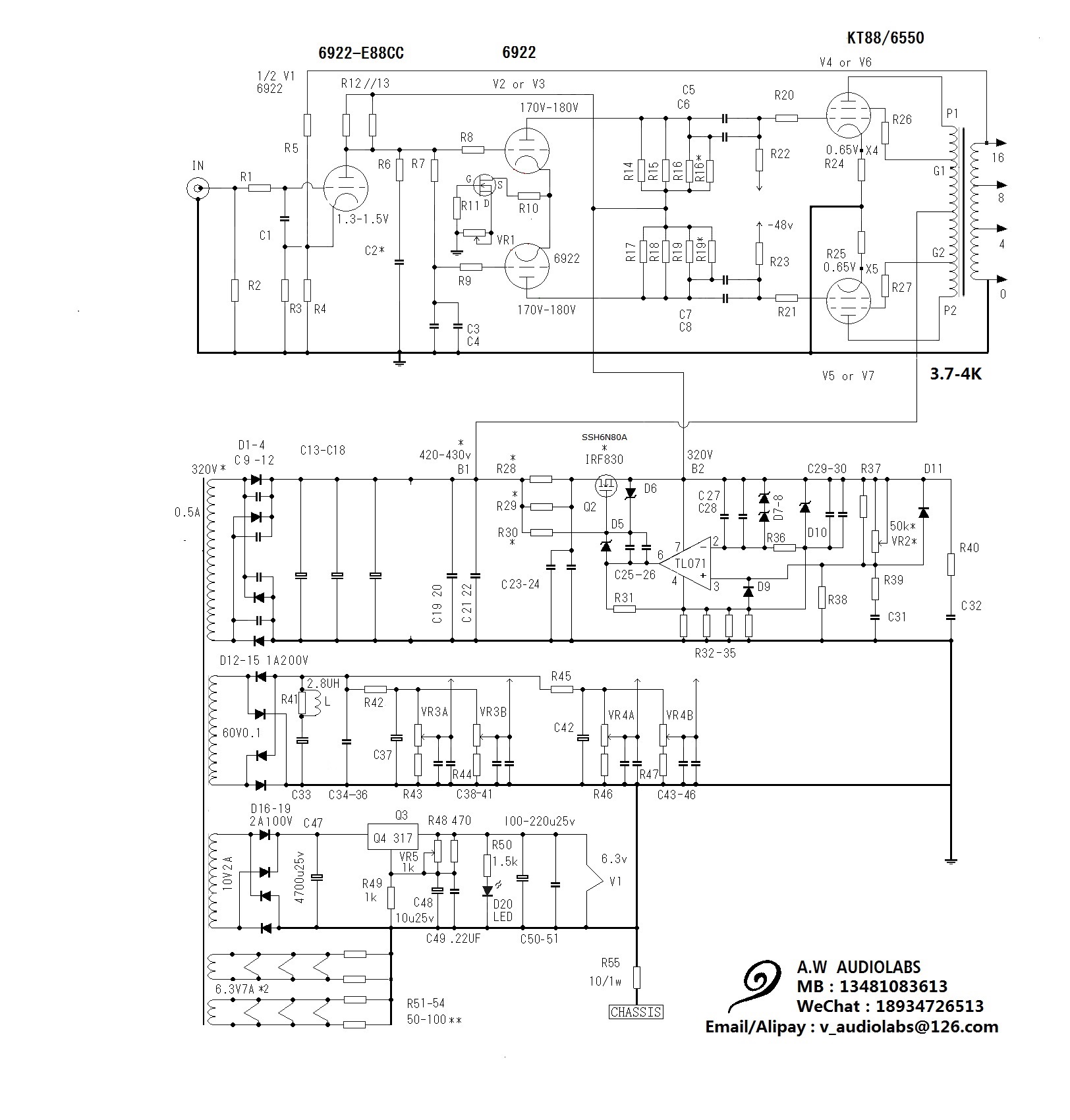

Hello,
I have a pcb based on a wiring diagram of the audio research VT60 SE, in the list of components are indicated RIKEN 2watt resistors - 4 x 200ohm, 4 x 10ohm and 1 x 1ohm, it is specified that they must be selected with a minimum deviation from the indicated value. Unfortunately they are almost impossible to find.
I bought vishay dale 2watt 200ohm 1% tolerance (CPF2200R00FKB14) - dale 2watt 10ohm 0.1% tolerance (CPF210R000BHE14) and dale 2watt 1ohm 0.5% tolerance (CPF21R0000DKB14).
I think there should be no problems with the operation, but I would like a guru's opinion.

Well they are exagerating, not only precision, but also al those parallel resistors 🤣

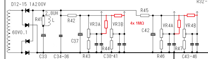

5% is close enough exept for R24-25. If you want exact reading of the bias current use 1%.
With all those resistors the importent ones are missing 😒
If a bias potmeter fails the tube has no negative grid voltage no more, not very healty.
To prevent a catastrophy put in 4 resistors.
Mona

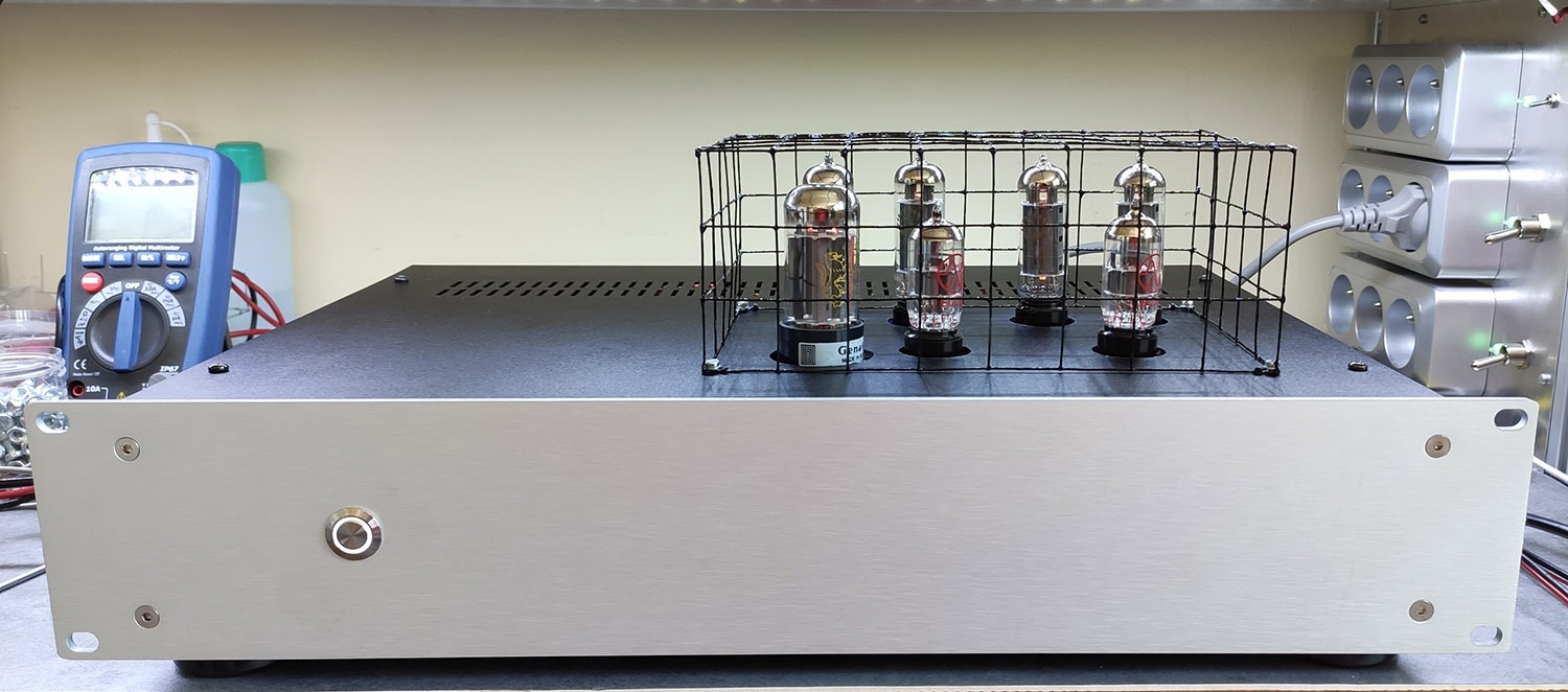

I love that open frame wire cover!
Have fun listening, and have fun watching the fruits of your labor.
Those chickens lay any eggs yet? 😉
Congratulations on your build. It's a good feeling of accomplishment to build something with your own hands.
