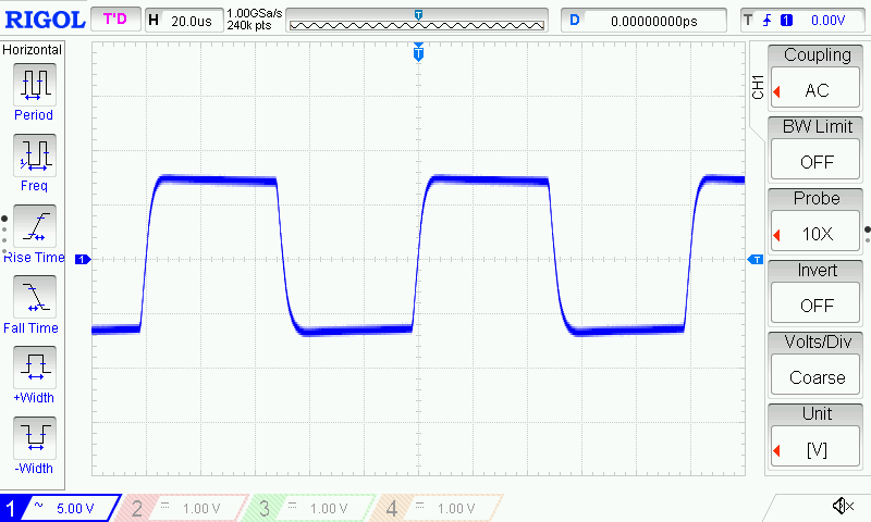

I have used the same Toroidy outputs and without feedback cap I get the following trace (10kHz, 8ohm dummy load).
Not sure if I need to add a cap or not?

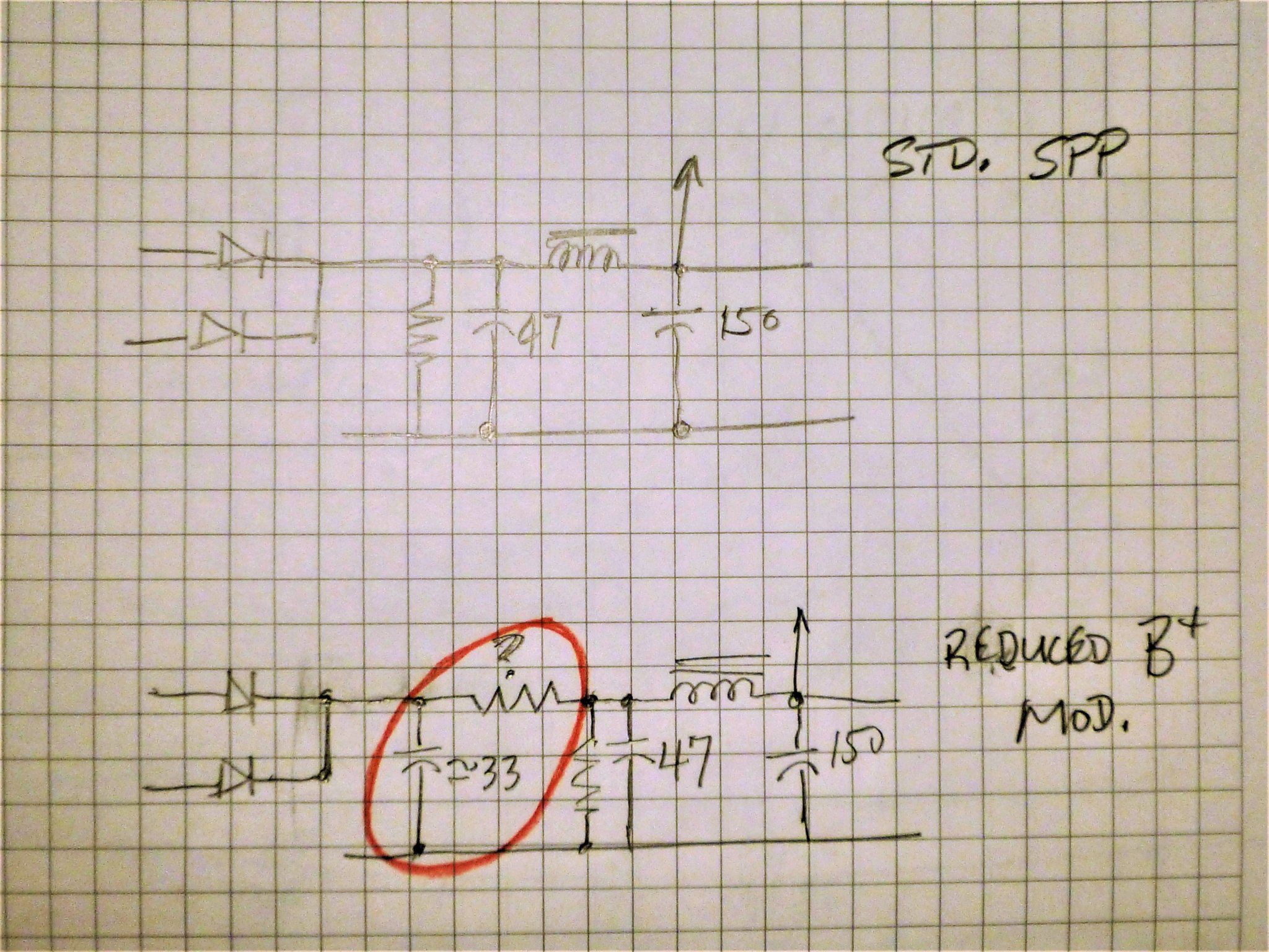

I've not experienced it myself but it's been reported by guitar amp techs that severe DC imbalance can be audible as hum in the speaker. 275, 280 not that much difference. Line voltage fluctuations will make more of a difference. If you find there is way too much B+ this can be reduced by adding another cap and resistor in the power supply. I did this on mine, see attached crude sketch. In this is needed it might be easier to mount the diodes off-board to save hacking the board.

I don't know a lot, sometimes not much at all, but I think you could have a lot worse 10 KHz square wave. If it were mine I wouldn't mess with it.

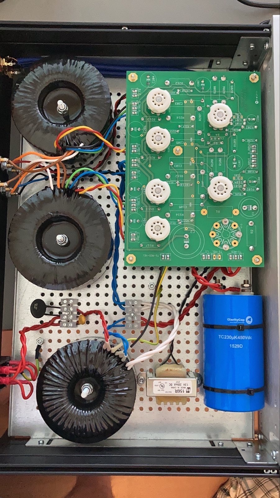

I build the Tubelab SPP, and I love my amp! 275-0-275 with SS rectification is perfekt, just like Hammond 370HX!. Changed the transformer, because it was made for 220v primary, so I bought a Hammond 370 HX , and the Hammond works perfekt. https://www.diyaudio.com/community/threads/made-myself-a-el84-pp-tubelab-clone.381104/After a lot of reading, I've also decided to build a SPP as my first tube (speaker) amp. Just to make sure I order the right things, can you guys confirm that the following makes sense? I'm planning to do a standard UL and SS rectification build.

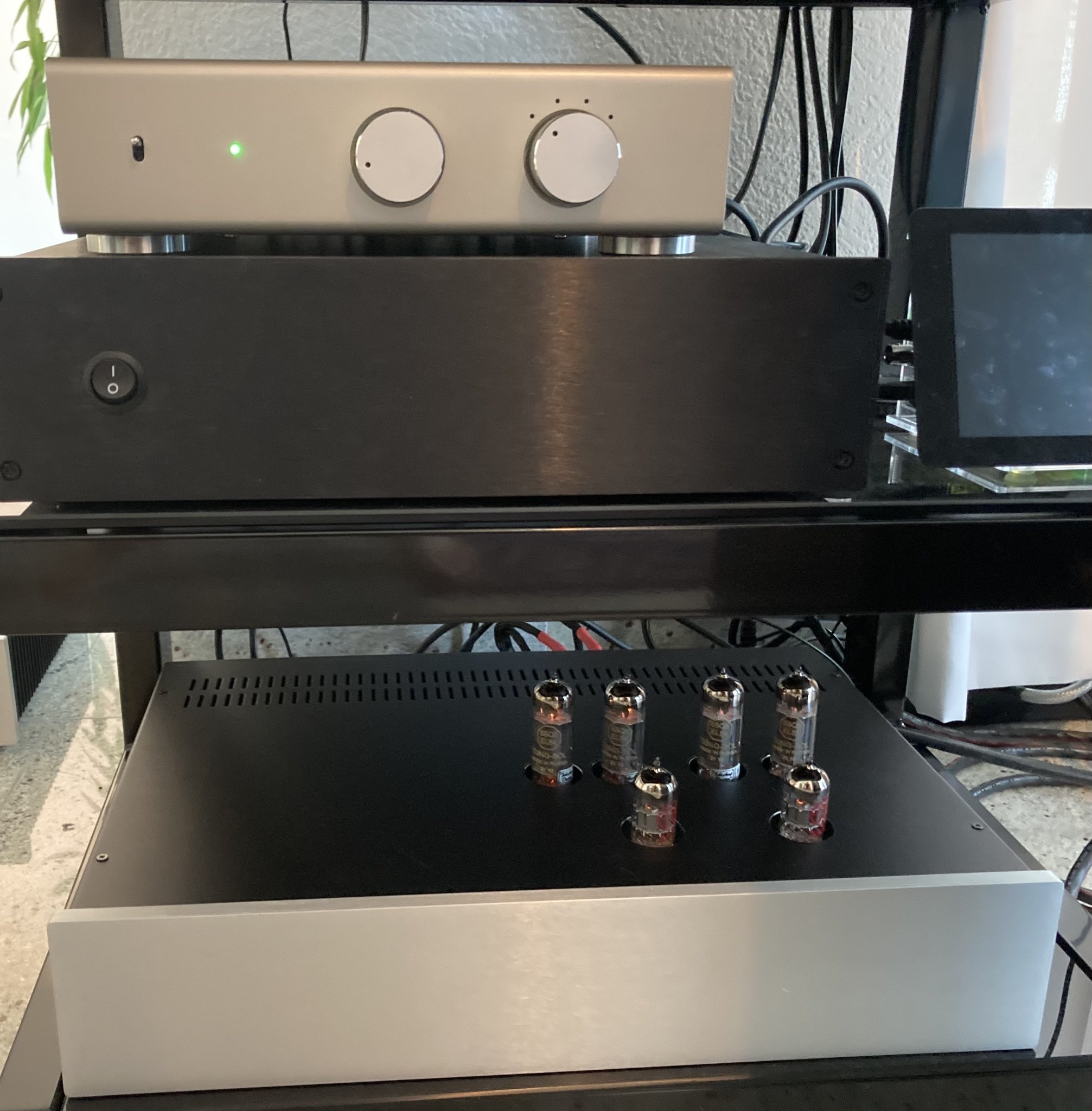

I realized that I never posted a picture of my final amp, so here you go. I increased the filter caps as I had a bit of hum, but now it's very quiet (on 96db speakers). A very fun build and it sounds fantastic!

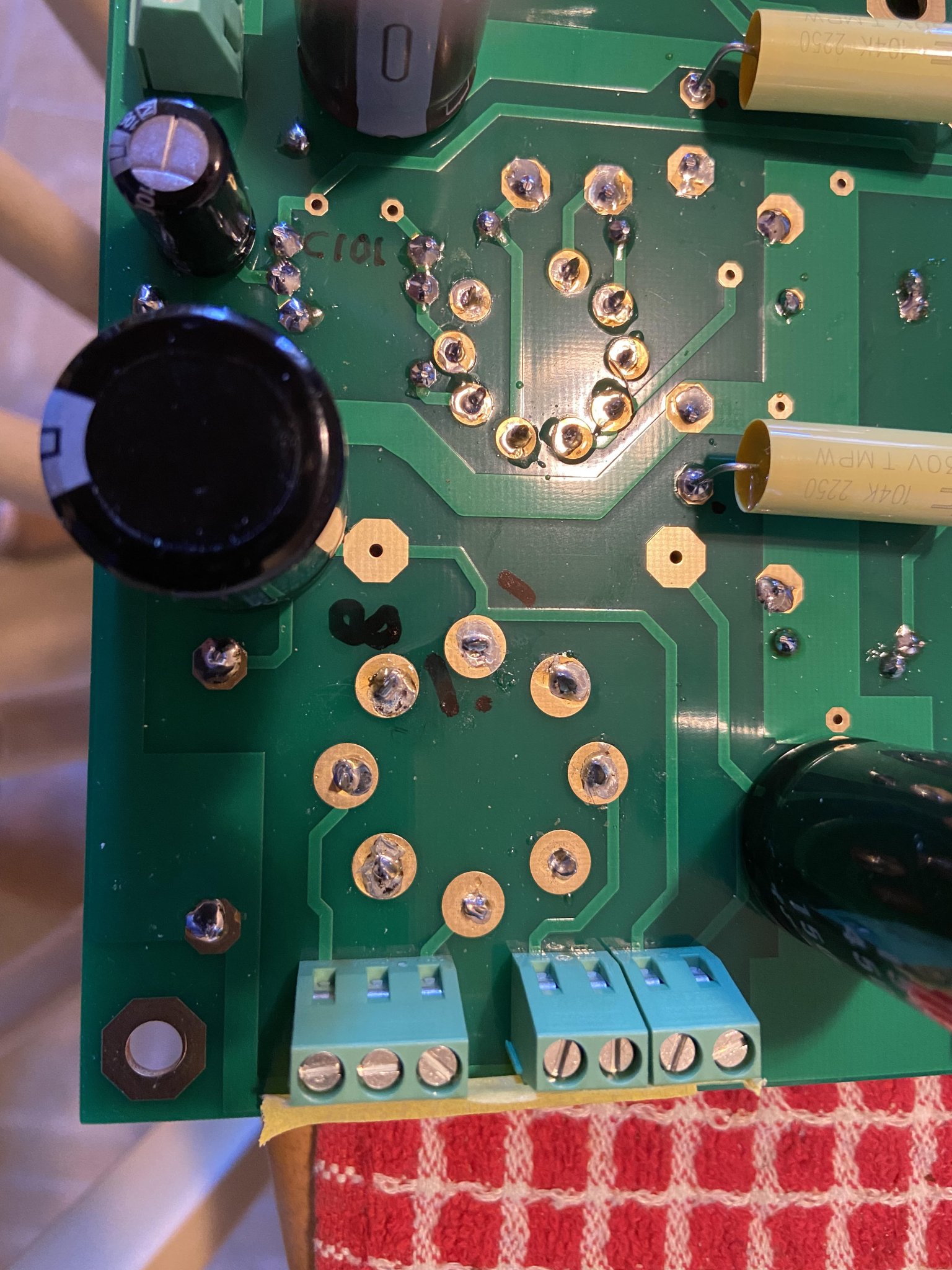

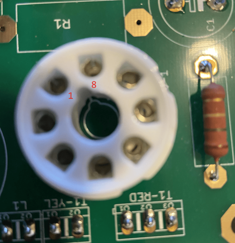

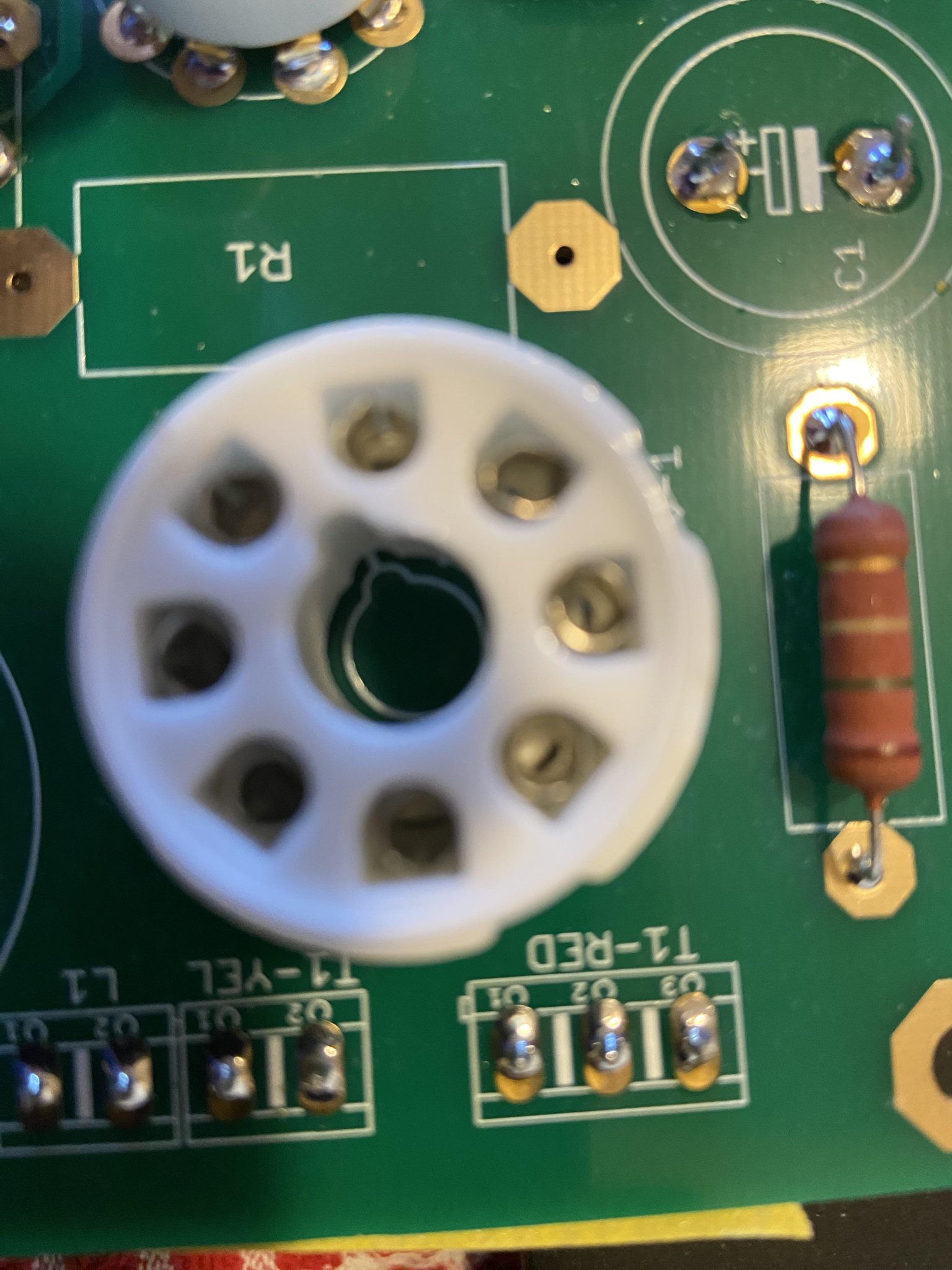

Help! My SPP Rectifier Socket or PCB Board Pinout Is Out To Lunch!
Triple checked installation both visually and with the DVM's continuity buzzer. Photo shows location of Pins 1 and 8 which makes the Pretty Red HV wires, for example, going to Pins 5 and 7.
Hello,
Regarding the last two post.
First photo i am sure you can improve things by better wire routing and making some wires shorter. Where is the first power supply cap?
Did you read about keeping the first cap wires short and not creating a loop.
The second photo, even on my small phone screen i can see you need to do something about your soldering skills.
Greetings Eduard

Ahhh - that was the question!@BillEpstein
Here is the correct numbering.
