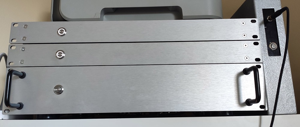

but I insist, a PA amp chassis (broken down or not) in 2U is very good as a base and you can find it for 50/100€ on the net.
The problem these days is the cost of the raw material.
I built two amps with Dibond, it's very practical and easy to find, look on the net

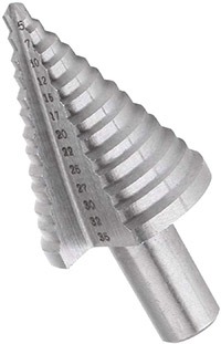

I use titanium coated (or cobalt) bits, I use step drill bits for mid sized holes, and an electrical knockout punch for the socket holes...
Crappy tire has the step drill bits on sale this week 🙂

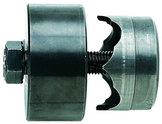

Huggygood, could you give me the french name for that tool and where you source it?or cookie cutters, I don't know the name in English
In the US they're "chassis punches" or the electricians call them "slug busters". Just search "chassis punch". Greenlee is the big brand here. The bay or amazon has them as well as electrical supply houses.Huggygood, could you give me the french name for that tool and where you source it?

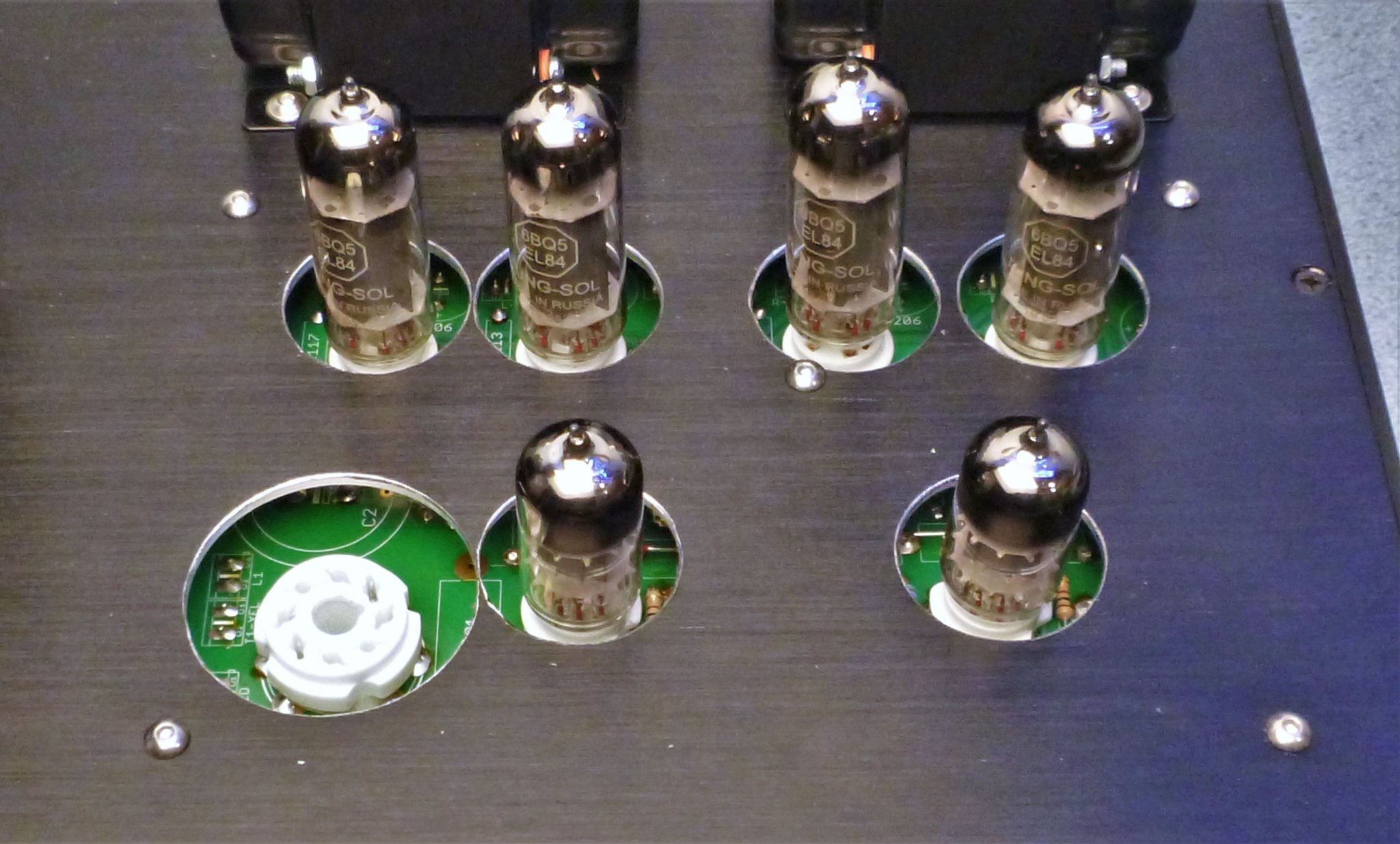

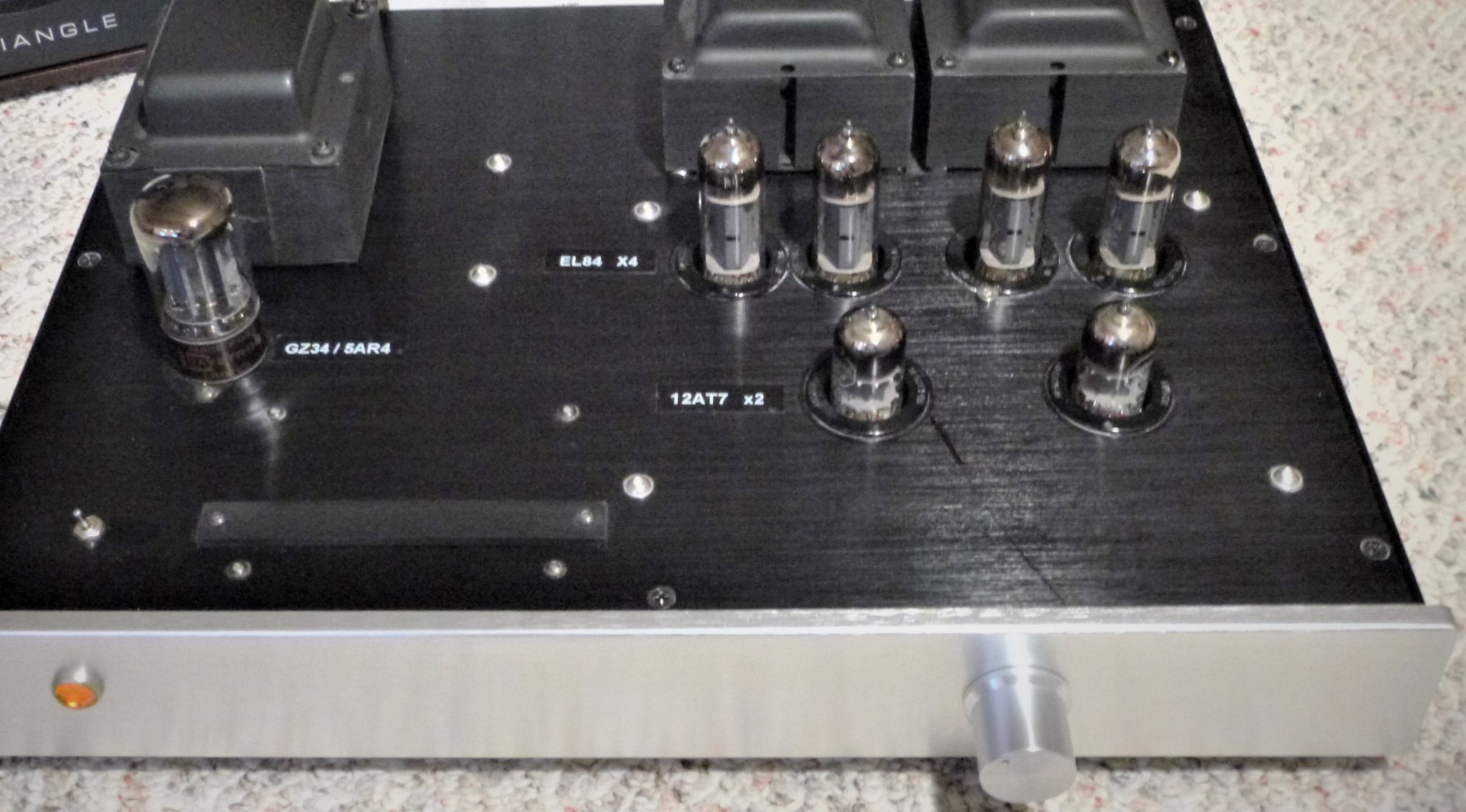

I'd like to put the heavy metal inside the chassis and only leave the tubes sticking out. I measured and it should all fit in the box.

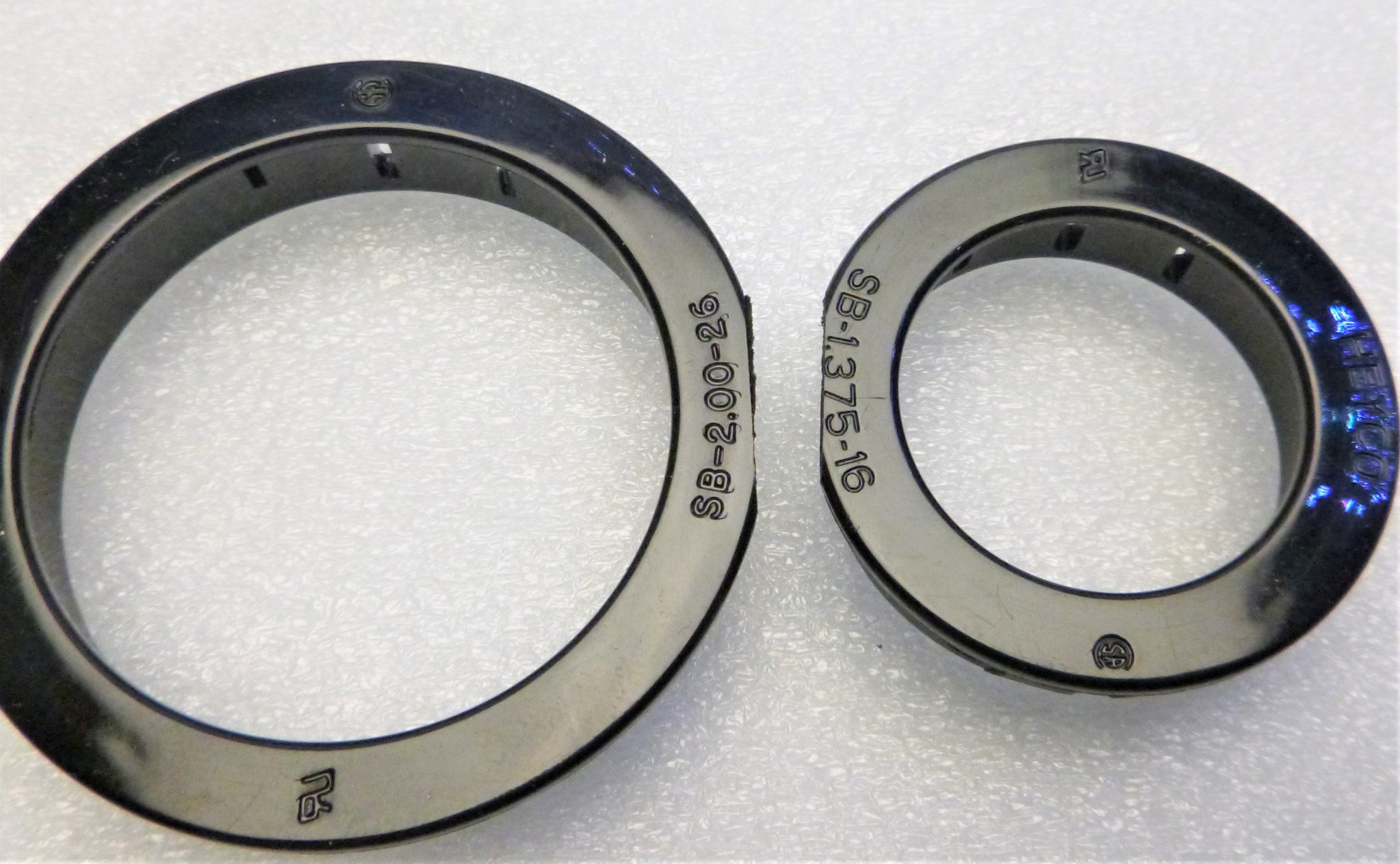

For the tube holes I will use the tool below. What are the little decorations around your smaller tubes?

emporte pieces evierHuggygood, could you give me the french name for that tool and where you source it?
https://www.amazon.fr/emporte-piece-evier/s?k=emporte+piece+evier
If you use a big step bit instead of a punch, make sure to clamp the work, and use a drill press, otherwise you might bind the tool and bend the chassis. Ask me how I know and why I use punches now...Steve,

Jacques,
They are Heyco bushing/grommet available from Mouser. Part number 836-2210 for the 9 pin tubes, and 836-2400 for the rectifier (if used). A bigger hole is needed and they can get kind of close together on some of the tubes, see attached pictures. They can hide some of your sins if your holes in the metal are not perfect. I think I got a local tool shop to make the holes in the picture below. I had an aluminum chassis and I wanted to hide the raw metal surface.
Be careful using the tool you show in post 73. They can wander from the ideal position. Practice on some scrap metal before you make your holes in the real chassis.
