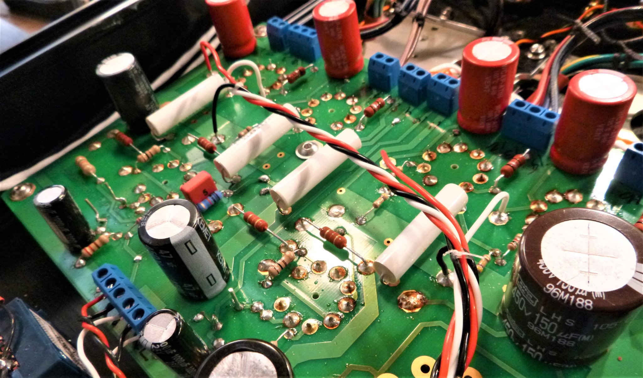

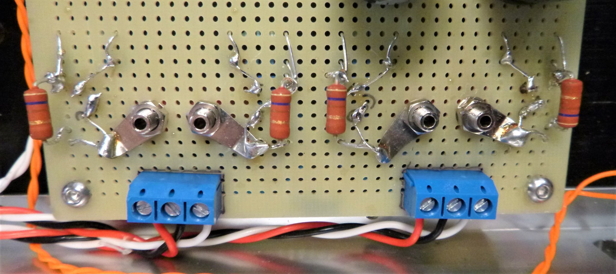

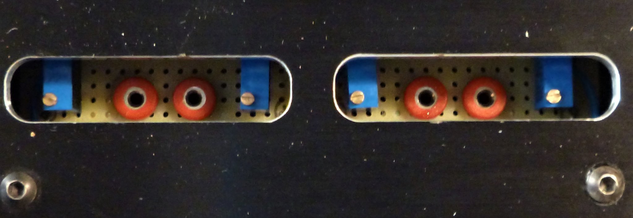

My bias mods based on circuit shown in post #20. See attached pictures.
470 ohm, 1 watt resistor (x4)
1000 ohm, 1/2 watt resistor (x4)
10 ohm, 1/4 watt 1% resistor (x4)
10K, 1/2 watt trimmer pot, Vishay or similar
The cathode bypass caps are left on the main PC board (red caps seen in picture)
Wires from nominal cathode resistor locations on PC board are run out to a generic perf board where resistors and pots are located.
As seen in picture pots and tip jacks for adjusting and measurement can be accessed from slots in the chassis top plate.
An easy mod.
Cheers, Steve

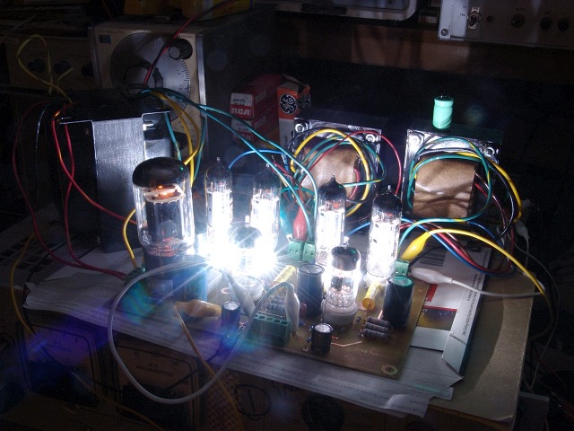

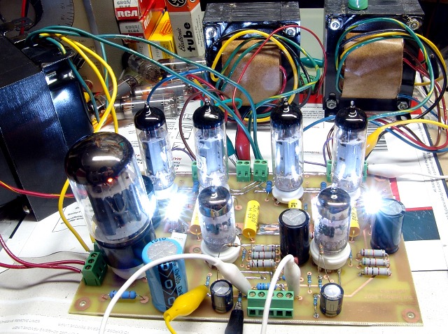

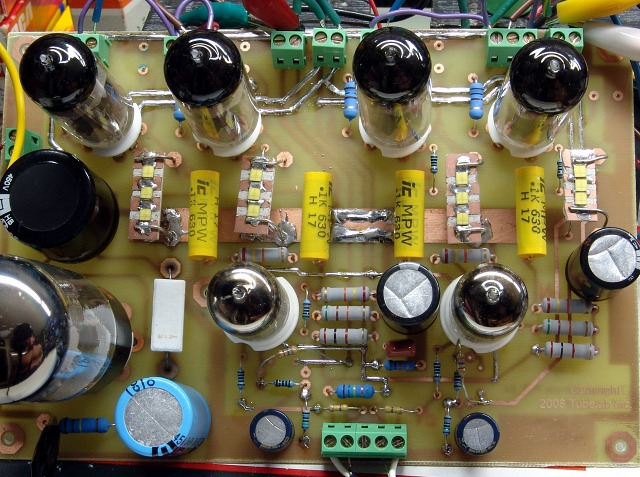

Those who have been around this forum for a while may remember Morgan Jones' Bevois Valley and and SY's Red Light District (RLD) amps. These and the SPP are all very similar designs with a few tweaks. Here is a picture of my WLD version. 4 X camera phone flash LEDs mounted on a heat spreader were used in place of the 270 ohm cathode resistors. This is a pre-production prototype PC board, not the production board being sold. It lit up the room quite well at idle and blinked like crazy when driven 10 dB into clipping with a guitar preamp. The BLD version kept blowing blue LEDS since powerful blue LED's weren't quite perfected in 2008.
