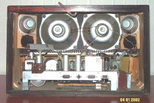

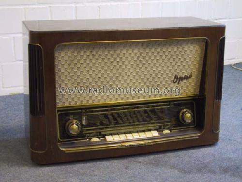

Actually I already owned a tube system as a child: a Telefunken Opus 6.
Funny enough it boosted an EL84 push pull!
Pretty damn loud with its 6 speakers for my small ears back then!

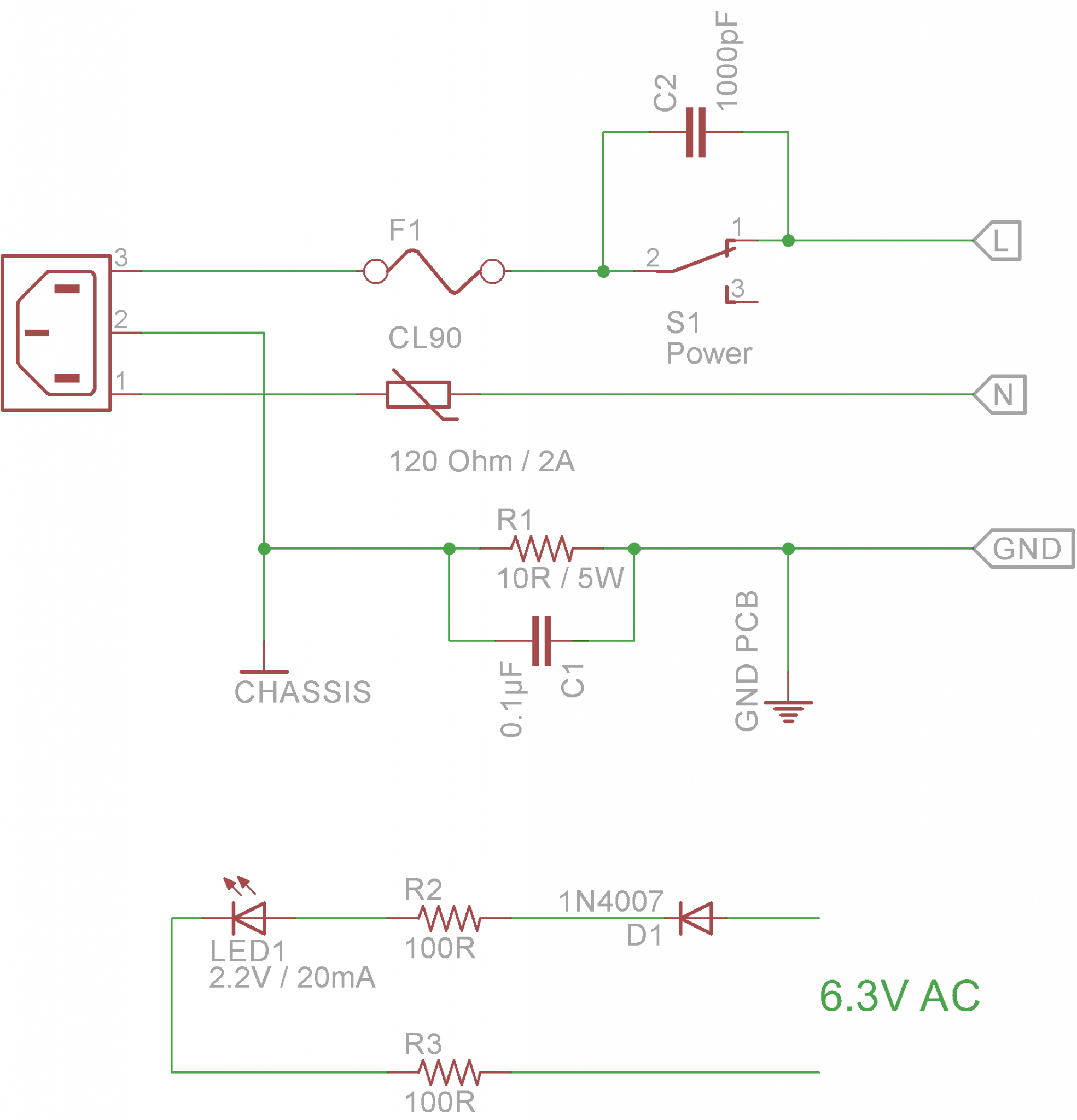

I've been following the whole thread. I will consider the Hammond 156R.
I am in Germany and need 230V and cannot use the 272JX/HX. The Marshall TT-MA36 transformer mentioned above or the Hammond 273HX should probably be considered.
Hammond offers the 300 series that can be wired for 240 volts on the primary. There are 372HX and 372JX models. Hammonds are likely quite expensive in Europe due to shipping costs. This one mentioned earlier by Ketje looks promising and not expensive. https://www.tube-town.net/ttstore/tt-ma36-36-watt-netztransformator.html
I have gone through all the documents from Wall of Sound for the 'SPP'. For section 4 'Power Switch Wiring' I created the following illustration.
I hope I understood everything correctly! Maybe the experts could take a look.
Another question: Is there anything special to consider when arranging the transformers?
Thank you in advance

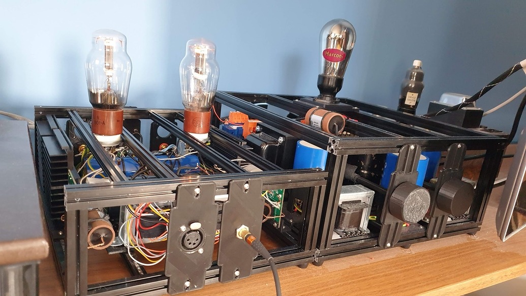

Hi Jacques,Hi Stonegreen,
Where did you source the black chassis from?
Jacques
I don't have a chassis yet. Everything is still in preparation.
Frank
I am a good customer there but at the moment all their alu chassis are back ordered 4 to 6 months.look at Audiophonics, HIFI 2000 chassis
I really want to tell you to look for broken amps on the second-hand market, that's often where I find my chassis.
(that's how I bought a remote Hitone H300 by chance in a modern chassis a few years ago...)
