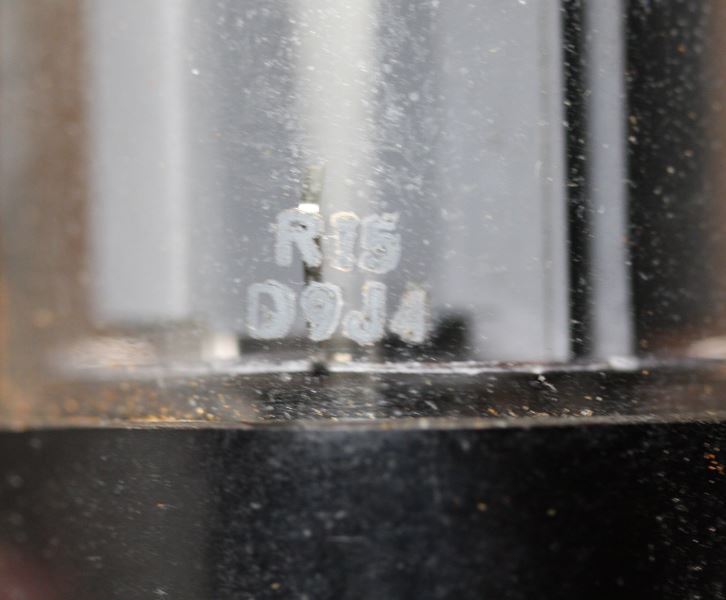

Each of these manufaturers used to mark their tubes in order to get the right designator stamped onto the glass envelopes. The Philips etch code is well documented at different WWW sites, but I don't know the Siemens' one. Do you find any tiny pieces of sheet metal with characters on it welded to the plates?I have some Siemens, are these likely to be Tungsram? I also have just 2 Philips.

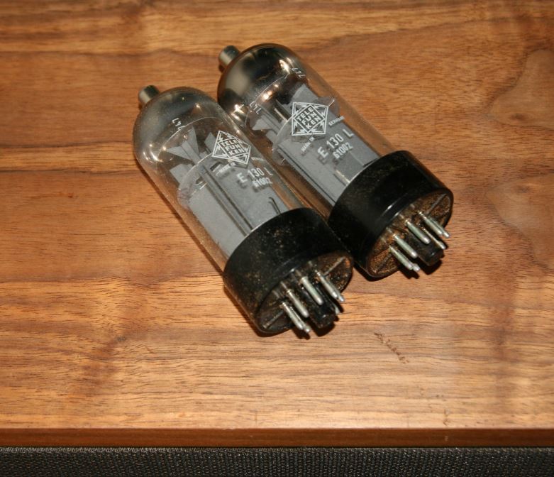

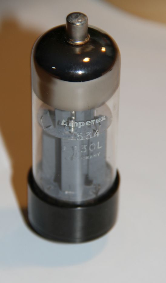

Here are pictures of my Tungsram (gassy) and Amperex E130Ls. Both my Tungsrams have pegged spacers. All my other E130Ls (Amperex, Mullard, Siemens, Valvo, Zaerix and some noname) have the same structure as the Amperex so I guess they come from the same factory (Philips?). Some have manufacturing codes at the base bottom while some have none. So if you have pegged spacers in your E130L it probably is made by Tungsram.

That's ok then, they are both as your Amperex, identicle, thanksHere are pictures of my Tungsram (gassy) and Amperex E130Ls. Both my Tungsrams have pegged spacers. All my other E130Ls (Amperex, Mullard, Siemens, Valvo, Zaerix and some noname) have the same structure as the Amperex so I guess they come from the same factory (Philips?). Some have manufacturing codes at the base bottom while some have none. So if you have pegged spacers in your E130L it probably is made by Tungsram.
