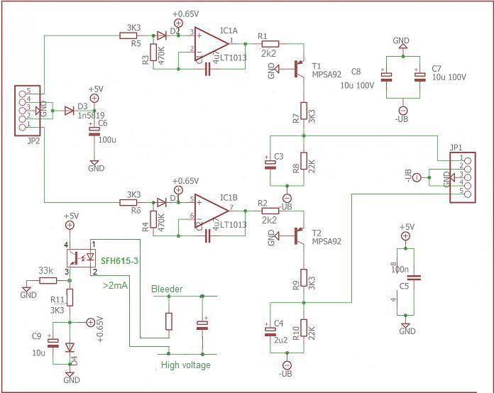

The negative voltage for the output tubes is supposed to come from the automatic bias circuit, see post #4 V4lve lover.Yes it is definitely missingOn 7N7 10 volts and on B+ 450V. It seems a negative supply is missing in the drawing. Something like 30V?
The reference to an optocoupler (left top amp schematic) is for the extension I made to the bias circuit for a delayed start.And the 7,5Ω cathode resistors are to get 80mA bias current.

I havent figured out the bias completely yet, i have a large stock of 12VDC coil voltage reed relays, and currently im thinking of delaying the complete +5V to the bias servo, the reed relay will be switched by the same 555 per channel as the high voltage. I may also make a new revision of the plug-in boards to connect the supply voltage for the diode reference to the outside world.
Negative will be stabilised with a TL783/LM317HV with its positive output tied to ground, this is because i prefer this. I need to check with Barry wether there is enough AC on his transformers to lose a couple of volts over the TL783
I like your optocoupler mod, but i dont think it will work well enough, you may want to include a couple of zener diodes in series with the optocoupler LED to make sure there is a clean start-up signal.
No need to stabilise the negative supply, the circuit controls the bias voltage to get the right tube current independent of the negatieve voltage as long as there is enough.Negative will be stabilised with a TL783/LM317HV with its positive output tied to ground, this is because i prefer this. I need to check with Barry wether there is enough AC on his transformers to lose a couple of volts over the TL783.
The start-up may well be slow, gives only a also slow raise of the bias current.I like your optocoupler mod, but i dont think it will work well enough, you may want to include a couple of zener diodes in series with the optocoupler LED to make sure there is a clean start-up signal.
