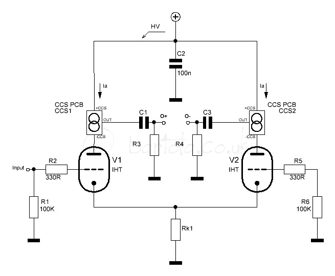

As said by Depanatoru in #169, a CCS in the LTP tail is much more reasonable than two as plate loads.
I don't know which edition of Morgan Jones' book you've got, but I think I've found what you mean in the 3rd one. And he did a really big mistake there: He provided a tail CCS as well as two plate load CCS's for a two triode LTP. This arrangement won't work at all, as the cathode CCS fights against the two plate CCS's, with the poor triode pair in between that apparently doesn't know what to do.
About ten years ago I cheerfully copied his schematics, using a 6N23-EV double triode, etched a PCB - and was wondering why it didn't work at all. Thinking thoroughly about it lend me to the above mentioned solution.

A circuit like that only function with also a CCS at the cathodes.
Here the current in Rk1 is the sum of CCS1 and CCS2. So the current doesn't change and so the cathode voltage will stay at a fixed level.
Like that there is no change from the left tube passed to the right one and no output on O-, only on O+.

In addition, I'd regard it as simply impossible to adjust the cathode CCS current precisely to the sum of both plate CCS currents - and keep it stable at all conditions, especially with temperature changes.

That is fundamental mistake , he mistook current mirror loads from many transistor diferential amplifiers for 2 current sources 😀
The circuit must work well if you do it in the right way . The gain should be signicant higher

In the 4th edition he explains the same circuit but the smoking gun is hidden in the text.
The impedance of the tail ccs vs the load ccss have to differ so they don't fight each other.
For example you go with a cascoded ccs for the tail and a single element ccs for the loads. Even a triode is ok, like in a differential SRPP with a cascoded ccs tail.
I made such a thing all with ecc88 tubes and the result is great as long as the srpp tubes are extremely well matched.

Active loads are a kind of weak current sources , but different that's why are not named current sources . Much weaker than the ones from the book ... not 1 transistor vs 2 cascoded transistors . And for a differential amplifier must be mirror active loads , not independent . If one goes up the other goes down by the same amount of current . Only in this wat are not "fighting" with the true current source from tail .
In Post 181 don't the following grid resisters R3 & R4 defeat the purpose of a CCS in the plates anyway.🙂

same here, not a book I would recommend, to many flaws, and tail and plate CCS without at least some resistance in parallel is so gross an error I wonder what he was thinking
