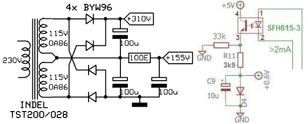

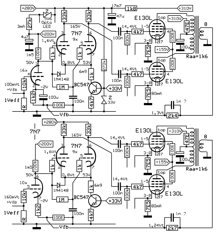

Just plain elektrolytes. On 7N7 10 volts and on B+ 450V. It seems a negative supply is missing in the drawing. Something like 30V?

One side with, the other without, the decoupling C in the first stage to show the difference.
No delay on the high voltage needed, the auto bias turns on when the first 7N7 heats-up.
Mona
As painted pointed out the negative supply is missing, I'm assuming that the 330k resistors are connected to ground, should there be capacitors across the 7r5 cathode resistors?
