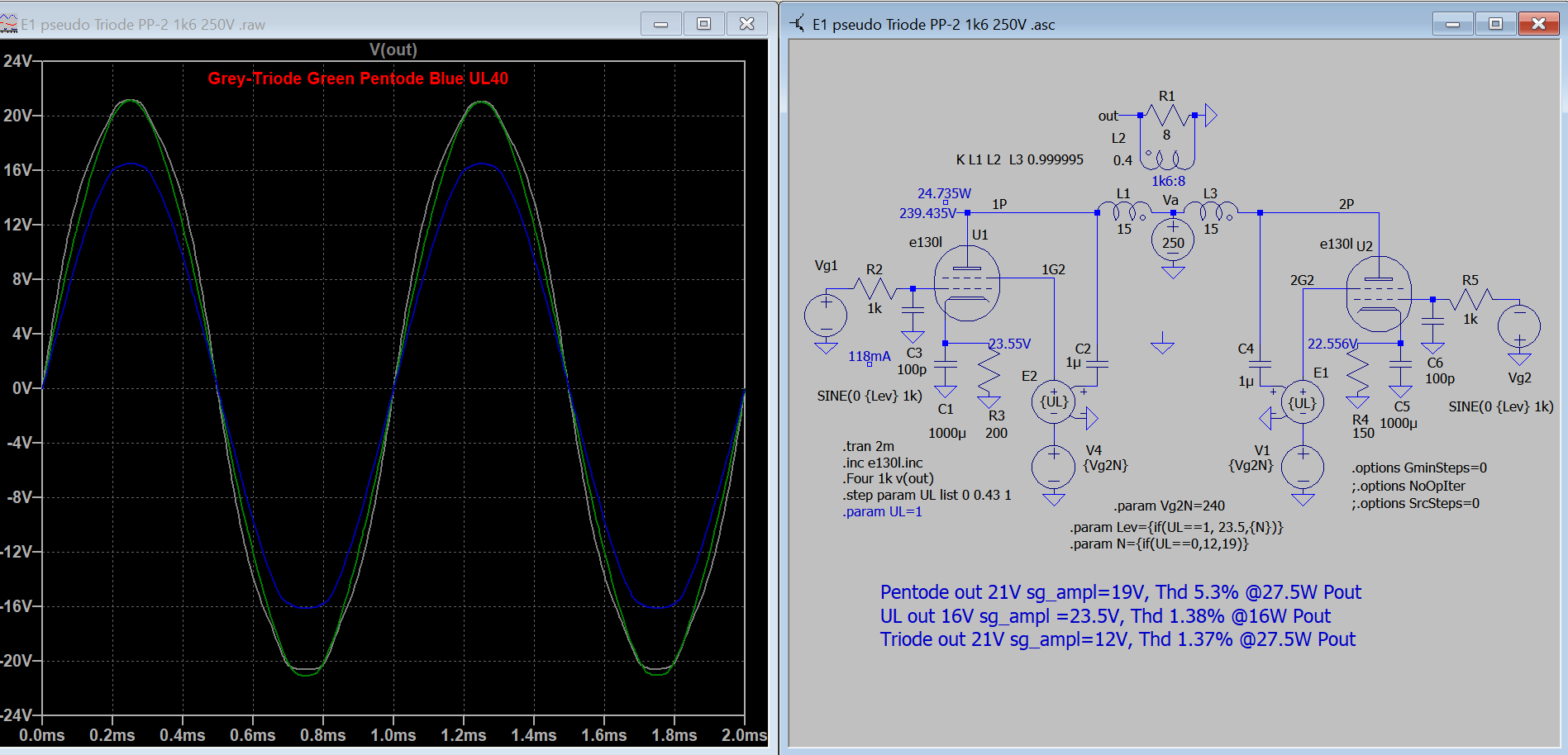

Two more snapshots, 250V and 300V HT version, hope these help in your project. If you want the sim asc let me know.[/Q
the only difference here is that I have 1.6k impedance transformers, (which is what philips recommend) with UL tap (43%).
Yes why, that make a lot of difference to triode power output. With 1k6 250V the output power becomes more even among the mode. I leave 300V version for you to work on then.

I wrongly put in last attachment here is the correction for 250V, 1k6 OT:
Pentode out 21V sg_ampl=12V, Thd 5.3% @27.5W Pout
UL out 16V sg_ampl =23.5V, Thd 1.38% @16W Pout
Triode out 21V sg_ampl=23.5V, Thd 1.37% @27.5W Pout

Hi Koonw,
Check your sim, r3 and r4 are different values (both should be 200), Pout for triode looks about twice as high as it should be, and the transformer as shown is 1.2k:8 (60H primary to 0.4H secondary). Also for THD should sim for more cycles and have a settling delay.
Bohrok2610 - peak anode dissipation exceeds the limit but average is under 20W over the full cycle.
