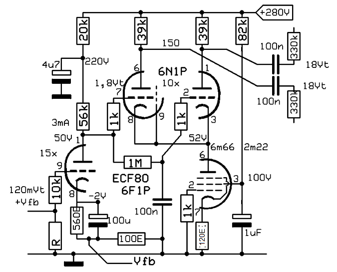

Another one only tubes but with CCS 😀As a tubes-only version, I would build this:
The CCS screen resistor (82k) probably need adjusted to get the right current.

Wait for a while and someone says that you should use cascode tubes for CCS😉
That needs much more voltage and you and up with a separate heater supply for the top-tube to get the Vfk within the max spec.Wait for a while and someone says that you should use cascode tubes for CCS😉
A pentode is a nice CCS at rather low anode voltage.
Mona
Exactly. The cascode has just been invented as something that resembles a pentode's properties (high gain, high plate impedance), but avoids it's partition noise.

So 6n6p is dual triode, so you would control each triode with it's own CCS, to balance desired current on each E130 tube? I'll get to the extra tube ahead of the phase splitter soon as gain is an issue here I think.

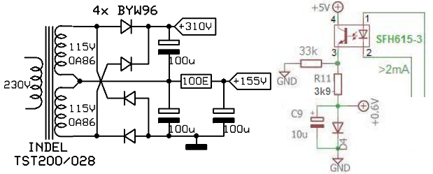

I have some IXYS IXTP08N100D2's & 1k pots, which could be implemented they will work at low voltage

Elegant solution Ketje. If I had the appropriate OT I would build it.Another one only tubes but with CCS 😀

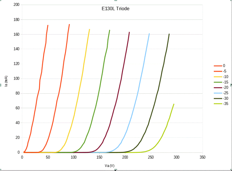

Any triode works better (more efficienctly) in A2 or AB2 mode, given that the control grid copes with grid current.
Best regards!
Best regards!
Only lowish gm/highish mu tubes need grid current, not the E130L.
Or do you want to run that tube in A2 triode with a load below 400 ohm?
As a side note IMO E130L triode needs a follower (source or cathode) as a driver.
based on what?
based on what?
If you want to get the most power out of E130L you will end up with positive grid current. IME source follower is beneficial especially in SE mode.
