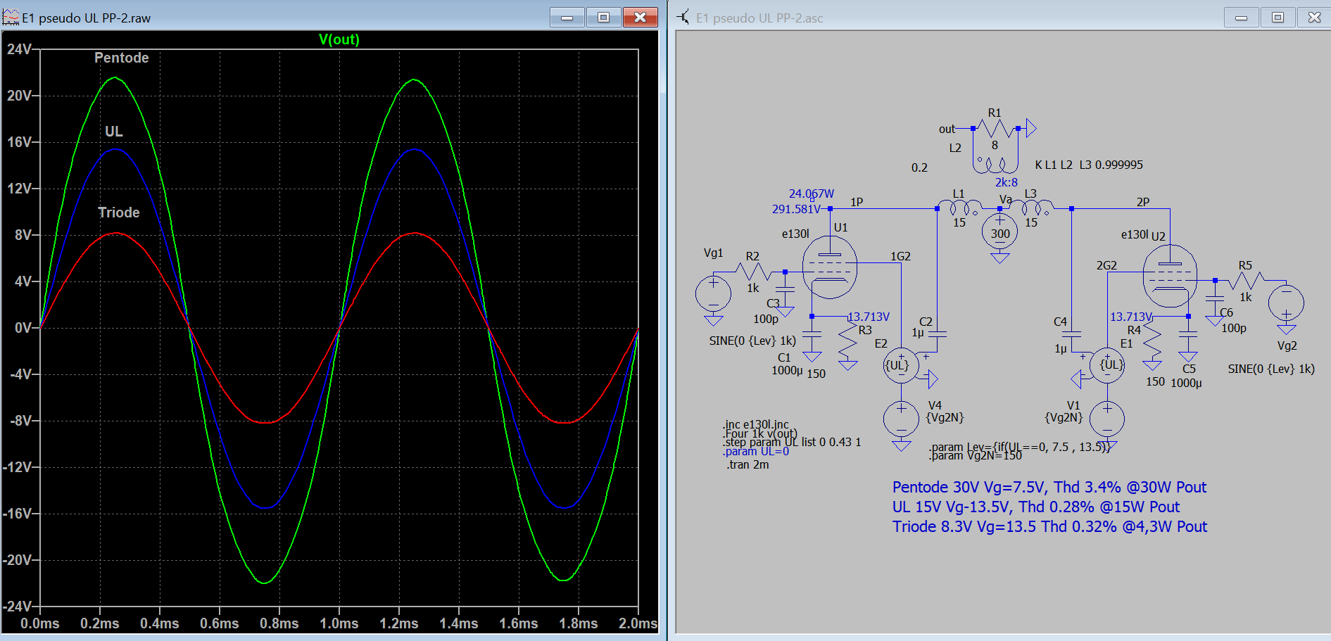

Based on the E130L triode curves I showed in #74 you might get closer to 30W if you dare to venture into grid current territory.

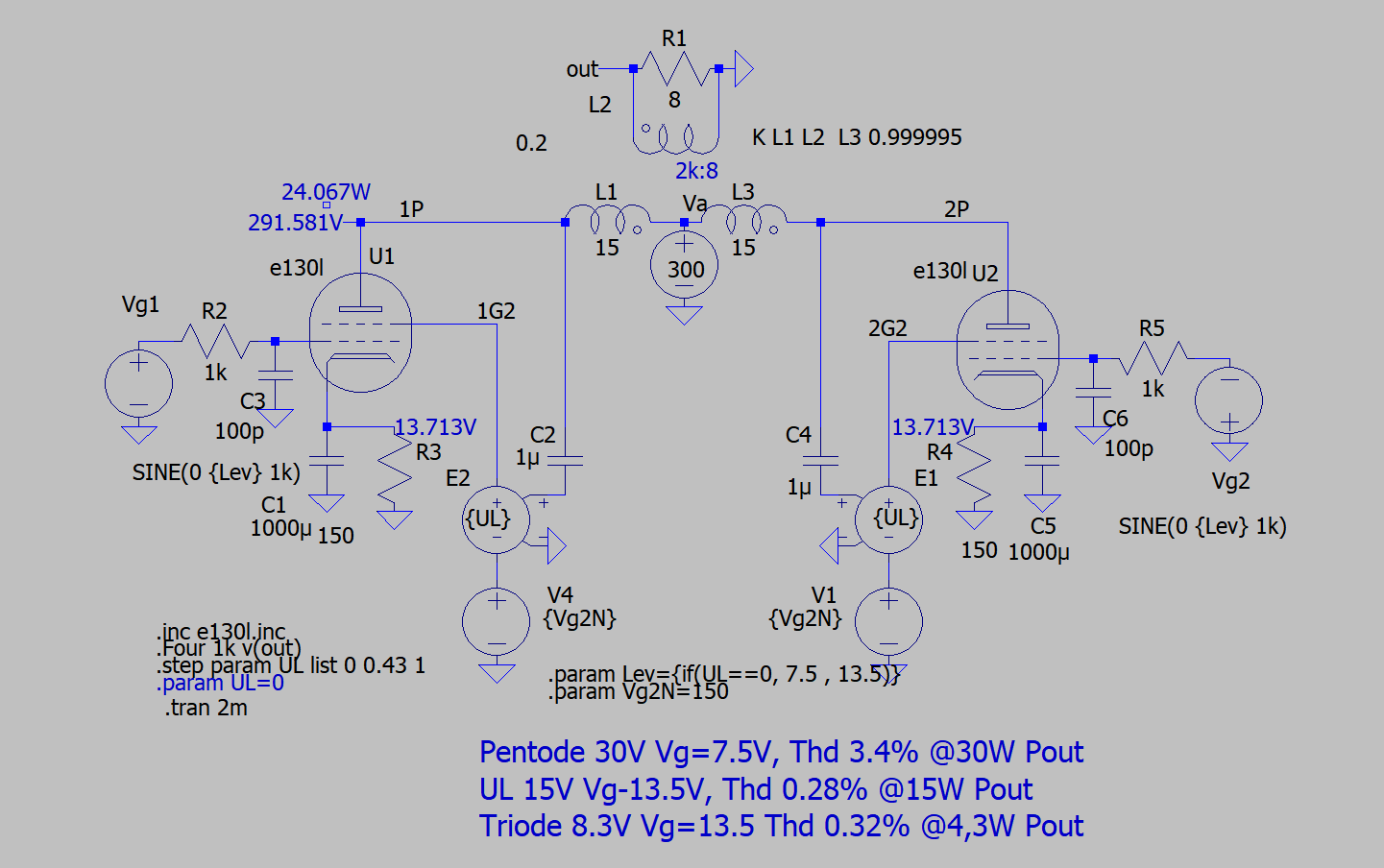

I don't have E130L tube model, but I used quite similar Svetlana's EL509 model to build a simulation of the full amplifier.
This is what I got:
Looks like a souped up Mullard 5-20.😀

Pentode mode is quite sensitive, required only 7.5V to full power 30W and 3.2% distortion and output Z can be further lowered with CF. Here is my sim result with new model I just posted.

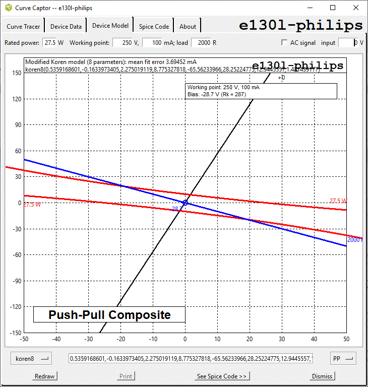

I certainly have never drawn load lines based on curves your -Ug 27,6V and Ia 100mA biasing must be based on.

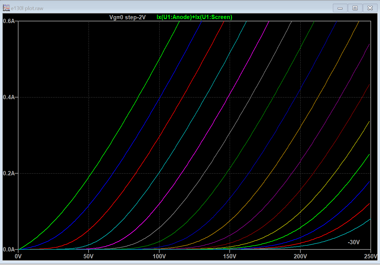

Get yourself triode curves from Philips for instance, make a few different models with
curve captor, check them against the tube manufactures published curves and use the one that comes closest.
At 250V and -Ug 27,6V you should get Ia close to 135mA +-5mA, not 100mA.
If you made your model by taking curves from a real tube the tube is probably worn out.

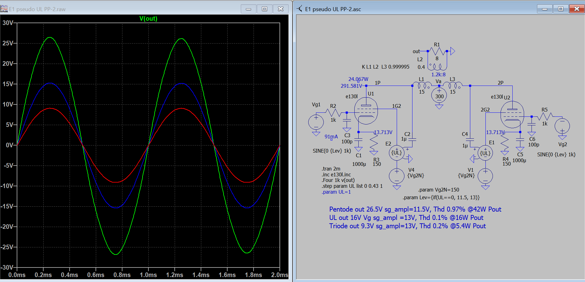

Here is my sim result for 1.2k:8 OT, 91mA or 24W Pwd each tube, Pout up and distortion down:
Pentode out 26.5V sg_ampl=11.5V, Thd 0.97% @42W Pout
UL out 16V Vg sg_ampl =13V, Thd 0.1% @16W Pout
Triode out 9.3V sg_ampl=13V, Thd 0.2% @5.4W Pout

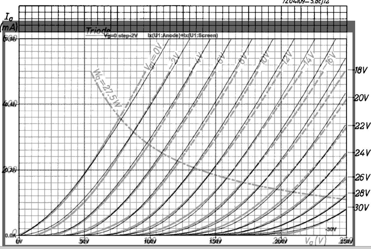

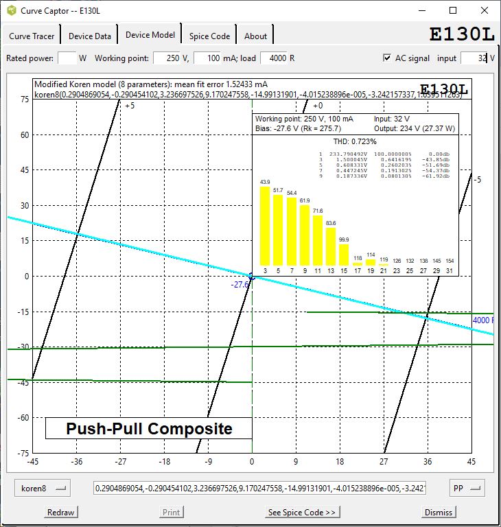

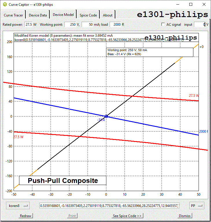

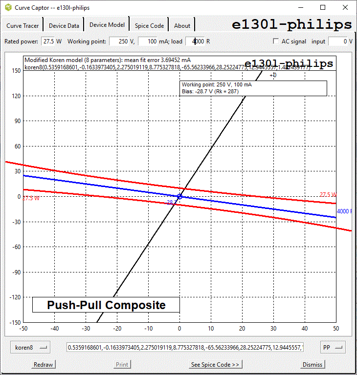

You apparently do not use loadlines with your amps. 4k load on 130L triode PP at 250V/100mA is actually quite reasonable if the goal is to have low distortion (see attachments). If you go to 2k load Ia needs to be lowered to about 50-60mA to not exceed anode dissipation limit. To use even lower 1.4k load does not make much sense. And please note that the loadlines in attachments are drawn from Philips datasheet.
Anyhow one of the main reasons to use E130L as triode is to have lower distortion. Negating this by trying to maximize output power with low Raa load is counterintuitive.

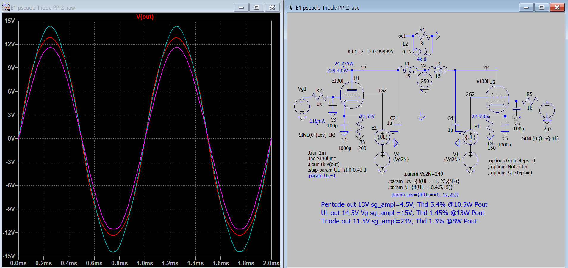

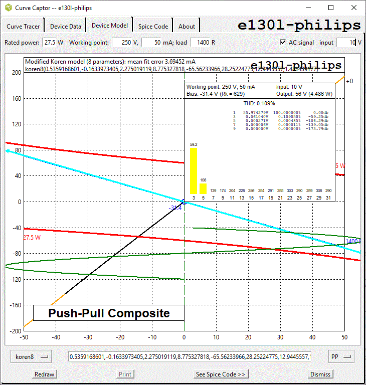

Two more snapshots, 250V and 300V HT version, hope these help in your project. If you want the sim asc let me know.
Please. I would like to compare with my results.
Thanks! Have you checked how well the triode curves from your model match the datasheet? At least the Vg-bias seems to be slightly off.
Thank you too, I did check, it's pretty close. Do forget to add screen current to anode current for triode plot.
