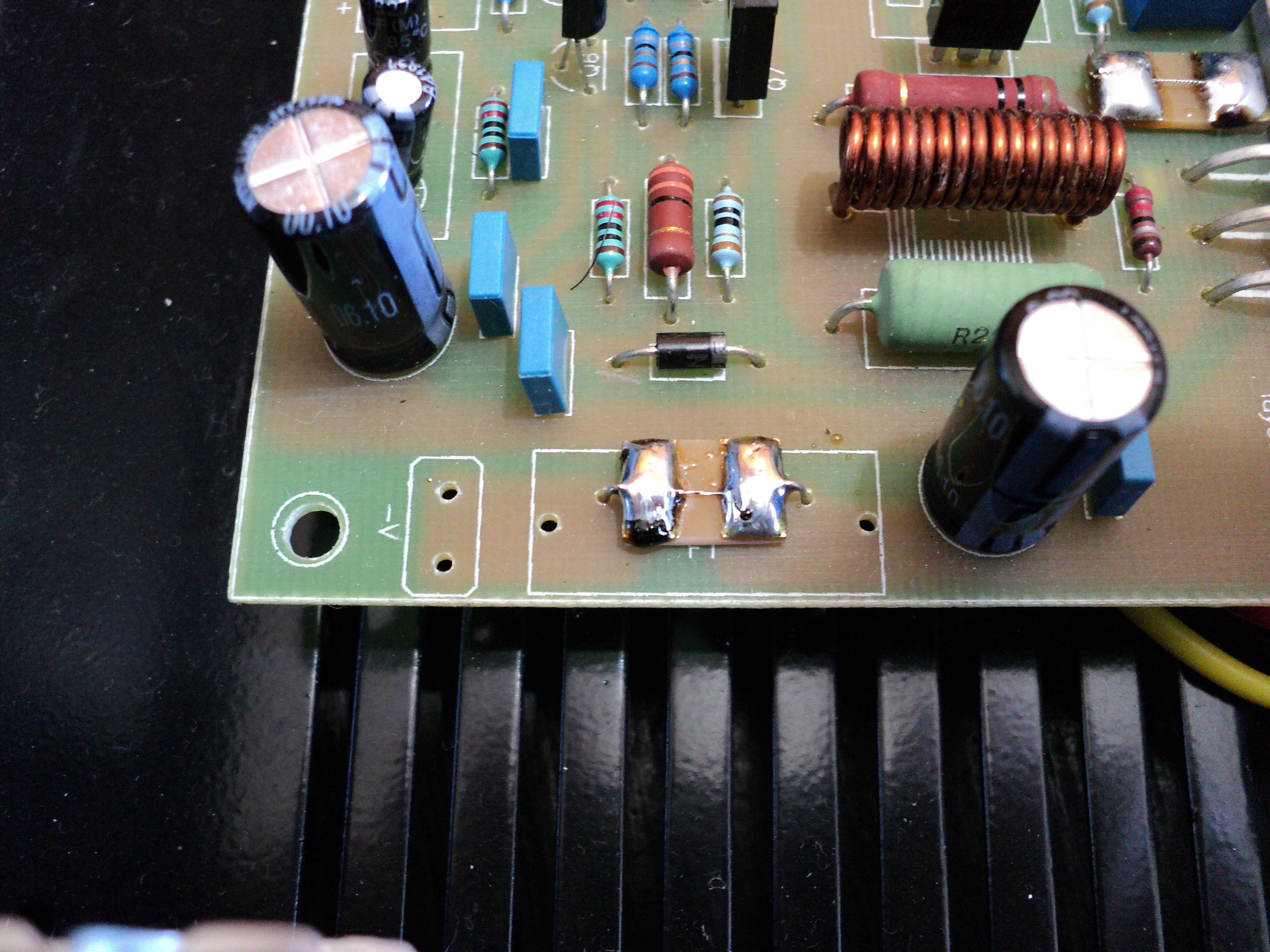

Good Andrew T... seems you are rigth...my own fuses
the ones i use are made by myself and they are not precise...so, your suggestion is very good and i agree that people should use higher rating fuse to the application.
The wire i use melts in 2.6 amperes DC...but even the solder melted around the wire can change this..also the solder in big quantity are dissipating, sinking heat, cooling the fuse and this may increase the ampere ratio...seems my fuse can be 3 amps or even more in the reality...so..what you say makes sense and also come from correct calculation.
So your suggestion is 3.5A to rails and 7 amperes in series with the output.
Thank you,
regards,
Carlos

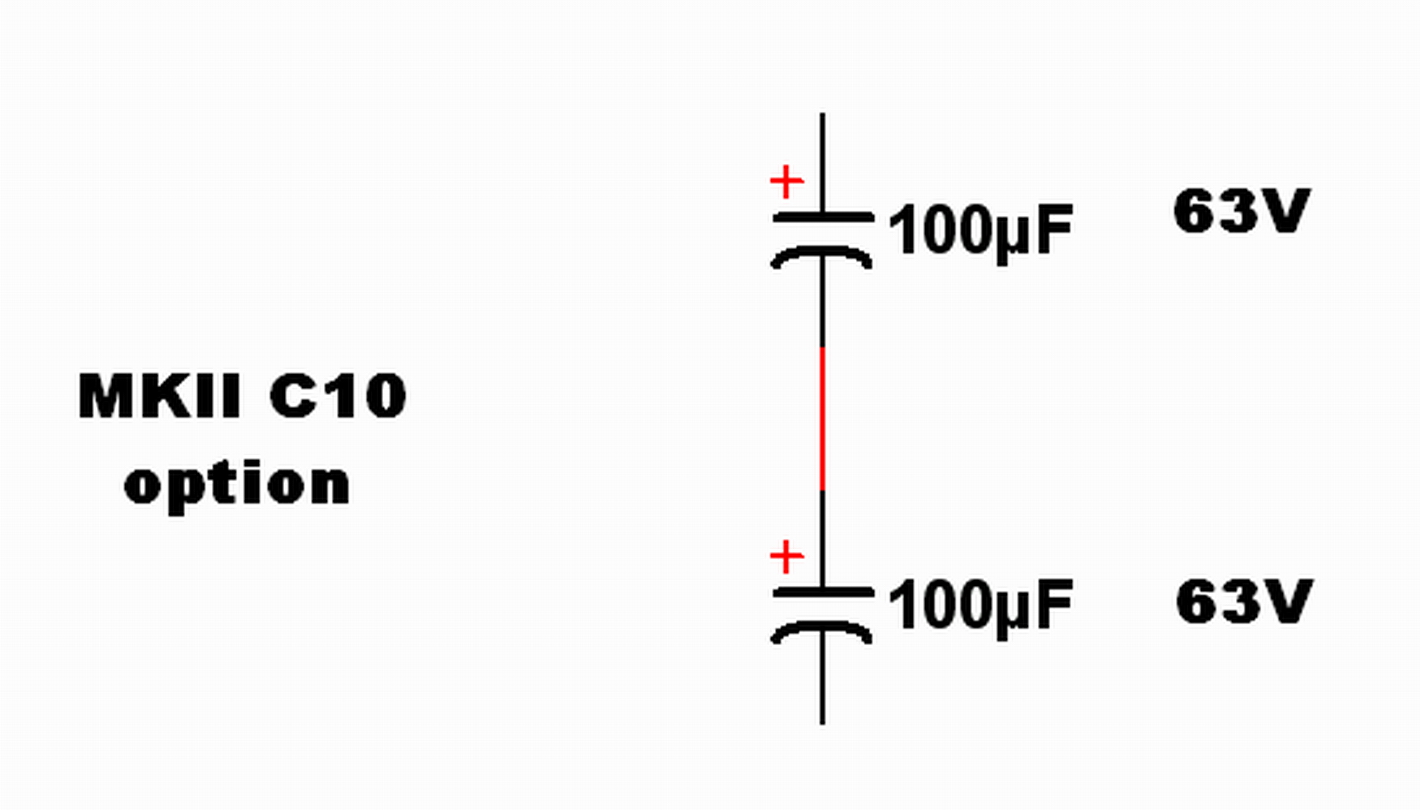

No!...i am sorry, this one is the bootstrap condenser
and the voltage it will face is really big, it is not a good idea to use 63 volts condensers in that position.
This condenser has it's negative lead connected to the output line..and thi line swings from very high positive voltages to very high negative voltages (AC audio swing ) that are near the rail voltage...so..you may charge this condenser during the negative half cicle swing to more than 80 volts.... a 63 volts condenser may be damaged, leak or explode one day.
If you cannot find a 100 volts (or more) unit, them use two 100uf/63 volts connected in series.. you know...two doing the job one can do....this way you gonna be creating a 50uf by 126 volts condenser ..do it not to stop your amplifier construtions while you will be continuing to search by the correct value and insulating voltage.
regards,
Carlos

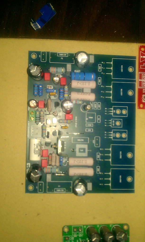

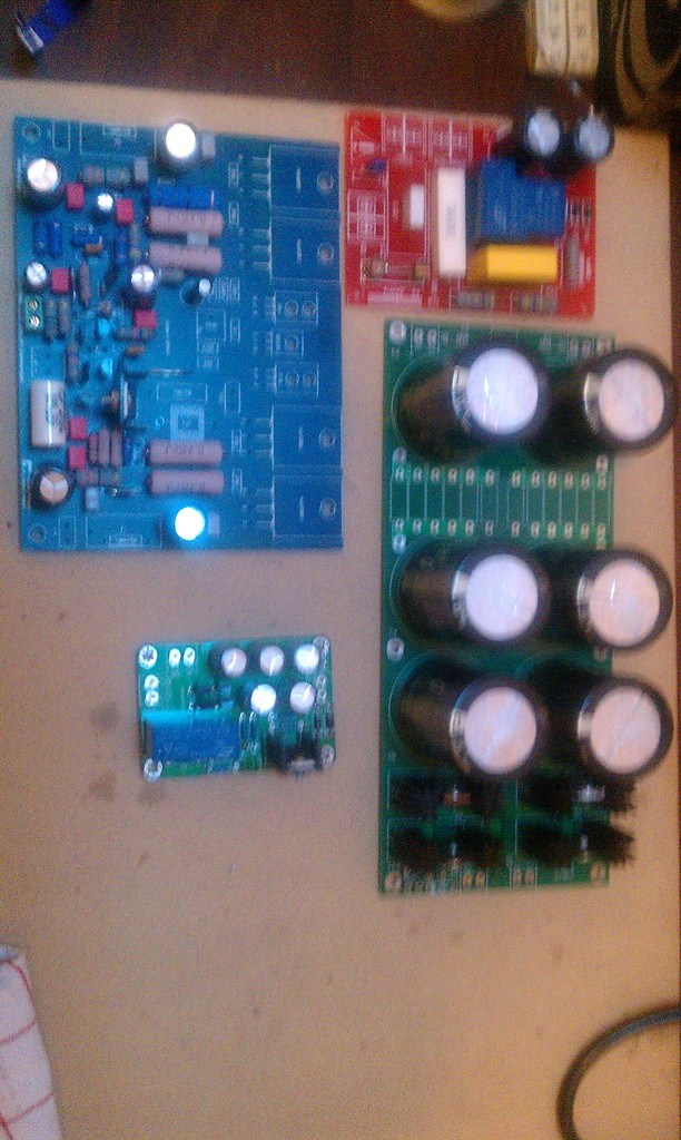

Here some pictures of progress so far. PSU, Speaker prot and softstart are also almost finished.
Forgot to buy the 2r2 resistors so still waiting on those. As soon as I receive them assembly can start!
Can't wait!
