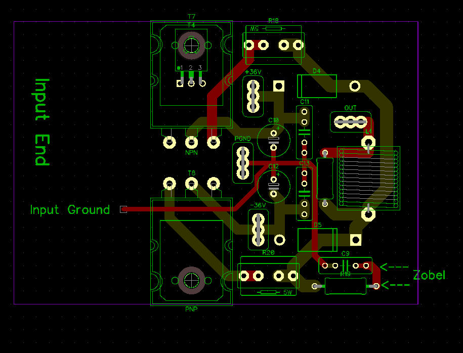

I agree with you up until the power enters the amplifier board. After the rail caps on the power connectors there is nothing to filter noise from the rails or ground. I try to run the speaker output traces along the power rails to reduce EMI on the board. Current is flowing equally in opposite directions in both those traces which should have a better cancelling effect than the ground would. I also plan the chassis before hand so there won't be any sensitive circuitry or wiring in that area anyways. Other than my first Slewmaster amp, every amp I've built has been absolutely silent without any fuss when installed in chassis so I must be doing something right.

It was the quietest point until you connected the Zobel to it. The Zobel output is filthy. It shouldn't connect to the same point as the input section.

The Output Zobel must return to the HF decoupling. That is the lowest impedance point for the above audio frequencies. From output device to Zobel back through the HF decoupling and into the output device is the current loop. It's that loop that must be compact and short to allow the HF to flow with least impedance.
Current flowing in longer traces will create excessive volts drops and that will create avoidable noise.
The input section is completely separate.
And where does the input ground connect to in your layout?
Here's an example of an output stage layout. As always it's not ideal. This time it's due to size constraints. High power traces and the ground connection to the supply inlet caps would be changed to planes at the end of the layout process but it'll give you the main idea. Power rail connections go to the supply inlet capacitors. Current follow a distinct separate path out of those capacitors to the output devices. The separate path is important. Ground to the input stage comes from a star point on the inlet side of the supply caps. Zobel ground on the opposite side of the caps. The Zobel dumps a lot of high frequency garbage to ground so I prefer to connect it right at the inlet ceramic/film input caps to allow them to dump this noise into the power rails away from the sensitive input ground. The VAS section would be next on the left side of the board with the input at the far left, as far away as reasonably possible from the high current areas.
