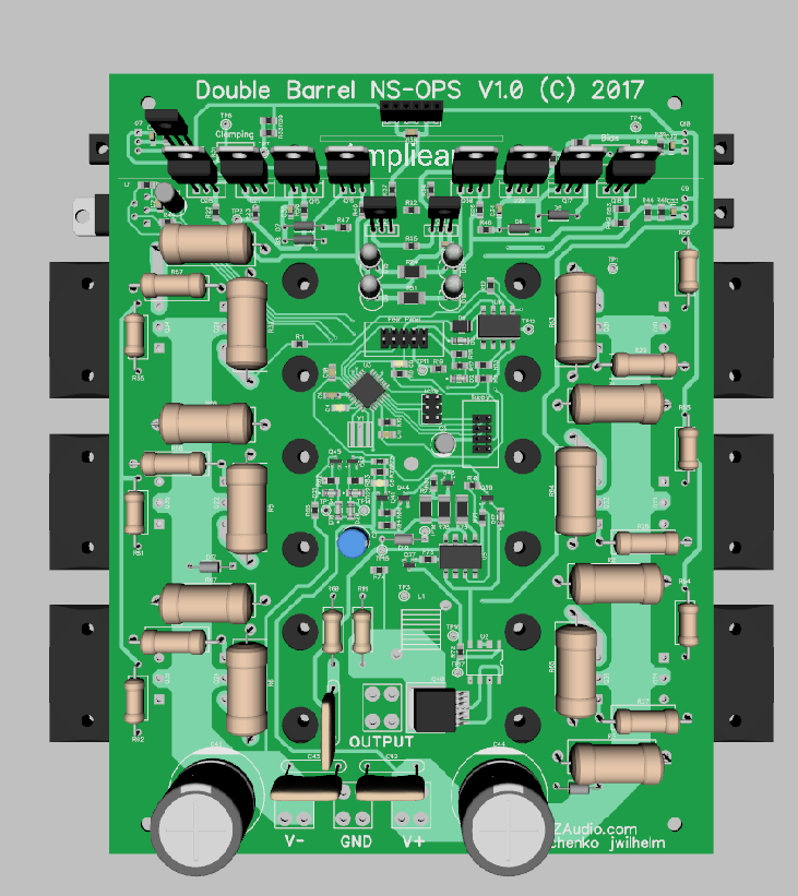

To mee, seems very difficult to put together voltages input on the amp board, because the V+ tap always goes to the collector of one output device, V- always goes to the other transistor...so, this two tracks always run close to each other.
Putting Voltage taps on the opposite sides of the board (each one on the side of the transistor it will be linked to) minimize the lenght of this tracks and let builder make them the same lenght (oscillations?)
If the amp only has a single pair of output transistors and they are to be placed on the same side of the board, the power connectors and associated capacitors can usually be placed between them. If the output transistors are on opposite sides of the board the power connection can go at one end. There's always a way to do this. It just takes some fore planning and a little thinking. I even easily group all the power connections together on a 6 pair 500W+ monster.
Another thing I often see is rail fuses on the amplifier board. This is wrong. Fusing should always be done at the source. They belong at the supply where they can protect the supply in the event of a short in the rail feed wiring.

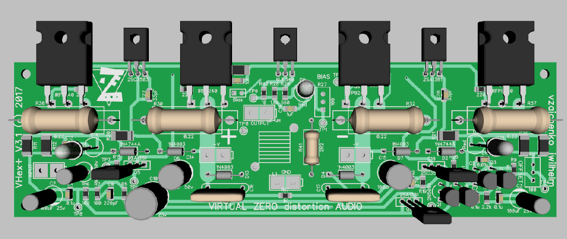

Just a curiosity.
Is it a problem for the power tracks to run parallel?
Many designs, like Elliot's p3a, make V+ and V- running parallel just on the same side of pcb amp (fuses are on the board and are also close and parallel to each other) for 3-4 inches lenght. These tracks also make a square turn to the transistor, one of those tracks running above the first transistor for reaching the other to the opposite side of the board

High current traces can run parallel. A sensitive low current trace should never run parallel to a high current trace though as the high current can induce a voltage into the low current trace.
the power feed uses three conductors. The variable current runs around two of these traces/wires at any instant in time. The third wire in that group is the Power Zero Volts.
It must be included in the LOW LOOP AREA layout design.
Simply closing up the +ve and -ve traces does not achieve low loop area if the Zero Volts is run to some remote star.
Take the post1858 layout as an example.
+ve current passes into +ve 35V terminal - +fuse holder - Q7e - Q7c - around the thick trace to top end of R13 - along R13 - common trace between the two resistors.
Where is the remainder of the current route to the speaker?
Where is the Return route from the speaker? It should be between the two resistors labelled R13 & R14, then follow the +ve current route described above, back to a terminal between +35V & -35V .
