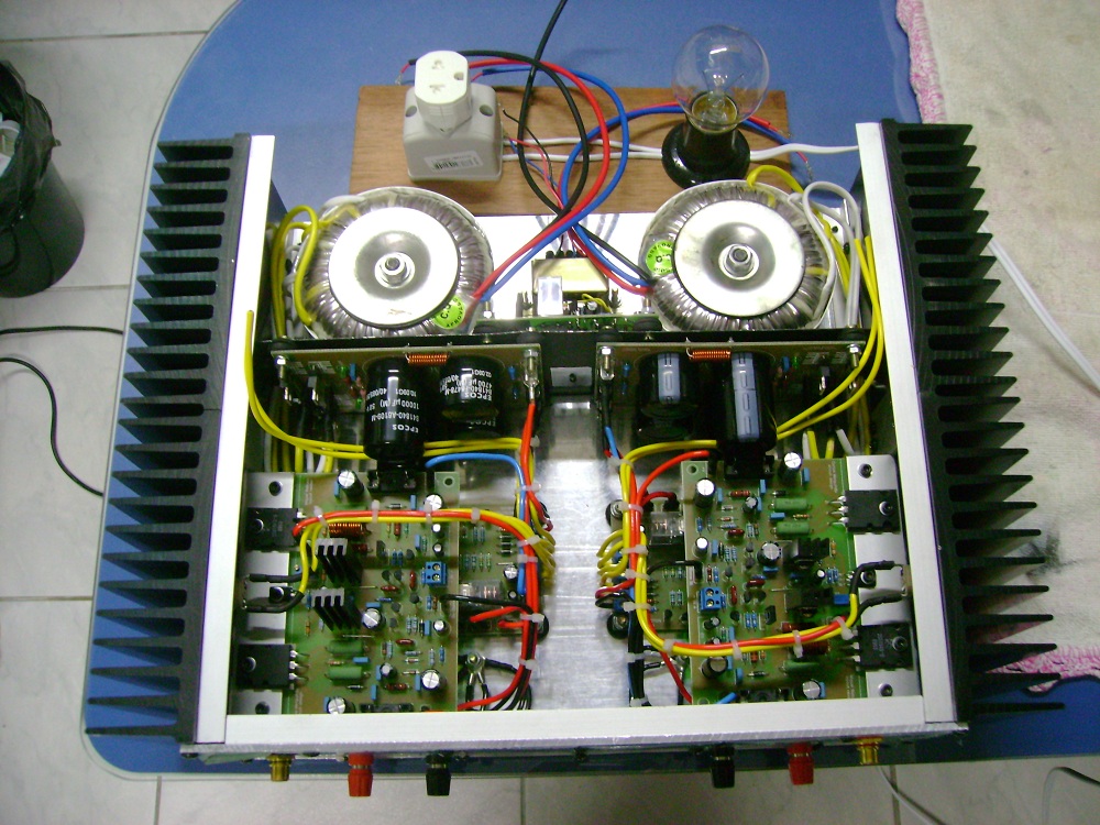

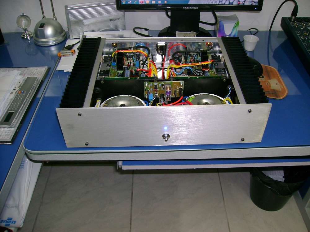

I am sorry folks...i have checked my amplifier and anything wrong with the series
resistances...the smell came from another place...i do not know where..maybe speaker, maybe modem, maybe computer.... speaker crossover use resistances...i found smell of something burning.....maybe speaker as it is underrated to my power amplifier output....and i was driving the amplifier really hard listening Sidney (Australia) Symphonic Orchestra yesterday.
Once i found this resistance warm..almost hot when i was testing the amplifier using steady tone generator, square wave and full power...and i decide to increase it in the Dx Blame blue boards, the MKII and also the Supercharged and the Dx Blame ES and Dx Blame ST already have suggested higher watt/size to these rail resistances.
To use higher watt...half watt or even one watt, as modern resistances are very small..well..this cannot be bad anyway..also to use a diode as i said can be done without troubles..and this cannot produce any harm to your amplifier.
I am uploading video showing my PC amplifier inside...and anything burned or smelling there.
I am sorry.... i was confused...i thougth was the resistances...but they are fine.
Soon i will post here the link to the video that i am already uploading to youtube.
regards,
Carlos

Was a stupid theory mine.... anything wrong with the resistances
I have imagined it should be burning (theory)..... but real world use to be something different..and anything toasted there...here is the video:

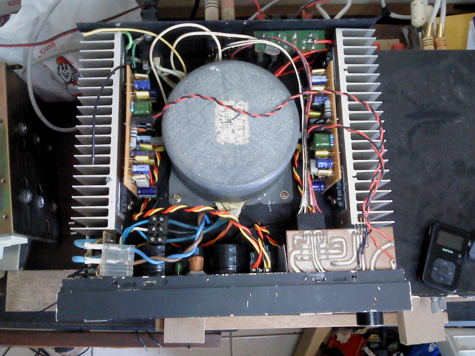

another DXBlameES mini
I love the sound of DXBlameES amp. When my friend give to me a broken amp with a nice small box, i just to think howto build DXBlameES inside
here the result...
here the result...

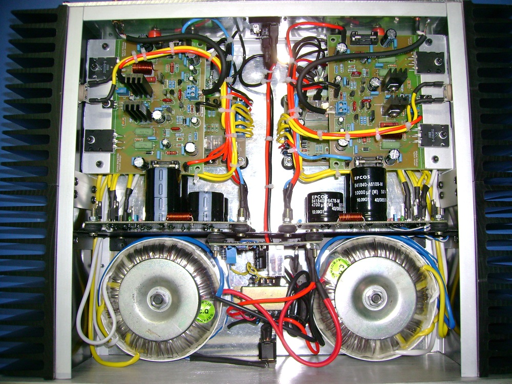

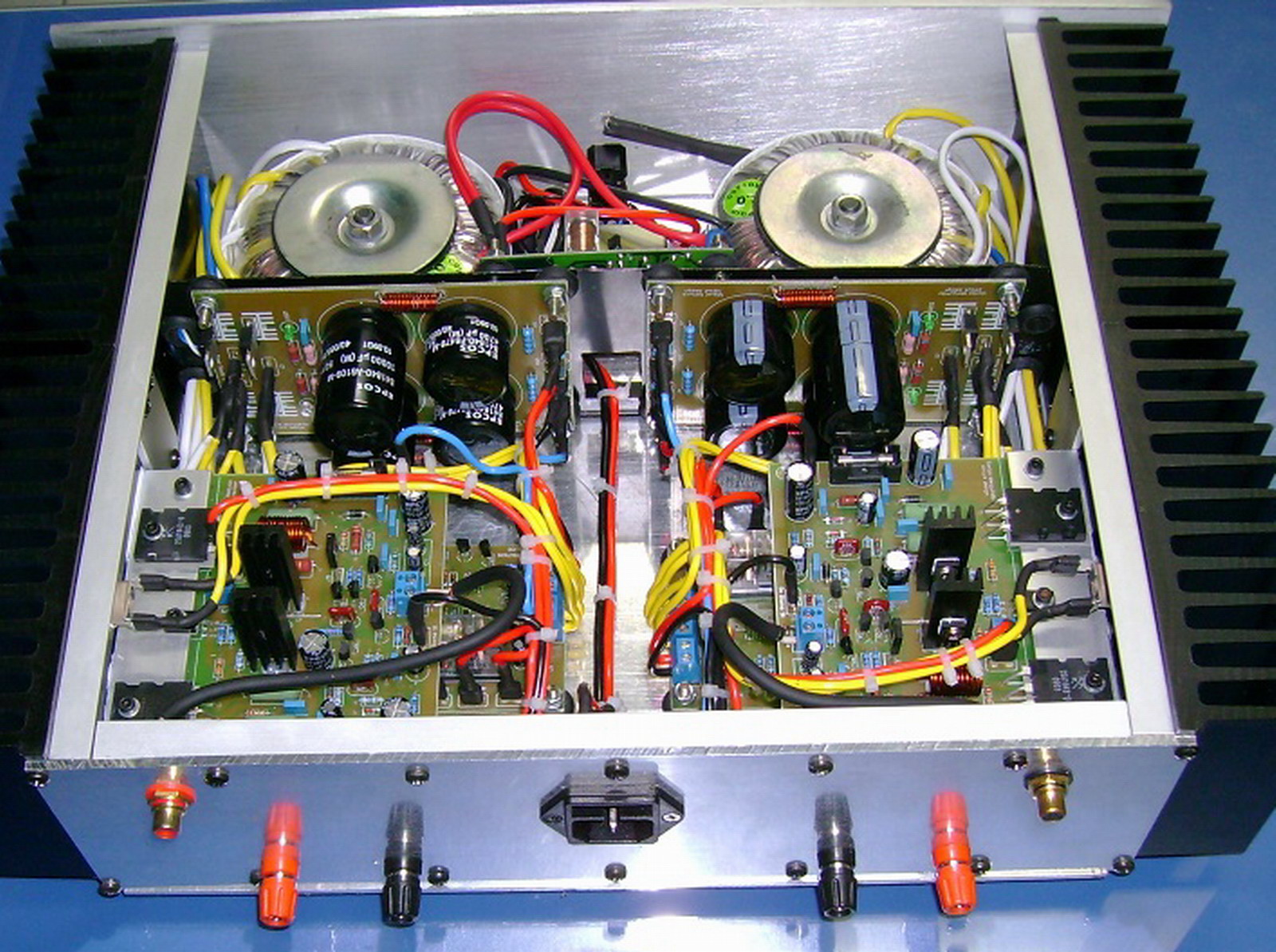

About power supply capacitors...
OEM's use less capacitance on purpose , barely adequate trafo as well. This is to have the power supply "sag" on purpose , allowing their barely adequate output stages to survive use by the consumer. To have "anal" amounts of supply reserve (capacitance) , any overcurrent event will have the power available to exceed SOA and blow the output stage. Study of OEM's has shown on average ,20kuF for 70w X 2 and 30Kuf for 100-120w X2 amps (Japanese). I am using 40Kuf @100V on my 120w/ch setup. If you have a over-engineered power supply (60kuf +) , you must match it with a the same output stage (example- 3 pair outputs for +/- 60V - 120w/ch amp) , especially if you are driving 4R loads.
PS - I only used 65,600uf total on 2- 250w/ch amps @ +/- 75V ... at full earthquake level .. less than 1v ripple was observed. plenty enough !!!
OS
OS
5000uf to each ampere of consumption
Blame ST power consumption to full power (100W/4 ohms) is 2.5A each rail..so..use, to each channel (separated supply, one to each channel) 12.500uf to 15000 to each rail..total of 30 thousand uf to each channel.
If you decide to use only 8 ohms...then you can divide by two these values.
Picture shows dual Dx supplies using 15k plus 15K each one of them.
Carlos
I don't understand how 100W rms/ 4 ohms can be developed with 2.5A.
What ripple level is achieved with "30 thousand uf to each channel" ?
Are the efforts by users to get 100W rms causing the parts to burn up ?
Thanks for your answers.
Noise is very little...if you inject subsonic tones, alike 8 hertz
Your speaker will move silently (we cannot listen this frequency) and you will not listen the mains noise even using 4 ohms speakers and full power...so.... it is good enougth this way.
1.5 amperes multiplied by 35 volts results in 87.5 watts of consumption to EACH rail..... so... total is 175 watts of consumption to produce 100 watts..you see that efficiency is within the class AB limits that sometimes reaches 65 percent.
To the speaker, you gonna have more current..combining both rail audio currents...audio may reach 5 amperes of audio and 20 volts RMS over 4 ohms speaker....or 2.5 amperes and 20 volts RMS over 8 ohms speakers.
I hope i could help you...needing anything more..please post your question.
