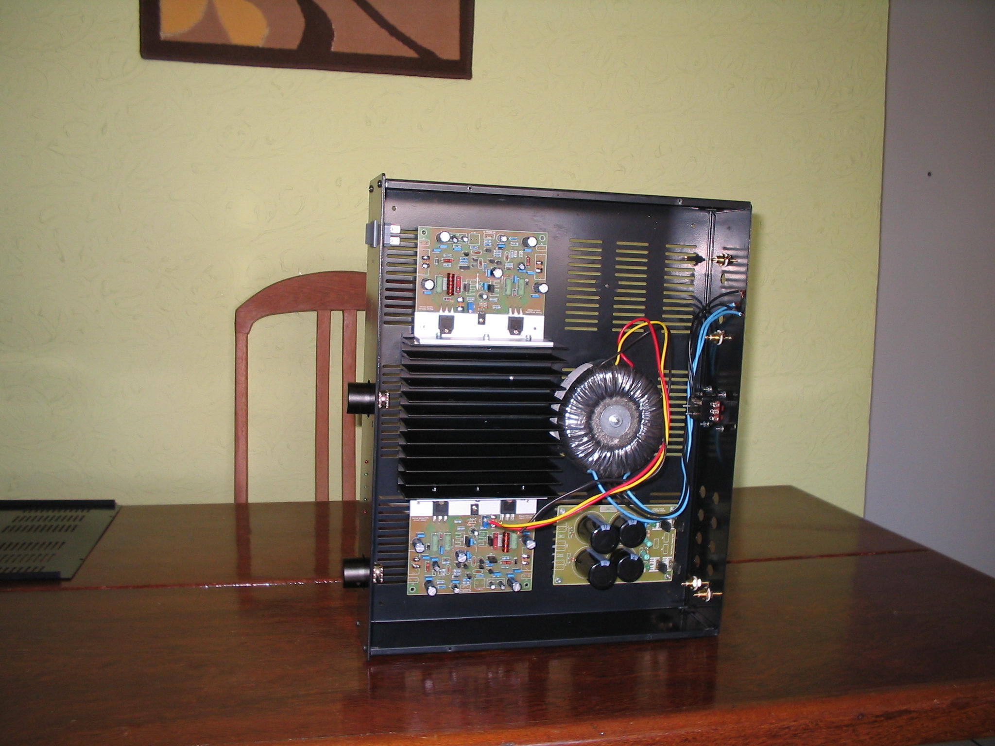

Boys, i am increasing rail resistors wattage...these 33 or 39 ohm ones
you have connected to rail diodes.
Some monsters have connected pre amplifier with several volts and smoked the series resistances because they have saturated VAS transistors.
They were already substituted, both VAS, by MJE15032 transistors..they are using heatsinks and i feel that these resistances should be bigger... 1 watt may be nice there..even 2 watts will be interesting..depends on the room you have in your board.... this is for safety to face monsters..and their criminal connections.
This amplifier is able to reach full power when you input 750 milivolts peak.... some guys connects 8 volts preamplifiers and turn the volume all the way up.
ahahahahahah!
regards,
Carlos

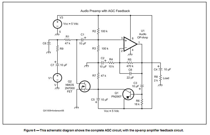

Use back to back diodes at input...
Single diodes... as shown here :
link: Analog Devices : Analog Dialogue : Input Protection
This will limit the input to +/- .8V (1.6v p-p)
For our "super amps" , to have a good amount of headroom , double (2 pairs in series) "back to back" diodes to get 3.2V p-p input limit. Good "fix" for those who "nuke" thier amps with preamps on steriods (10v p-p OP :smash: )
OS
But this clips the signal Ostripper
and this is not a very good idea as have sonic issues on that.
I would prefer an AGC style circuit, draining signal to ground without clip it... a fet receiving DC audio rectified captured in the output..adjusted to enter only when people overdrive the amplifier (not to kill dinamics...not to avoid distortions...just to avoid BIG distortions)
This is something you could cooperate and would be welcome..to develop the circuit... see AGC in the internet if this is not something that belongs your age...AGC is old and simple circuit, and can be highly developed.
This can be a "monster audiophile controller".....if they plug high level preamplifier, then signal will be controled without mess with the power amplifier.
I have made it once but was not good..... problems with hold and release time.
I was thinking to ask Hugh Dean...but the man is too much busy...he will not do it for me as he has his own personnal targets.
Monster audiophiles exists and they are not just few.... these powerholic guys does whatever they can to play loud...they increase signal in the input and also they install several speaker in parallel...hehehehehe... terrible these guys, they need a really heavy duty amplifier, something made to a hummer war vehicle....i have visited some and i perceived they do not perceive distortions....clipping and distorting at 5 percent is normal for them.....bass clipping and sinus transformed in square waves is what they listen...another world.... the "monster world"
regards,
Carlos
Under normal conditions (under 3.2v p-p) the diodes would never clip and would offer a stiff upper limit to the input. AGC is known to me (basically a compressor).
Here is that circuit you mentioned (pix-below 1) link: http://www.arrl.org/files/file/QEX_Next_Issue/Sep-Oct_2010/Anderson%20Sept-Oct.pdf
This would be better put at the output of the preamp , one must note that either clipping or compression DOES alter the signal . Clipping sets a "hard limit" , but compression (AGC) might affect the sound otherwise. 🙁
OS
