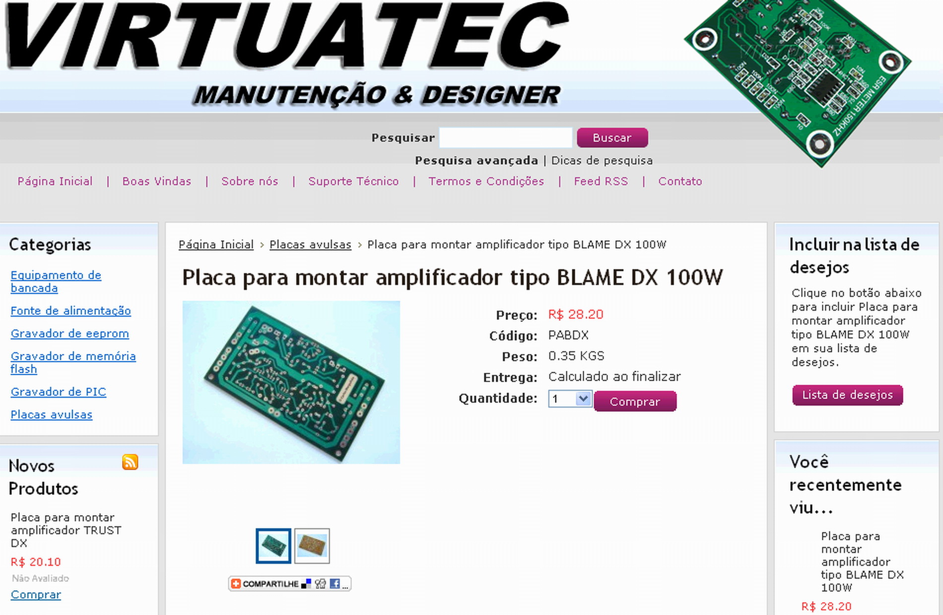

can u give characteristic this amp like slew rate, damping factor, THD , TIM , and frequency response?
Sadly there are pirates in Brasil
But gladly they are spreadimd the nice amplifier world wide too.... and this is not that bad.
What is impressive is the small price.....i tried a lot but could never had so low price to boards....this smuggler maybe have ordered thousand boards to obtain such low price.

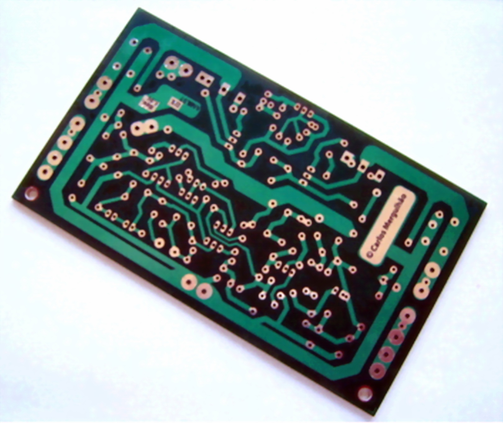

The board is awfull....aaagh!.... ridiculous layout....and Virtua can have twoi meanings; virtue and virtual....for sure there's no virtue in such kind of illegal , non supported and non authorized behavior

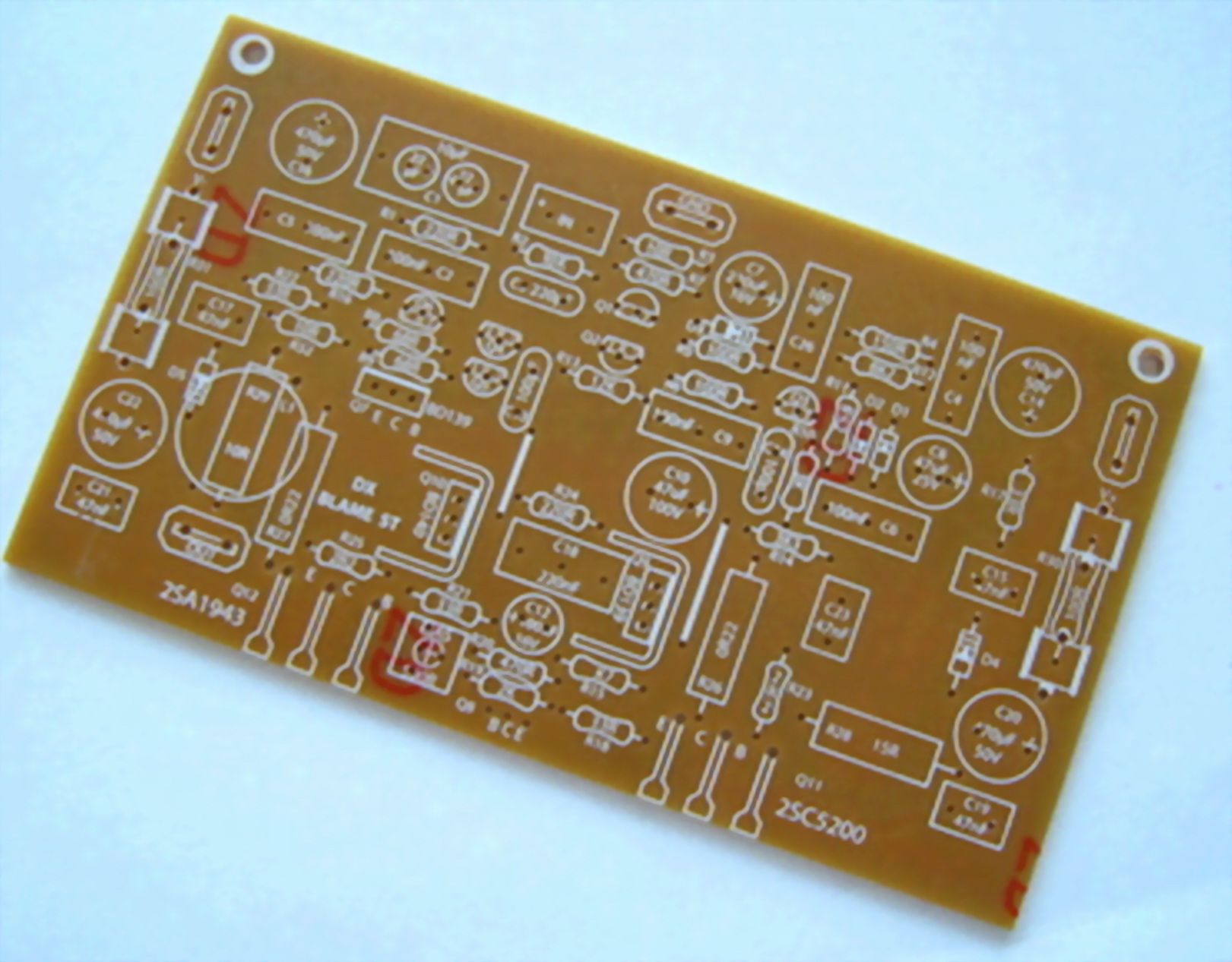

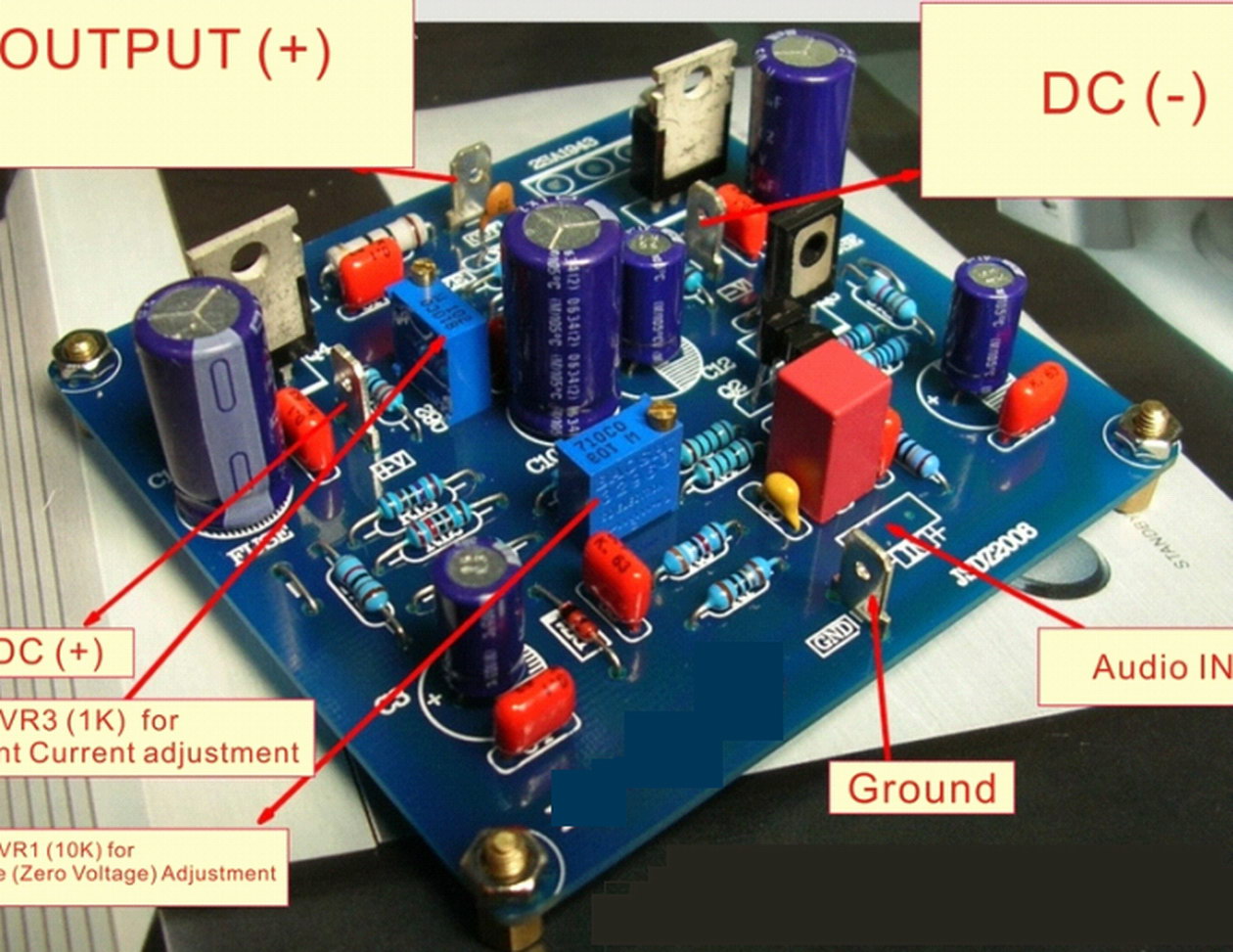

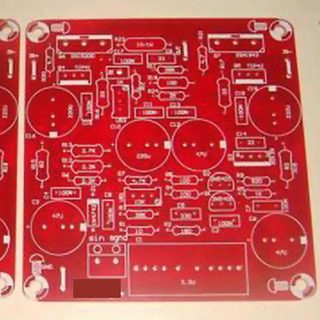

Hello Carlos
Looking at the silk screen side photo, it seem to me that those pirated Dx Blame board made for the pirate are not fiberglass pcb but just cheap rosin pcb, so they cost less to made and the pirate can sell them for cheap.
So it's a real el-cheapo crap pcb from that pirate, he stoll it to you and he sell a bad copy pcb of your amp.

Yes dear Gaetan...also they are very small...and silk screen seems poor
there's a silk screen that washing boards with Kerozene (aviation fuel) or alcohol, the paint is diluted and removed...maybe this is the case....but interesting anyway, is the low price the one could have.
I have asked Mitchell to search for low price anywhere and he could not find a manufacturer to ask for low price alike this one...maybe the guy have ordered a few thousands boards.

I found a web page where they copy all popular amps, the Dx, the Pass Lab, the Quad, the Naim, etc... that is ripp-off and piracy on big scale.
All those pirates do surf all the diy amps forums on the web, and they look for the most popular amps and schematics, they don't know a lot about amp design, but they don't mind since they pirate other's amps designs.

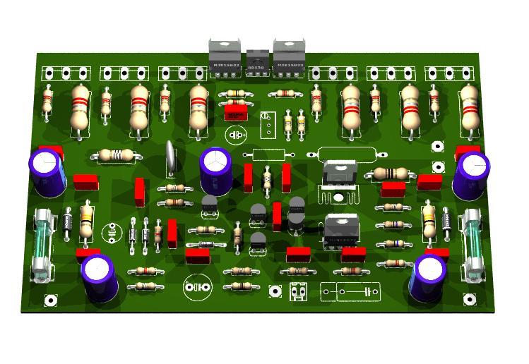

A couple of quick questions (for Carlos):
Is there a reason why 47nF was chosen for the poly decoupling caps instead of the usual 100nF?
Why is the Zobel 15R + 47nF instead of the more usual 10R + 100nF?
Thanks.

Decoupling caps can go from 103 to 224
The reason why was that i had them at my home..huge ones to high voltage...as i use to make prototype..when finished i copy the values used in the prototype board to the final schematic...this way these values became standard..no problem to use the most common values.... 100N and 10 ohms..well..these parts will not operate anyway in my amplifiers..you can even remove them..... Dx Blame is very stable.
These decoupling ones cannot be coiled internally...so, not beeing coil internally you can use the value you have with twice the rail voltage... as almost all values higher than 10N will be good, as they will represent a very low resistance to drain oscilations as soon as they start... when the electrolitic condensers, because coiled (inductors) are a resistance to high frequencies cross them in direction to the ground.

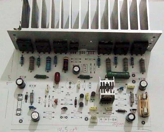

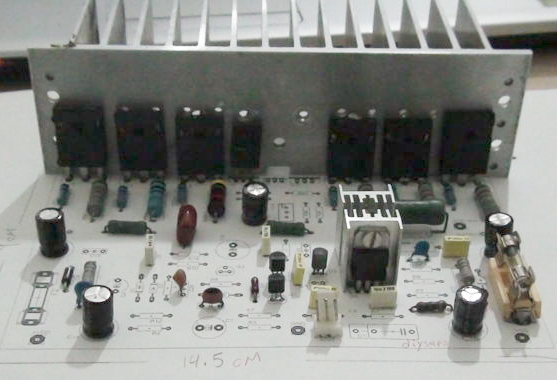

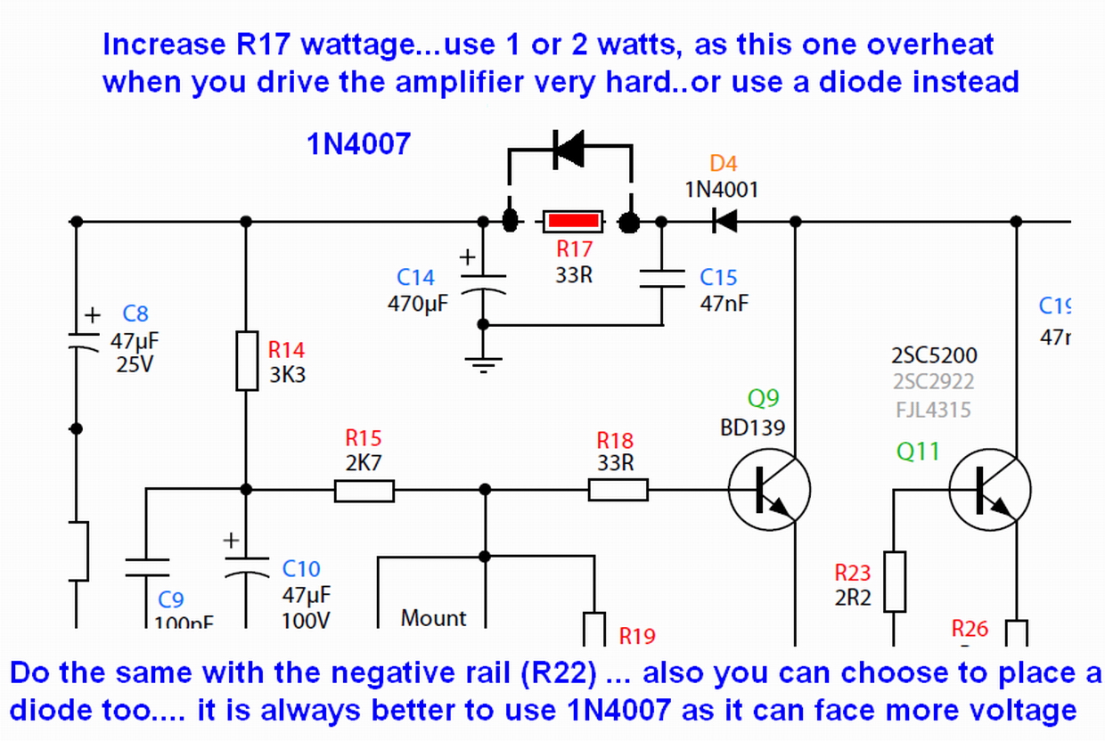

I perceive R17 hot while i was pushing the amplifier very hard
Playing full power a pipe organ...huge bass and i felt the resistance start to smell....so.... a good idea is to increase it's watts ratio, and this was already made in Brazilian boards.... also you can put 1N4007 diode in the resistance place substituting it by the diode.... try 1 or 2 watts..the bigger one you find room to install there.
Also, as i have told you before, several times, it is a good idea to install big transistors in the Q6 position.... so, the two VAS uses bigger transistors, not the small 2N5551 or BC546 anymore...this was done in the earlier models and boards....also a good idea to use heatsinks on them (both) if your amplifier is MKII Supercharged, MKII and MKIII.

something wrong here.i felt the resistance start to smell....so.... a good idea is to increase it's watts ratio,.... try 1 or 2 watts..the bigger one you find room to install there.
R17 passes <20mA. It feeds the LTP at the input and feeds the VAS.
Power dissipated at quiescent state, assuming 20mA, is ~ 13mW
When the amp is driven the LTP current stays substantially the same. The VAS current varies either side of the quiescent value. The average power dissipation when the VAS is processing the audio signal remains at the Pq value.
The amp is misbehaving if R17 runs warm.
Fitting a higher power resistor will not stop the amp misbehaving.
You have to find out why R17 is passing extra current.
You don't stick an Elastoplast over the cut where a leg is almost severed off.
Are we back to the missing resistor in the collector of the VAS buffer?
