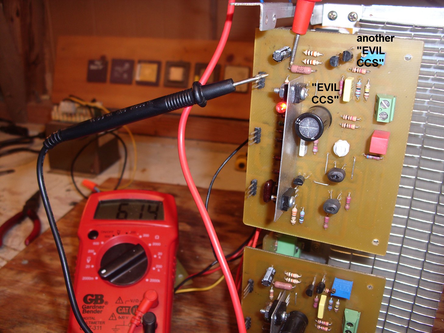

I agree , Dr. Self's "blameless" is the "most for the least" (8-9 parts). "Evil CCS's" are at least good for universal voltage (EXACTLY 6.14mA from 15V to 80V 🙂 ) To make a "CCS'ed" blameless sound better , add resistor at LTP "tail" to "soften" it's CCS. 😀 . "Trial and error" (the DX way) to the rest of the amp's values , and even the "EVIL CCS" version can be VERY good sounding (below) and will never fail ( 48 hours of 60V square wave - VERY HOT!! )

But this trick will not emulate the loudspeaker impedance variations being fed back to the VAS through a bootstrap , A "true blameless" with TMC (CCS VAS) tries to do so. Bootstrap does have a certain "magic" , but this is dependent on the speaker and output stage used/auditioned. Both versions of the blameless are very defined and can be "tweaked" to be almost identical.
The resistor on the LTP does add a few PPM to distortion , but at .0002-3% ... who cares ? :scratch:
